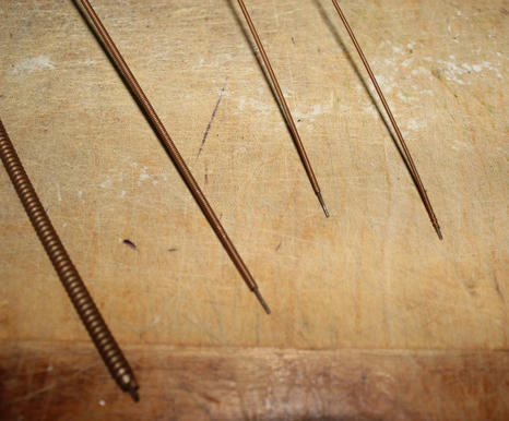

Another option, and bear with me people, is piano wire. Not the generic thin-guage rolled stuff at the craft store, I'm talking about the actual wire used to string pianos. The guaging ranges from a very fine single strand extruded wire, all the way up to thick strands with a spiraled outer layer. I'd guess it goes from 1/32" diameter all the way up to nearly 1/4", the lengths get to nearly 3 feet:
Yes, they are not the easiest to just go 'pick up' at a store... I got my supply from a couple of junked pianos, and have been using those for a couple of years now. Anyways, piano tuners can also get you old strings as well. If you don't find any other alternatives to work that are long enough, PM me and I can send you a few. :thumbsup
