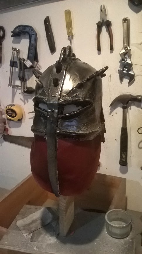

I tried a variation of this method to kick off my Hiccup helmet, and it worked as a base.
