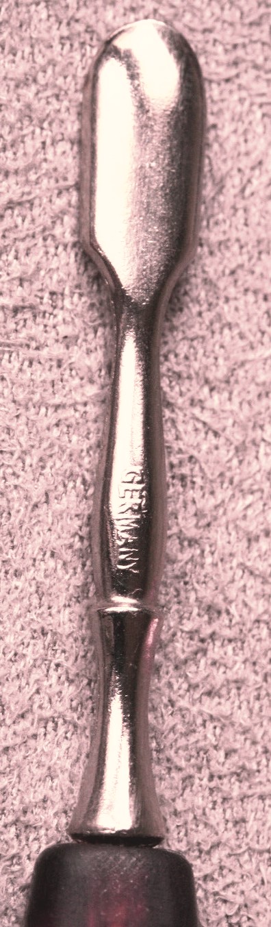

I love using a manicure tool that is rounded and concave on one side; like this:
