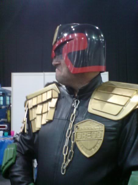

Sorry no pics , but the dredd eagle on my avatar was done in rustoleum, it was a bit rushed as i was getting it ready for an event and i think i could have got it a lot shinier with more time. Good stuff and dries quick but i would definately go for the krylon if you can get it as when i did have a can is was shinier.

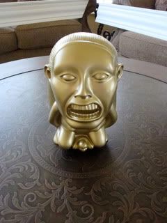

Here is the idol I painted with the Rust Oleum Advanced Metallic Pure Gold:

It looks way better. Not sure what success the other poster had with it, but coming from a spray can it has an incredible chrome look, if you spray it right. Looks even better in person. If you spray too far away from the object you're not gonna get much of a reflective surface. And spraying too much and too close will cause it to run. Also, as I mentioned before, fingerprints were a problem. Because the idol is rubber I think it was more susceptible to fingerprints. I suspect the paint will work even better on metallic surfaces. In any event, let it dry for a really long time before handling it. If you do get some fingerprints, I found that rubbing it with a little bit of wax paper makes minor ones disappear. Finally, don't apply a finishing clear coat. I didn't know better and when I did, the shine was gone. Had to do it all over again. Grrrr

here's one of the shoulder and eagle done with rustoleum and Krylon premium brass , as said it was a bit rushed and i reckon i could have got a better finish if i had gloss blacked and poished the black too before painting the gold.

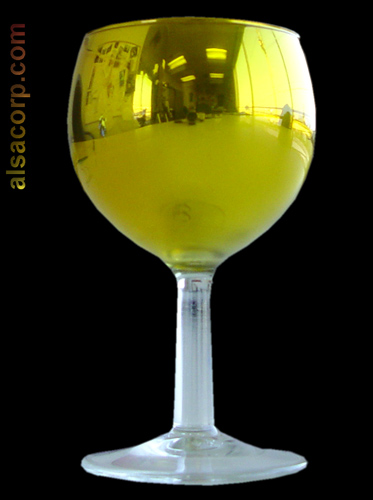

I just talk to a Tech at Alsacorp. All you do for the killer chrome in a can is, do the chrome, use a coat or two of mirra-Clear then use the true gold candy, coat again with Mirra Clear for the most durable finish, no finger prints, very effective...Don't think you can match this...period, not with a can anyway, but as already stated, it is expensive. I've used this product with great sucsess and a little goes quite far, being it's a metal deposition, it's just dust coated to achieve the optimum effect.
Will
http://alsacorp.com/products/mirrachrome/images/alsa_alsa_disney19.jpg
http://www.alsacorp.com/images/MCglass1L.jpg
http://alsacorp.com/products/mirrachrome/images/alsa_alsa_disney23.jpg
http://alsacorp.com/products/mirrachrome/showcase/P1040321.jpg
http://alsacorp.com/products/mirrachrome/showcase/DSC08027_L.jpg
http://alsacorp.com/products/mirrachrome/showcase/DSC08024_L.jpg
