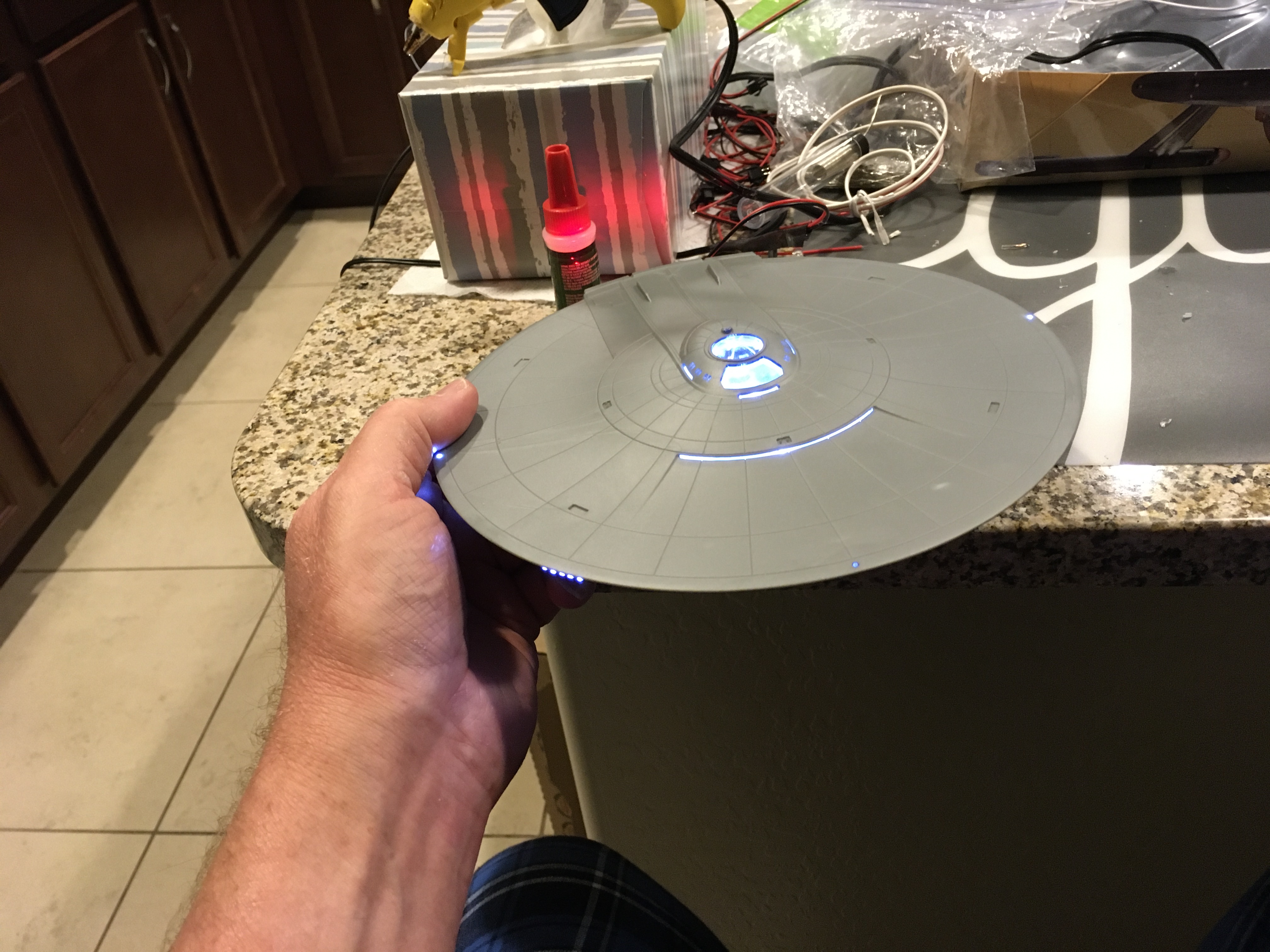

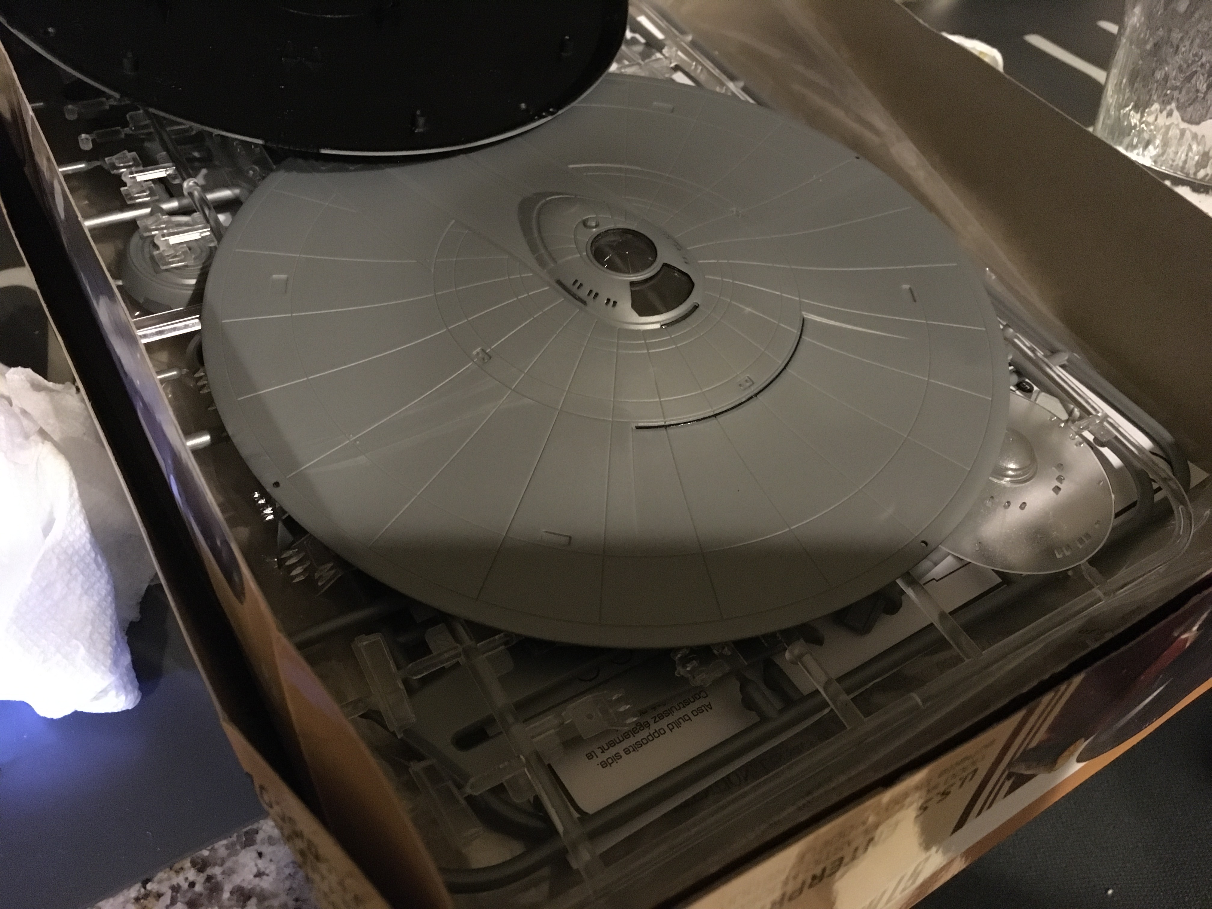

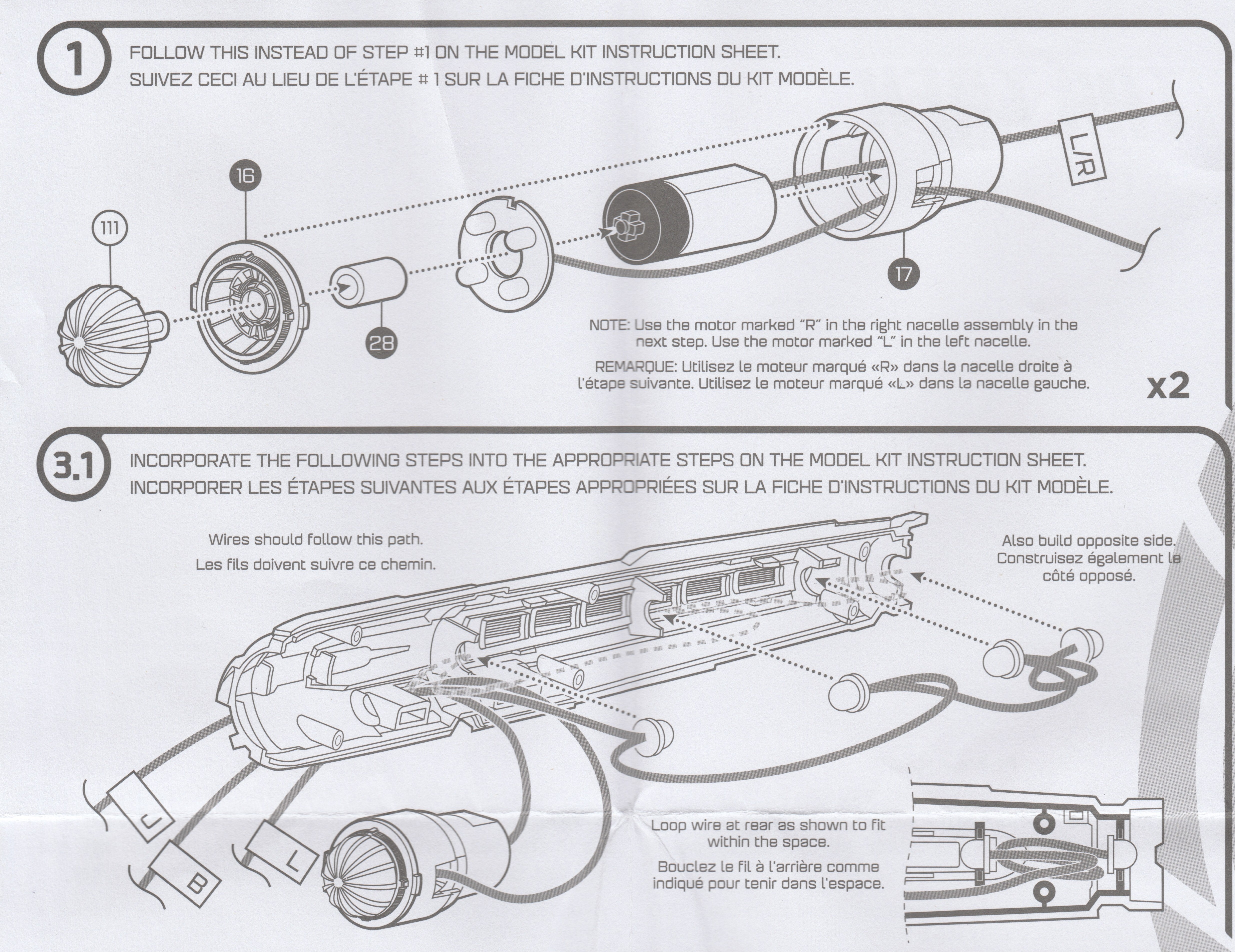

I picked one up yesterday afternoon. It is a very well crafted model. It was made with LED mounts built in, the windows are grouped in sections in clear and the whole thing fits together tightly. There are wire tracks built into all of the pieces and the base has a metal rod for mounting it.

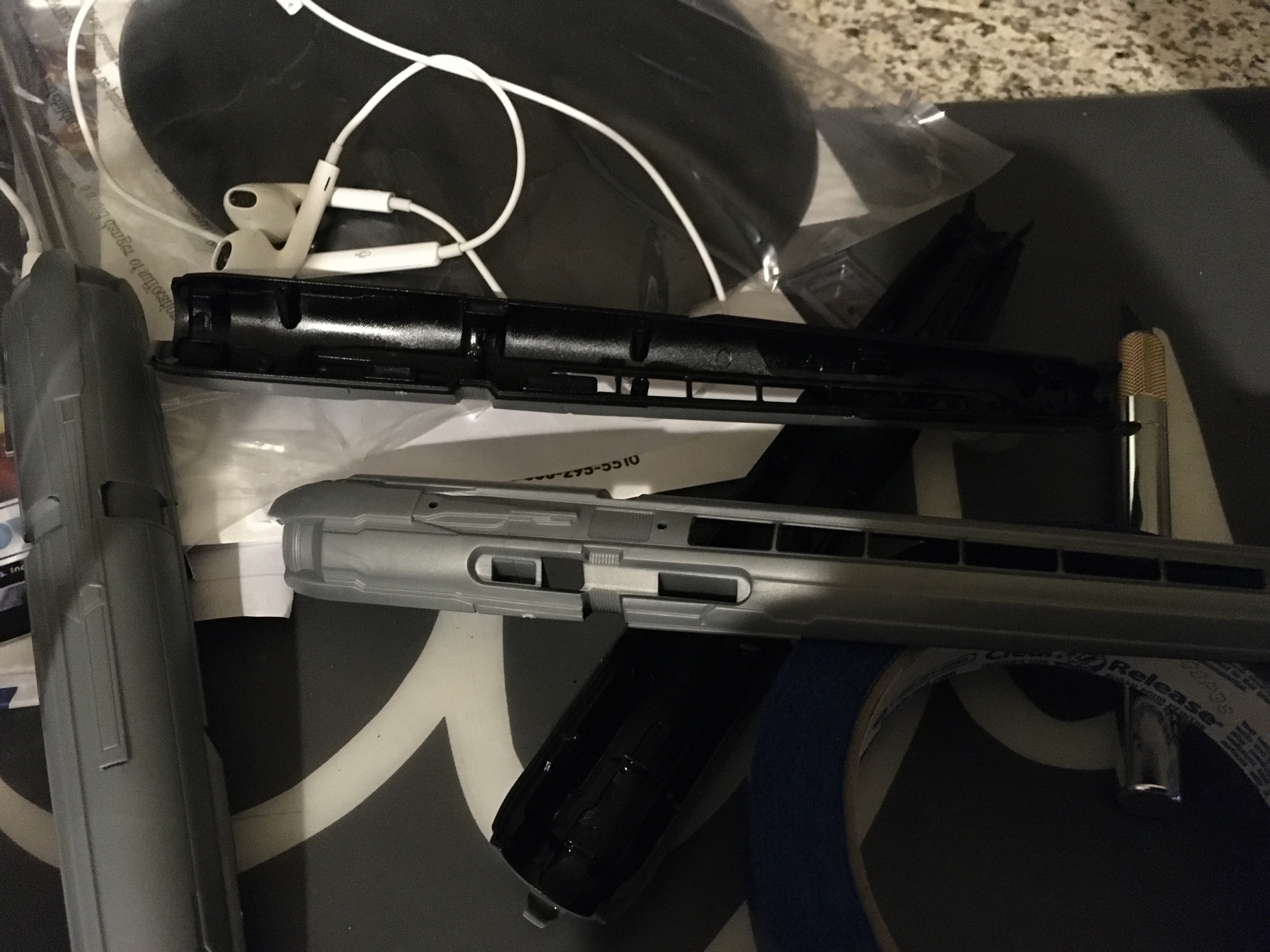

It’s moulded in the ship’s color, a silver grey which is great as it will save with base color painting, but I’m going to have to mask it really well as the inside needs to be painted black to block light leaks.
The warp nacelles have clear parts, sadly the end cap at the rear of the engine is cast in clear and will need to be painted, with the exception of the lit areas. The bussard collectors have two clear end caps, and outer one and a smaller inner one. I think I’ll paint the inner one translucent red and then light it yellow from behind. The outer caps I’ll leave clear and see how it looks.

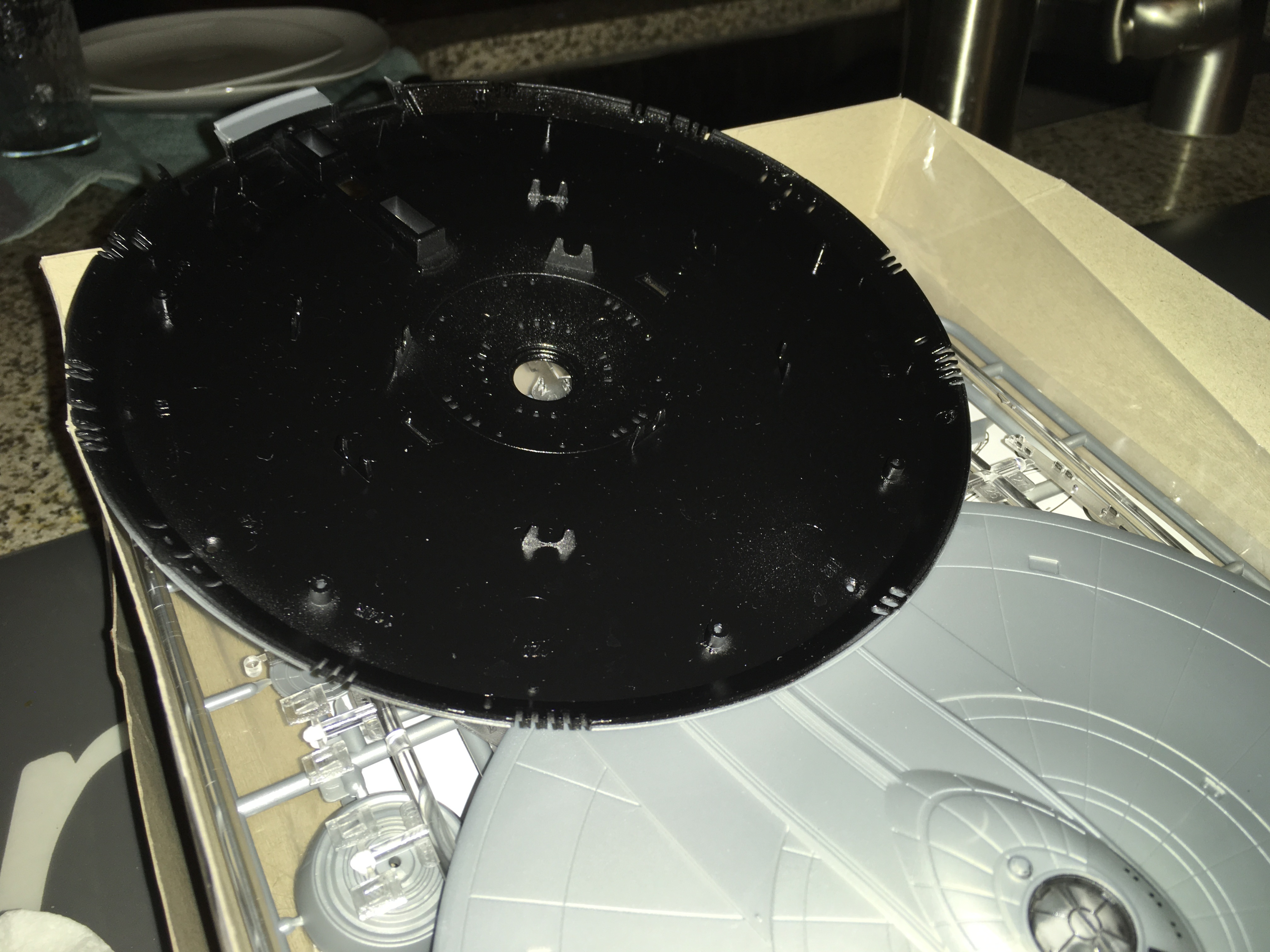

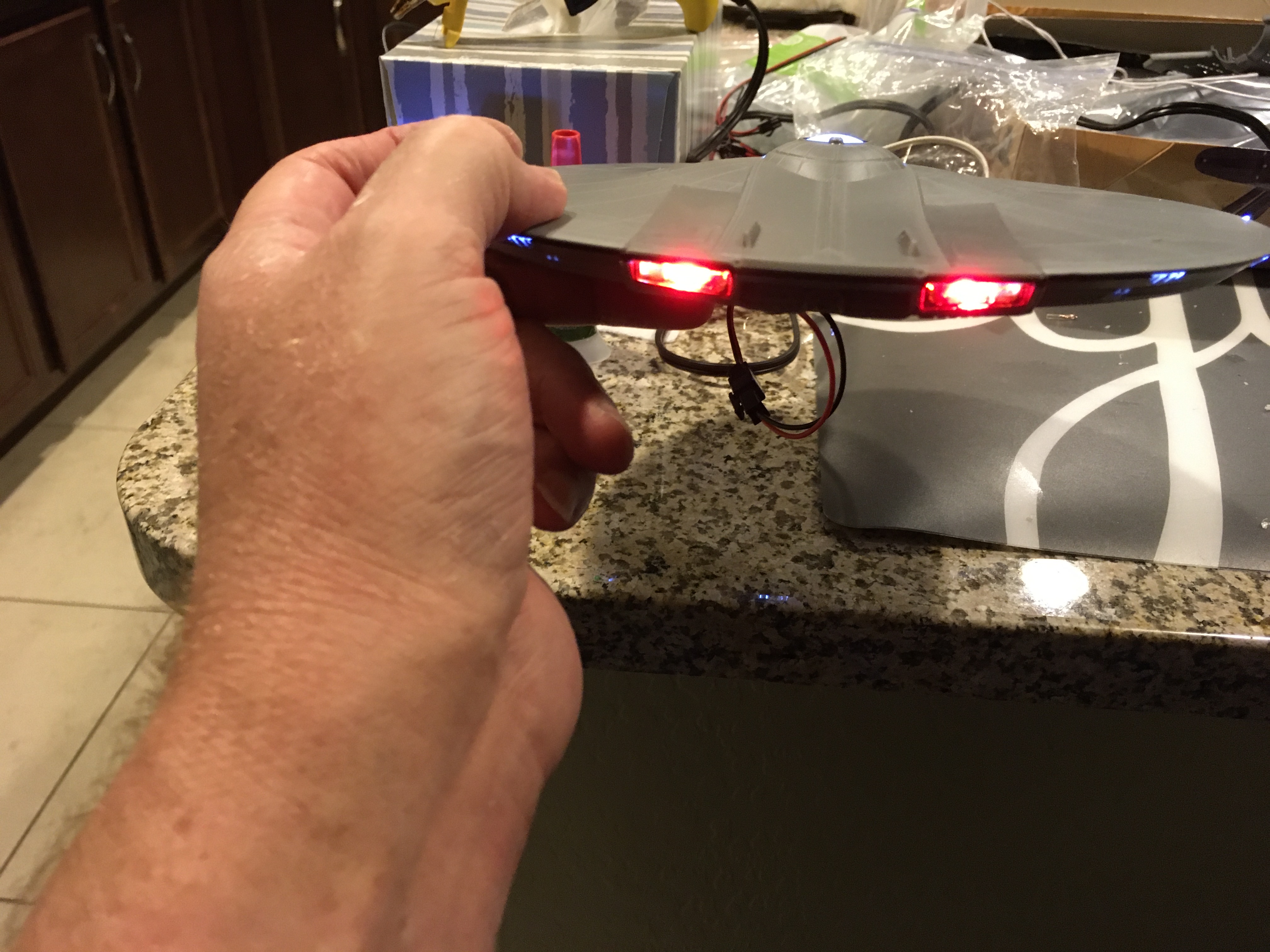

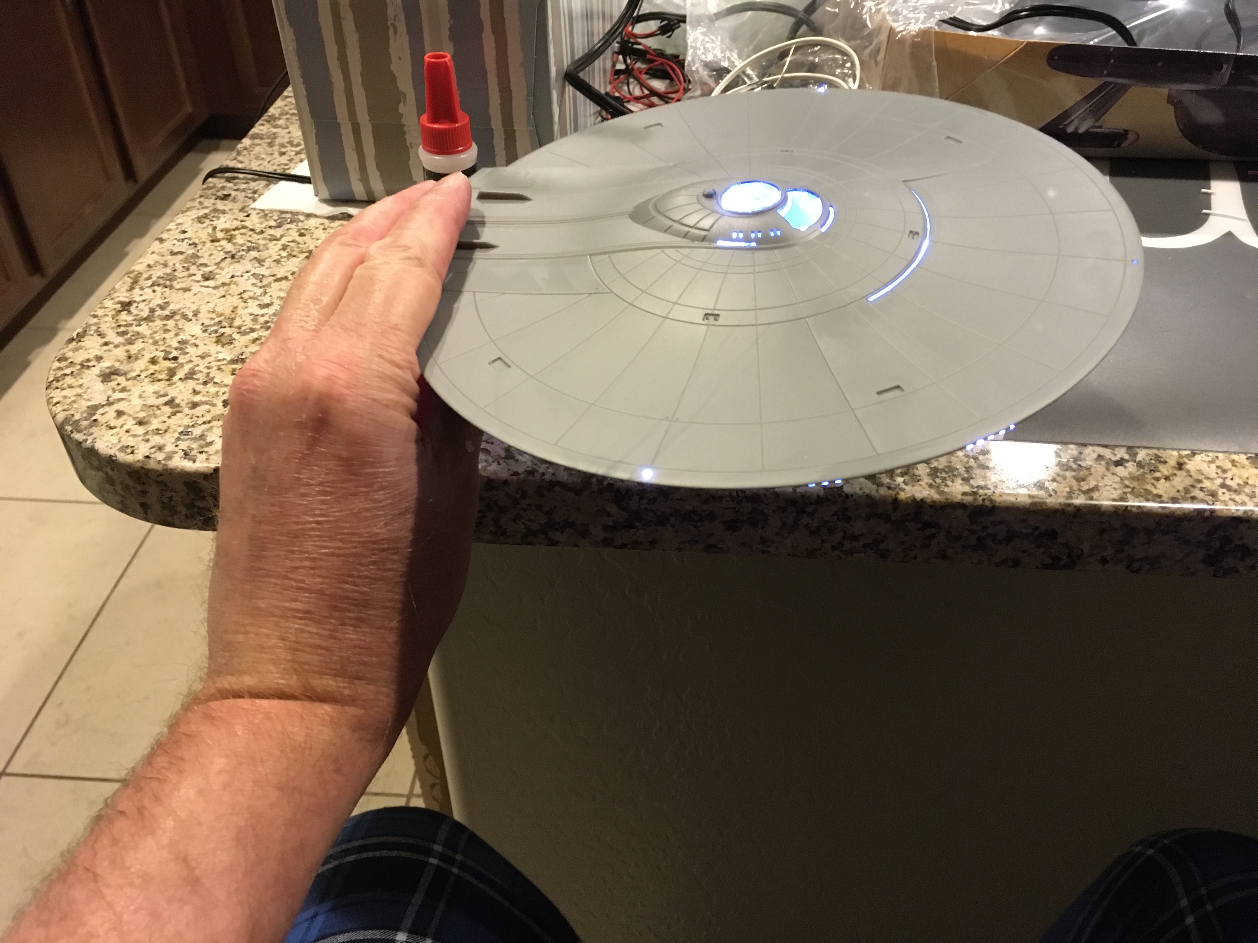

Took some pictures to show the ship’s color. Got the underside painted black without any overspray. Whew!

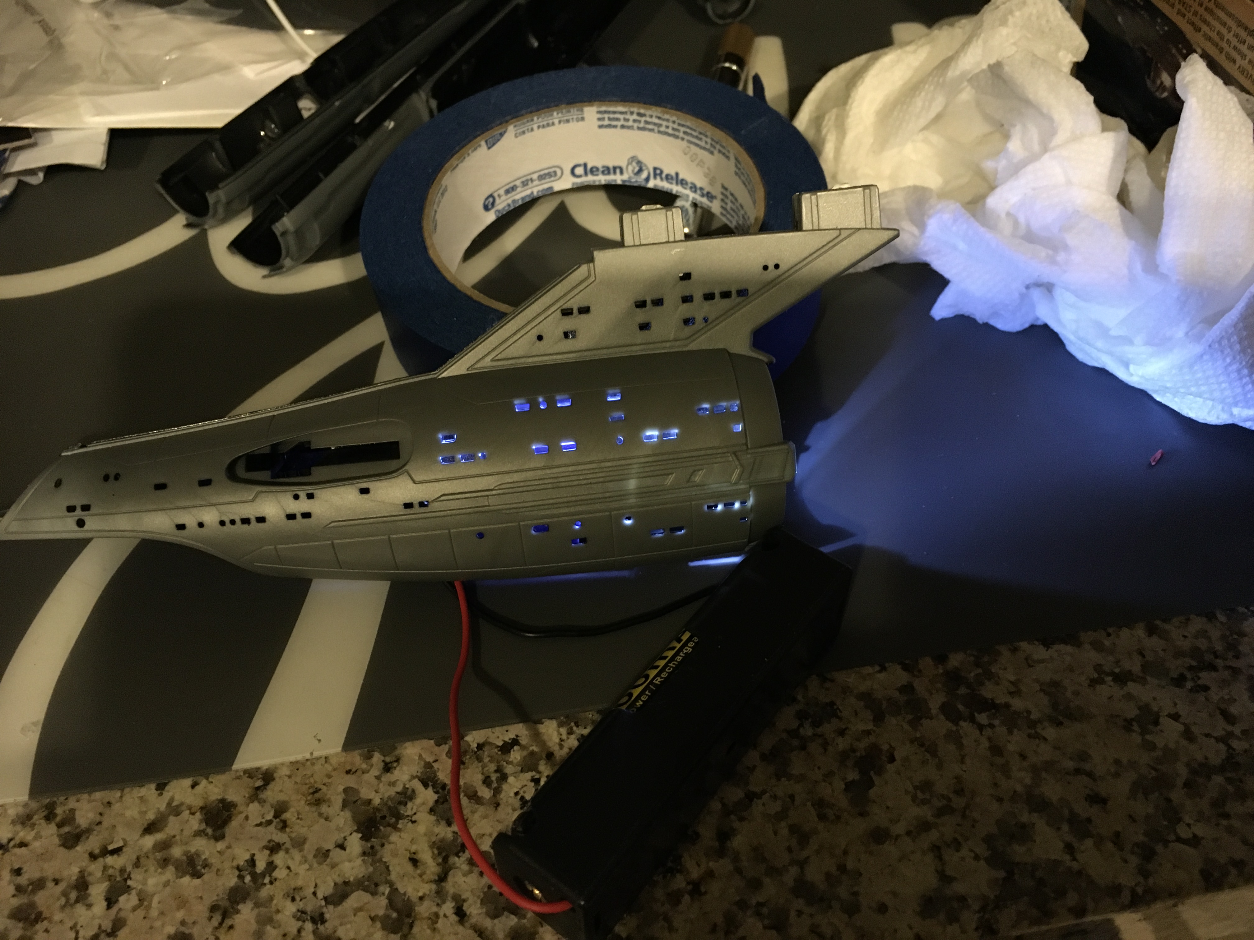

Look at some of the LED holders. They are all for 5mm except for the neck which holds two 3mm.
I have a single LED in the main body to test light.

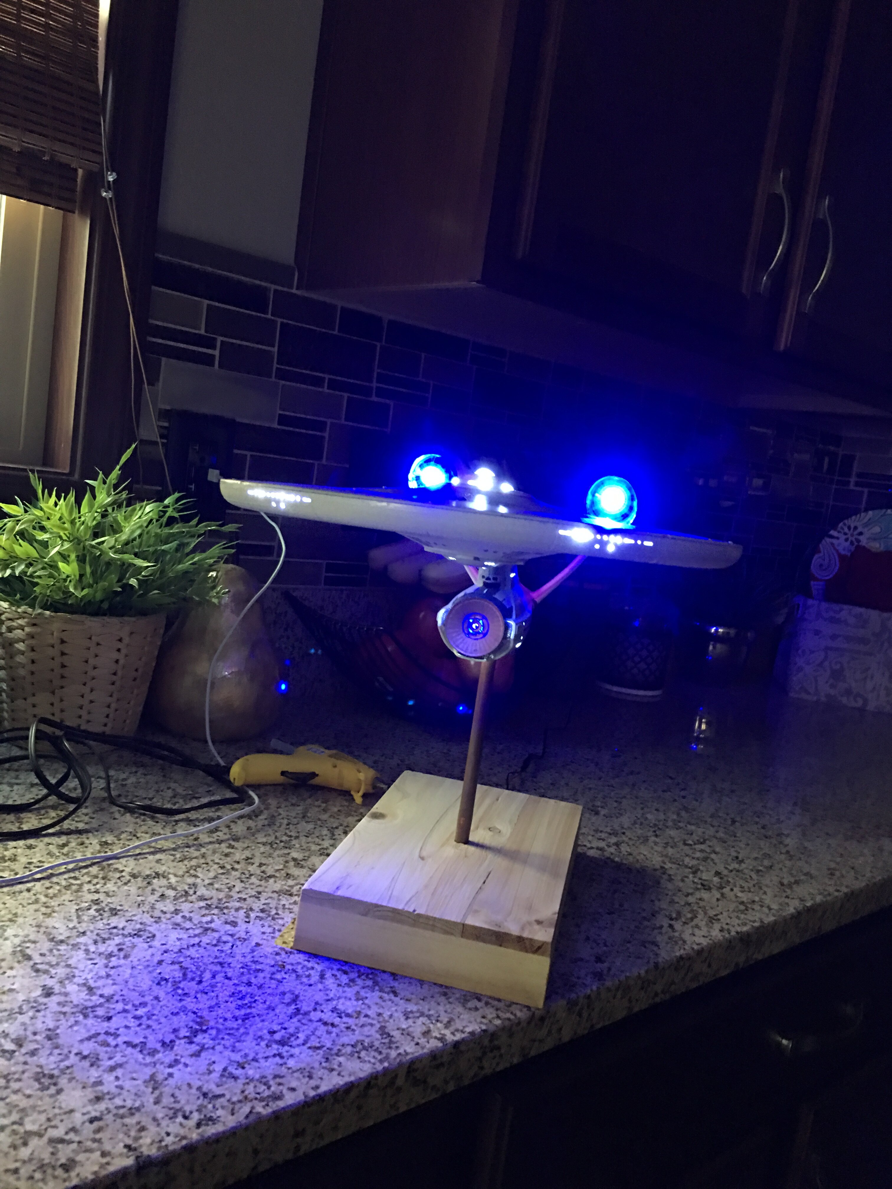

Cool, that is basically how I am wiring up my engines. I was not worried about having spinning Bussard collectors, so I decided not to spend $80 on the kit, but rather to use the multitude of LEDs I already have. I have never needed to have the spinning rims and all the bells and whistle’s on my models, for two reasons. 1. As long as it’s lit and looks nice that’s enough for me. 2, my wife does not let me display them anyway! LOL
aye. i ended up not liking the colors of ALL the leds they supplied and there's additional lighting i'll be doing like the spotlighting and such. all i ended up finding useful was the battery switchbox, the rudimentary circuit boards, and the motors. i don't like my white spaceship lighting blueish and the bussard lighting was not amber enough for my taste. i also don't like my clear parts colored when the power is off save for the red outer domes.
i'm currently trying to fit a bunch of leds in the tiny 1/2500 version first. then i'll be moving on to the 2 of the bigger ones i got (i'm gonna make sure that front registry gets really lit on mines).

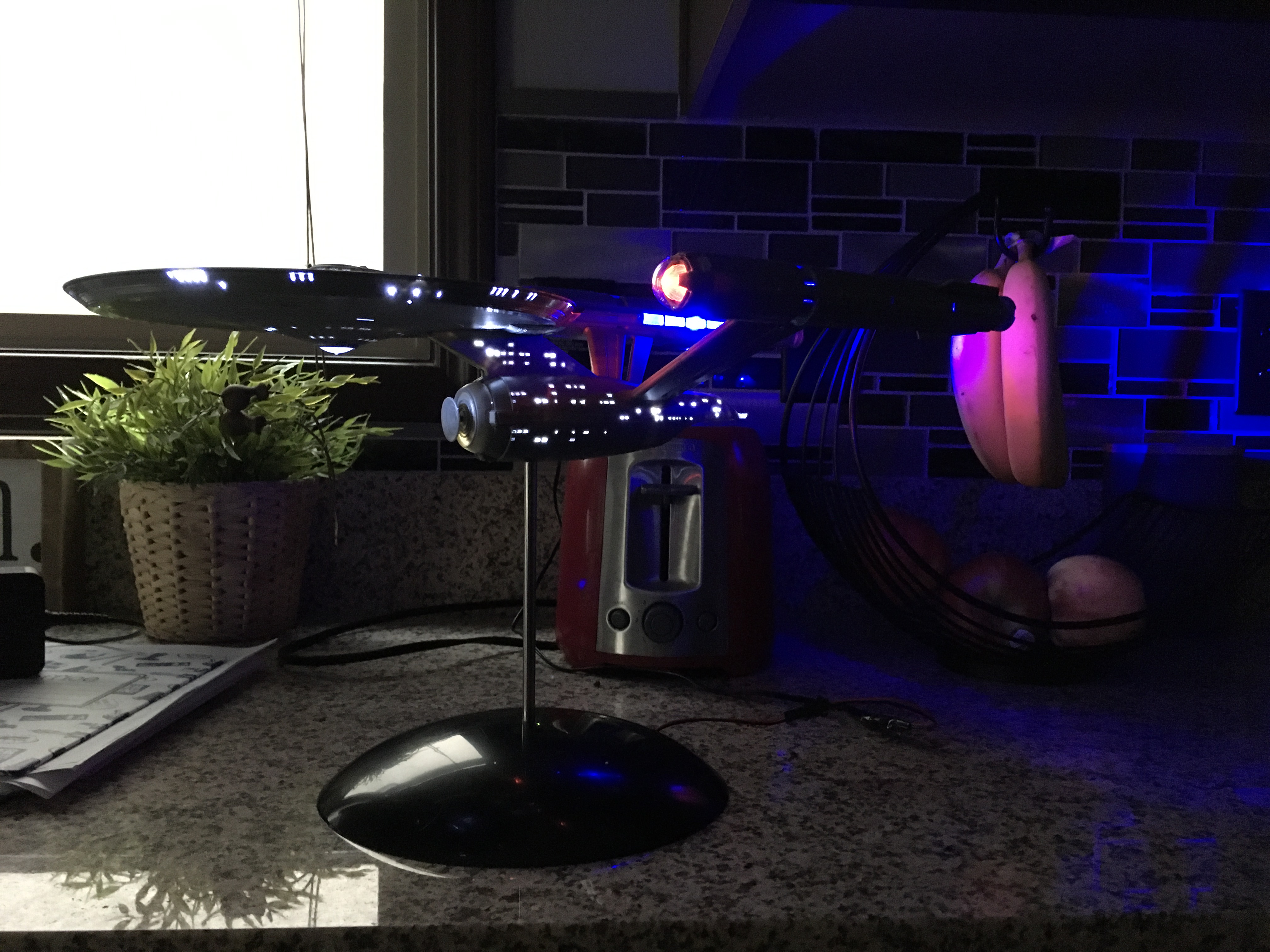

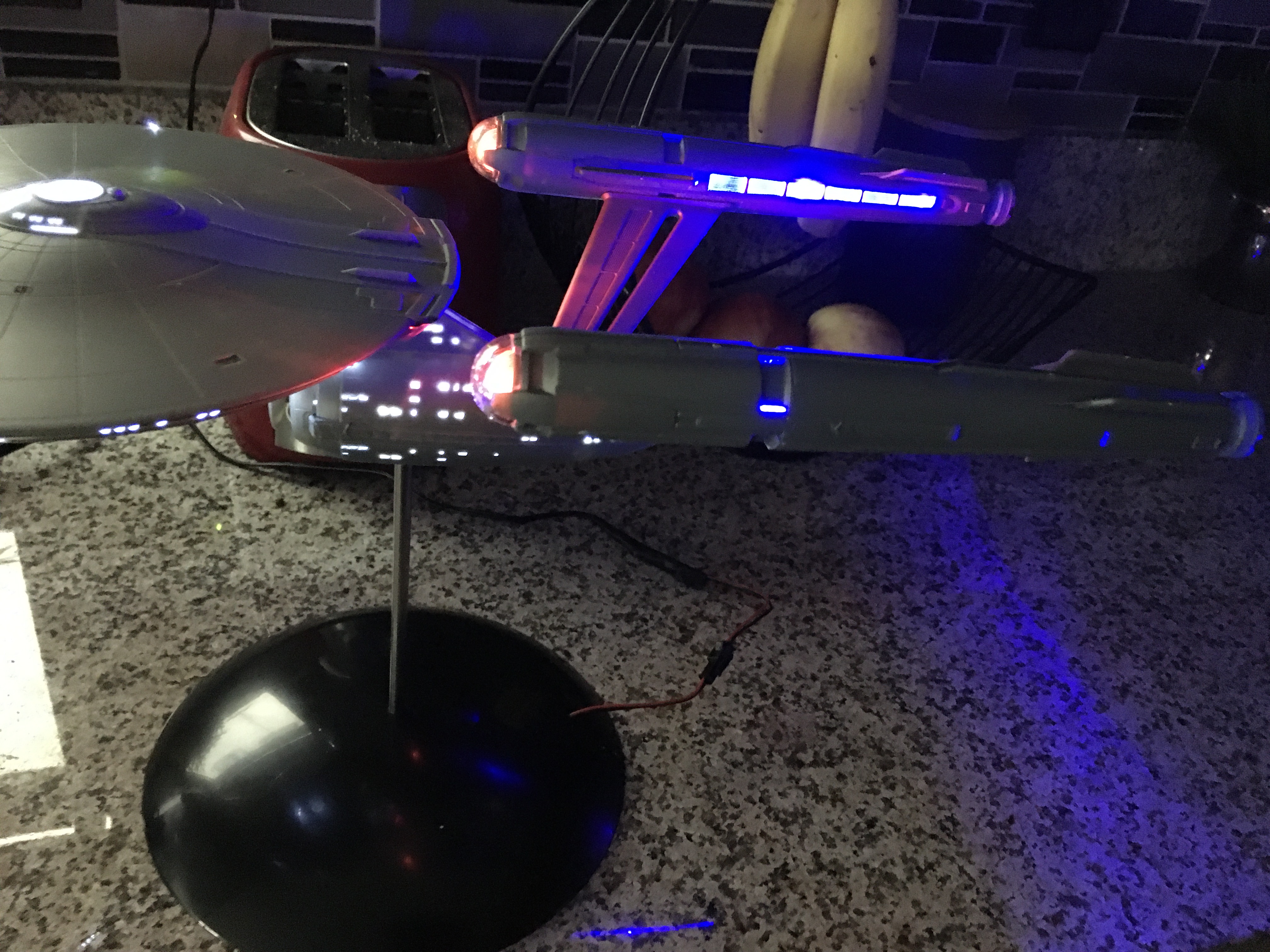

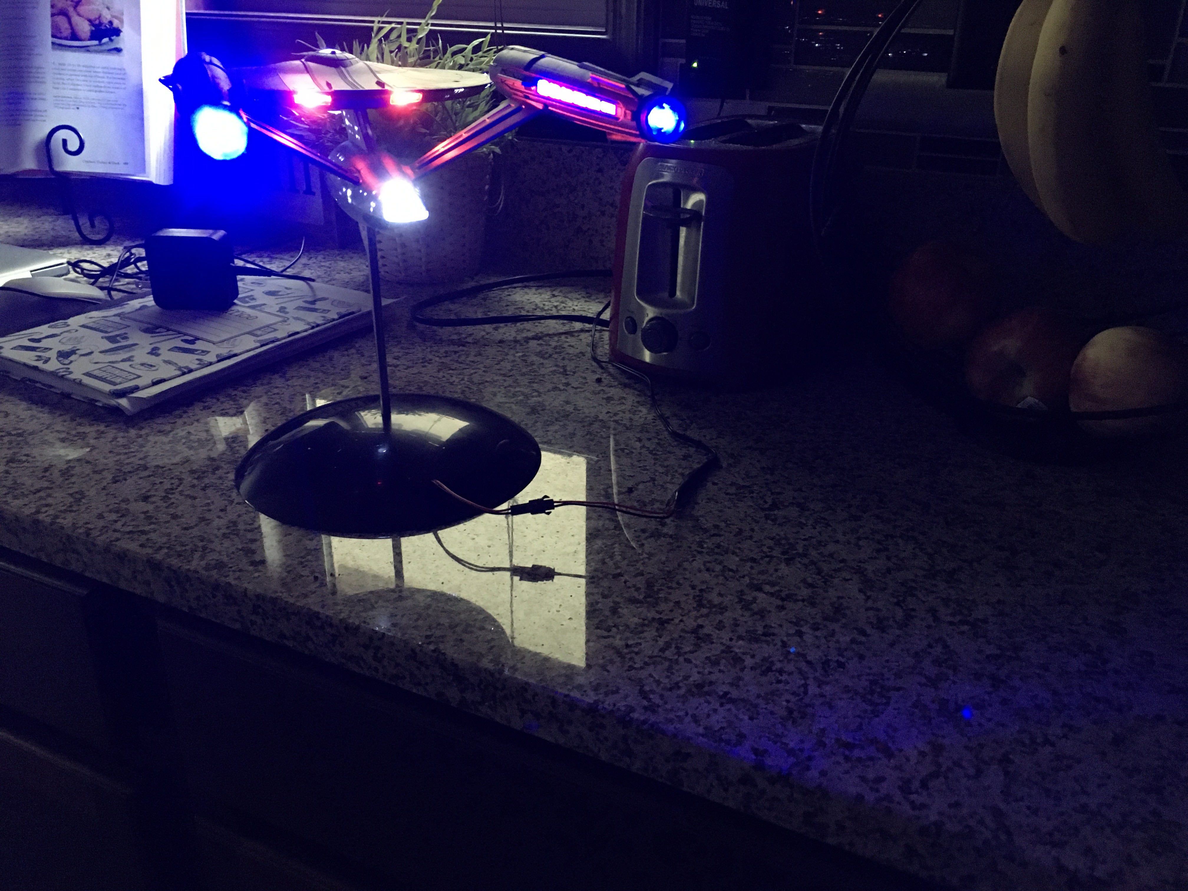

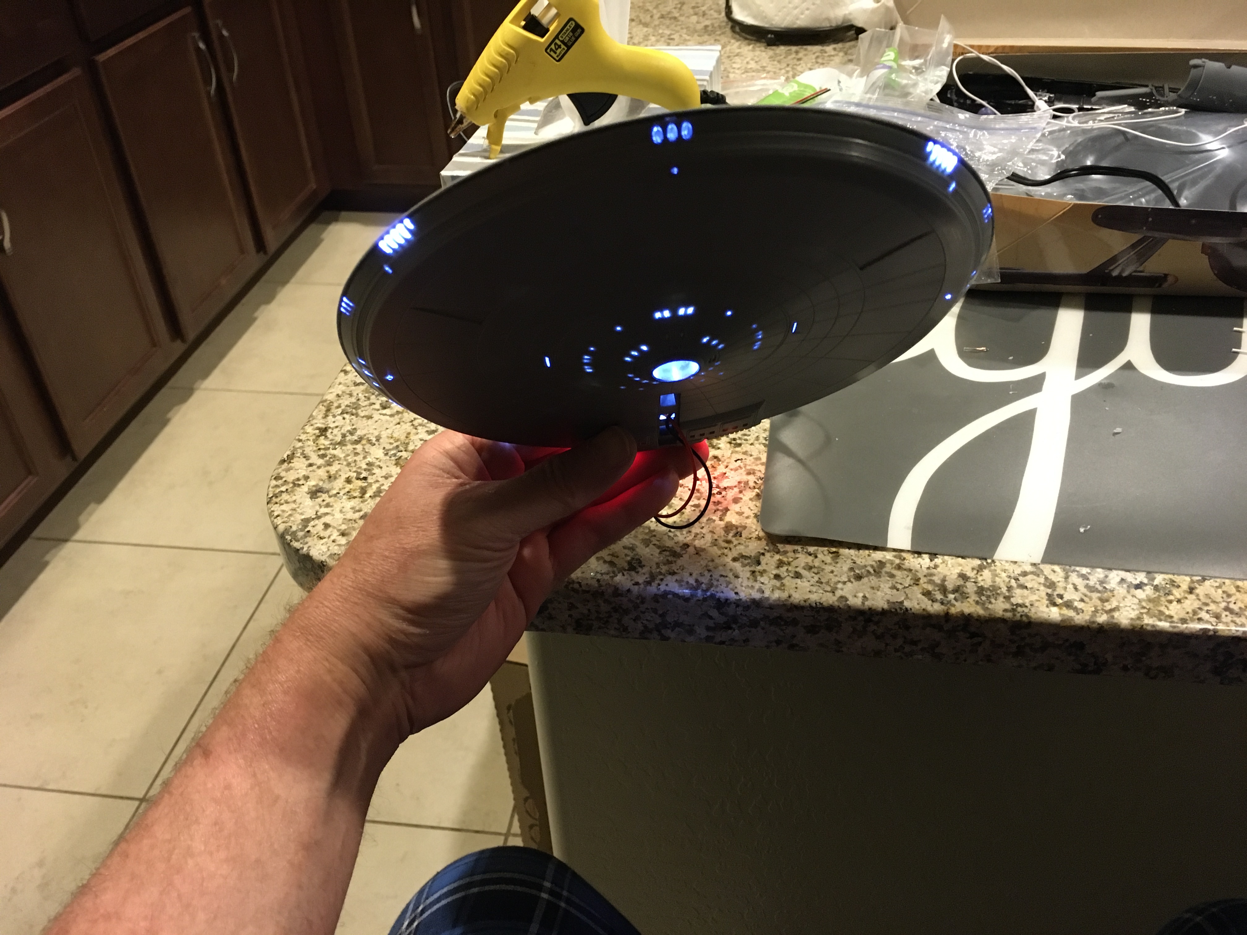

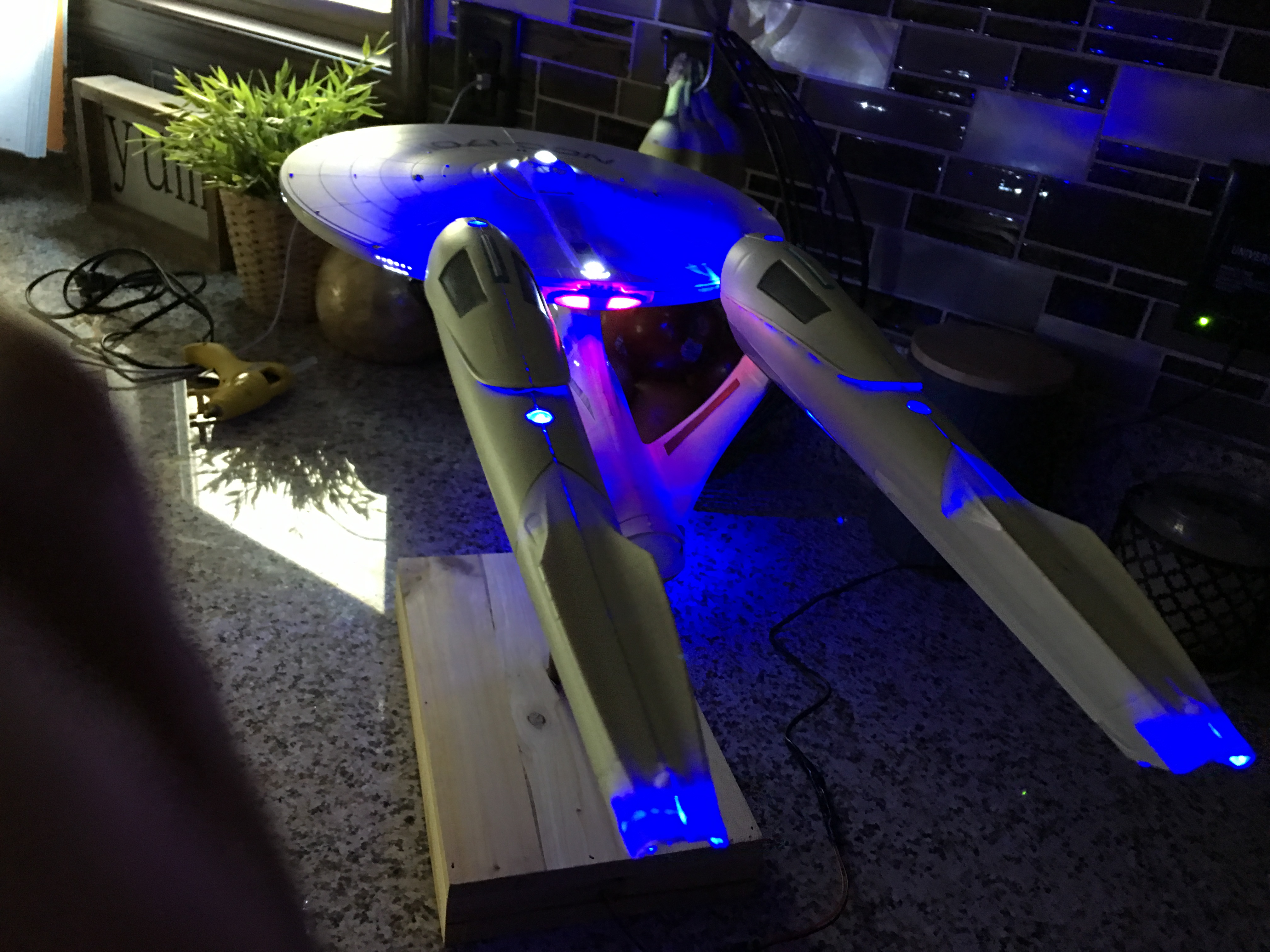

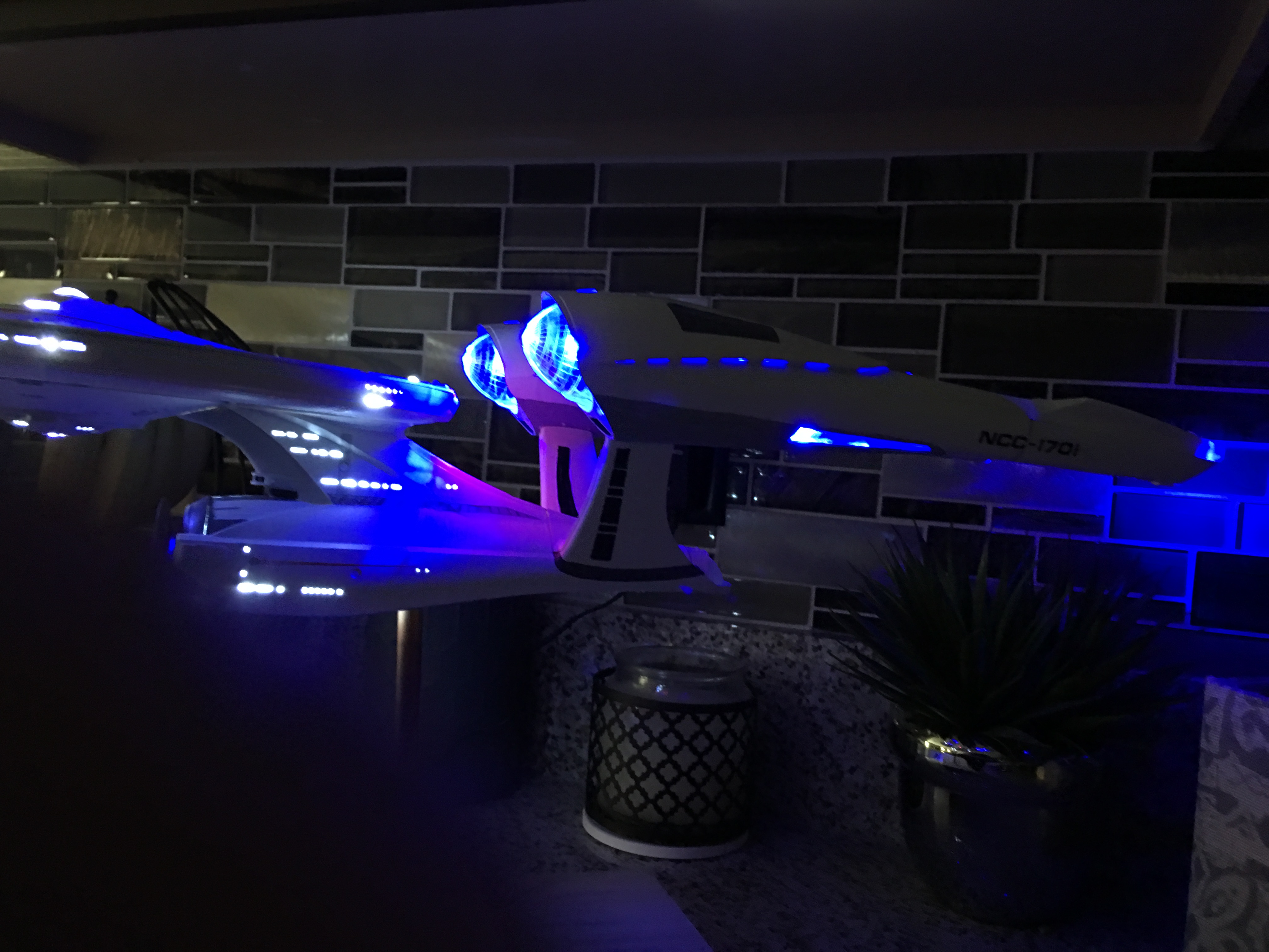

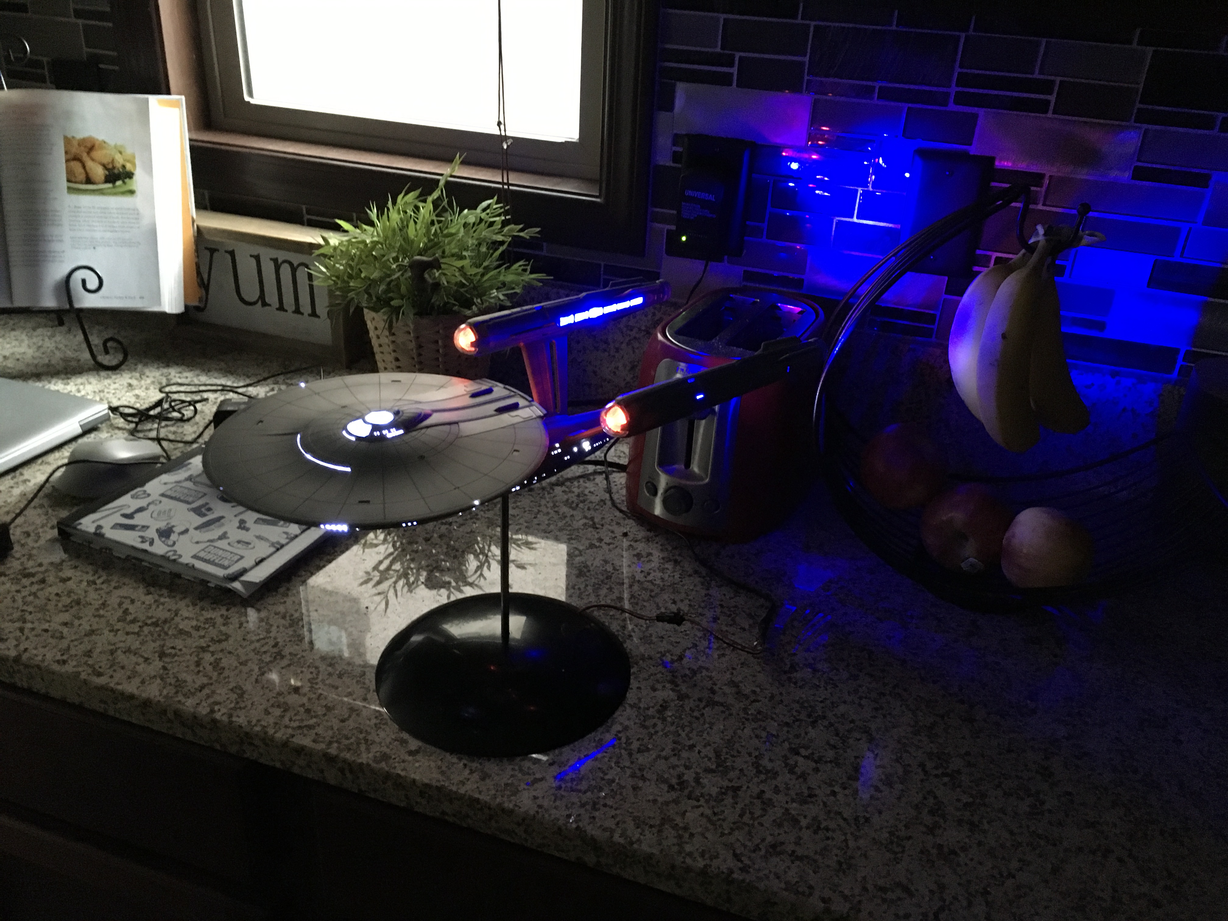

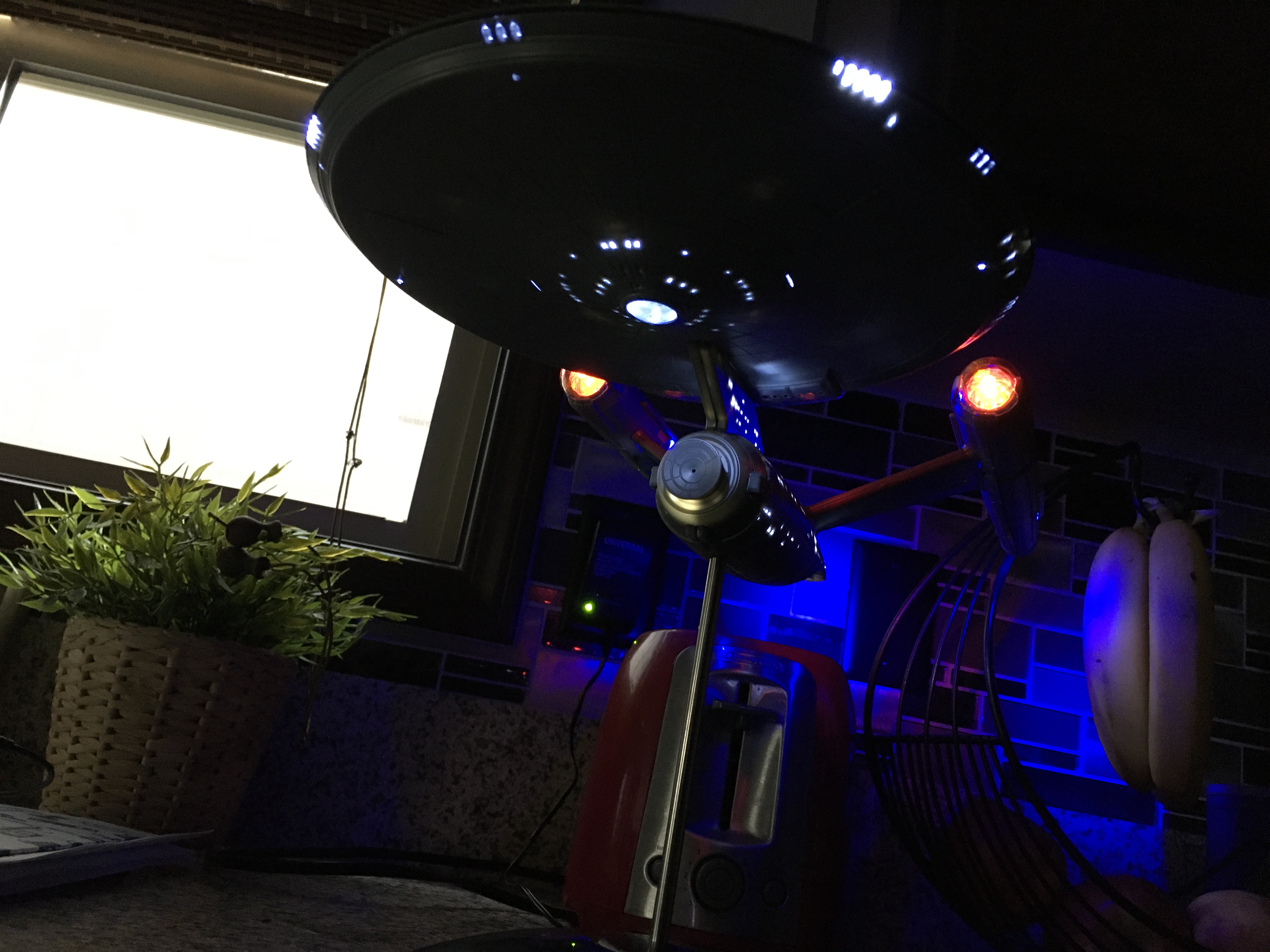

All of the lighting is done. I still have a lot of detail painting to do. Masking off behind the deflector dish to avoid the light leak. I wish you could see what I did with the bussard collectors. I used 2 millimeter LEDs, in a series rotating between red and yellow. It really gave off a nice effect, but in the picture it looks solid amber. In real life you can see both yellow and red burning separately as well as mixing together. I used different voltages on the resistors so that the lights will burn at different levels. I wouldn’t think that everybody in their cabins had all their lights on at the same saturation point. I’d like to have some windows dimmer than others in my models.
Not done, but the biggest task is over.
