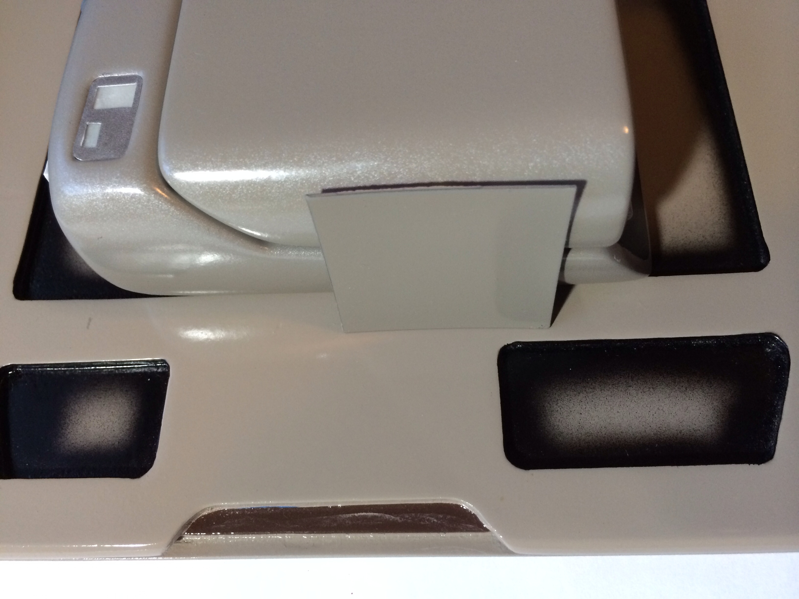

Here is a production made and partially finished Voyager PADD in a later “dove gray” (painted at time of production). The styrene square is painted in Castle Rock, as is the tricorder (2014ish).
Krylon Classic Gray is near dead on for Krylon Dove Gray from the time of early TNG. The photo below shows a marker tool painted a few years ago in Classic Gray compared to the screen used early TNG medkit and it’s very close. The medkit itself is shown matched to a sample of vintage Krylon Dove Gray, upper right. The Voyager PADD is the same as shown above.
Krylon Stone Gray works too but is a few shades darker.
A quick disclaimer that there were many different shades of dove grey used over the course of the production of the three TNG era shows; as the props were built, paint colors varied depending on what brands and colors were available in local stores, which prop companies built the props, and as paint formulations changed over the years... the Voyager color above is an example.
