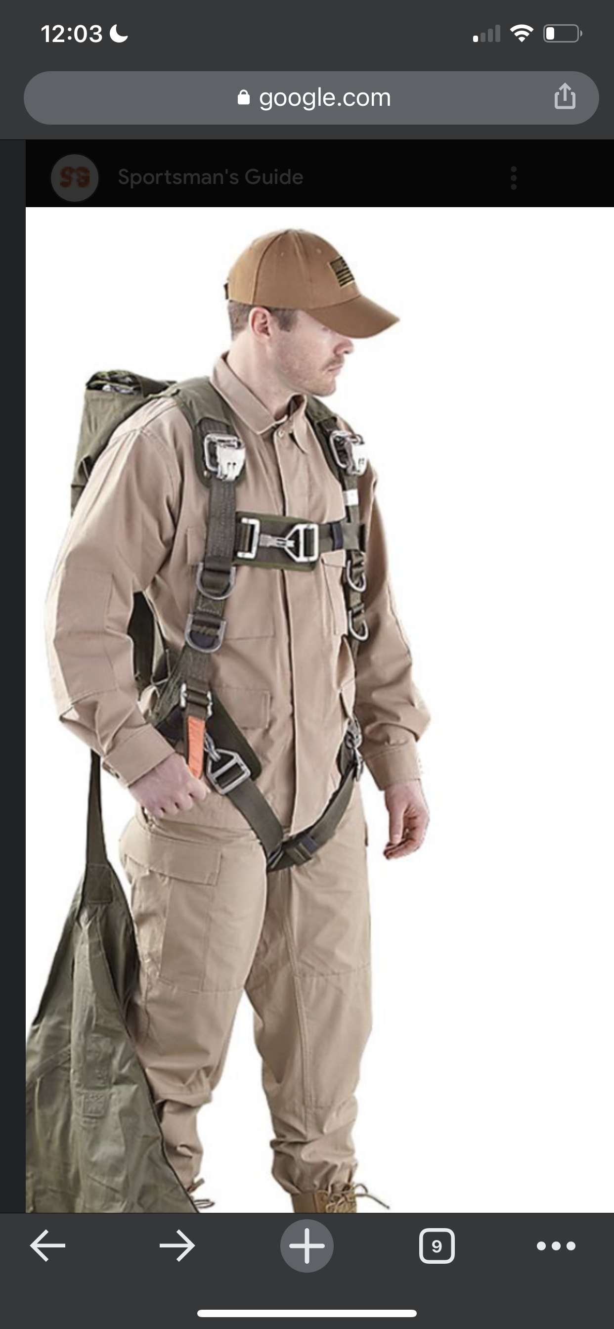

Okay working theory around the harness he wears is that it’s a British MK1 para-harness, this version I found looks VERY close aside from the buckling around the legs may be different.
Food for thought: the harness could also be an American parachute assembly (MC-1 or T-10) - but its hard to tell, they appear to have cut it down and reassembled it, adding or removing bits of hardware.
I think you’re right it’s not simply one harness, the top buckles on shoulder straps too spot on to reference but the bottom look totally different. Looking at different para harness there’s definitely a few American ones that look similar too.
