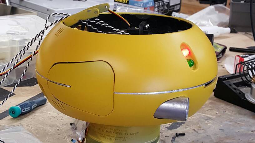

Thanks for all of the compliments!! I am making another one now, that is much better, for someone. I am perfecting my design and hope to have my files available in August along with plenty of reference photos for you guys. Here is the new one..

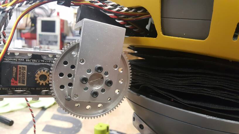

Sorry guys for the delays updating here! I have been busy with other projects but have also been building a second more accurate Weebo. This has given me the opportunity to take more photos and have been trying to make a somewhat of a guide for you guys. I will be putting all of the files up on my site including STLs, Audio, Video and all my reference photos. Give me a few more weeks and it will all be available to you guys.
Now some new things I have finished on this second one is more accurate dimensions thanks to Adam sending me reference photos. He was also kind enough to send me a couple original castings of the Eye lens and the 3 Engine Jets. I went ahead on my new design and remodeled the Lower Jets based on Adam's parts. So now the 3 lower jets are more accurate and have been given servos to make them move. It has turned out awesome! I also added a working 12v light to Weebos flashlight. I used a pinball lamp instead of a LED because I feel that is more accurate. Here is a couple of videos.

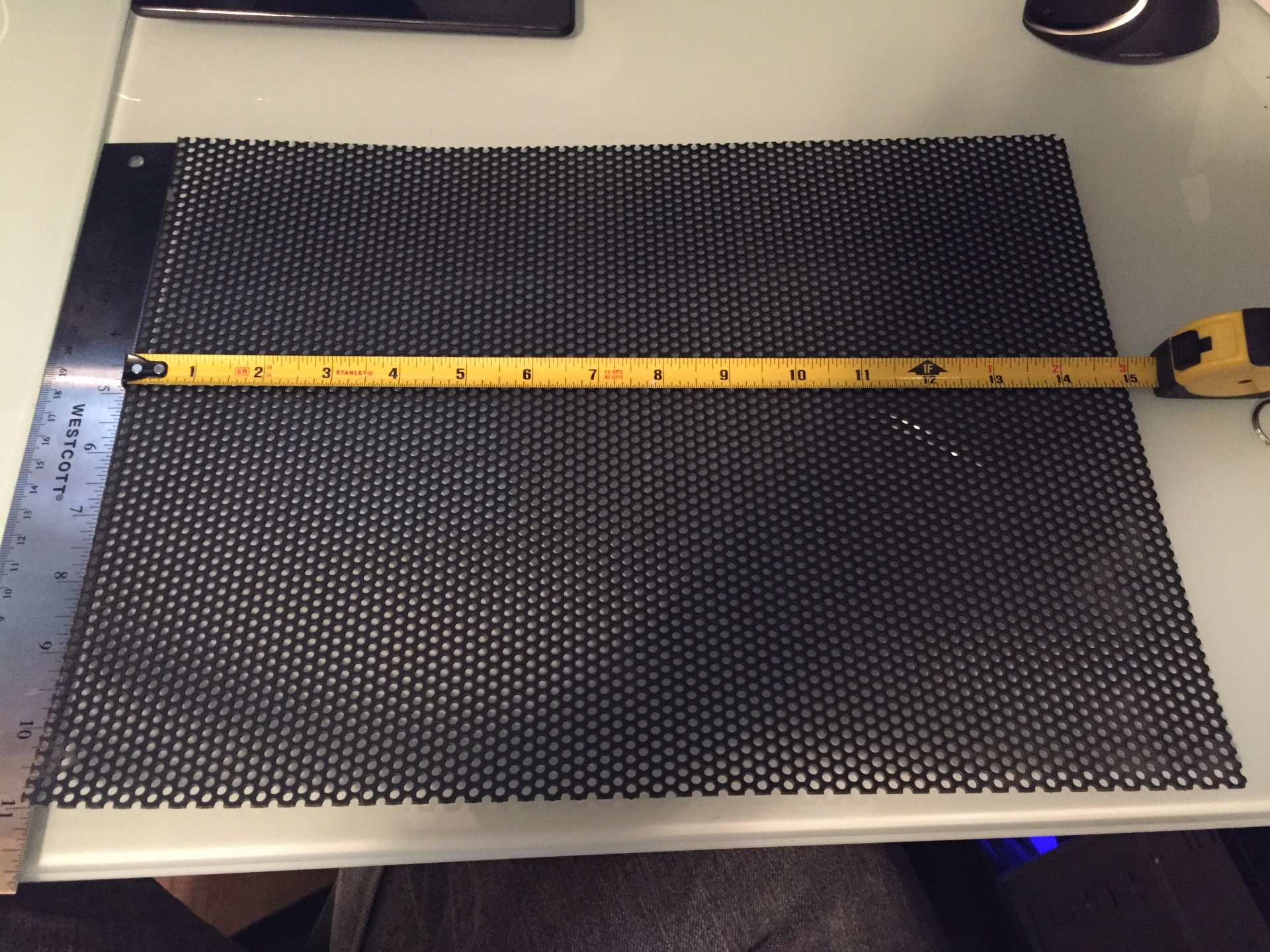

It looks like you using the rear vent for part of the animatronics. But if you need, I may have a sheet of the plastic perforated mesh which resides there. After looking at Adam's photos I am almost sure it's the correct stuff.
I'd like to see what you have. I made a 3d printed mesh but ended up leaving it out as all of my mounting and cables ran through that vent.

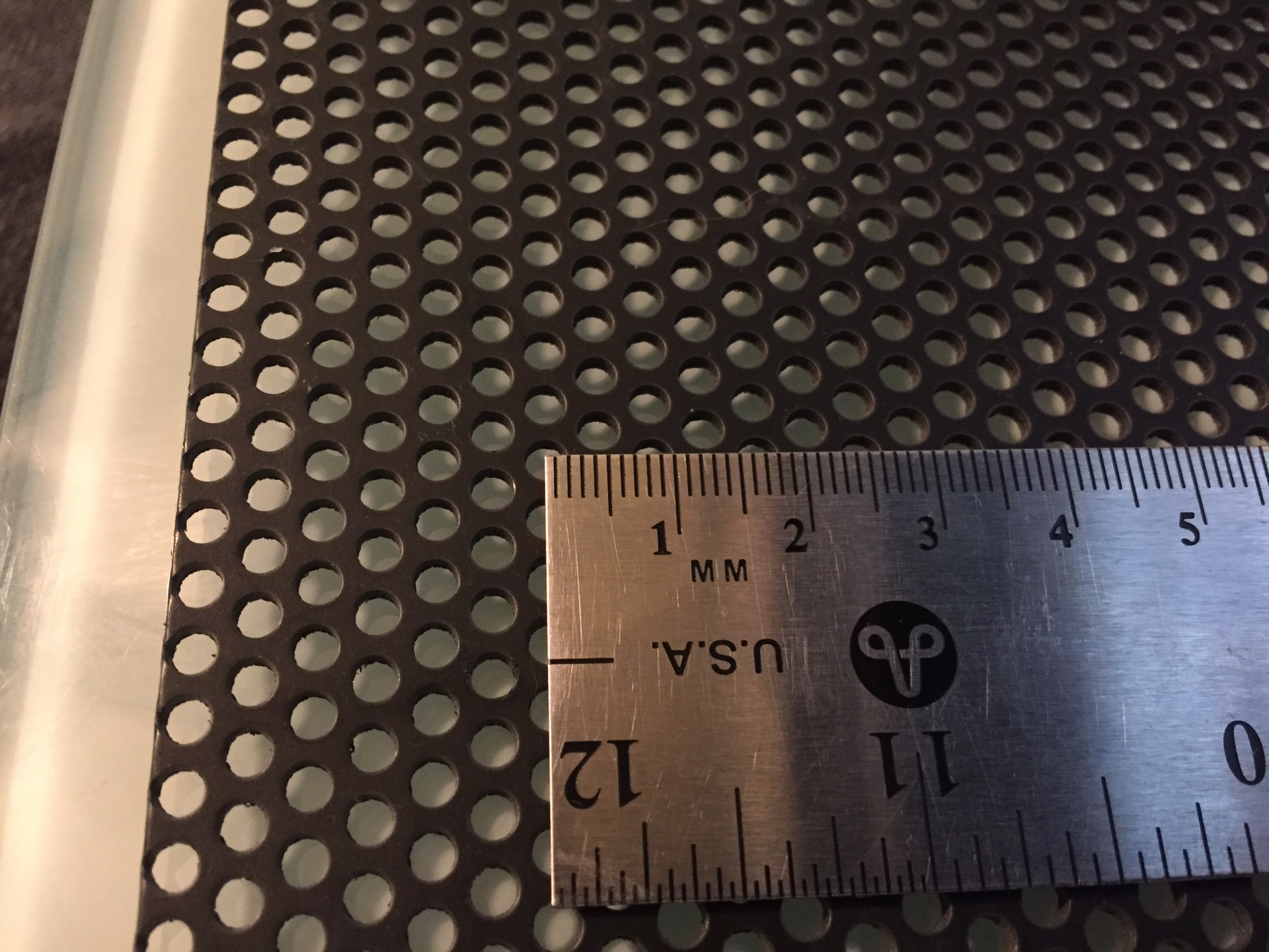

I have one complete sheet left, it is 15x11". The holes are 1/8" on either 3/16" or 5mm spacing. The plastic is soft and flexible and can be cut by scissors.
I don't remember where I got it exactly, it may have been American Science and Surplus. I used it all over on my Radioactive Ammo PC, so the sheet has been sitting in my bin of materials for a decade. (Had to clear quite a bit of dust off to take the photos :D ).
As a fellow functional prop enthusiast, how about this: Half the sheet for (7.5x11") for just the price of shipping from zip code 78613. Or the full sheet for $10 + shipping. (You decide if I cut it down to fit a flat rate box, or use a larger box). PM me to work it out.
