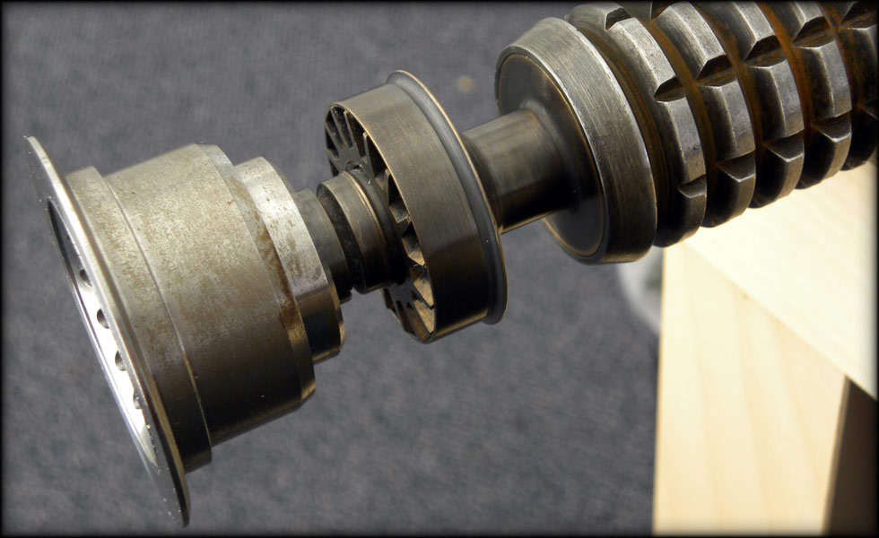

I have been working on my ANH Obi for about, 3 years now, off and on, a piece here, a piece there, but one thing I have always wondered was how to get my nice shiny brass windvane to darken up a bit.
One day last week while I was working on restoring some guns for a client, I noticed I had in the chemicals shelf among my gun bluing stuff was a small bottle of Birchwood Casey Brass Black.
Well, I chucked up my grenade and windvane into the lathe and spun it, polishing what little oxidation was already on the brass off with some 1000 grit sandpaper, until there was a nice clean shine.
Then I dunked the windvane into a shotglass full of the brass black to experiment, it came out NICE. So I polished up the fan part and set it in a seperate glass container, and it also turned out well.
Here are pics of the result, I think I will use some Birchwood Casey bluing chemical on the grenade, plus maybe some plum brown, see what I get, but I have been poking round here for a long time and I hadn't heard of anyone weathering saber parts using gunsmith chemicals.
Also, on a seperate ANM2 Booster piece (not pictured) I used Aluminum Black from the same company and got good results, but boy did it stink, meaning, BEWARE the gases coming off this if you try it. Make sure it's in a well ventilated area.
