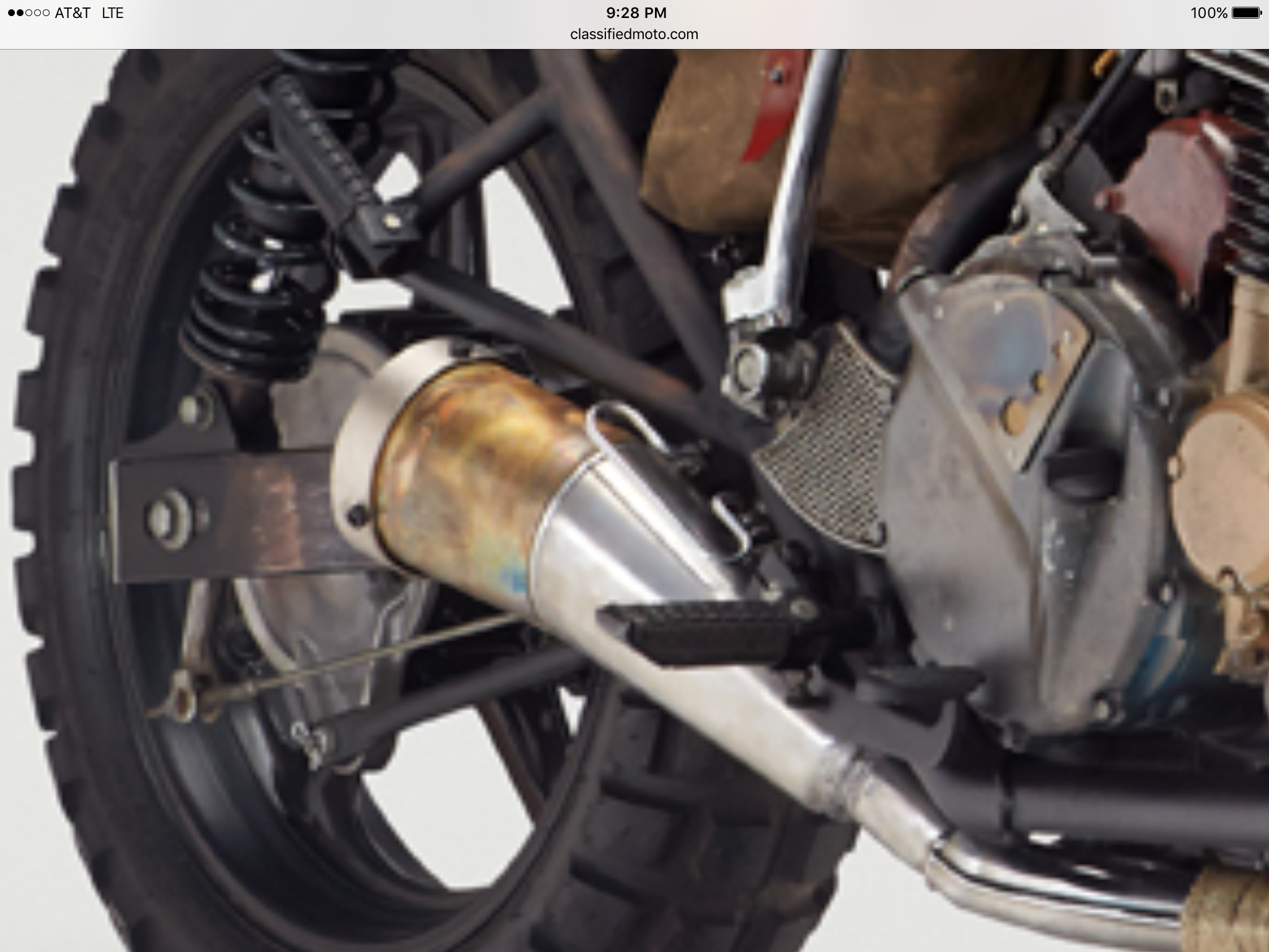

Where did you get the mesh and what's the size? Looks to me like they plated or heated the pipe before installing it but I'm not sure. As for the fender I'm almost positive it is a yamaha xv920r since they build alot of them. The pre apocalypse bike has a xs650 fender. I used the 920r and it looks dead on. As for the dye on seat I'm not sure, and I can't find Roy. He Is not at the shop he used to be at. For the hockey tape coloring I saw a YouTube video using shoe Polish that looks very close to theirs, that's what I'll try. I'll post up pics in the next few days of how it looks.
IMG_0303.PNGSo looking at the exhaust there is a very definitive ridge where the patina starts. I'm thinking the wrapped a piece of sheet metal around it that was distressed using vinegar like the tank. Then wrapped and attached the mesh and slid it over the end of the pipe. That ridge is what made me think there has to be something there more than just the mesh. What do you guys think? I may try this weekend minus the mesh since I don't have it yet

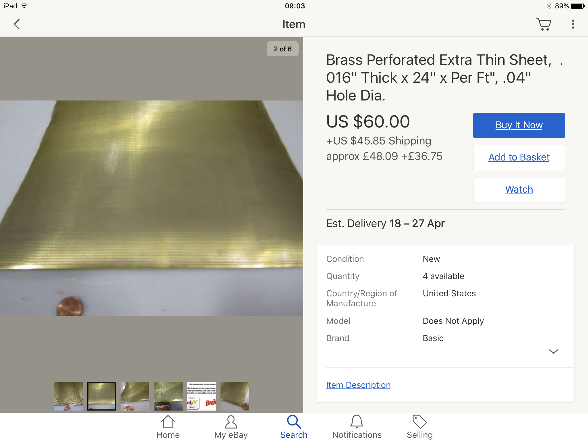

MustangMike88. I think the detail on the exhaust is very thin, very small hole punched as opposed to woven - brass sheet. Then heated with a gas welder to get the coloured effect. I used this on a project at college years ago and it looks exactly the same. I got mine from a metal scrap yard. Not sure what the application would be for, maybe sieving or straining something? But definitely looks the same from close ups
Make sure that brass isn't the one that is "wafered" I picked up a sheet that I thought was solid brass and it turned out to be two sheets of brass sandwiching a piece of perf board. Trying to bend it as a curve caused it to snap.

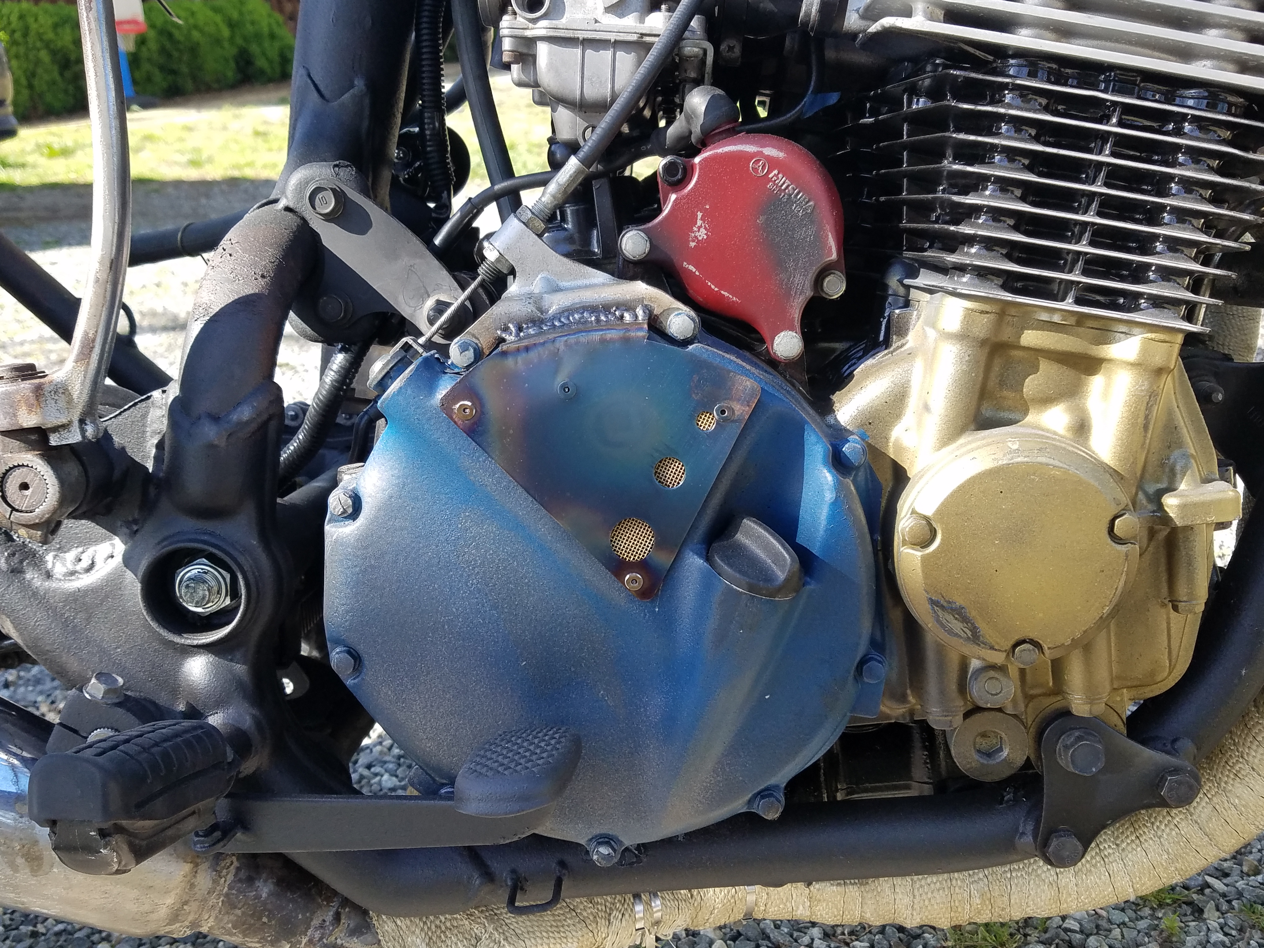

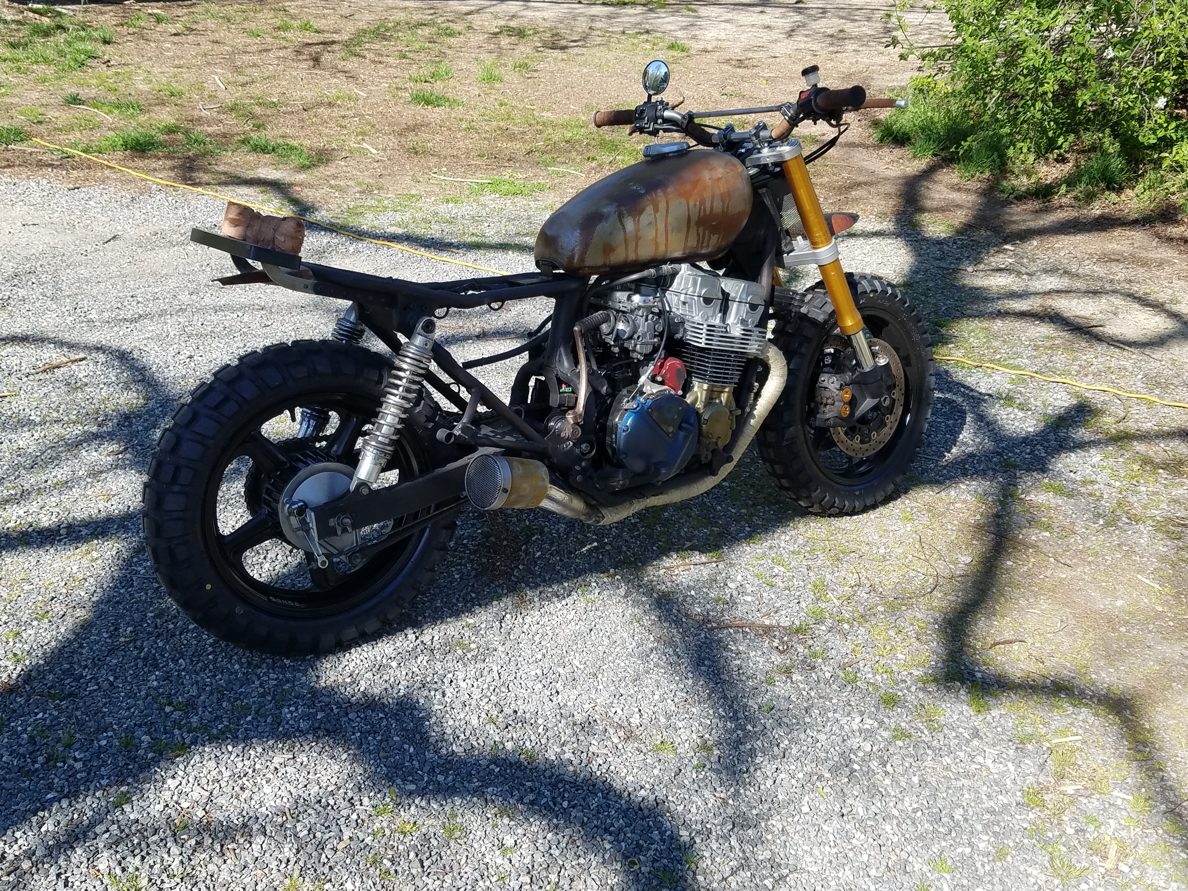

Got the patch in the tank welded on. Took quite a while to scale up from the various shots of the bike. I still need to inspect the tank on the inside to make sure I didnt burn through anywhere creating a hole.
Also got the exhaust cut. 5" from the weld line seems to be the magic spot. Literally the exact amount of space to cut the baffling out.
Looks great! I cut mine at 5 inches also. Got my exhaust done this weekend and finally got it running. Sounds awesome. The brass mesh looked pretty much spot on when you heat it lightly. I'll post up some pics

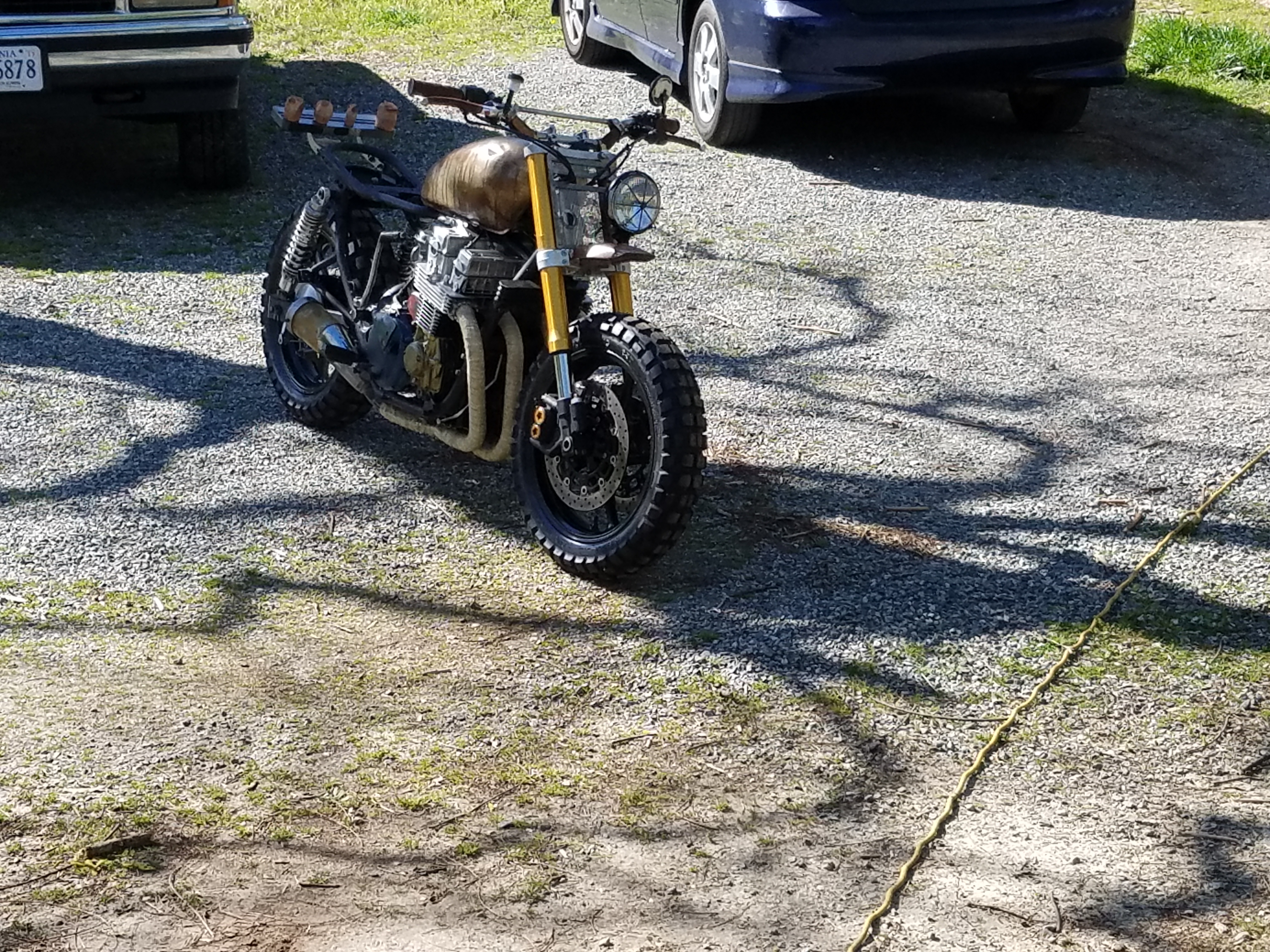

Just a useful tip when mounting the tank. I had to mount with petcocks on and both coils mounted under the tank. If the rear of the tank is mounted at the right height it will also clear the coils.
Thanks for the info, I mounted mine with levers out. Just seems easier for everyday use. So I went to a local foam distributor this weekend and found out some info on Roy Baird. Supposedly he was the best around here, but the guy just up and vanished. Moved out of the state and no one knows where he went lol. So he's out of the question for wrapping the seat.
