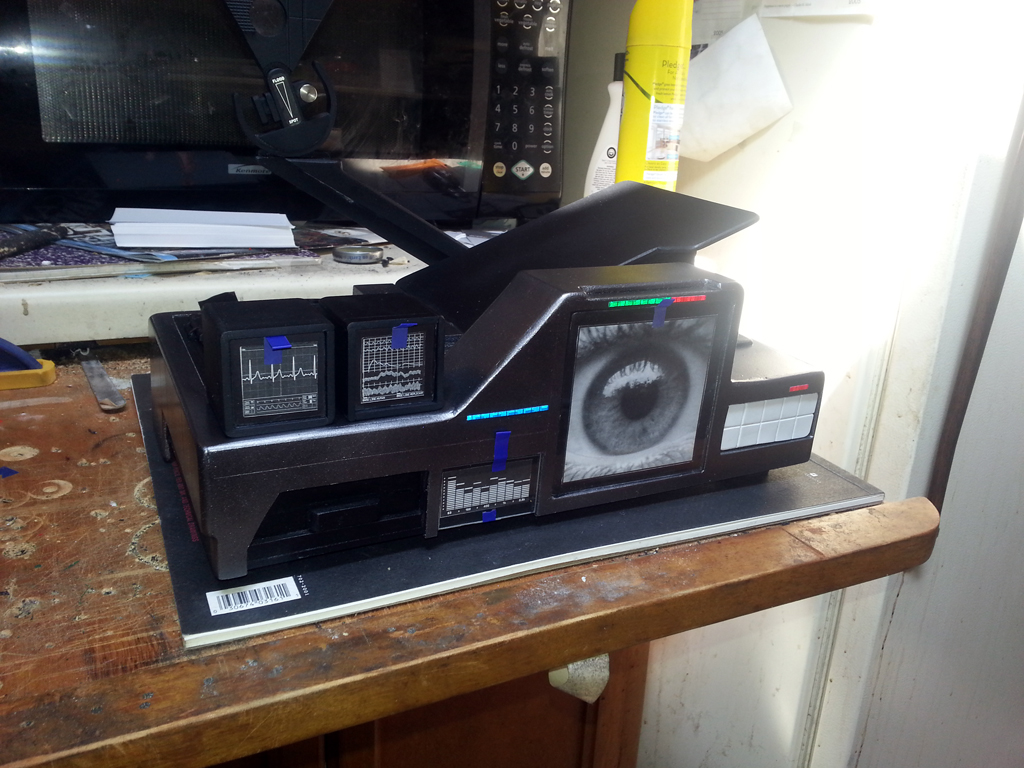

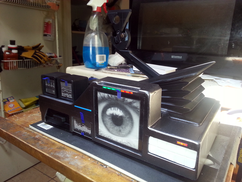

The only thing that still remains to be done is to rework the monitor graphics into color versions and install the monitor glass. If I had it to do over again, there's probably about a hundred different things I'd do differently, but overall I enjoyed the challenges presented by this build. I'll post better photos once I've finished fully, but in the mean time here are a few snaps of the model in its current state. Thanks for looking.
