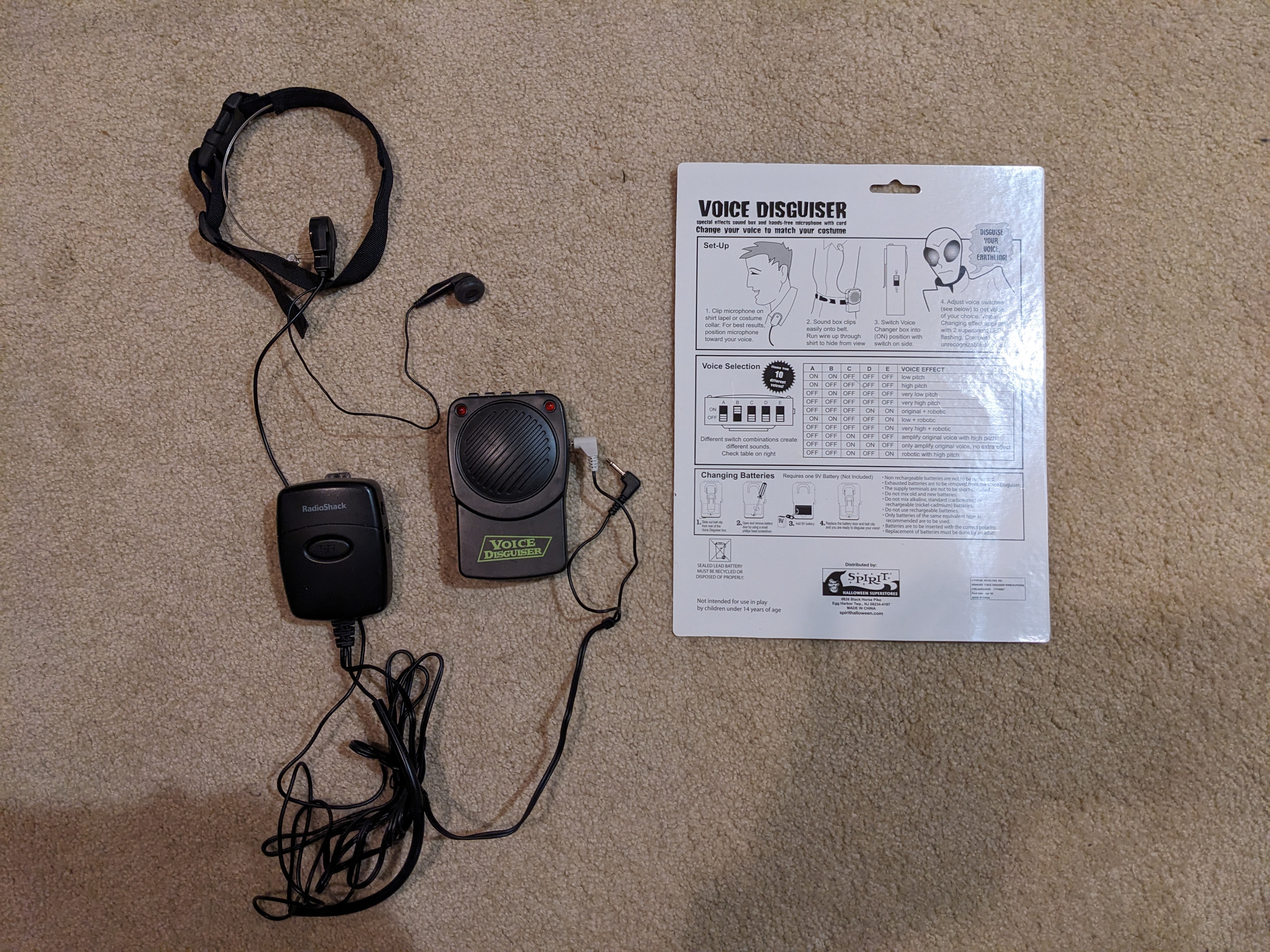

So, if I have this right...
Transdermal mike connects to voice changer, which connects to speaker?
If so, I could probably buy this setup for about 60 bucks, depending. Much more doable than I thought.
I dug out the setup so it is easier to understand.
Top left is the mic and neck band.
The box that says RadioShack is the VOX controller with PTT option.
Microphone out goes to the voice changer.
Earpiece is not needed, so it gets tucked in the neck band. Black plug is audio in for earpiece and is not used.

Ah, that one is very different than the changers I've been seeing. I haven't seen any like that at all.
Still, I think it would be easy to add a speaker to one of the ones I have seen. And it would be no more bulky than your setup, as rhe throat mikes I looked at have a built in switch for PTT or VOX.
