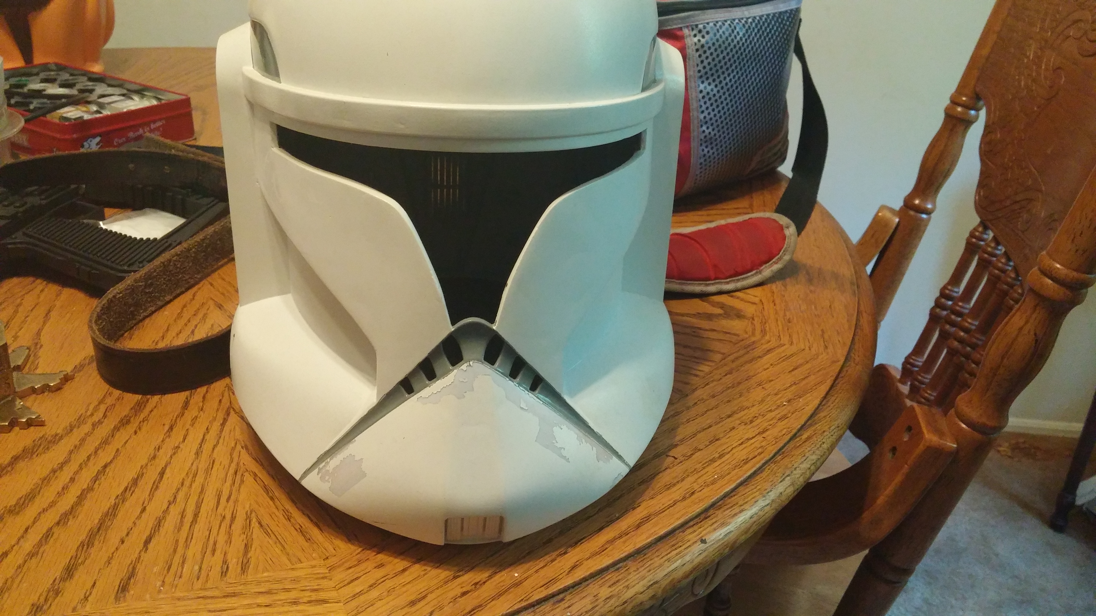

I did this mod a couple years ago and for the life of me, I cannot get the paint to stick. I've tried all different kinds. the only thing I haven't tried was airbrushing it. Did you do anything special?20150919_140054[1].jpg
for the helmet I modified some years ago and also for a rubies stormtrooper bucket, which is also supposed to be made out of PVC, I used some normal plastic primer for cars in a rattle can. than a coat with acrylic filler and the normal filler to fill all the slits. worked pretty well in my case, there were absolutely no problems and the color look good till now.

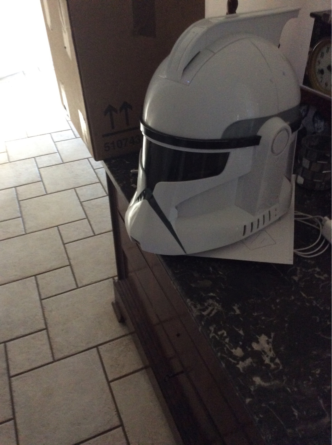

That's weird all my pictures from 2012 have disappeared?
the visor template I drew is a somewhere a couple of Laptops & IPads back
I'll see if I've got it saved anywhere on my external hardrive & re post it
thought it would be safe on here :lol
