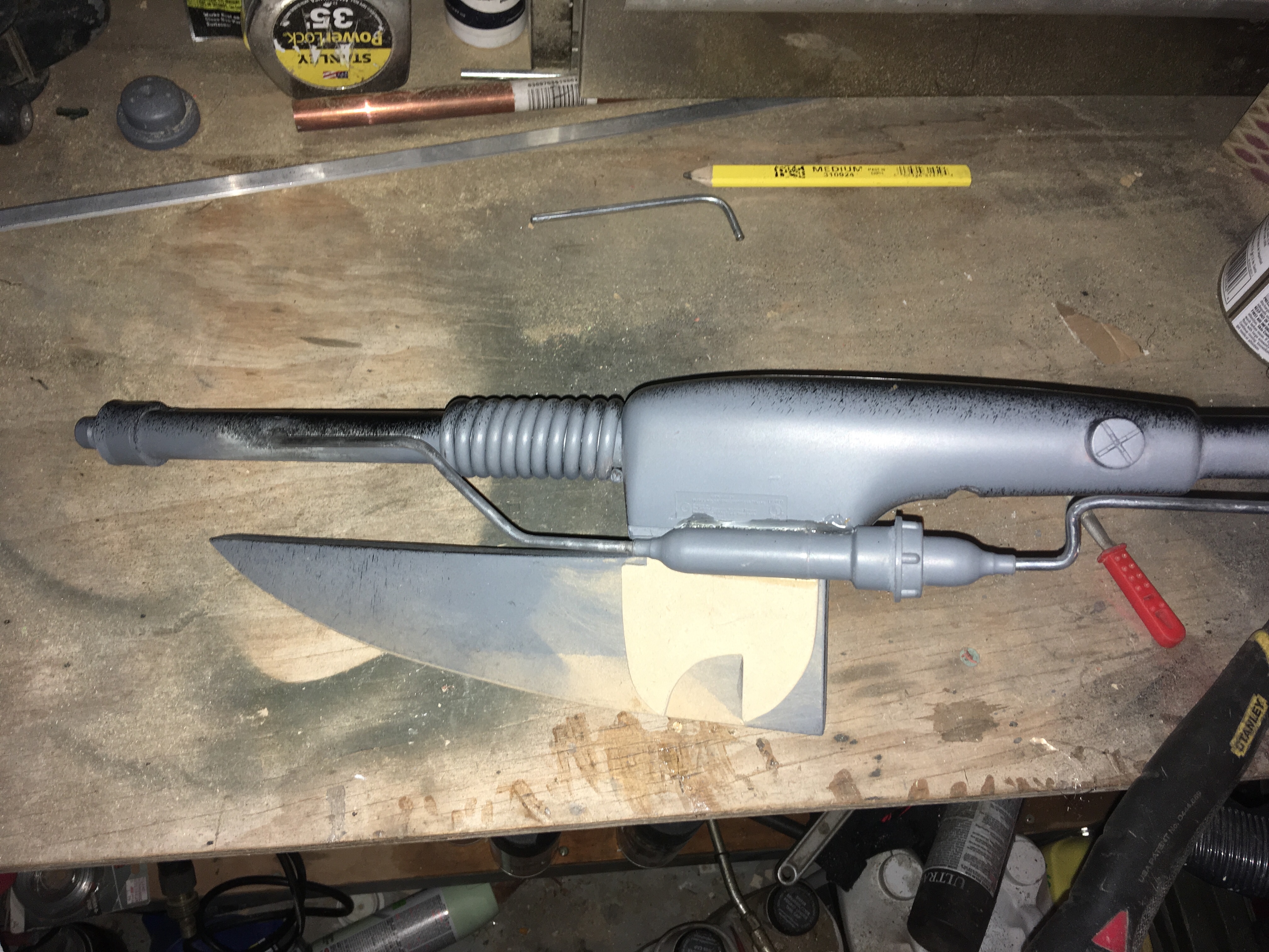

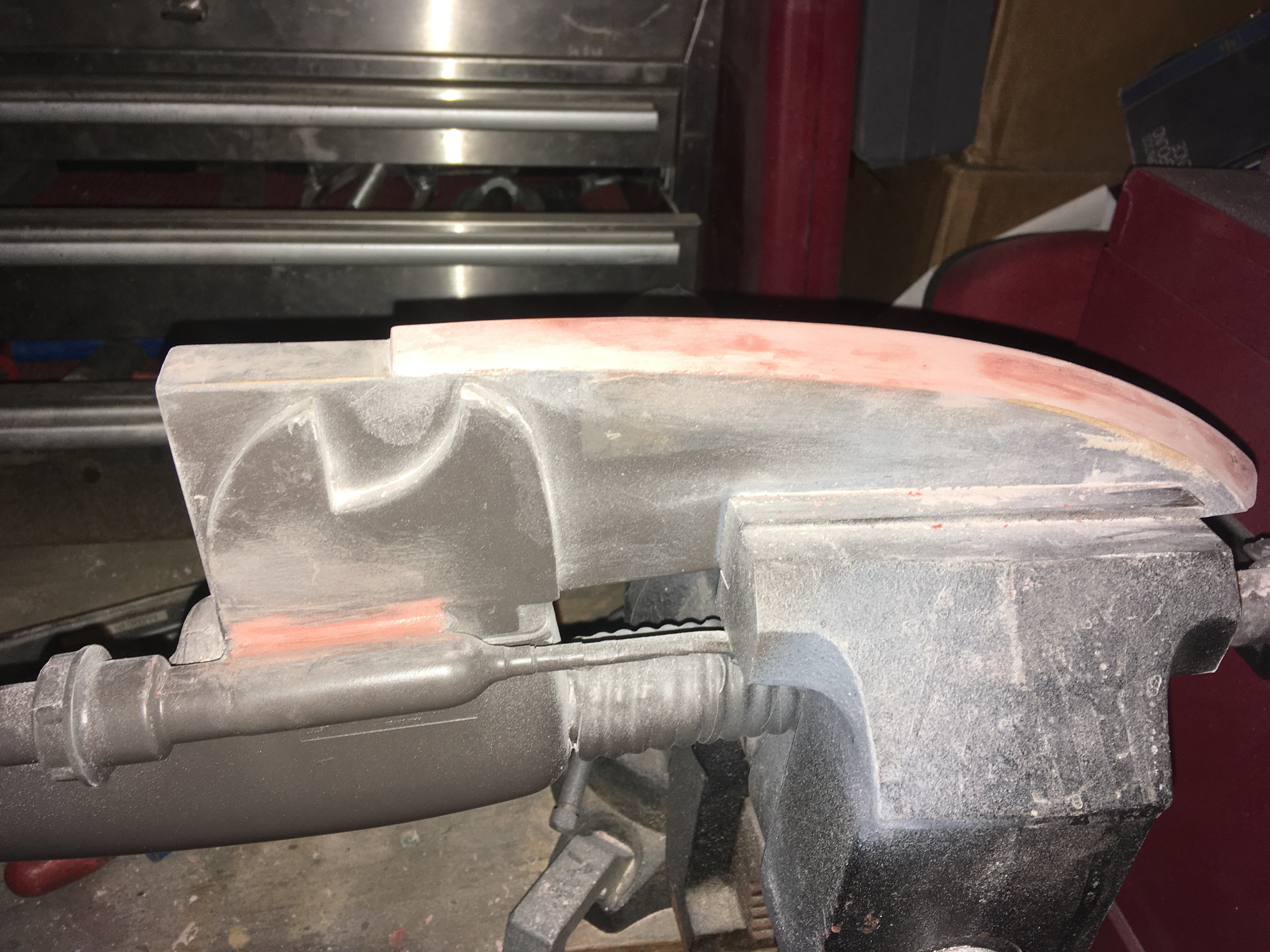

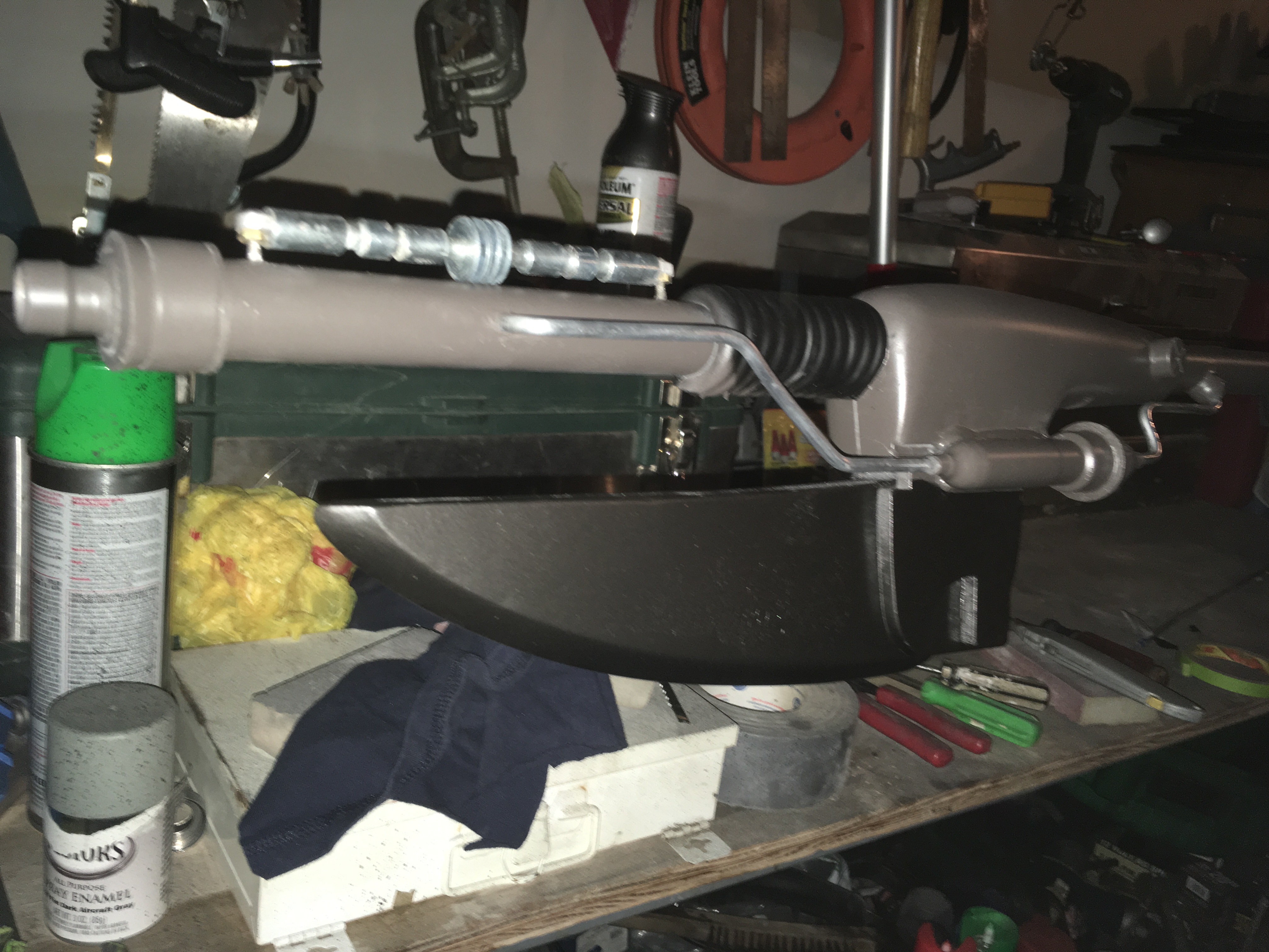

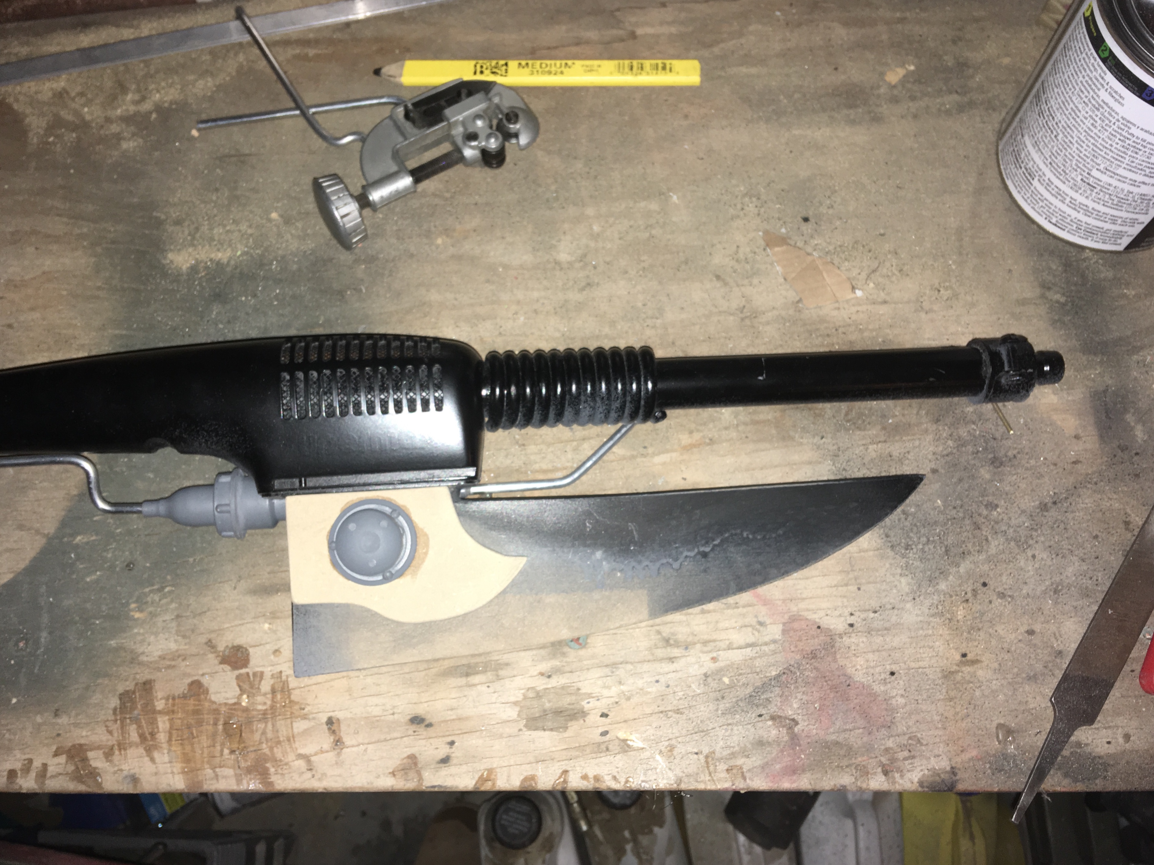

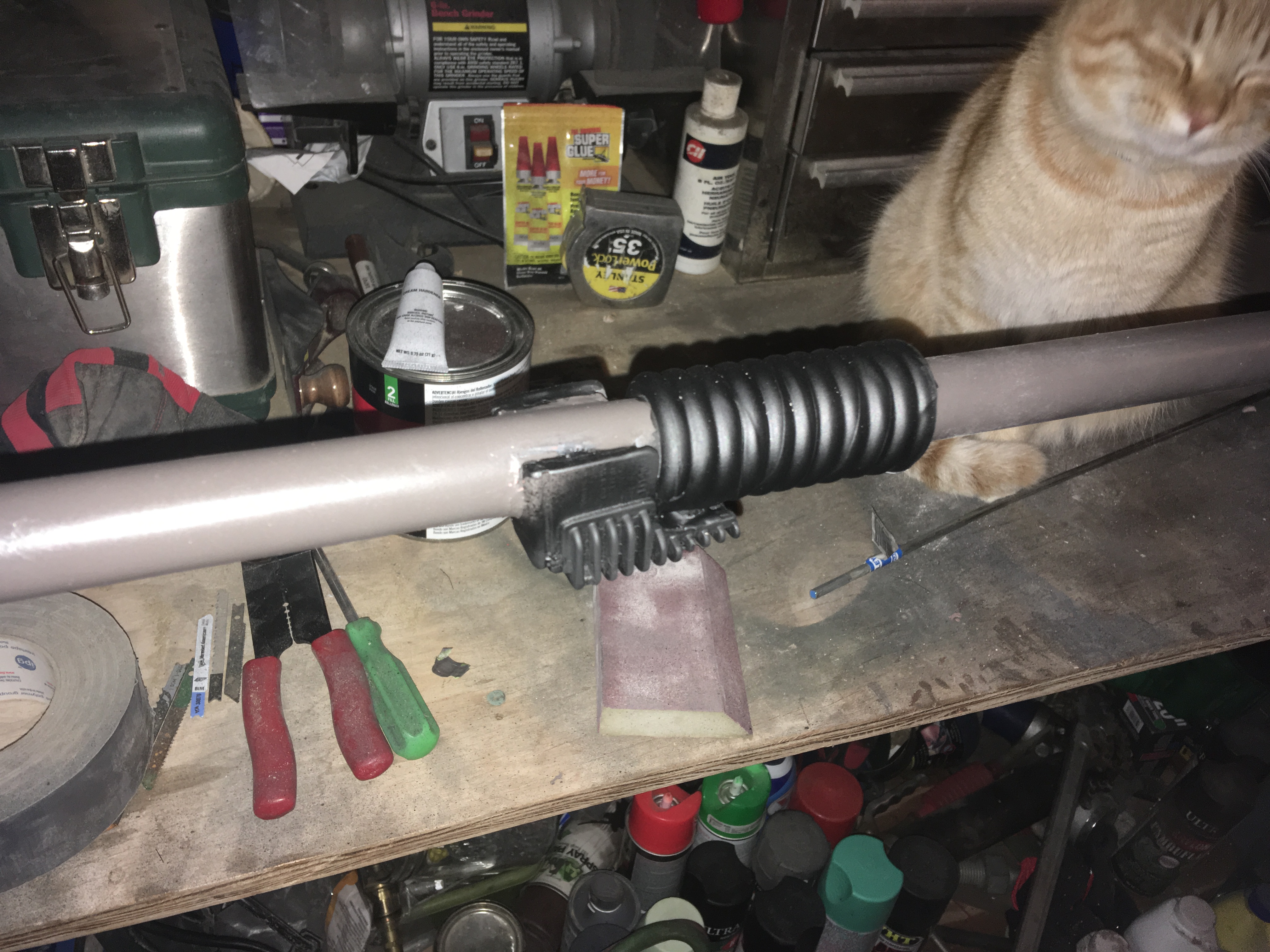

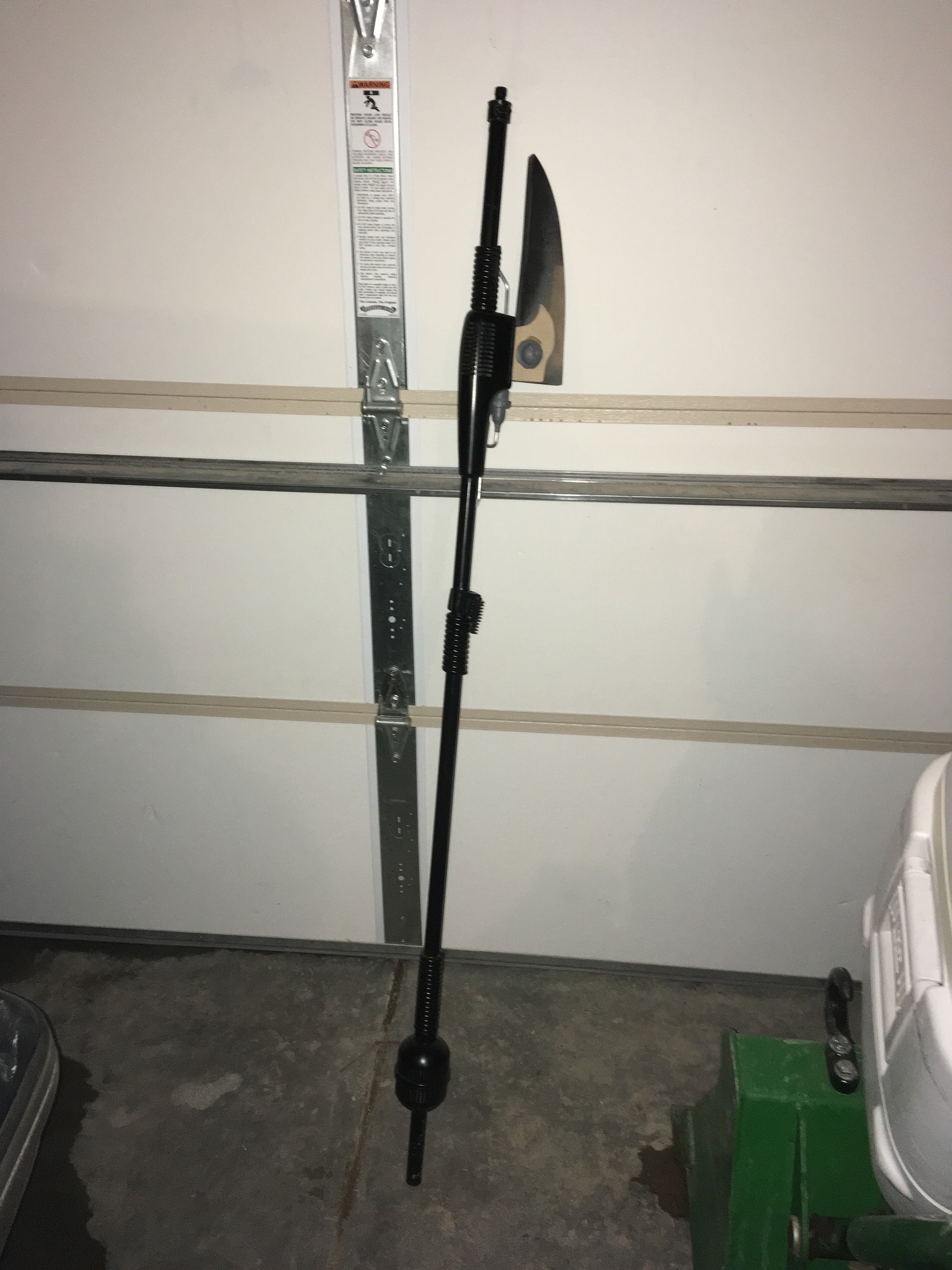

I’m currently working on a vibro axe and thought I’d share the build process I used. It’s not 100% accurate but it’s close enough for now. It still has a ways to go but I’m happy so far. Next is the blade edge that I’m going to make with bondo. I used the following,
-3/4” EMT conduit
-correct Gillette Super Max dryer
-real Soft Flo Soaker
-orange Han blaster part
-homemade Yamaha part
-homemade X bolt
-Co2 canisters
-modified modern Danco boot and Lasco dishwasher adapter
-homemade Vader rod
3/4” and 1/4” MDF for the blade

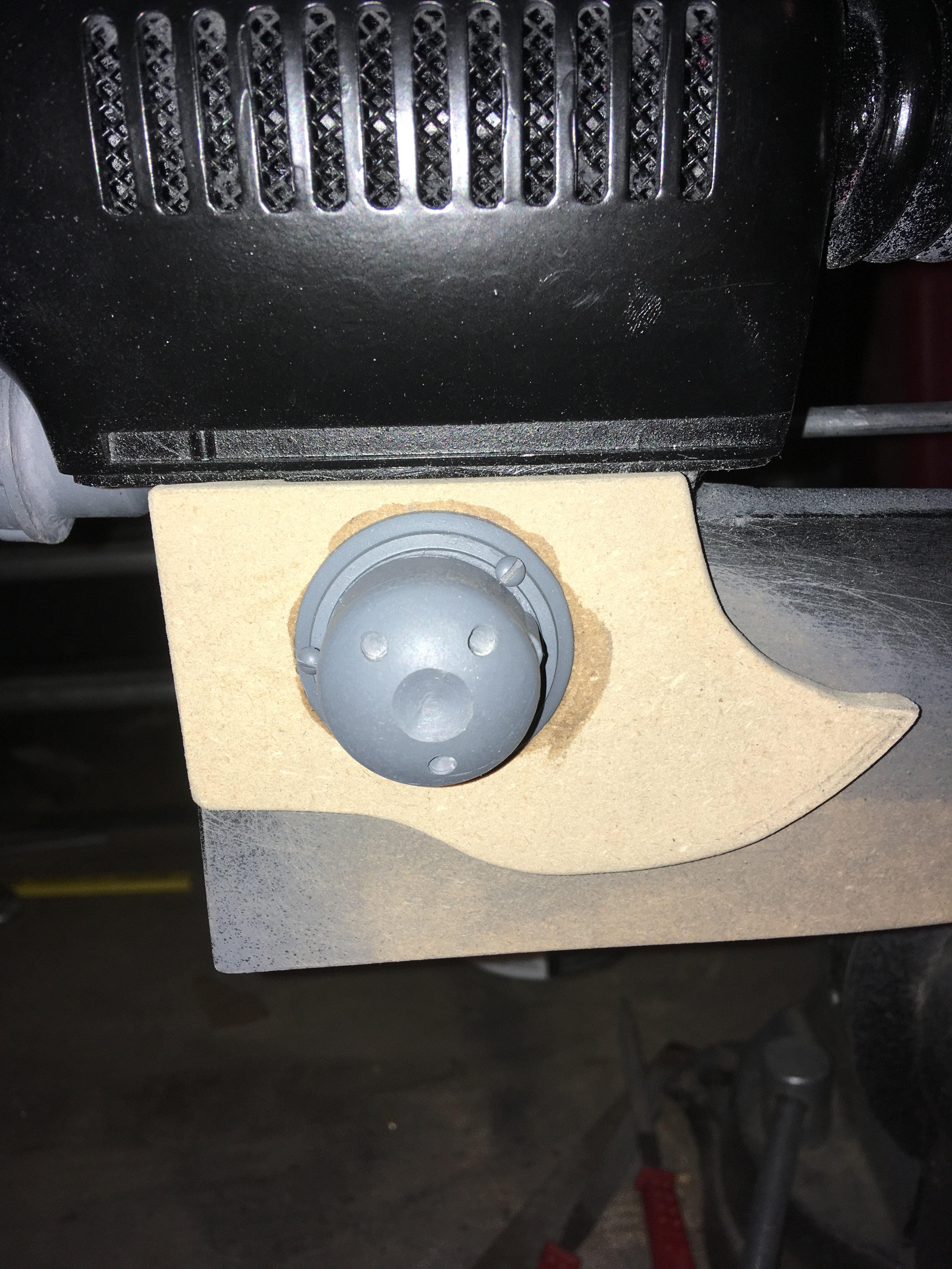

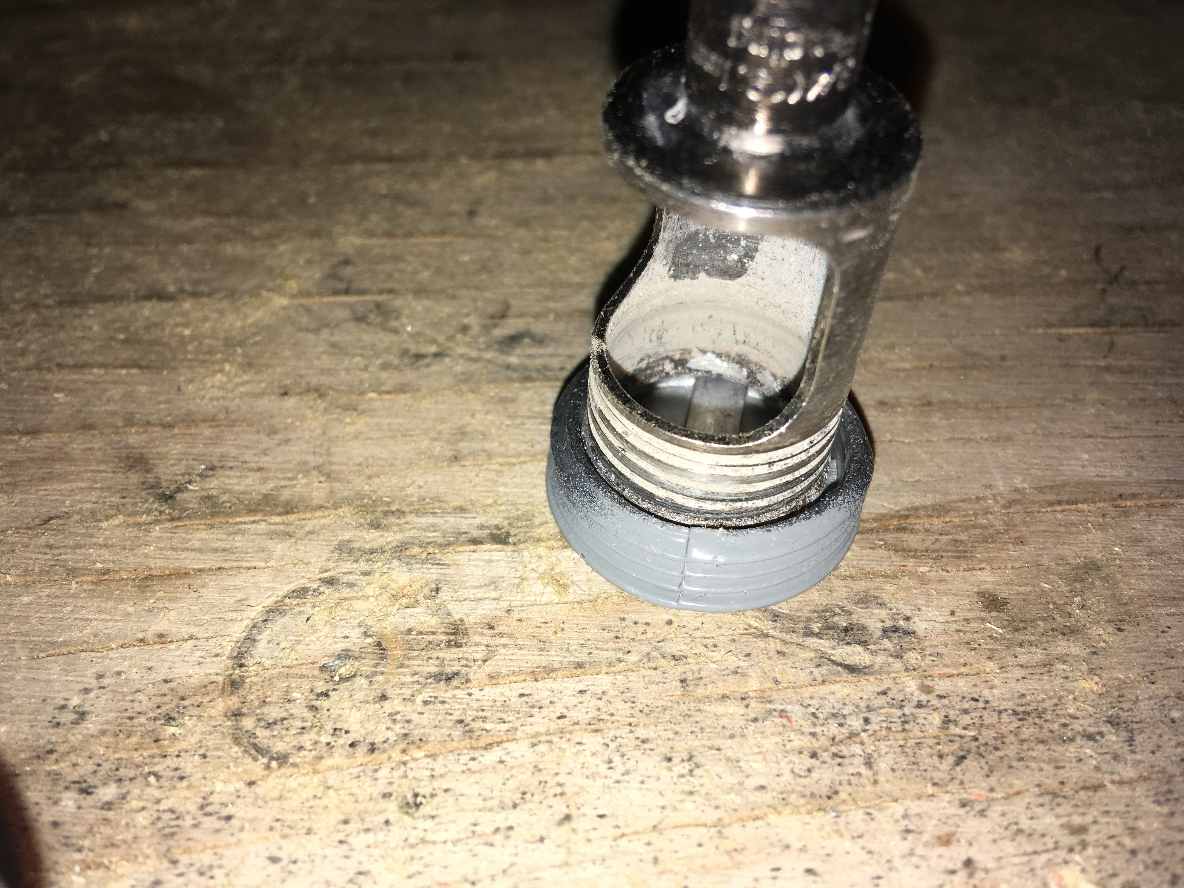

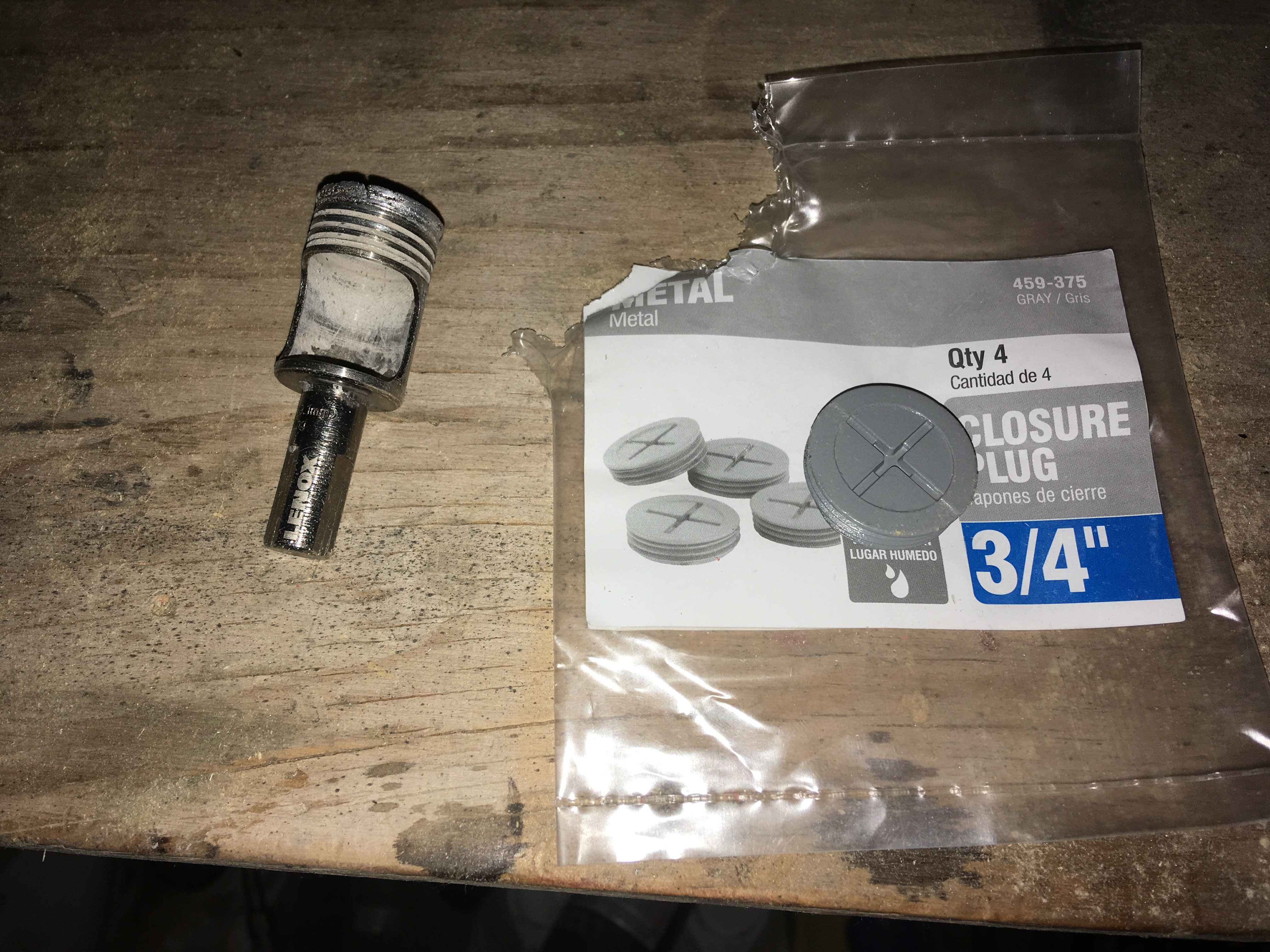

There’s probably a better way to make the x bolt but I used a 3/4” closure plug. I cut out the inside with a 3/4” tile drill bit and glued the cut out piece to a piece of 1/2” copper pipe. The copper came off of a 3/4” to 1/2” reducer. It wouldn’t fit in regular 1/2” pipe but the reducer worked great.
Love this build and this prop in general!
I look forward to seeing how it all turns out.

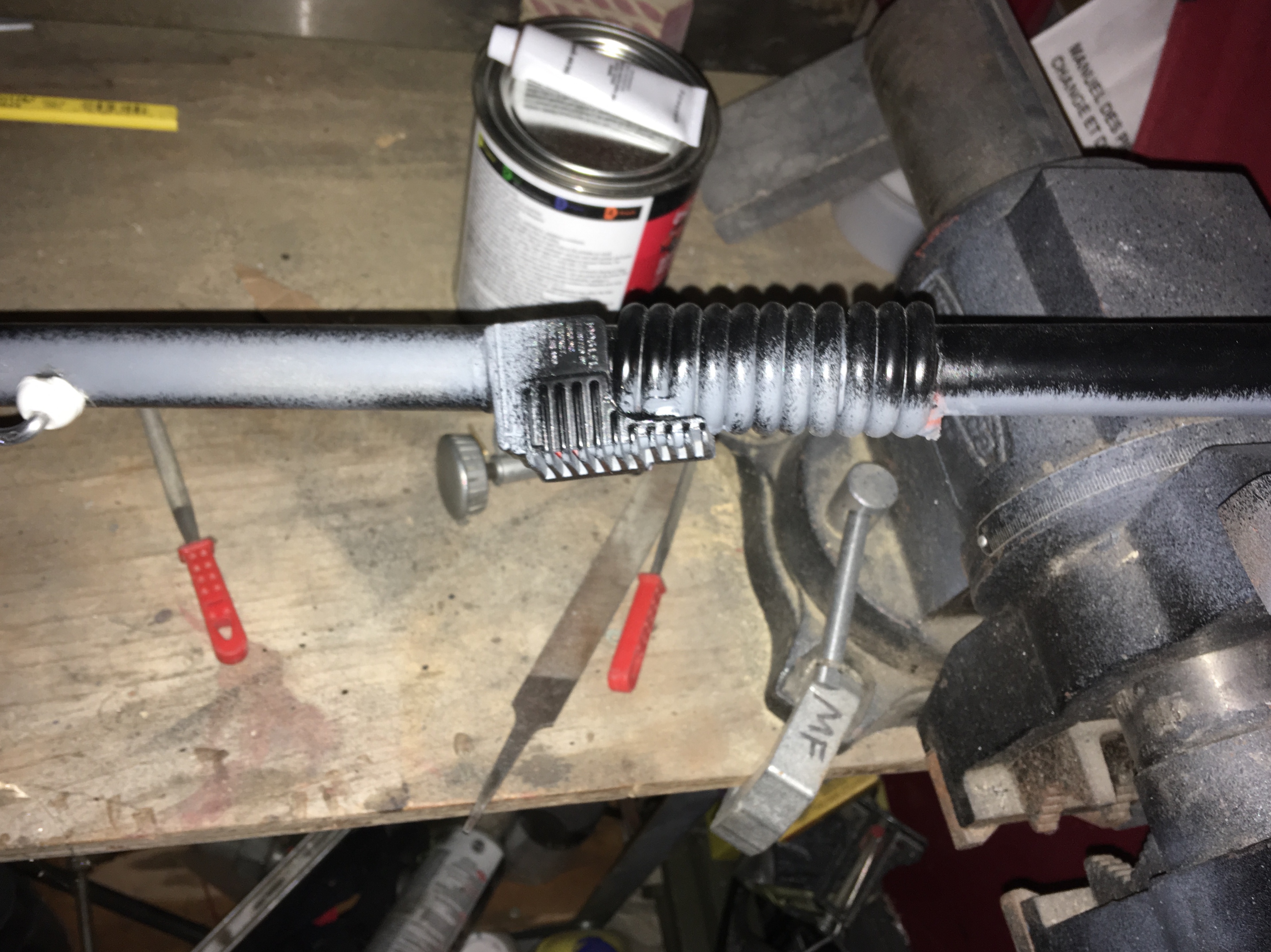

Thanks everyone. I found the hair dryer for $1 at a thrift store years ago. I put it on hold because I couldn’t find the right soaker but I got one on eBay last month. I still need to find the Yamaha part. I made mine out of sanded down 1/2” pvc cap, plastic disc and a couple of screws.

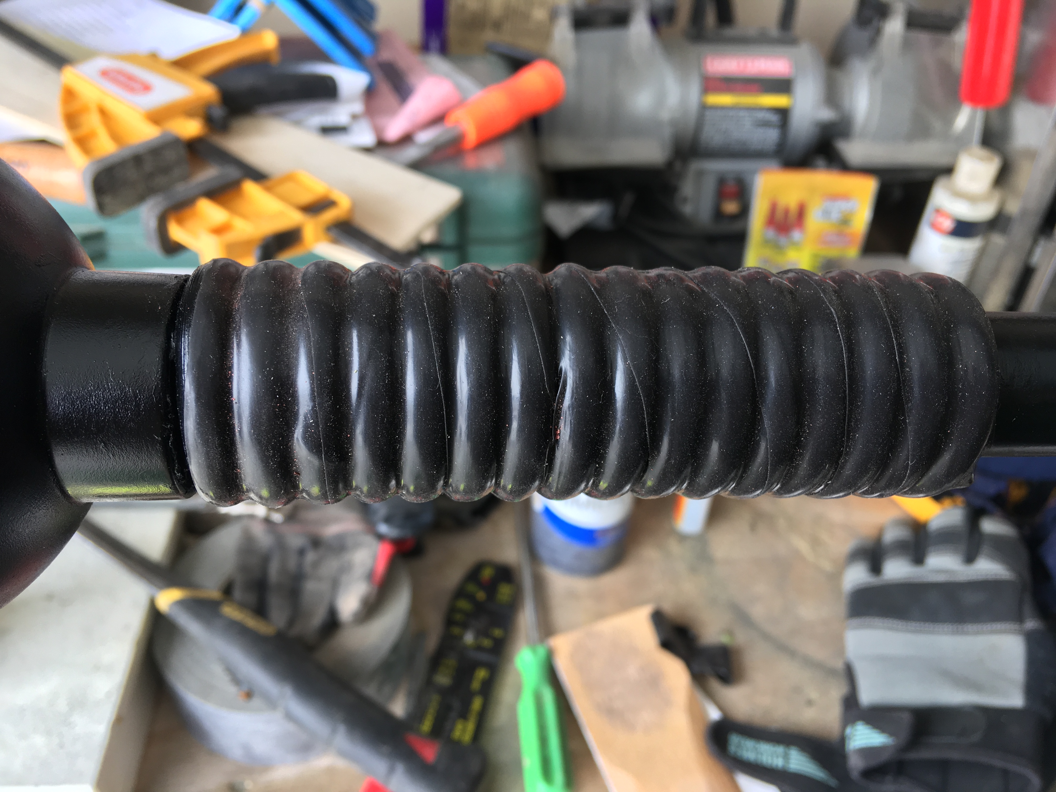

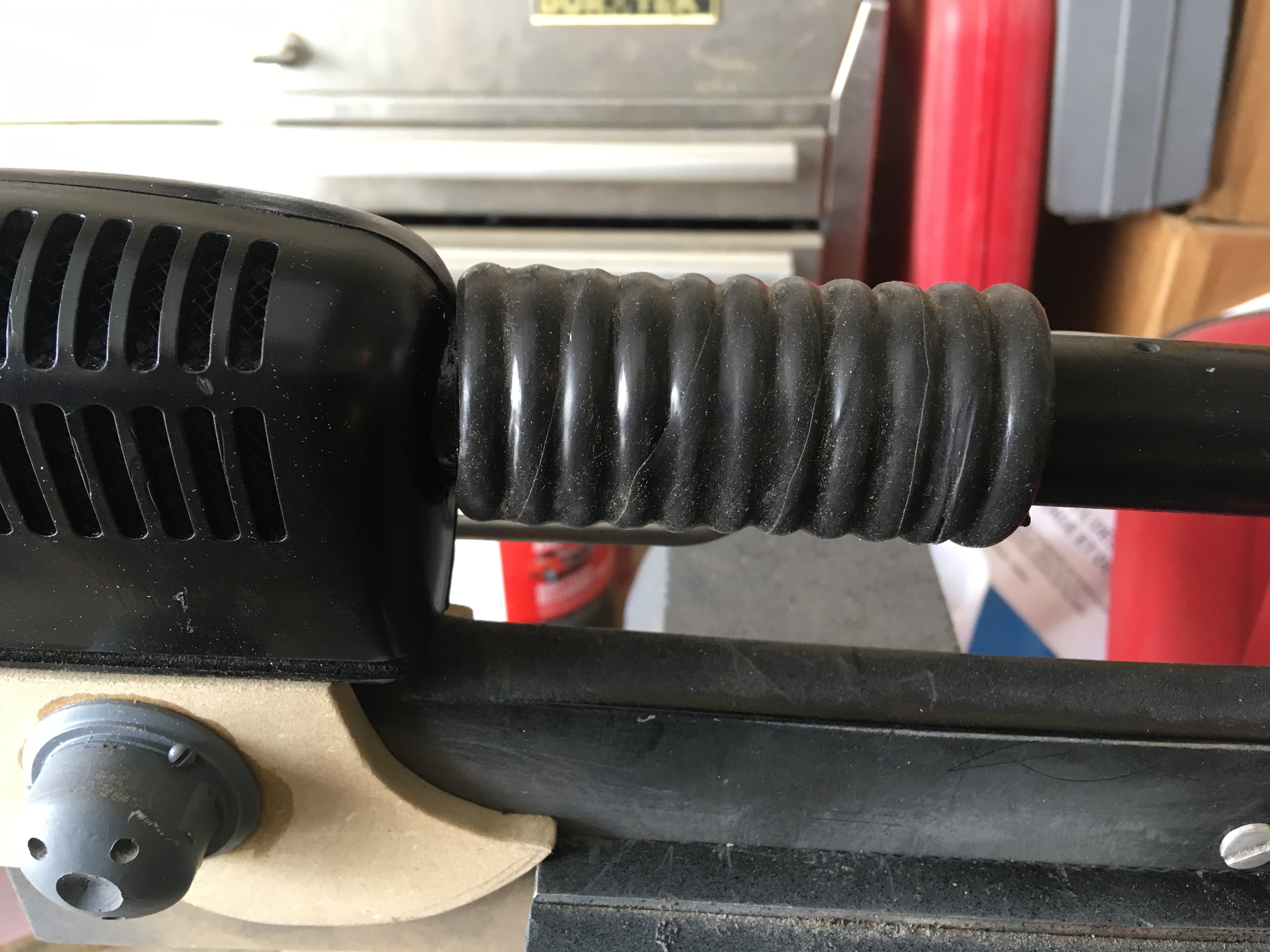

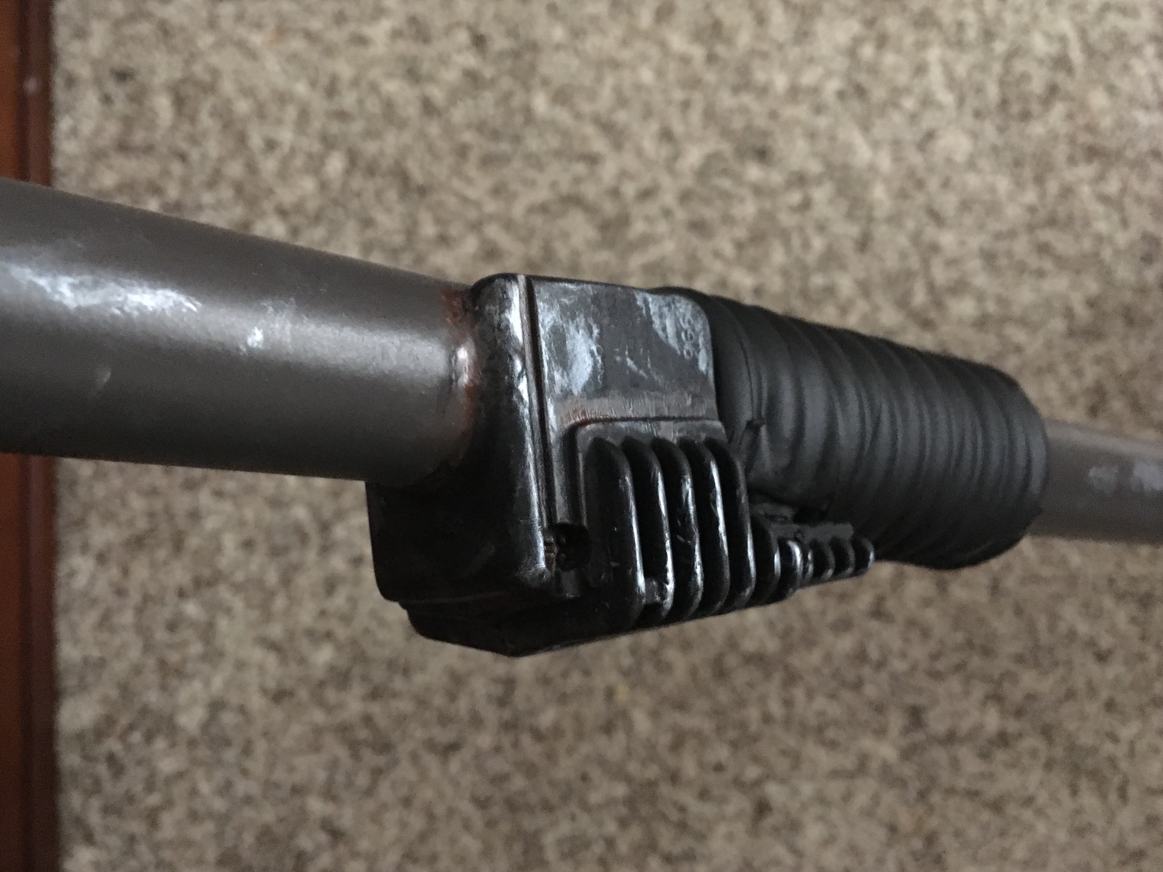

For the grip wrap I used self fusing silicon tape from Home Depot instead of electrical tape or shrink tube. It was a pain to work with and collected every dust particle in my shop but I was able to get it wrapped nice and tight. I don’t know how well paint would hold up under handling but for display I think it will be fine.

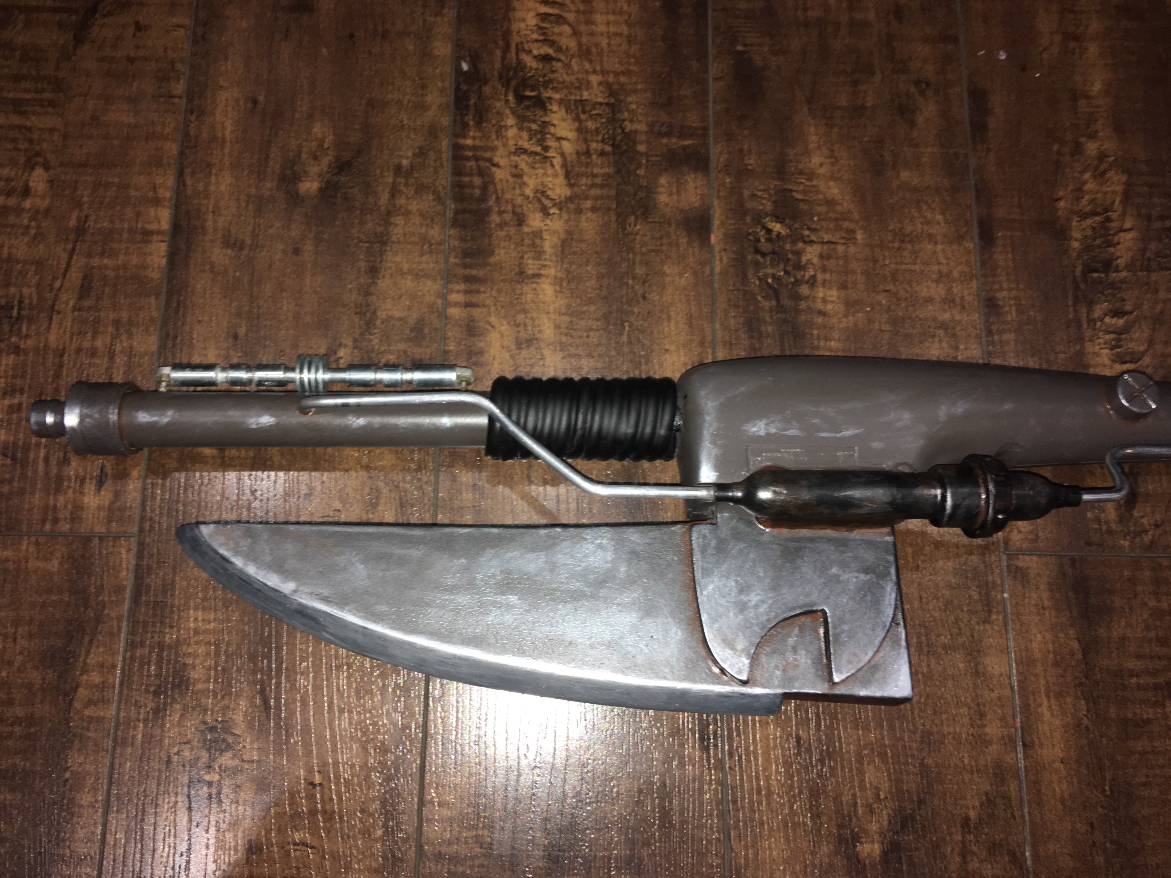

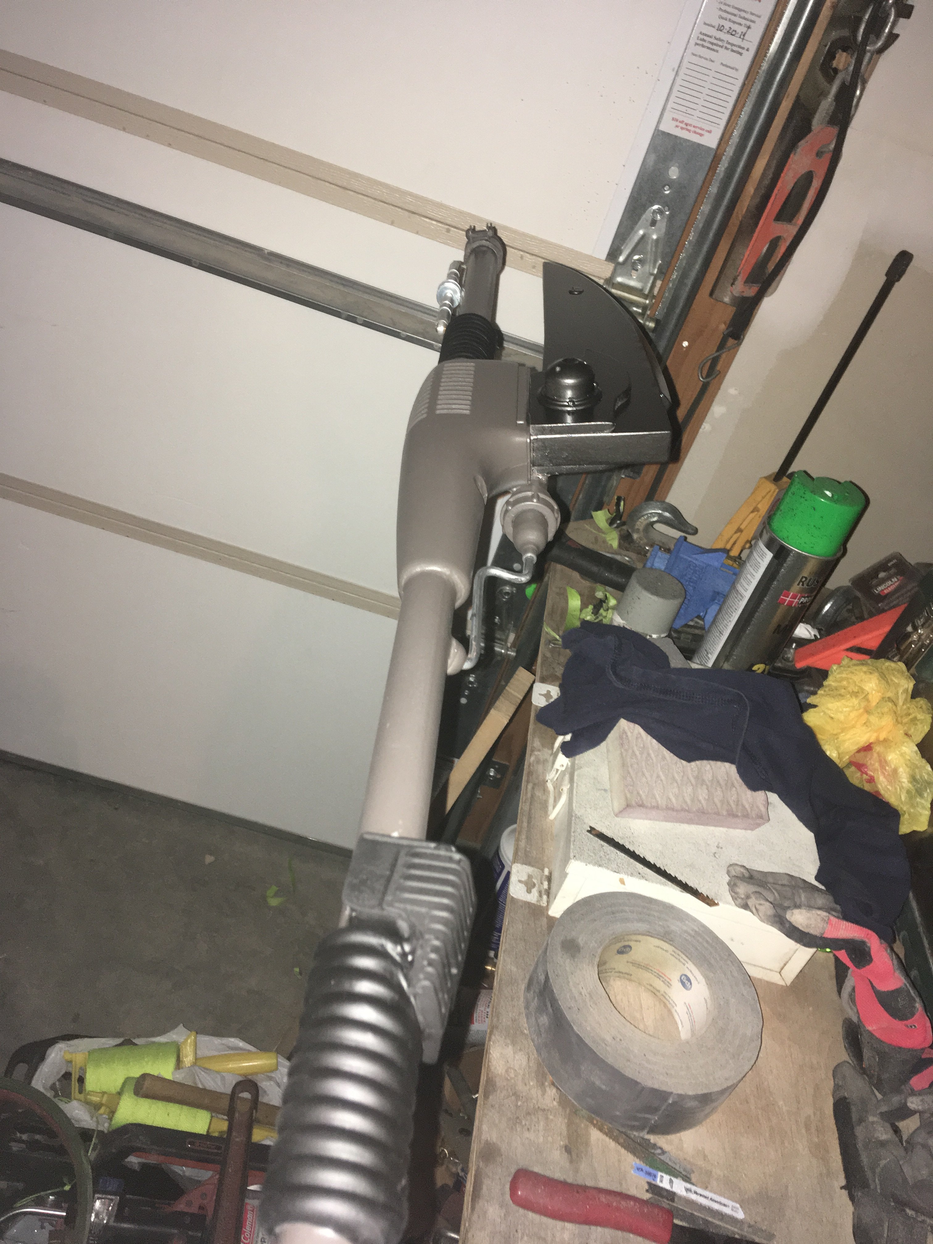

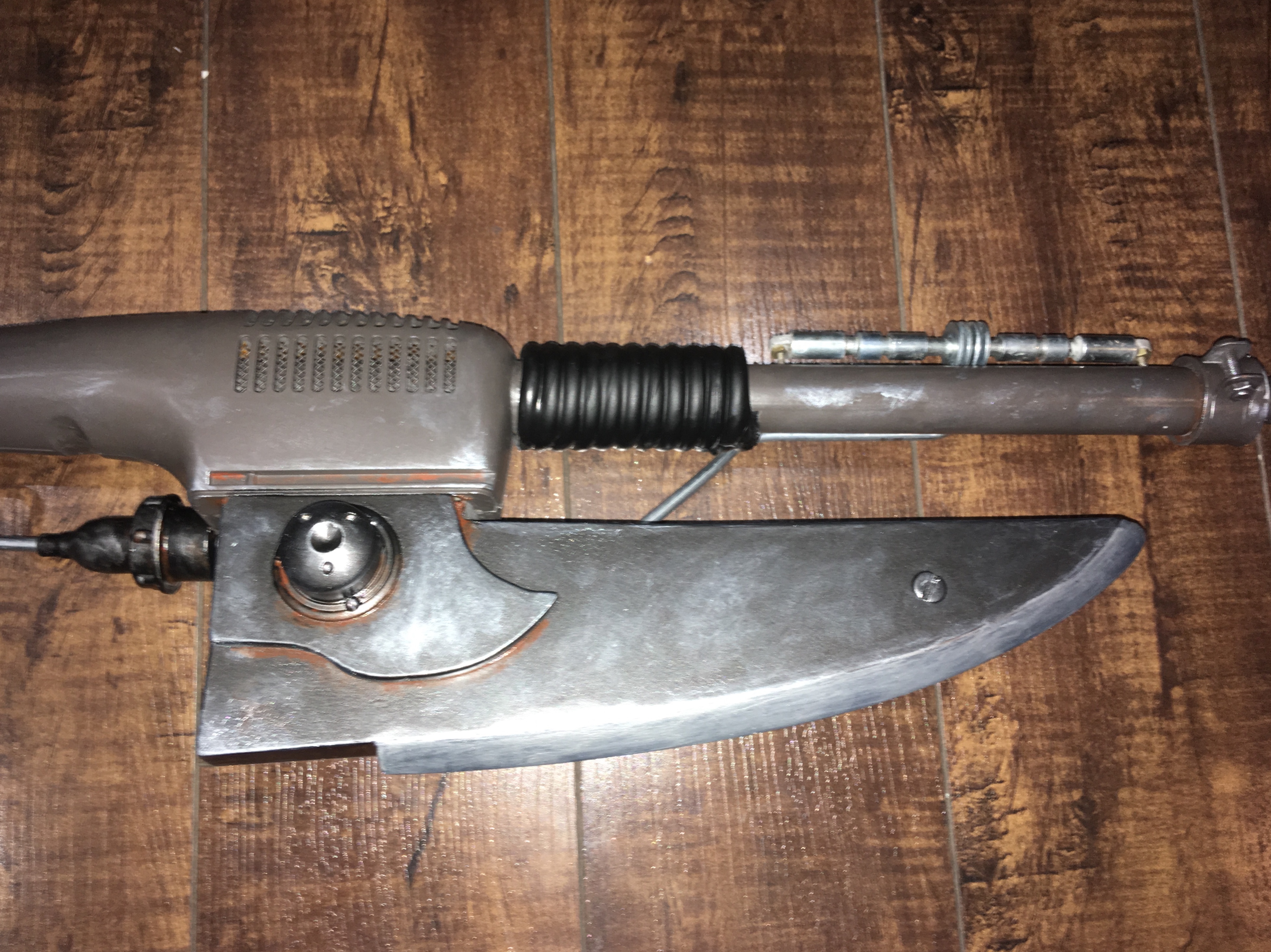

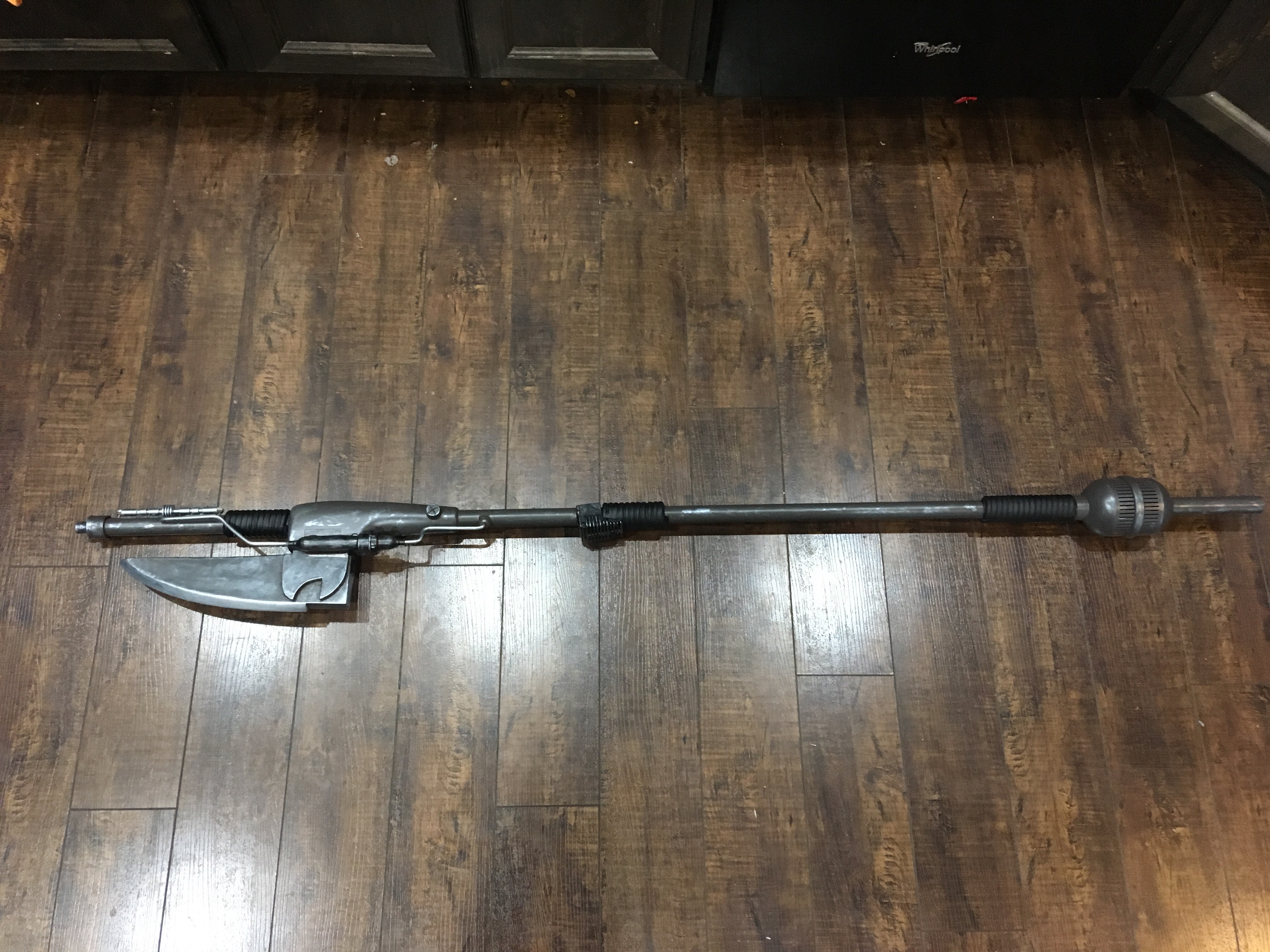

This has been a really fun build. You really should build yours. I got it painted and now all that’s left is a little detail painting and weathering. The pictures are not that great and don’t do the colors justice but this is how it turned out. I’m pretty happy with it.
Great job! Your build inspired me to give this a go.

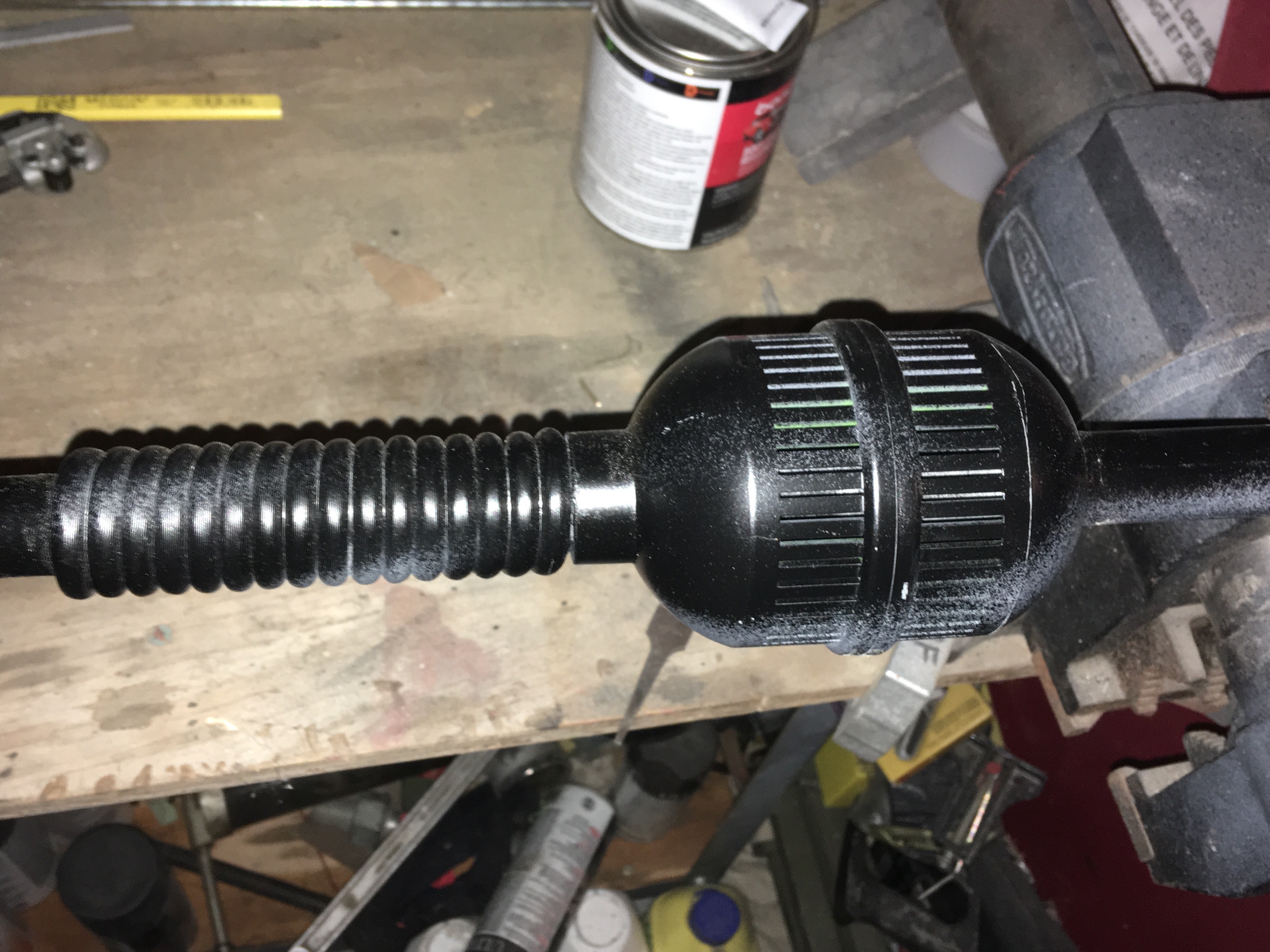

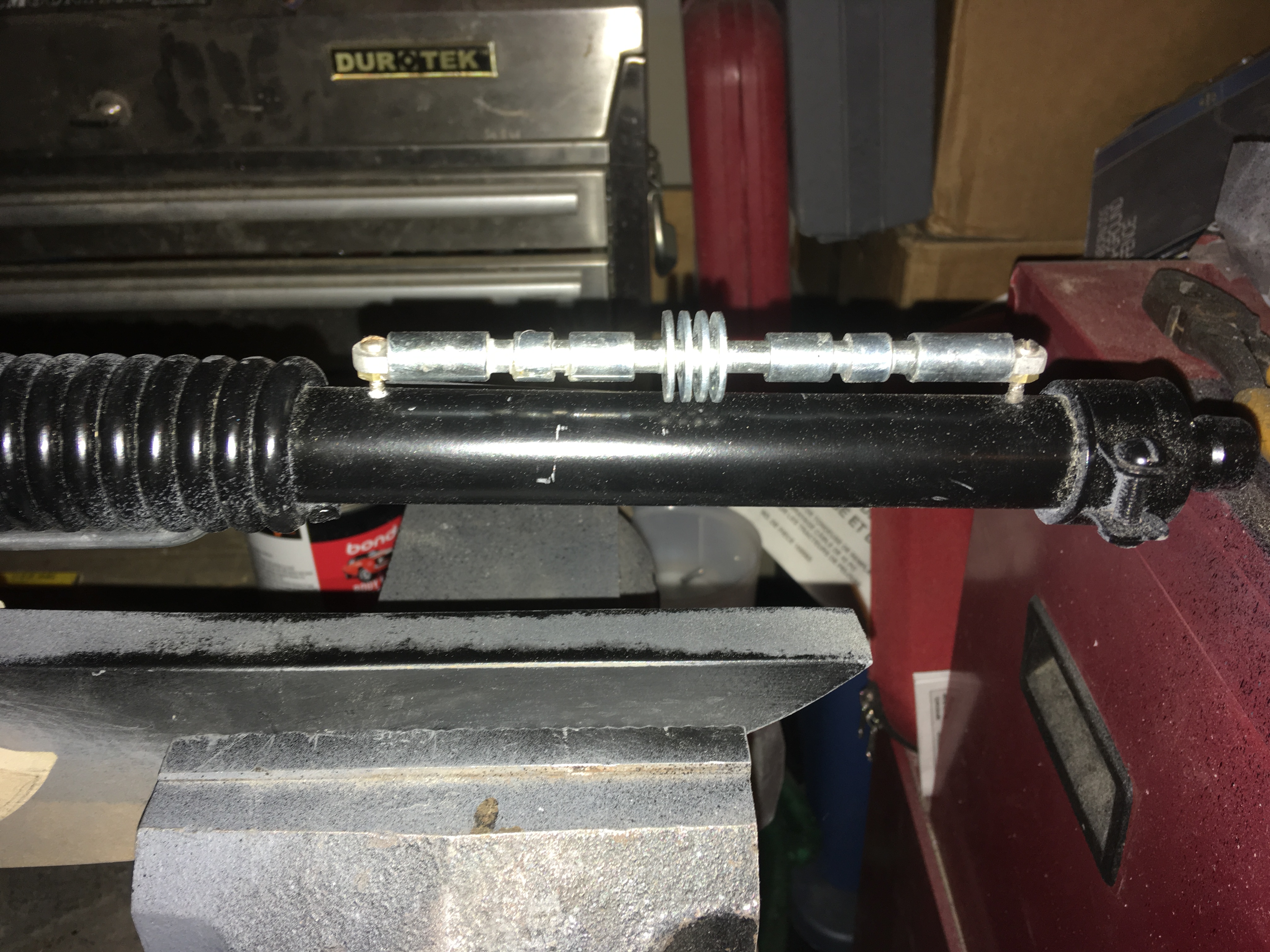

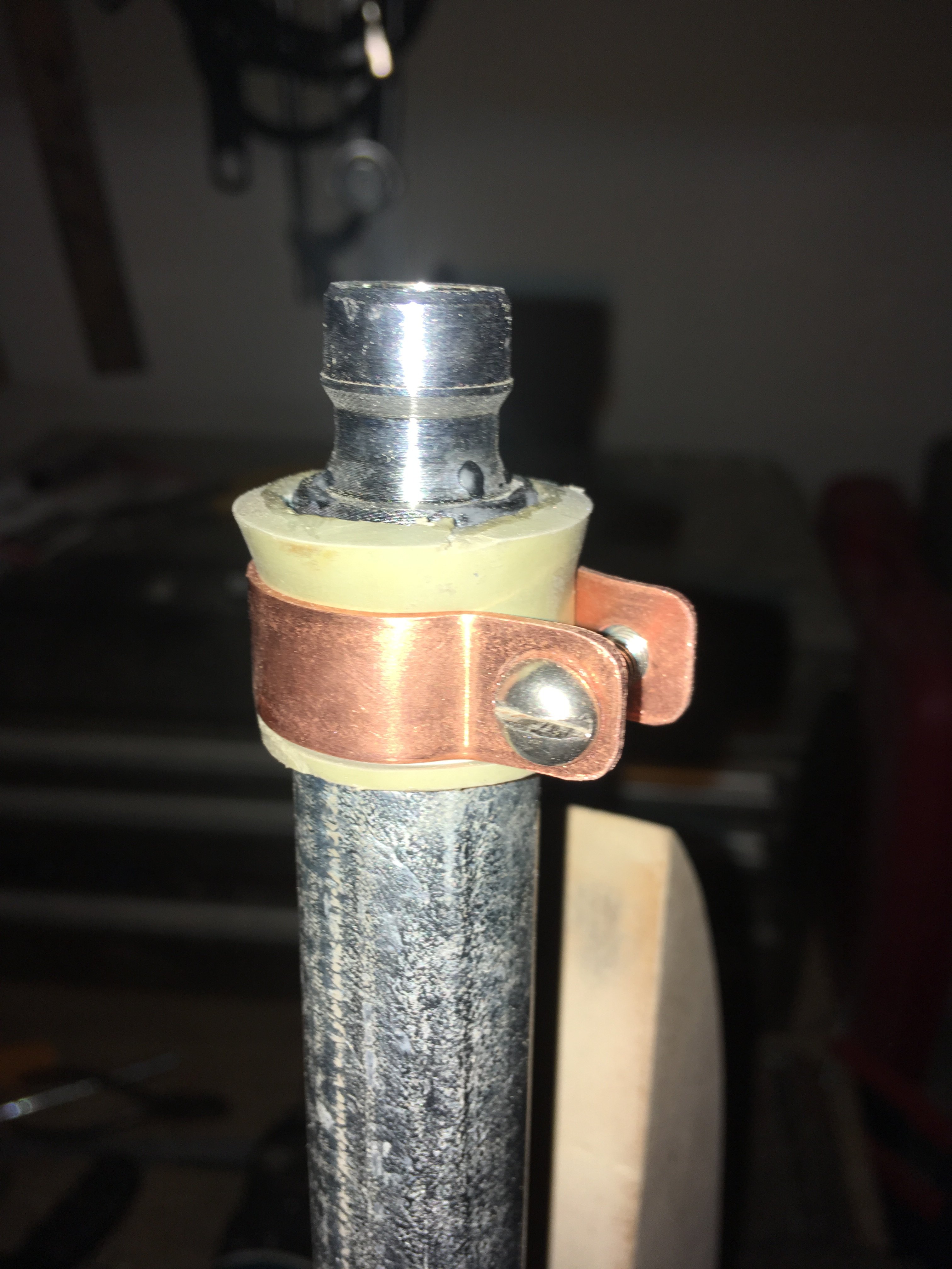

What did you use to connect the two CO2 cartridges together?
I ended up cutting down an old drill bit to fit the co2 cartridges together. It was all I had at the time, I don’t remember what size it was. The copper pipe I originally wanted to use had an outside diameter that was the same of the cartridge so I found a bit that fit. If I was going to do it again I would find a pipe that fit. When I put the metal rods on it would have been nice to have a hollow core instead of a solid block for a little room for error.
