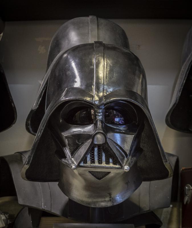

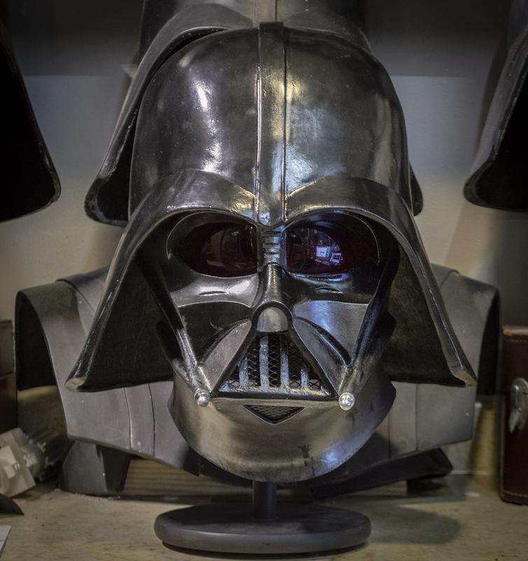

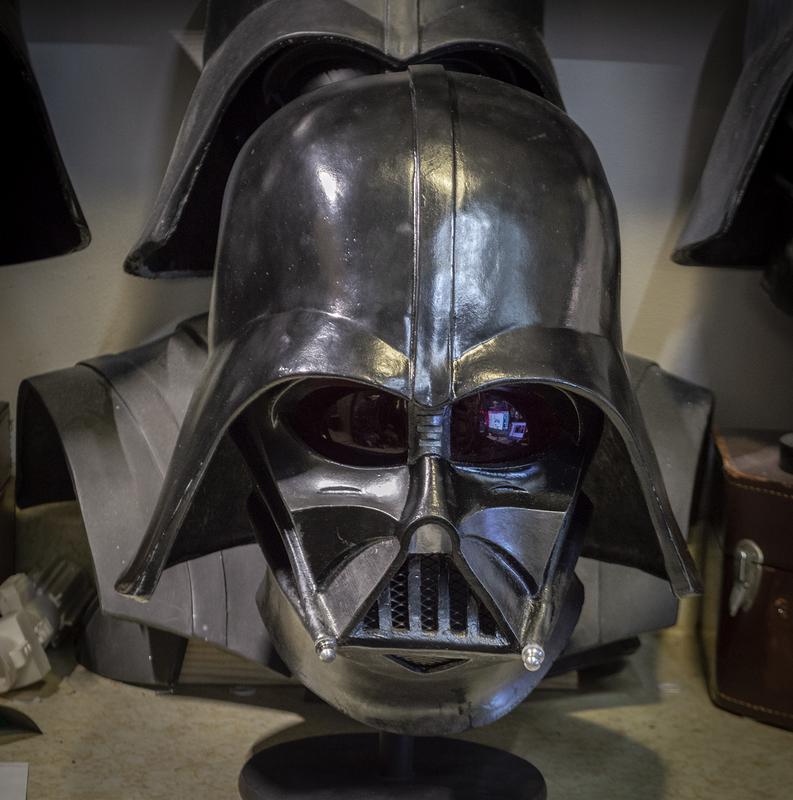

Hey guys! I just realized I havent posted a new thread on the RPF in a while (outside of the Junkyard that is). So what better way to get back to posting, than to share with you all this SL I just finished for my good friend Piers. Went with fully functional 3M apple tabs for the mounting system and some early 70's Volvo mesh for the vents. Hope you guys like it as much as I enjoyed working on it :

This is the best copy of the SL. It does not have the flaired neck!

Believe me, all SL helmets have varying degrees of neck flaring. Another thing to take in to consideration is distance and lens while taking the photos. I try to optimize as much as posible when I photograph Vader helmets.
Thanks guys! working on these helmets is definitely a labor of love and it means the world to me to see it being so well received.

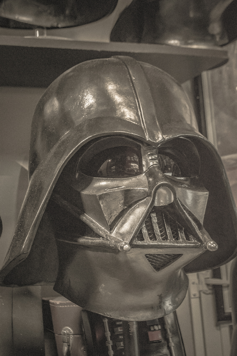

Here is another cool shot I took before it was completed. Tried making it look like vintage photography.

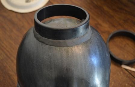

I know, right? It's a pain to install and difficult to get the dome to sit properly -- but that's accuracy for you lol. On the helmets I've finished I've done many of them with the tube solution for that reason.
My "tube" broke off the inside of my dome. :(
And this happened years back, so I've lost the tube.
Is the best way to install a new one just to use some slow setting epoxy, so that I've got time to make adjustments as it cures?

Bummer! Once I have the tube placement down I tack in place with superglue then hit it with 5 min Epoxy. Once that has cured I go over the outside of the join with two-part putty to give it a more finished look and help lock it in place.
1028866
Same process for the dome?
Yep :) only when doing the dome tube I don't add a ring of putty on the inside edge of the tube --- or if I do I make sure it doesn't interfere with the fit of the two rings (if that makes sense). I've also been known to use BondoGlass around the ring.
