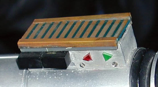

To me it looks like the hardest part in reproducing these would be to find a PCB manufacturing house that could provide the card in the right colour and with a very thin blue solder mask like the original. I have not seen any modern board that comes close to the one in the Exactra.
I have been thinking that if I were to make these, I think I would ignore those who would want one for a Luke ANH - make them the right size for an MPP to begin with and skip the green solder mask over the blue. Instead use black solder mask and white screen printing to create mock LEDs.
Then after I got the boards, I could dye them blue-green in a dye-bath or with a marker pen.
I am not sure that there really is solder mask in-between the gold traces under the bubbles. If not, then that would leave only a couple traces at one end that should be covered with solder mask instead of gold.
