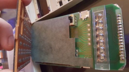

As far as I can tell I have replicated the front and back side of the card. Please all have a look at this to make sure it will line up with the bubblestrip as described in this thread.
Any changes needed, I would like to have complete by end of week, so I can get these cards made.
Can you extend the card out to the left still? It is important for being able to flip the bubbles. There is a mirror image effect.
I was under the impression that the peaks of the bubbles would line up with the via pads with holes in the card. As the card sits now, those line up, unless I am missing something.
I can, of course, extend the card out more, which might be fine to do if you all are planning on sanding it down anyway. I could conceivably make these as long as my other cards for anyone wanting to use these in a normal graflex style clamp. Those of you wanting it for an MPP clamp would be sanding them down anyway, I suppose?
Also, my manufacturer offers the exact same thickness as the card supplied for reference, so that is good.
Quick question - what type of adhesive would be best for attaching The circuit card to the bubbles?
Im assuming something that dries clear?

Does anyone know a source for a more accurate bubble strip, to go with Sloth's card, upon completion?
None needed ;) the clamp holds both in place
Yeah, but the way the card is shown to be cut doesn't suggest anything will be holding the card to the bubble strip.
Am I correct in assuming that the bubble strip edges will be the only thing part in the clamp slots and The card edges will not he in the clamp slots?

Same size as the cut bubble strip or bigger should be fine. Thanks a LOT for doing this ;) for too long have there been replicas of all other circuit boards, except this particular one.
Also down for two
Well I cut mine to be the same width as the bubble strip, and from what Sloth is saying it seems you should be able to have it be whatever width you want :D
I just have a question. What are the green squares on the rendering, the mask surface? Should they be moved down onto the squares and not on the "loops"?
