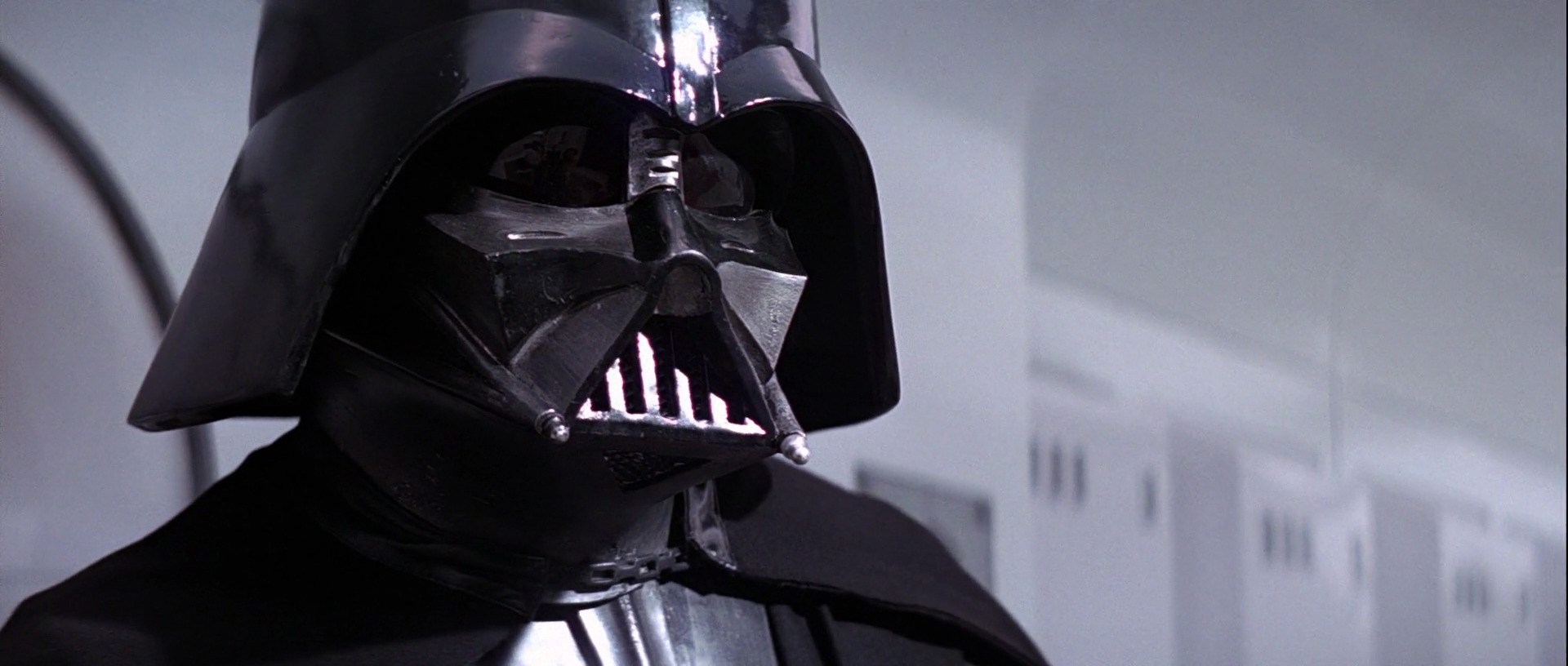

I'm intrigued about both custom & found object here as there are at least three scenes in ANH where Vader's right tusk is either very dark compared to the other one & also appears of slightly different form at the base (?) - thus:

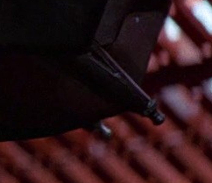

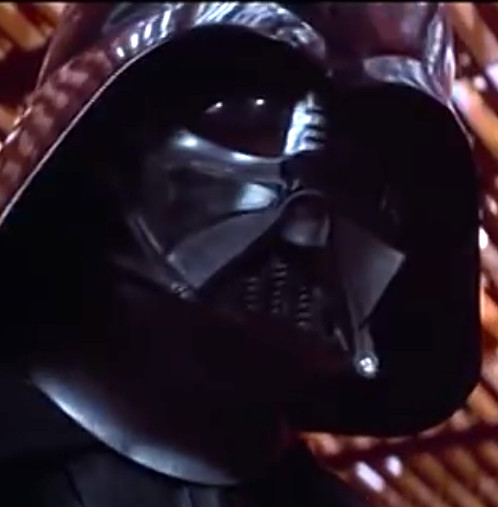

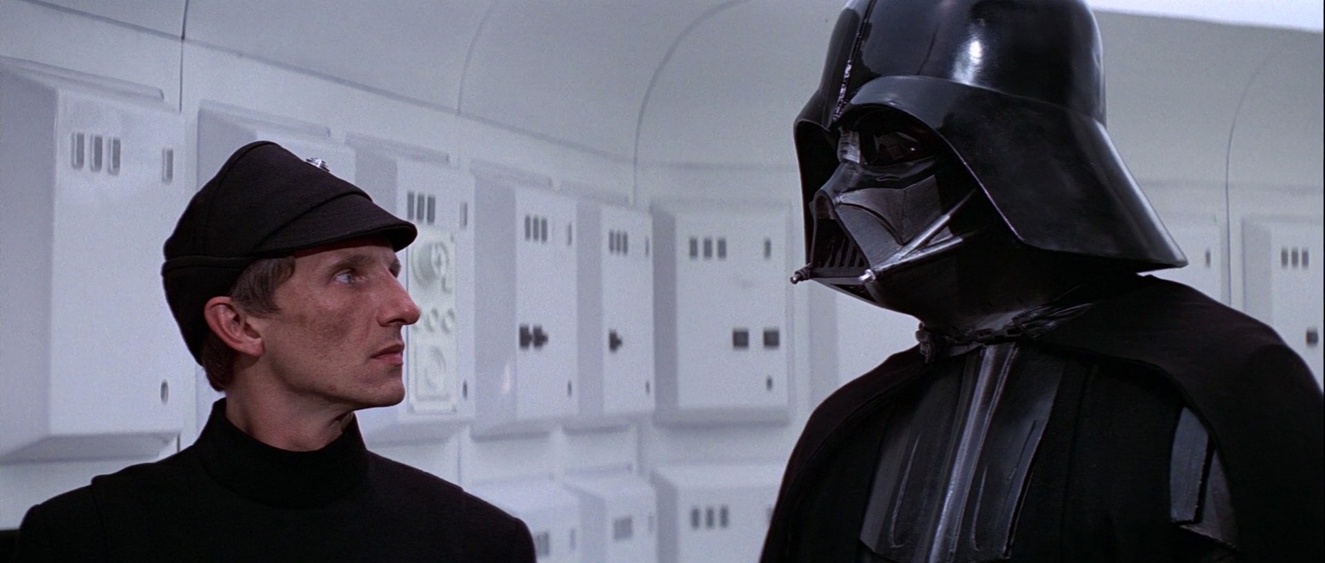

...or is much shorter or possibly missing leaving a stud - thus:

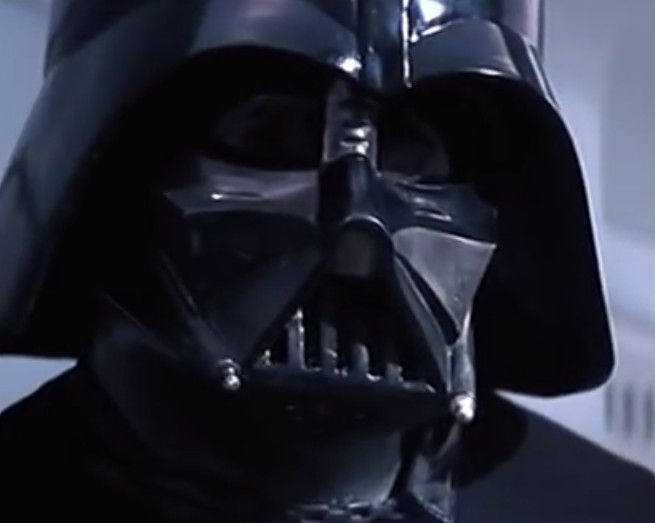

again at ANH opening promo, but here the stud also looks bent out of place :
The left looks the same in all shots so presumably is the 'standard version'. To me neither look much like what's been shown so far. To me the end looks spherical - on both sides when present. I admit I haven't looked for scenes where both may appear the same so don't have a chronology. I took these screen grabs while looking for shots of saber wiring.

Wow - some of those look very like what I see in my 1st picture, very close.

The dark is just paint.
the last of those close-ups actually looks like the "tusk" area doesn't protrude as much, maybe it's an optical illusion?
Considering it's black I'd say yes.
Begs the same question then - why paint one & not the other?
Ref my 3rd pick - why make one shorter than the other?
This doesn't make any sense to me for machined parts.

Because the helmet was painted asymmetrically. The black tusk is on the black cheek side and the silver tusk is on the silver/gunmetal cheek side.
That always looked like reflected light to me (he has such a shiny helmet...) - but checking other pictures I can see what you mean - does explain this well. Thanks.
I don’t see one tusk shorter than the other.
This is the angle that shows it but I'll admit I can find no other clear instance so is weak evidence esp. as later in the shot it's obvious that this side is totally black.
