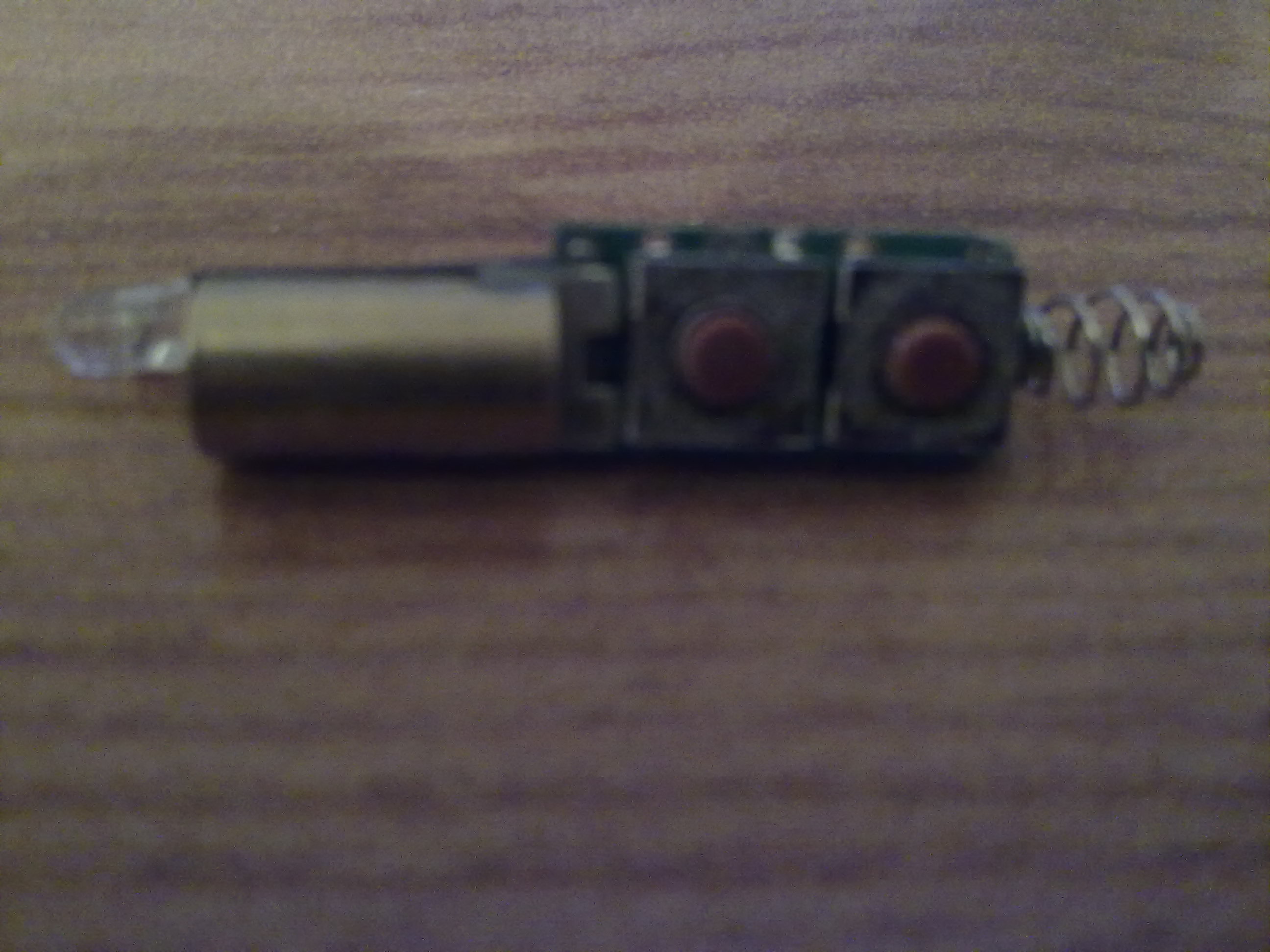

CALLING ALL EXPERTS I HAVE 3 OF THESE RED LASERS WHICH I WNT TO USE IN MY BIO HELMET ANY SUGGESTIONS ON HOW I CAN RIG THEM UP SO THEY RUN OF A BATTERY PACK AND SWITCH INSIDE THE HELMET...
ALL HELP WILL BE MUCH APPRECIATED..

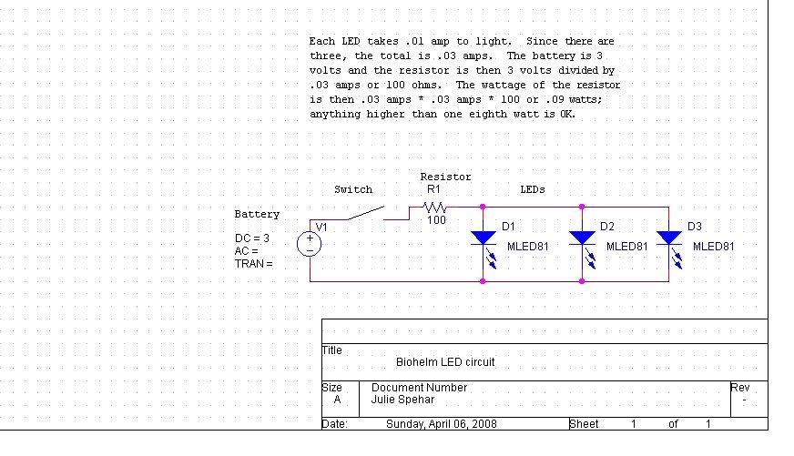

What is the voltage and current required by each laser?
That will tell you the resistor you need.
Here's a schematic (theres an error in the instructions, take battery voltage minus the Laser voltage and then divide by the total current to find the resistor.... not battery voltage divided by total current):
