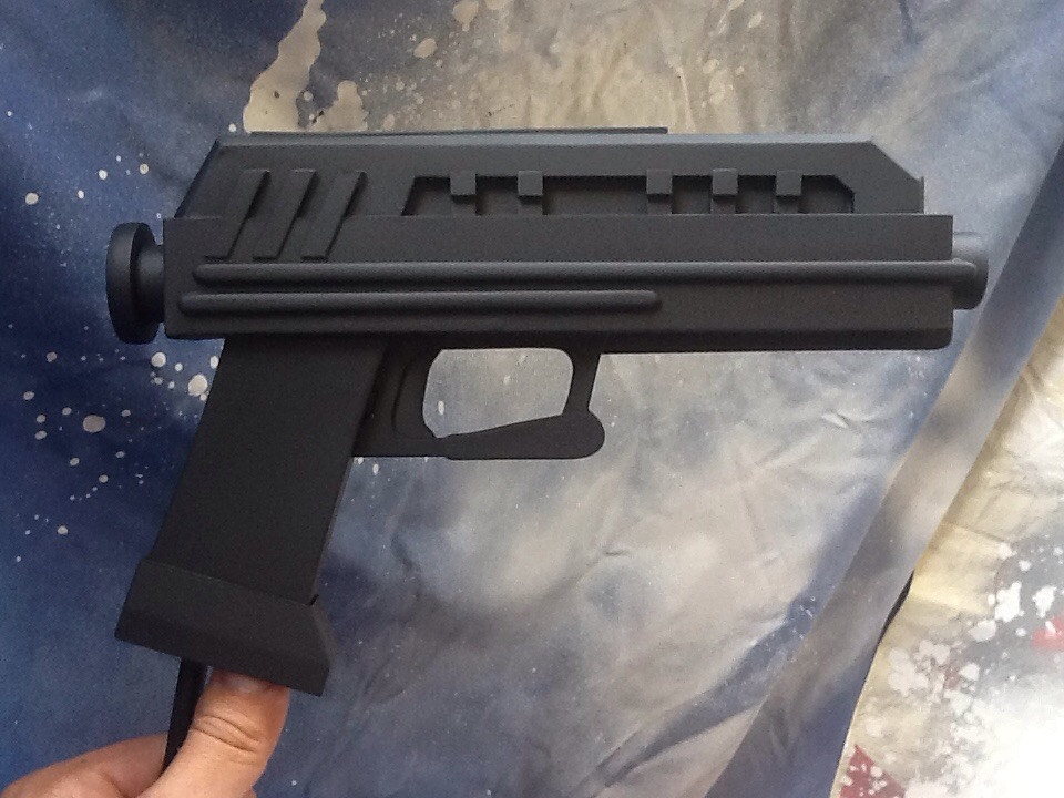

Well, after a couple of weeks of constant work I finally finished the basic construction of my DC-17 hand blaster!
https://www.youtube.com/watch?v=-Zn8auahLTQ
Now I have to add putty, sand, add putty, sand, add putty and sand again a gazillion times before painting it. I want it to be pretty much perfect :p
But first I'll take a few days off. Happy new year! :)

Almost there! :)

Aaaannd... done! Really happy with the result. Now I can focus on my armor again ;)
