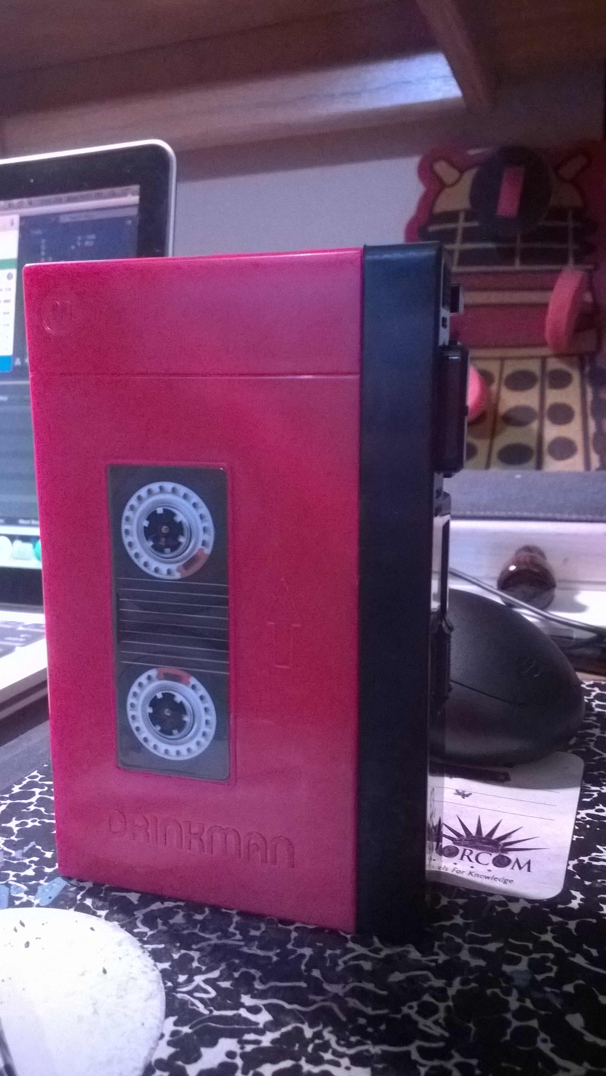

The Drinkman is a Walkman lookalike. It is very close in size and even has the fake buttons. When I got mine, I had to open it up to see what the inside looked like.
Here is what it looks like next to a WM-3.

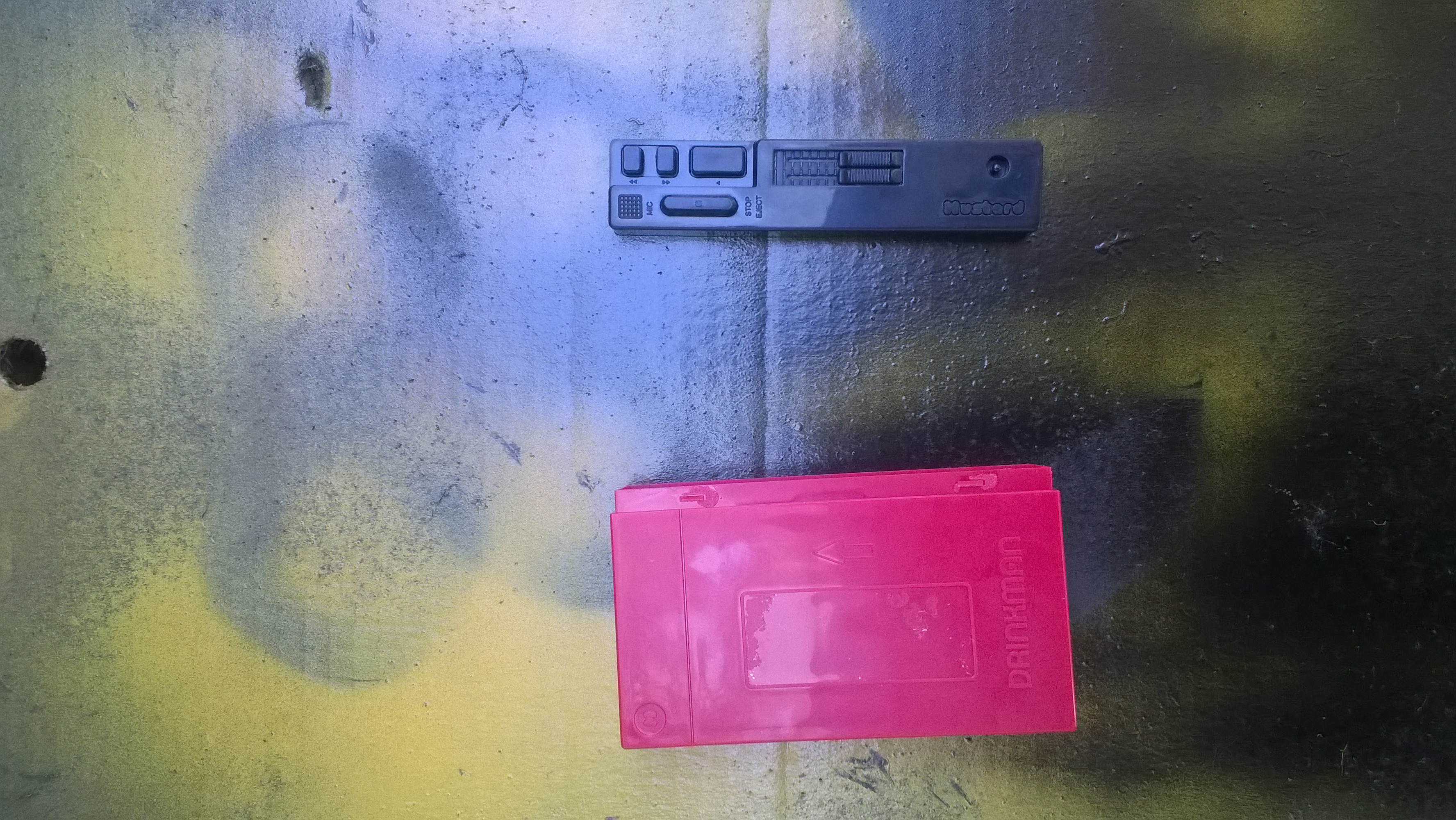

Here is everything dismantled:
Inside shot:

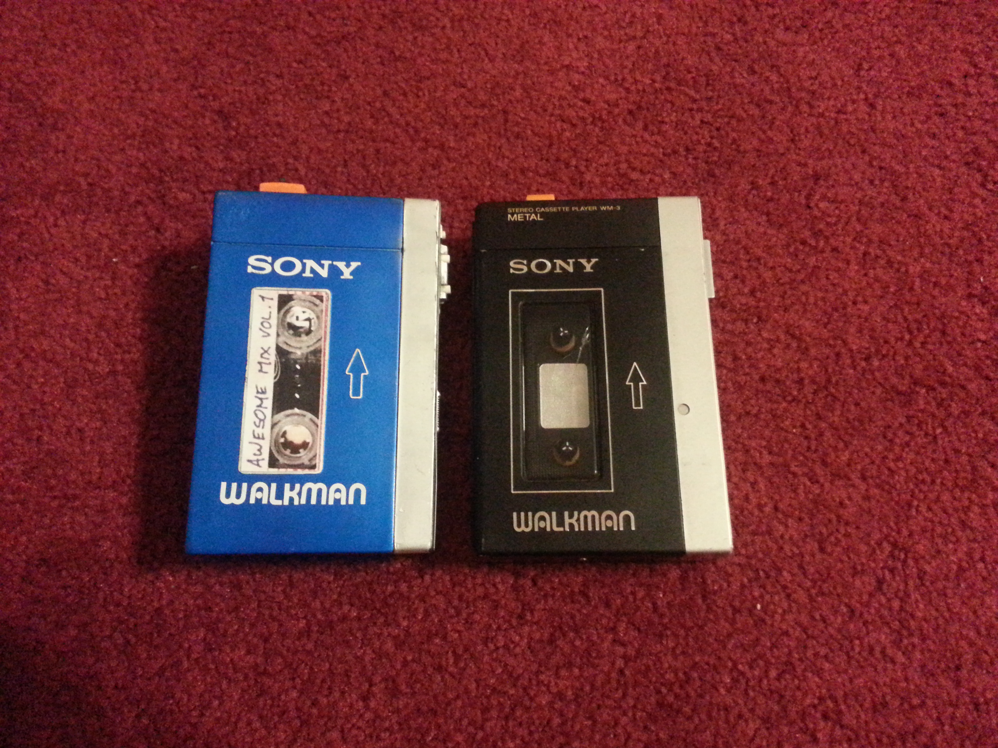

Finished Pics:
How does it hold up against a WM-3?
Great!
