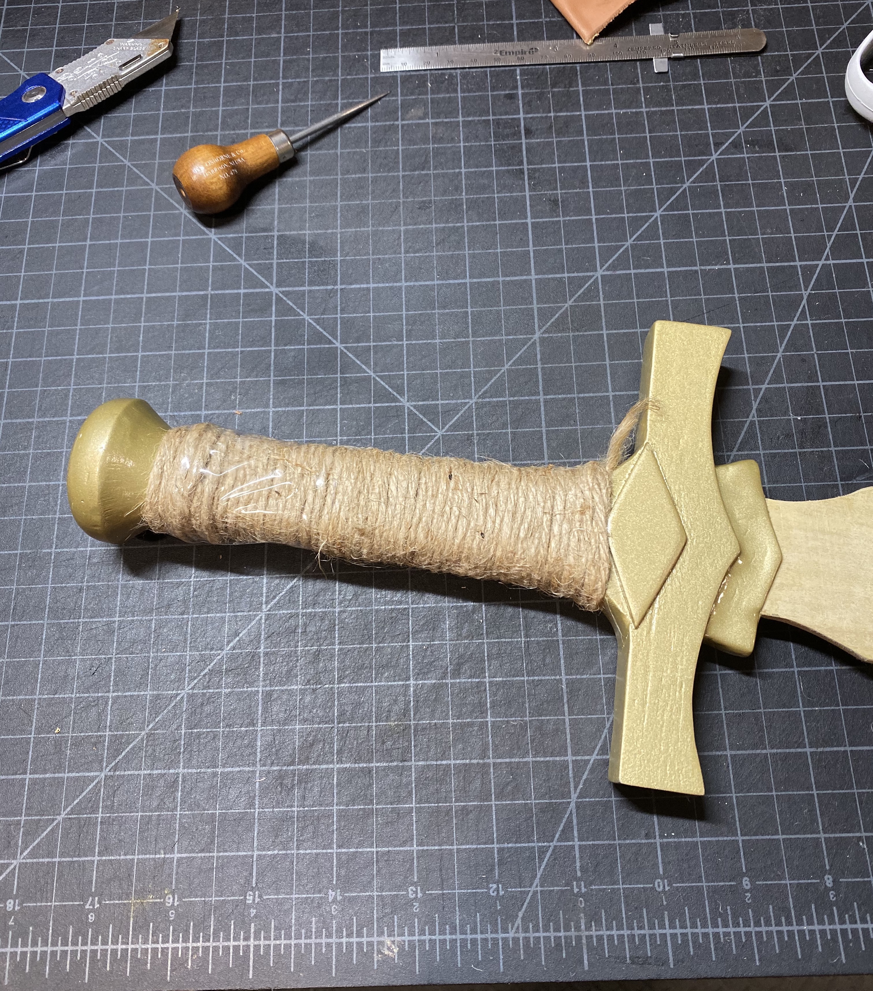

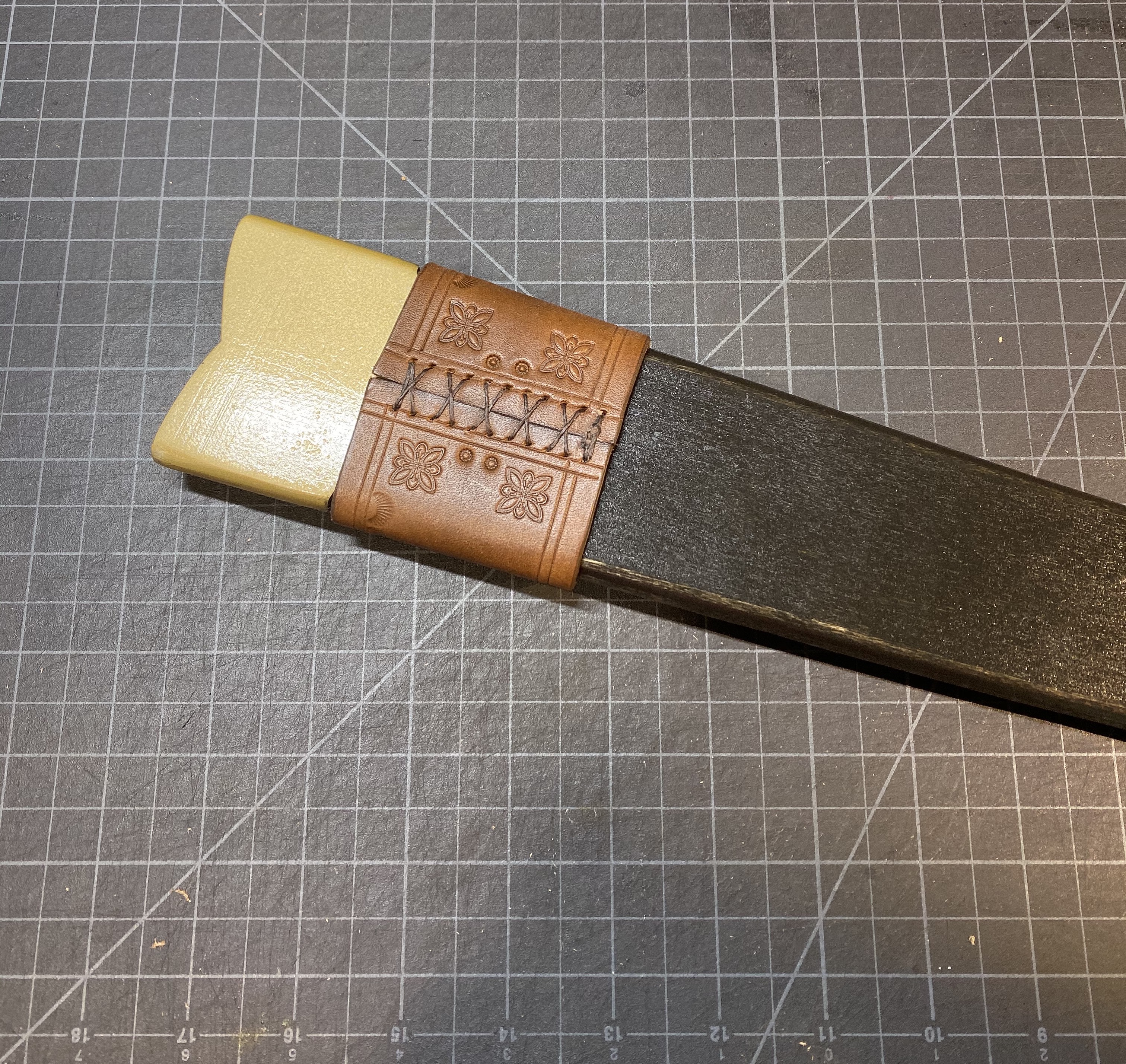

Sword, Scabbard and Frog
Sword and scabbard are made from poplar and plywood with some epoxy wood putty for accents. Still working on the sword. I'm putting a leather grip on and it's currently wrapped with twine while it dries. I usually leave the blade bare wood so it's easy to bring around without people mistaking it for real metal.
Frog is just leather that I sewed together and stamped a few borders/designs on. At first I couldn't figure out how to attach the scabbard to the belt but it turned out this simple frog worked very well.

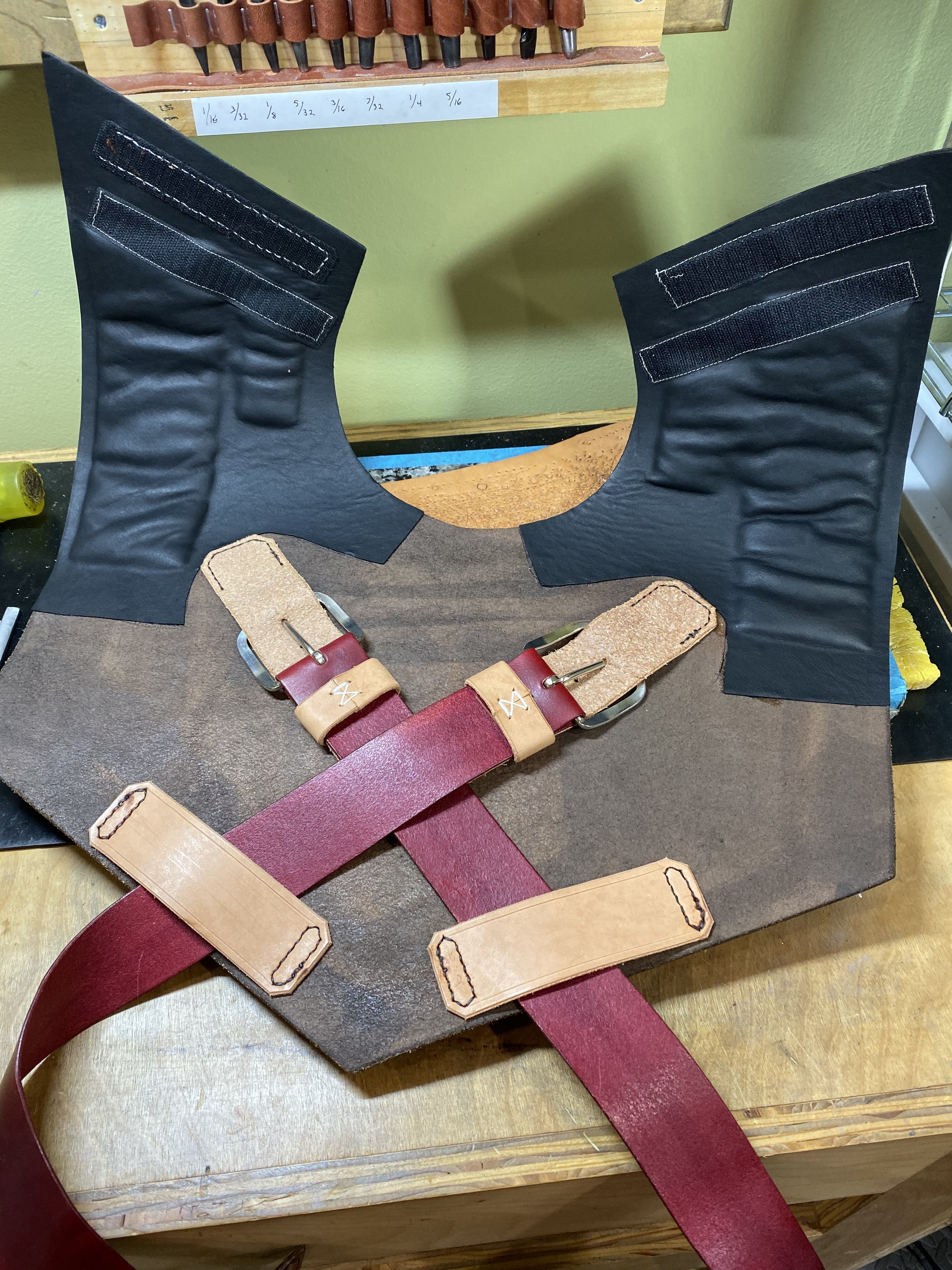

Shoulder Guard and Harness
Lot of work went into this part. Main body is 6oz leather dyed brown. I cared the designs in and then painted them with acrylic gold paint. Added some padding and lining under the shoulders. Tried real hard to figure out how to get the straps set up to look like the show and still work practically for putting on/taking off.
