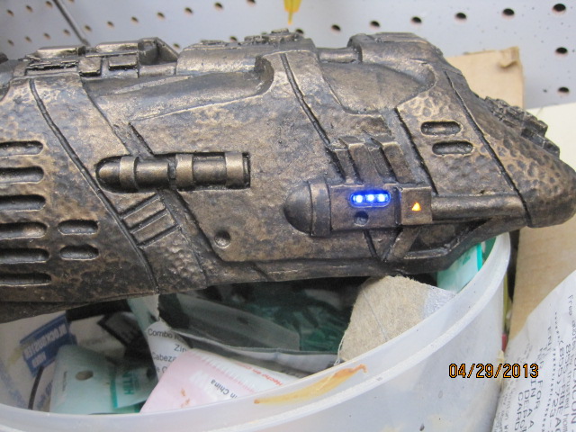

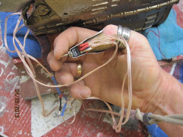

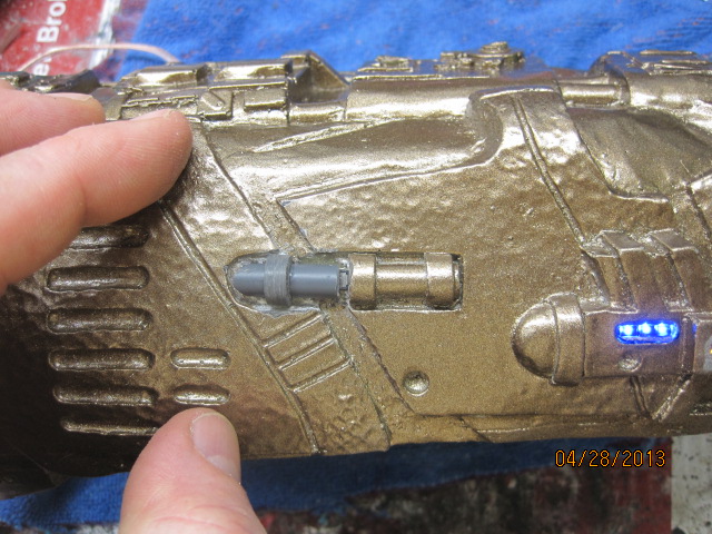

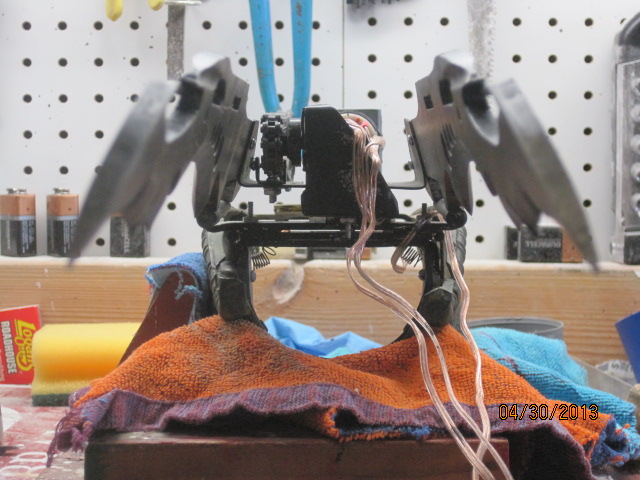

Here is the double switch set up. Since I use limit switches I have to have the lights
powered from a different source but I want them to come on when I power on the blades
so this is my solution. I did the same thing on the spear.

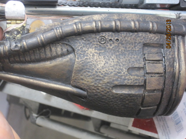

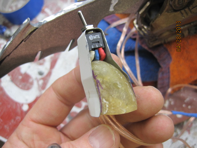

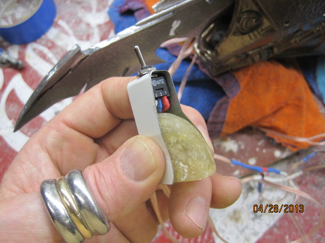

The arm that bridges the switches,

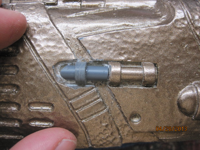

The rest of these are the thumb switch. I ended up using a piece of very thin sheet metal. It works great.
The thumb of course will be sculpted a little longer to cover the switch. The toggle tip will be in the fingernail.
 All the fingers were going to be longer anyway as the original pred had very long fingers even for Kevin Peter Hall.

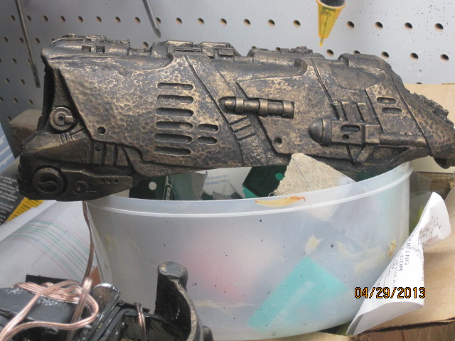

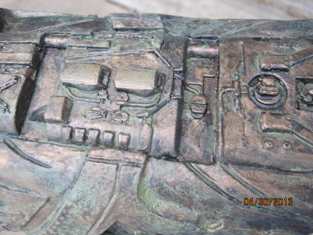

Got most  of the weathering done yesterday. It is getting very close now. I hope to have the completion video
up tomorrow.

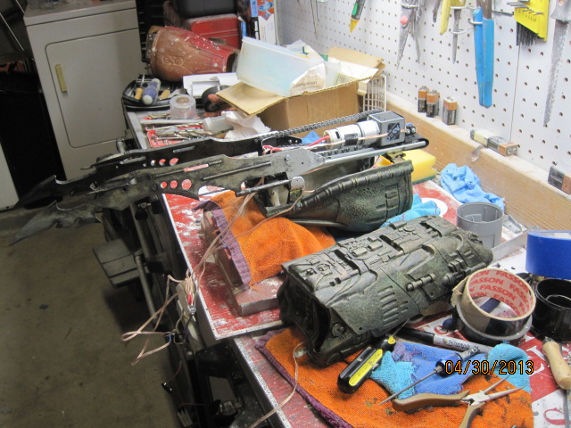

Here's my work space. Very neat huh.
I just liked this shot.
Here you can see the olive drab I washed it with. I like a little of the jungle being on it.

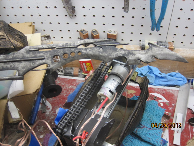

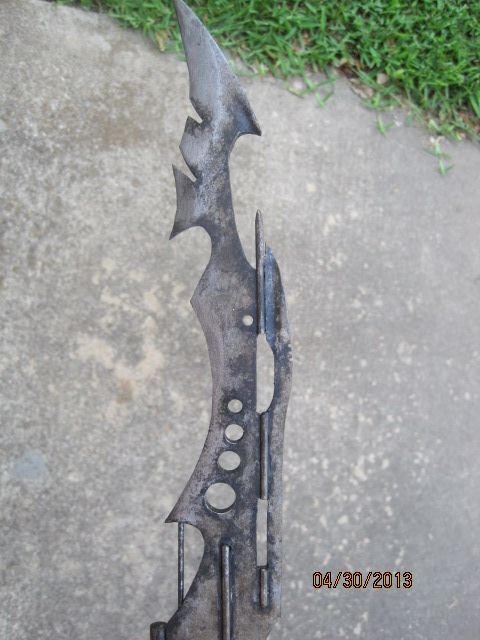

and finally the blades
If your victim dont die with the blade stab...... They die from infection.....LOL with the rust :)
The weathering is crazy

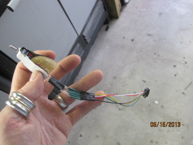

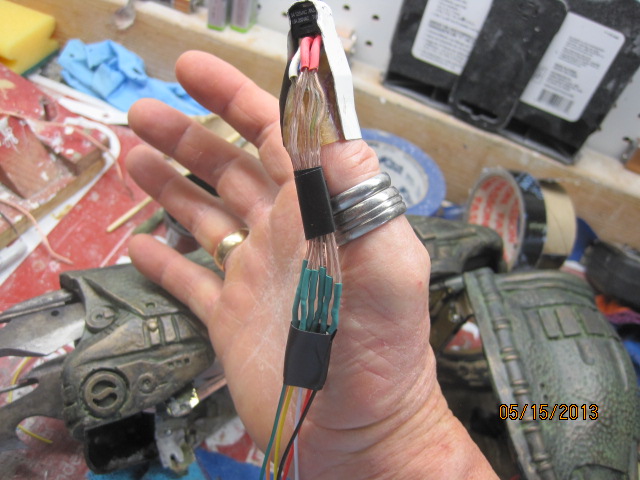

Steve, I was waiting for a part for the wiring harness anyway. It is here now. I ordered a little 6 wire quick disconnect. I think I mentioned it above. Since the thumb switch will be mounted in the glove I needed to be able to disconnect it and Radio (crapping) Shack didn't have anything I could use. I'm off to the gym then back for some soldering.
