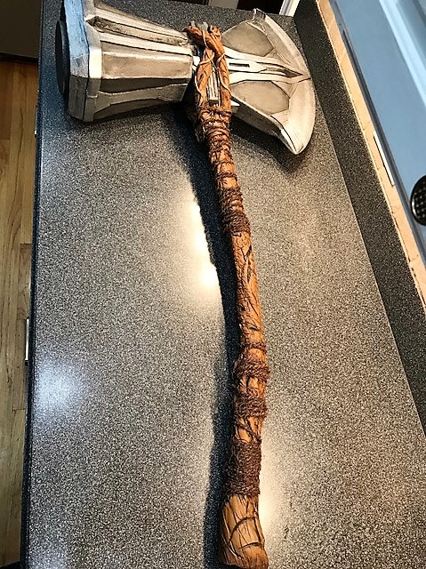

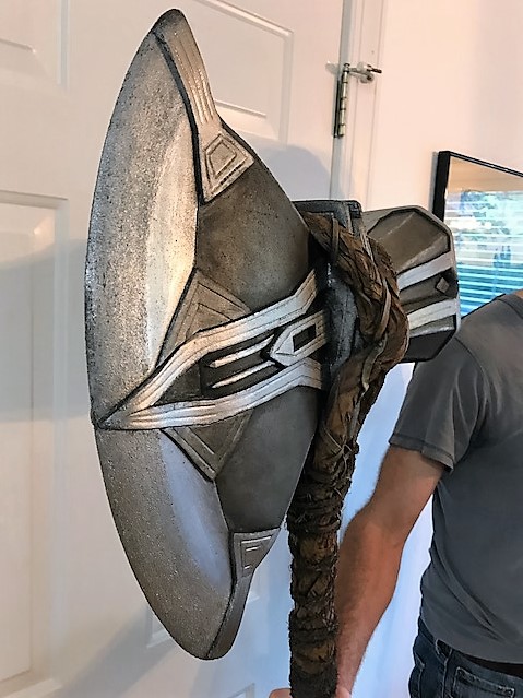

Thor's Stormbreaker Axe / Hammer Photo Dump - Important tip of the day, never be afraid to fail, learn from it, and correct you mistakes. Yesterday afternoon I took the entire weapon apart because I was just not happy with the scale and some of the details, so I spent about 2 hours cutting, reshaping, and detailing. But I will say Stormbreaker is now where I want it and I am excited to get some paint on it this afternoon
Thor's Stormbreaker - Finally getting some paint on this beast. I primed it with some Valspar brown and Rustoleum Antique Flat Nickle. Hand painting was done by first doing a wash over the entire piece with Liquitex heavy body Mars Black. Metalic highlights were painted on using Liquitex Rich Silver, and the bark was a mix of Liquitex Burnt Sienna and Raw Sienna
Throwing a huge props out to SKS Props !!! This tutorial was amazing.
Thanks so much for this and the YouTube.
Only thing I added was a little green in the roots that wrap the axe head.
Again SKS really appreciate the tutorial.
