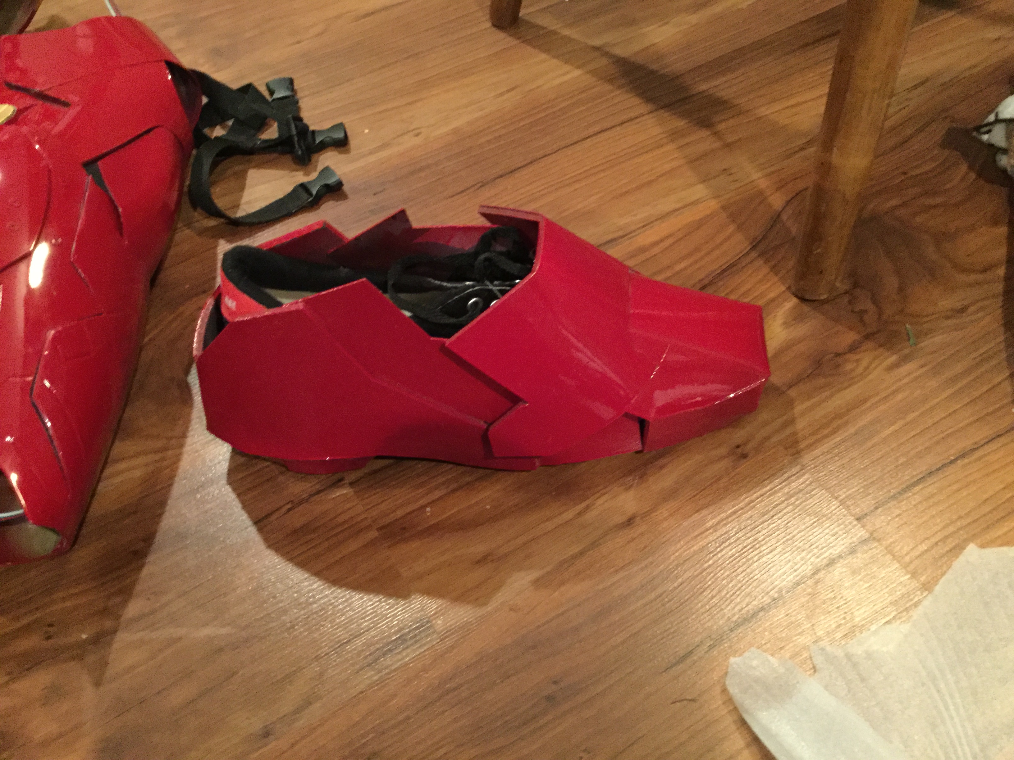

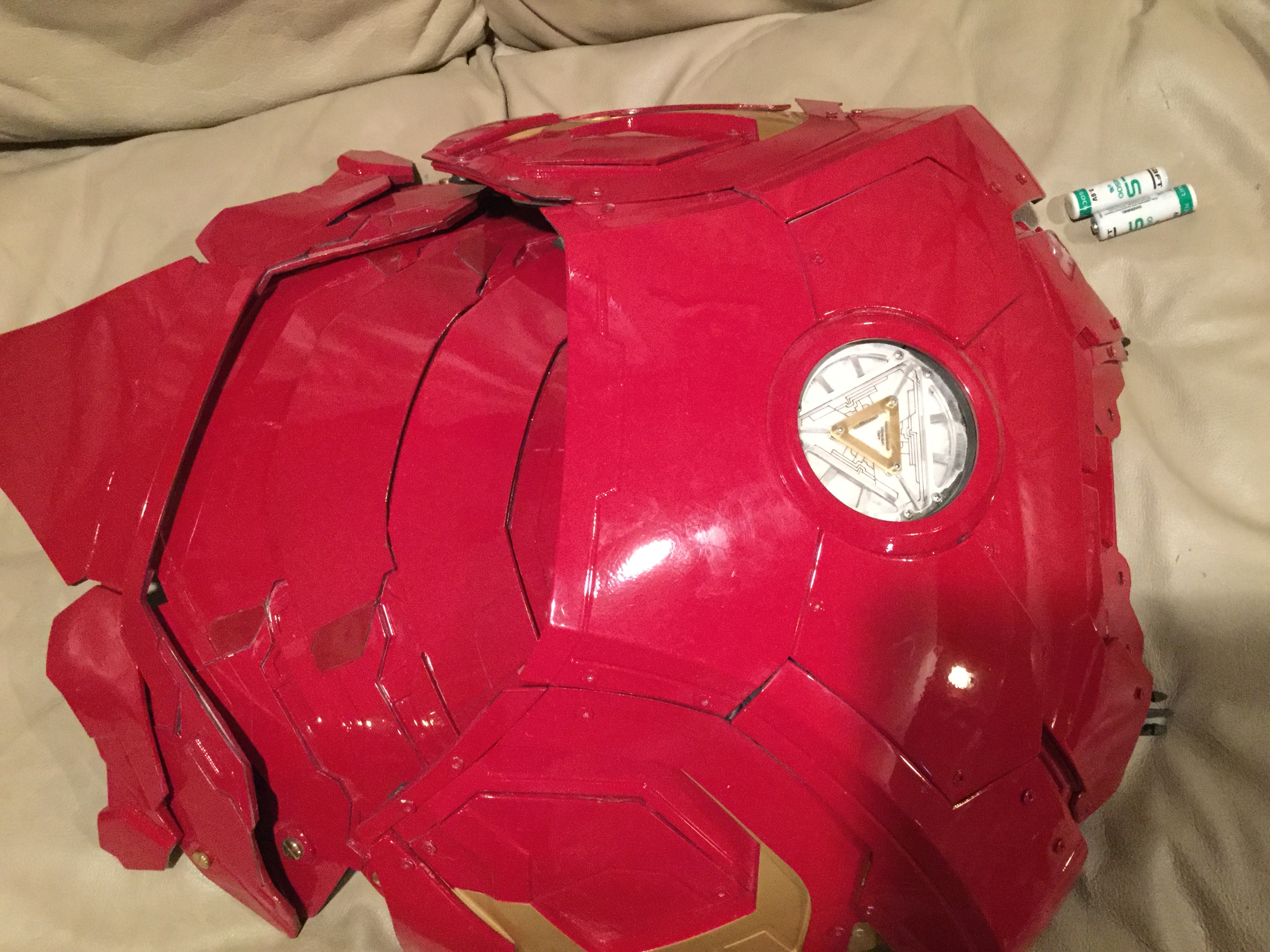

Hey everyone - suit arrived late last night in a double walled plywood crate (great packaging). The top was screwed down so it was like 'A Christmas Story" when opening lol! I am very impressed with the workmanship and quality. Everything was assembled as promised and the quality is good. Here are a few pics until I get more into assembly -
More to come -

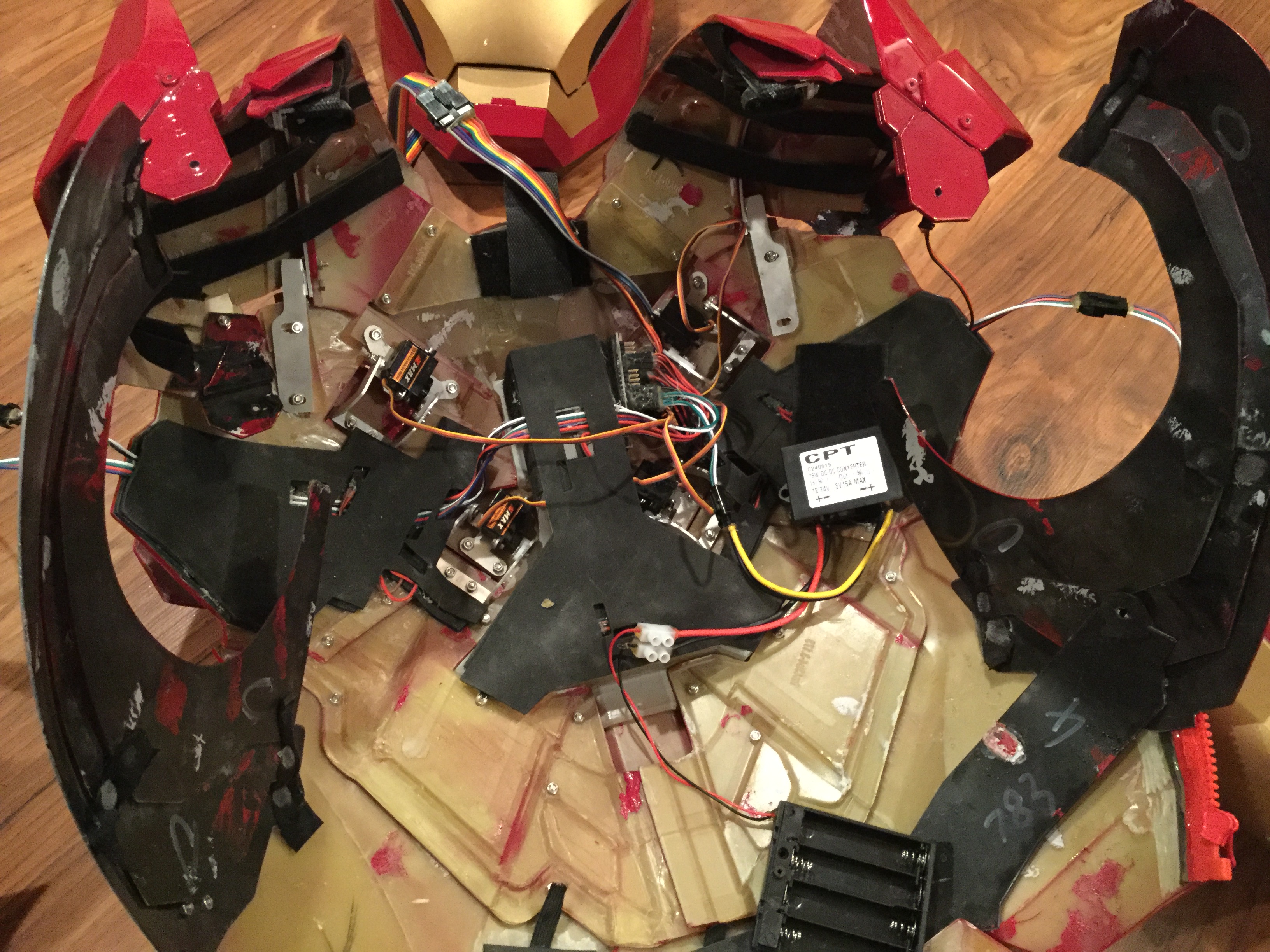

Not to sound like a complete idiot but the Micro Controller Board in the back piece had come disconnected (1 row of cables) what came unplugged is the wires that run to the helmet and the 4 servo motors for the flaps. Can anyone share what pins that these were plugged into? I attached a pic - thank you for taking the time

On a side note, the suit has some weak spots as far as the fiberglass material. I have see a few slight cracks and splits that I am reinforcing to prevent a blowout. Nothing show stopping but those that have a suit coming in, reach out and ill share what Ive discovered.

Another servo malfunction this time with helmet.... sigh.. was doing a show and it happened... any assistance on this?
Tested with multiple new servos at home however problem seems to be either with the hand button that triggers it... or connection.. but checked all connections.. sigh..
did you trouble shoot the hand button? seems like a simple thing to test and rule out.
Basically I'm a noob when it comes to all this but I'm glad I'm learning lots... and also frustrated cause the thing I wanted to most (a working IronMan helmet) isn't working :(
Must thank Super dave and John
Update: Problem was a frayed wire in the left hand. The wire connected to the push button and connector came loose and could see it was exposed, connected it back and sealed it in and around with epoxy. So far so good
