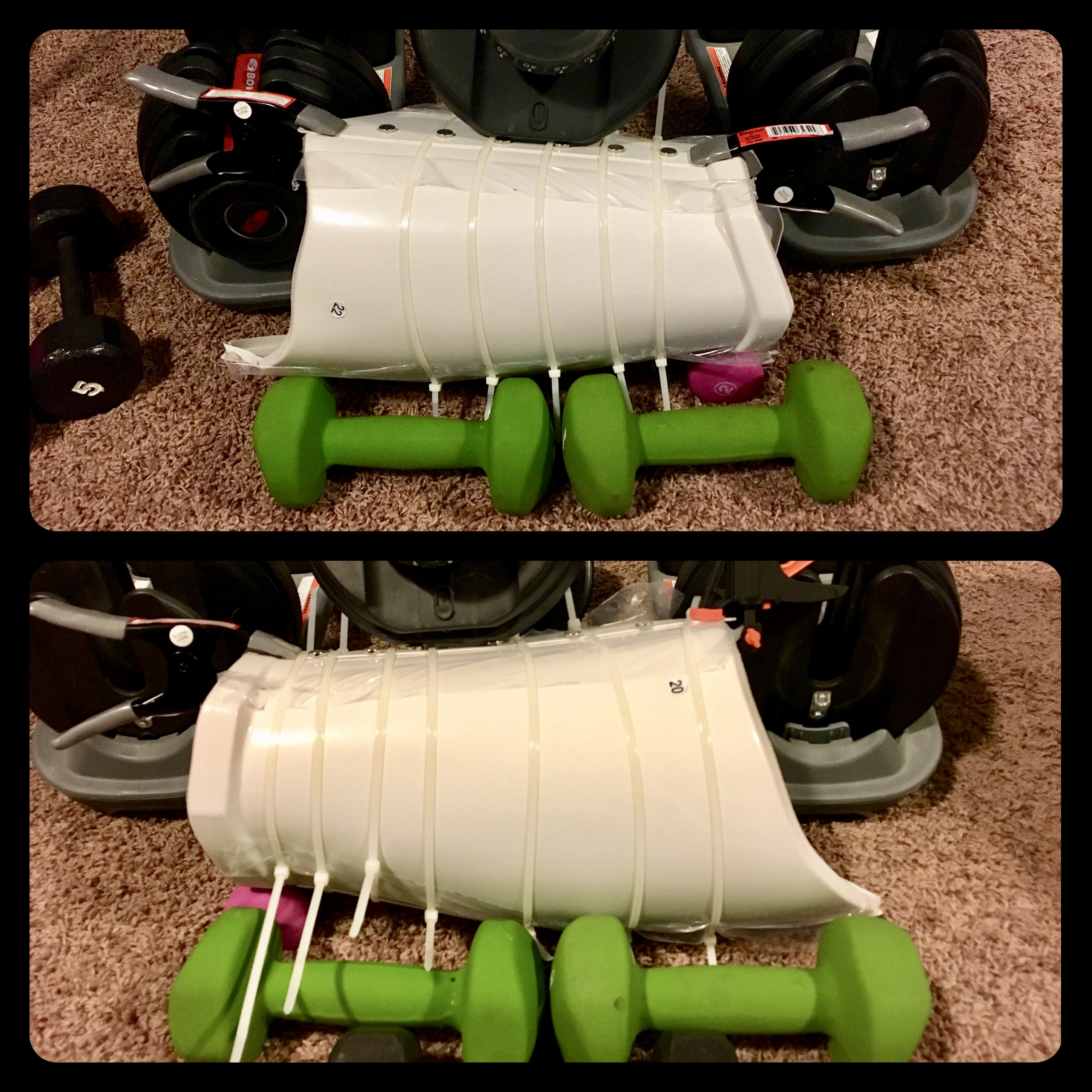

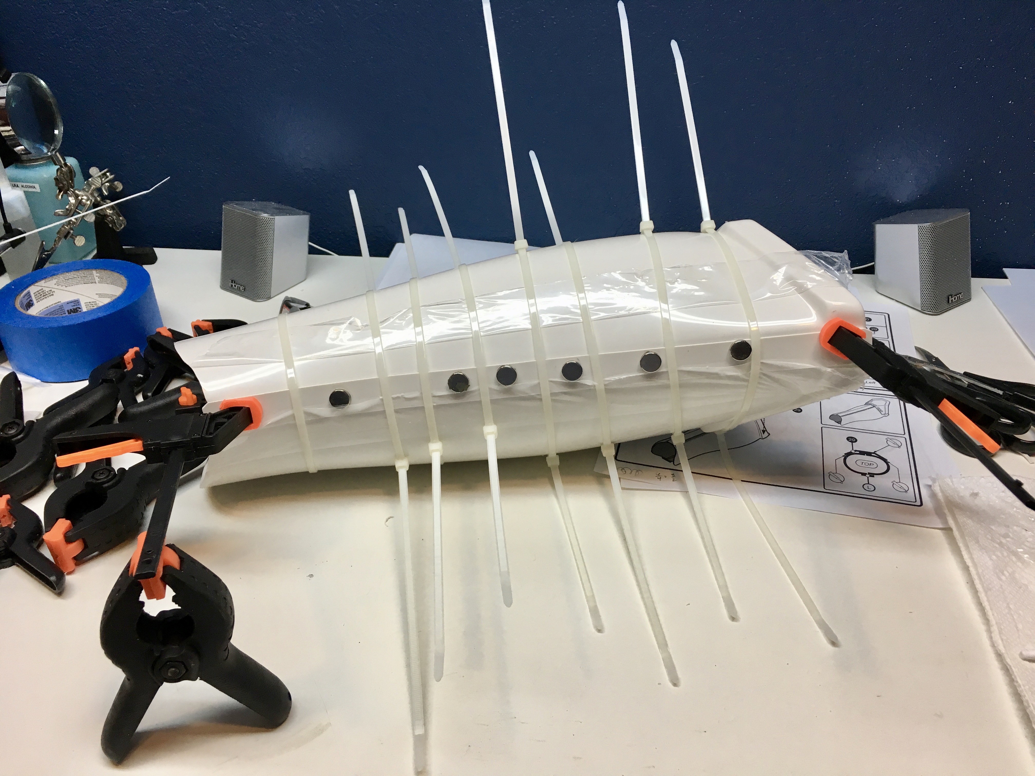

The thighs on my kit were tough too. I found the best approach was to attach the cover strip one side at a time. For the thighs, I flattened them out using some dumbbells. For the other pieces, I used zip ties to hold everything together while the adhesive dried.
As for the calf fitting, yes it's tight. Make sure you size them with your trooper boots on!
Some pics for reference.

Excellent process! I've been using the magnets, and clamps but hadn't thought of the zip ties, awesome! Thanks! georditrooper suggested this discussion be carried on in another thread, and I suppose that's best, so not to clutter this one with replica talk. is there another existing thread? I was going to start one but didn't want to go to the trouble as I'm trying to get this done before Halloween.
