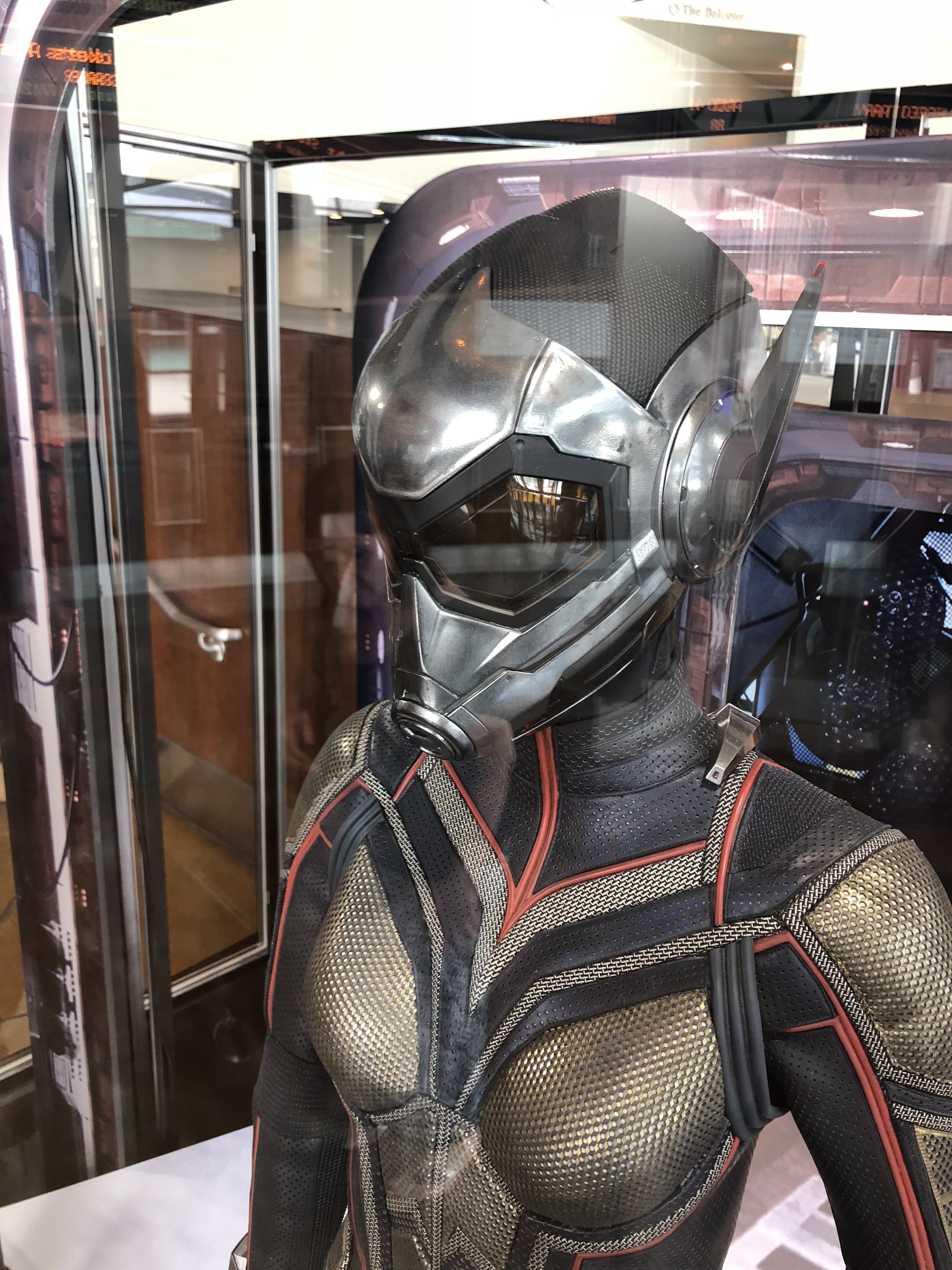

The Wasp costume is on display at the Arclight Hollywood Cinema. I forgot that there is usually a display there when I went to see a movie yesterday so I didn't take my good camera or stay after dark to avoid the glare, but still got some decent pictures with my iPhone 8. Here's an album with the shots I got. There's also Albums with Ant Man and Ghost.

I'm working on a Wasp suit from the latest movie but the reference images have confused me. The pictures taken on set seem to have the main parts of the suit seem like a dark blue but in the references images above and others I've gathered show the main parts black. So I'm very confused as to which colour is more accurate
The black leather-like material has holes punched in it with a blue backing material so it can look like a dark blue with the mixing of colors.

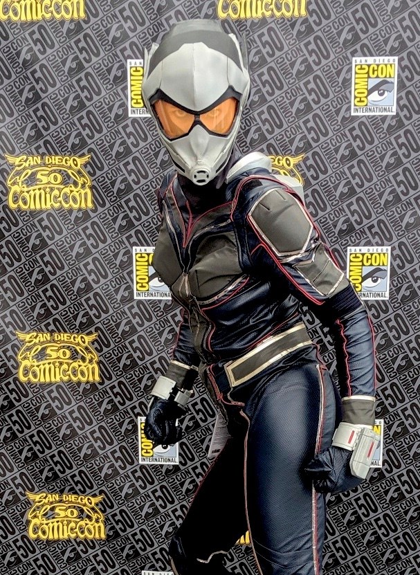

I built the HVD Wasp costume for SDCC 2019. Some of it was last minute, so a lot of scrambling and not quite what I wanted. But I ended up with a solid version 1. The current helmet is a bad foam job. Wrist cuffs and backpack are a 3d print that needs some rework to get closer to screen accurate.
I commissioned the soft part but it needs work to get it looking better, it's not very breathable, and is VERY restrictive. I'm probably going to get some 4-way stretch printed to match the pattern and replace the area in the armpit through much of the inside upper arm so it breathes more (or at all). The torso is also a touch too long so it bunches. The silver accents should be more of a gold color, so I'm going to paint/dye those. The gloves also need to be redone. I sent those back twice and they ended up sending me all of it and spare material so I hand sewed them closer to fitting. Still too small and weird fitment. But I'm probably stuck with that as is since the pleather pattern will be hard to find.
Version 2.0 helmet is in progress. It's about 1/3 printed so far.
Backpack 2.0 will have swappable wings (small to large) and LEDs. I'm tempted to try the motorized wings as that's way closer to my skill set than sewing. haha
