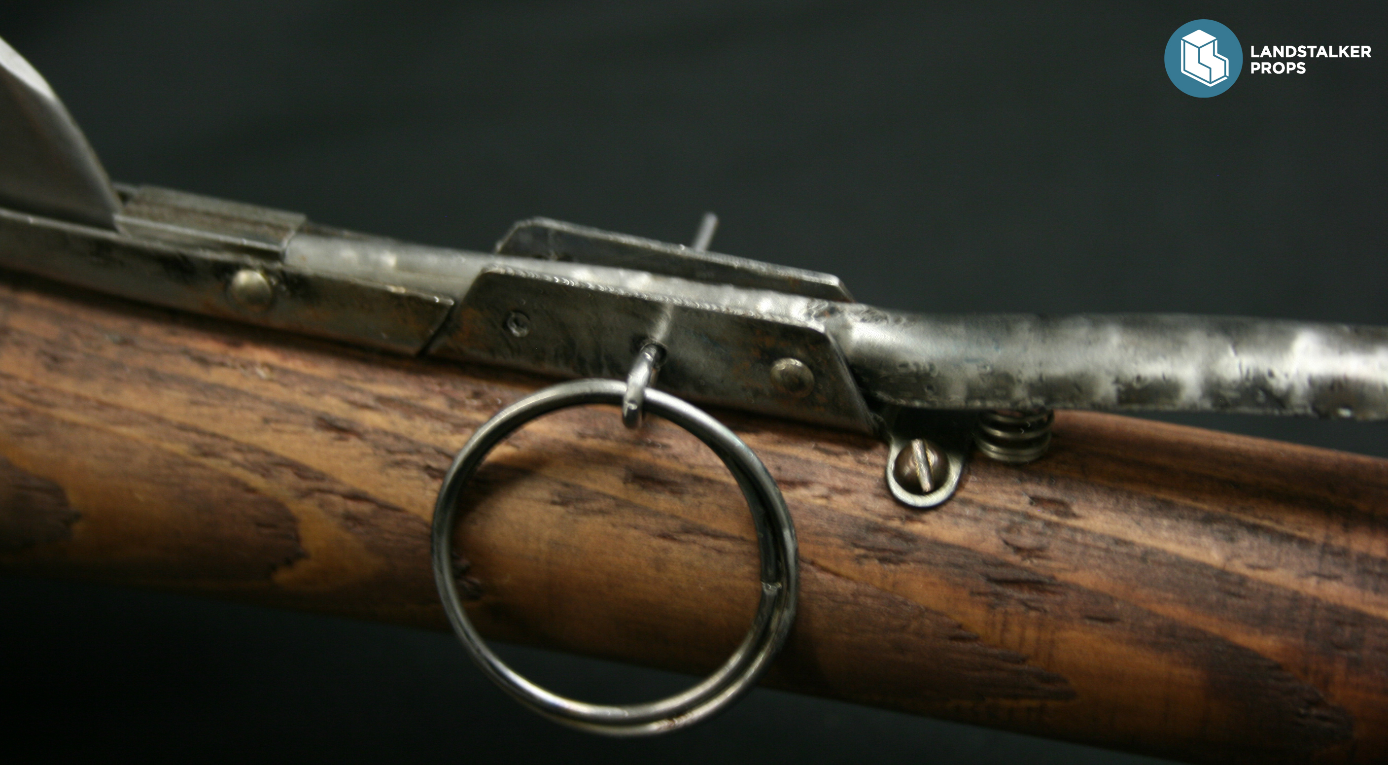

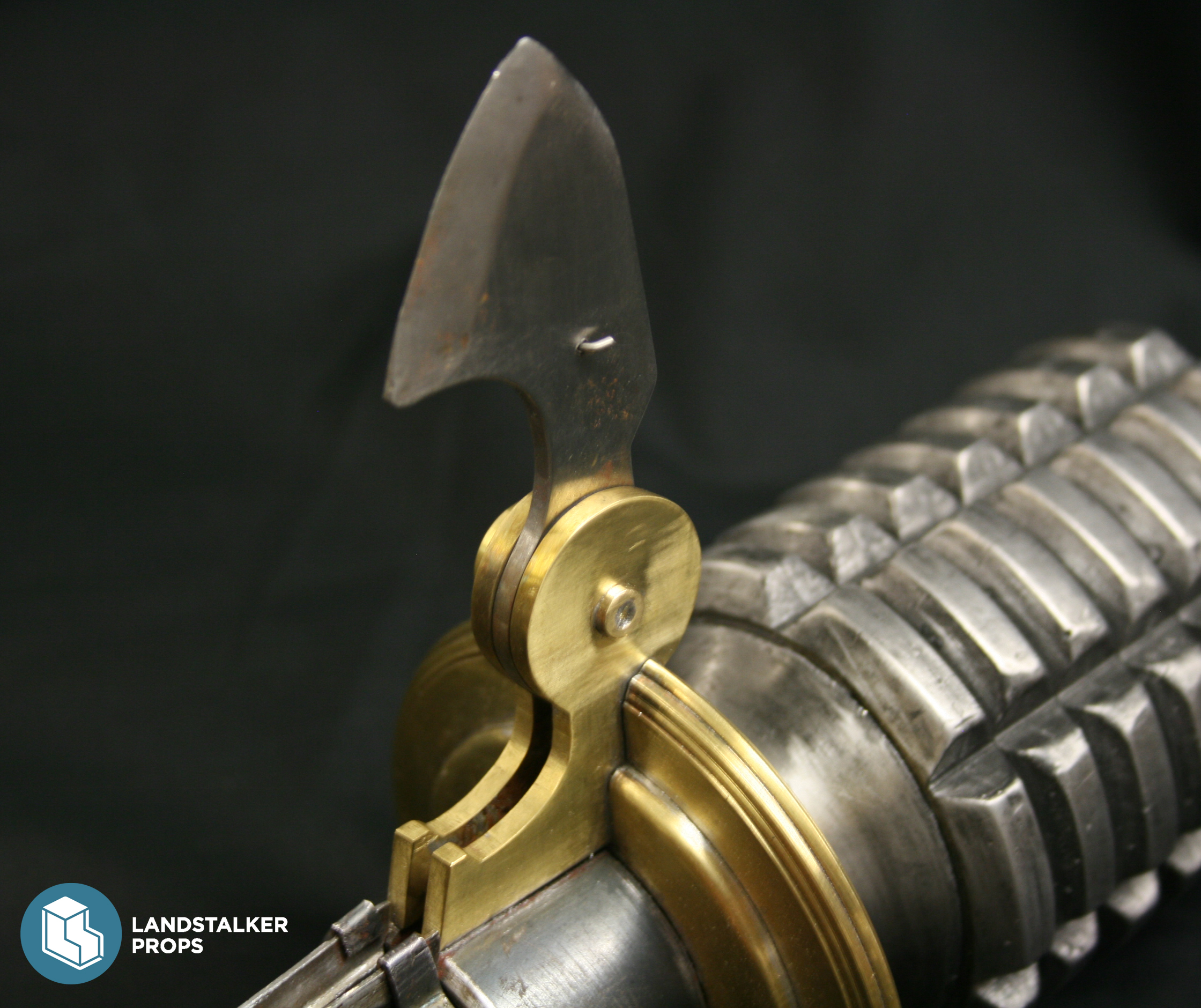

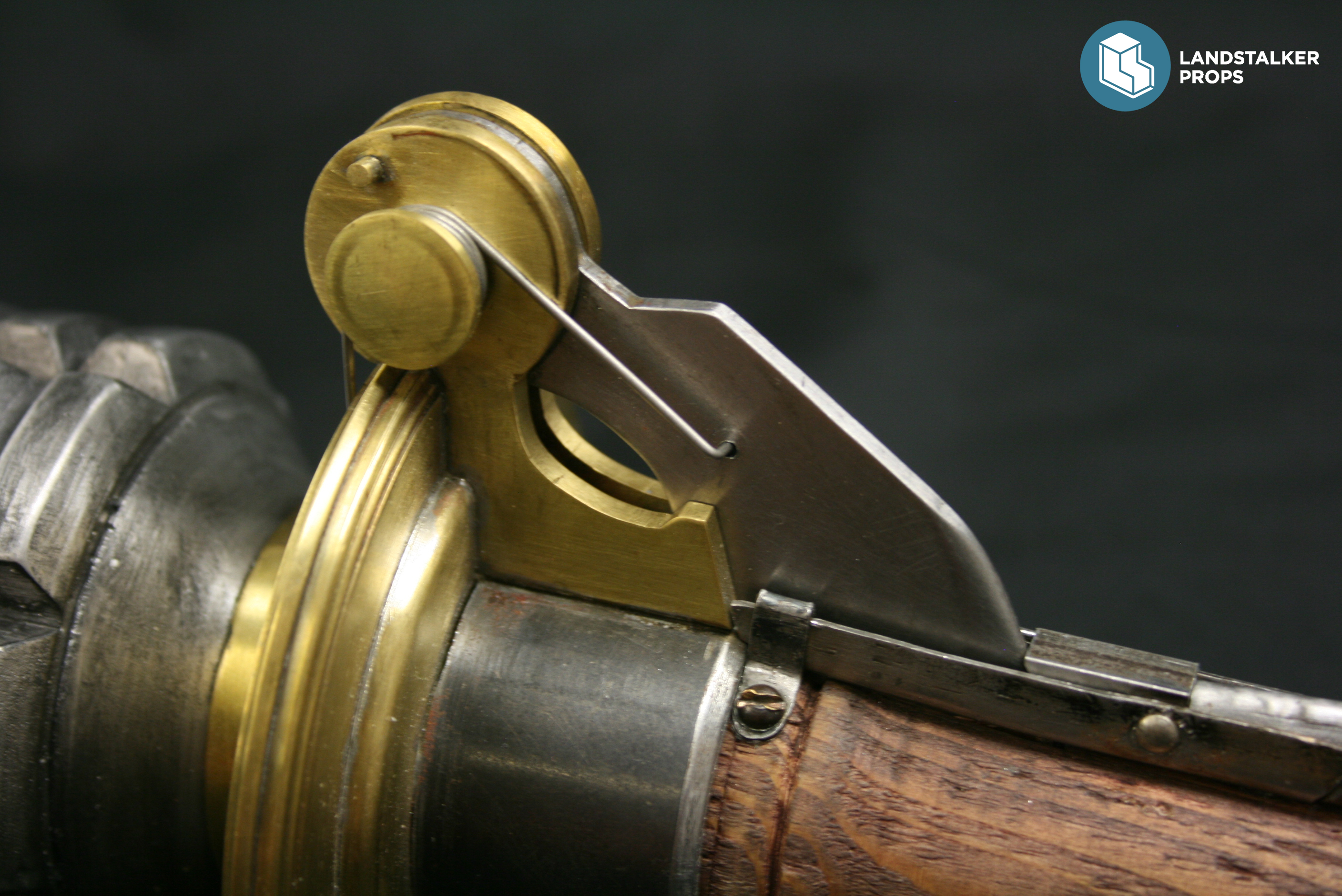

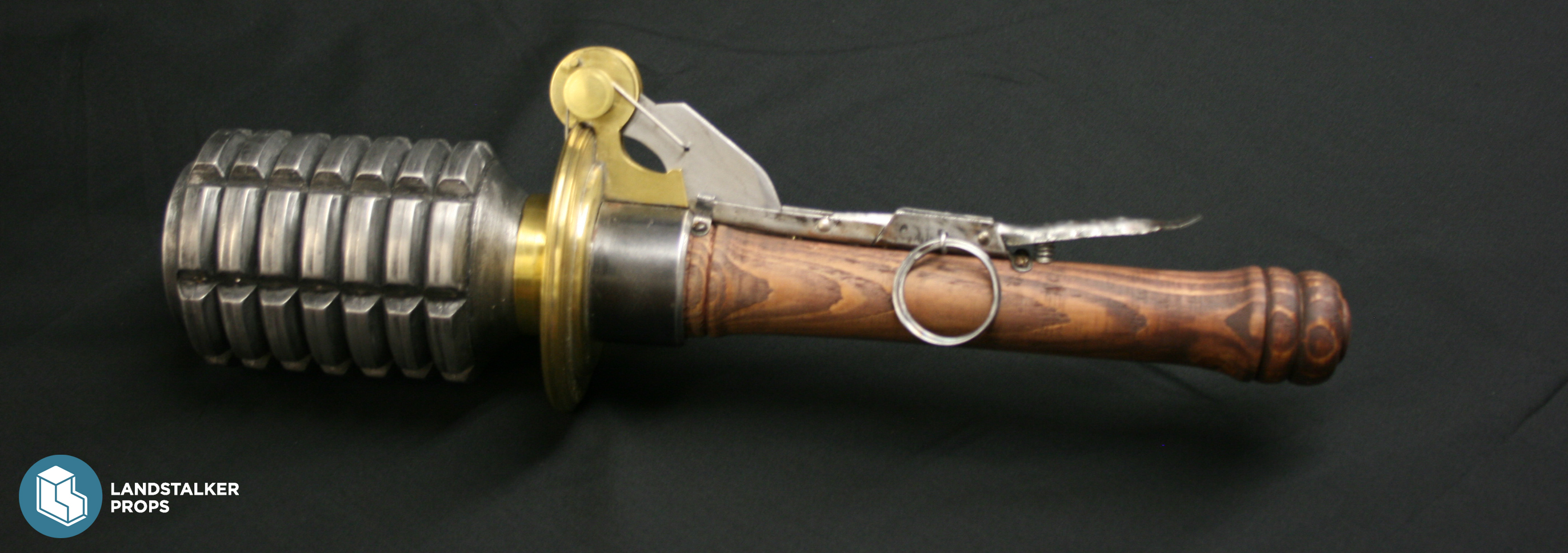

The handle was lathed from a block of pine and stained the correct colour, the brass parts were cut from 3mm brass sheets, lathed and then soldered together to make the central piece.

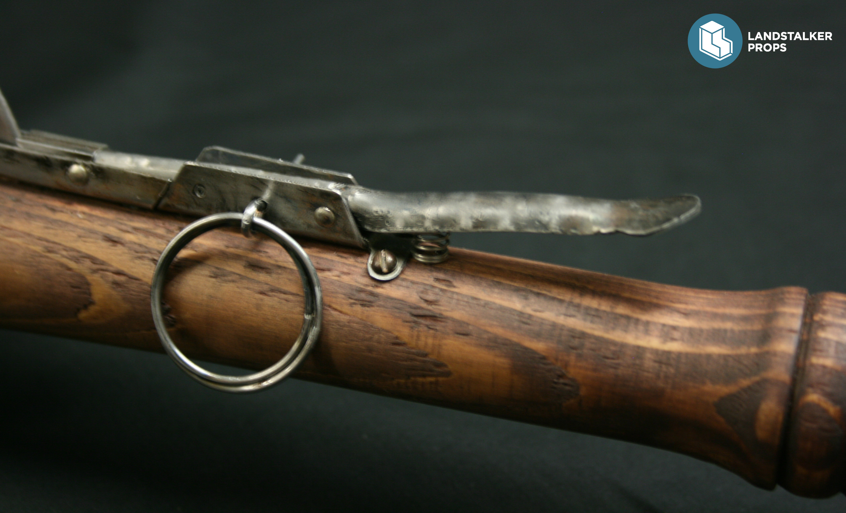

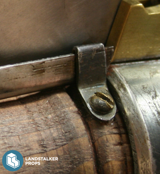

All of the release mechanism (which actually works), the blade and the collar are made from mild steel. This was cut, heated, hammered and forged into shape to make the parts. Everything is screwed and fixed with mini rivets.
The blade is spring loaded and sharp.

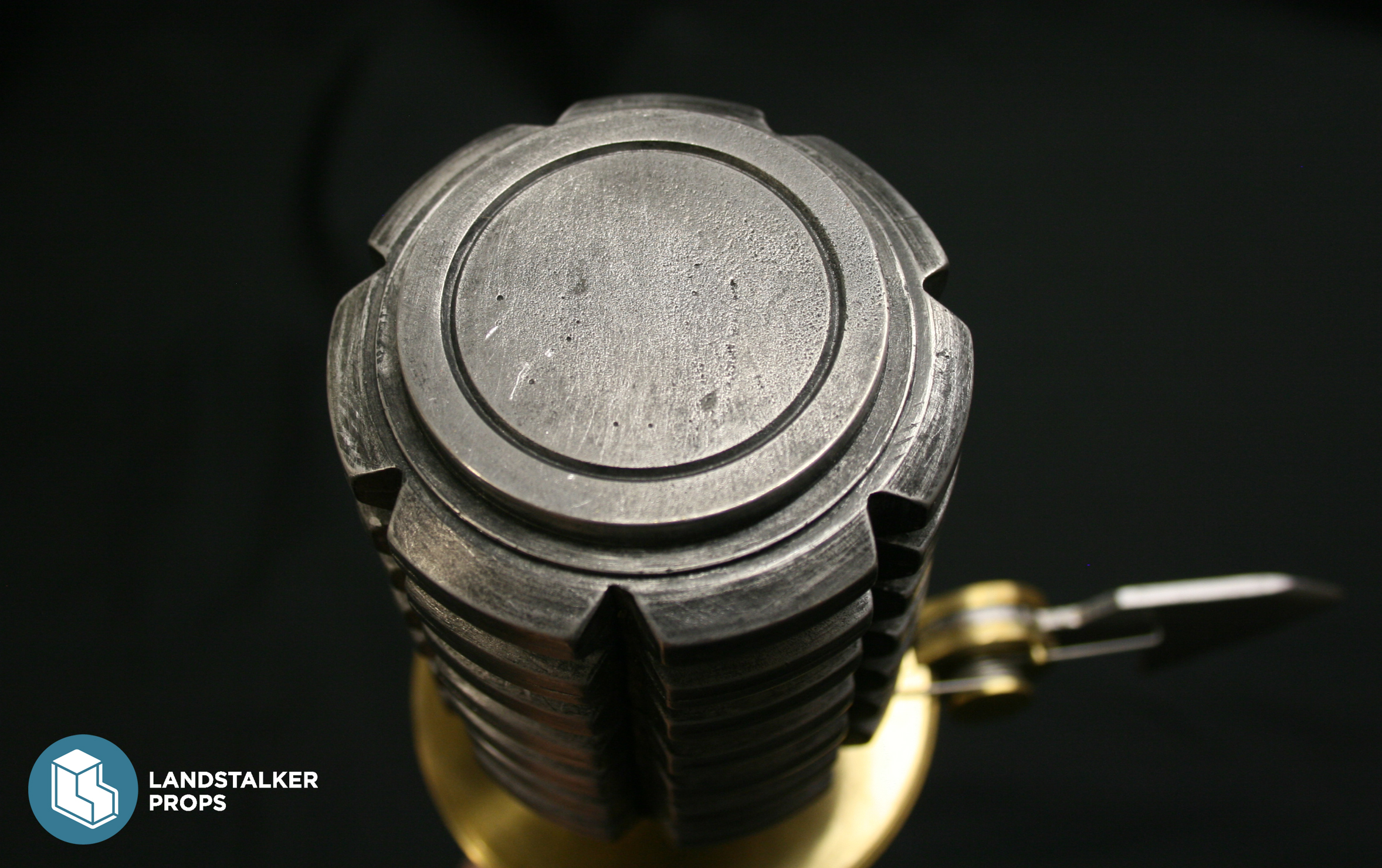

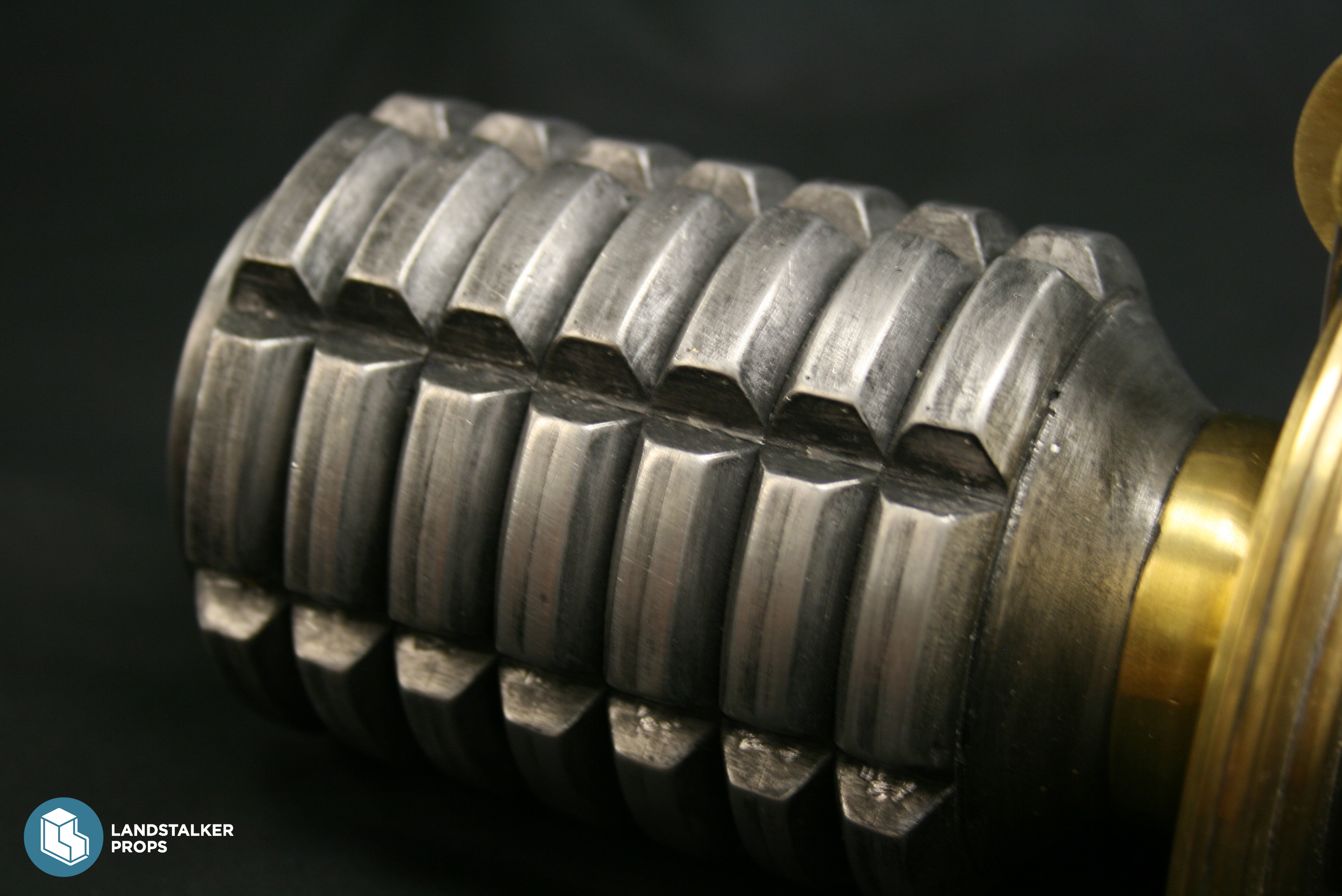

The actual grenade part was cast in seperate sections which were soldered together on the inside to join them into one piece. Casting these was a real pain but the finished result looks good.

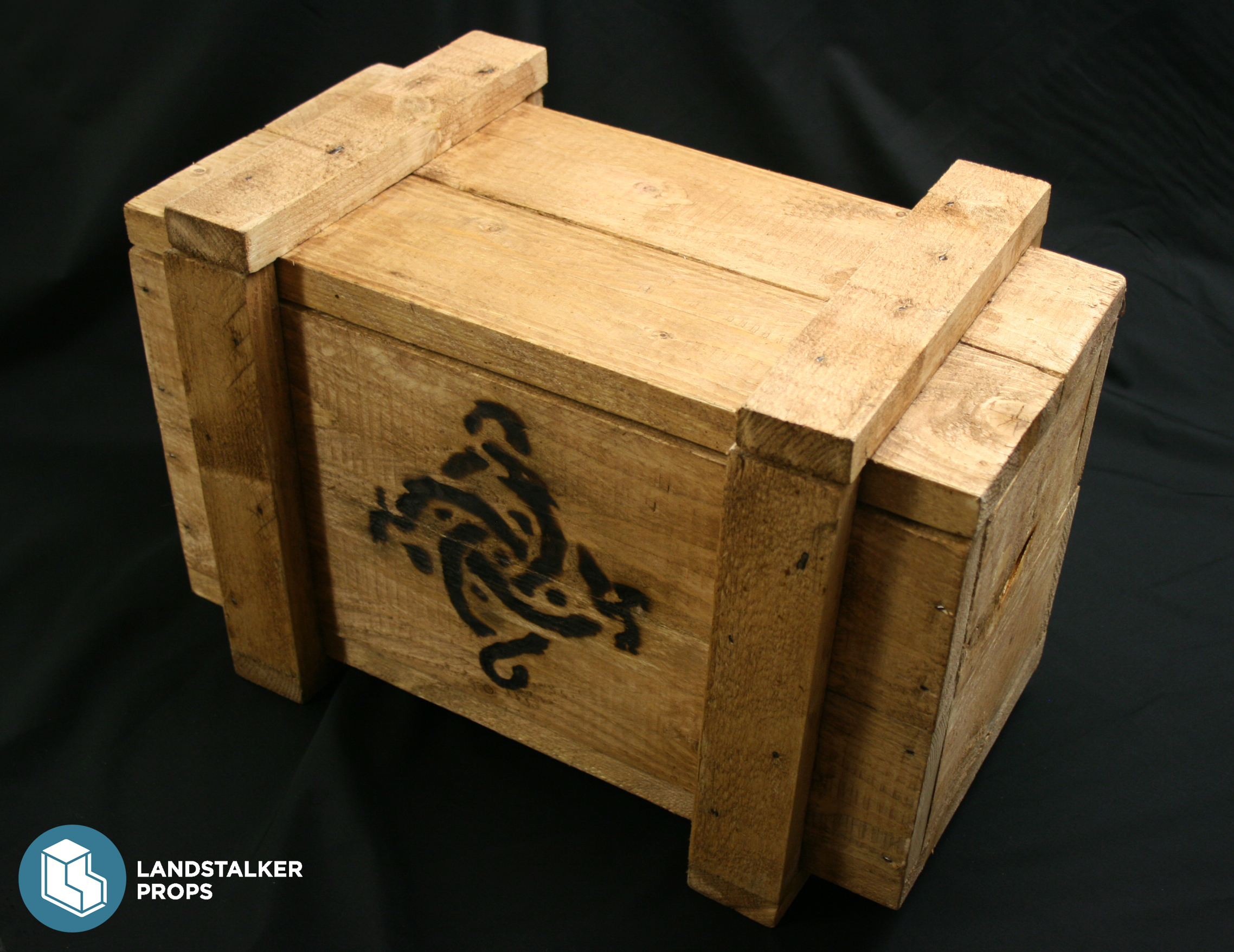

Finally I decided that a crate would look cool as they find some weapons in crates during the game. This was nailed together, again no modern screws and fixtures, stained and then The Order logo was burned on.

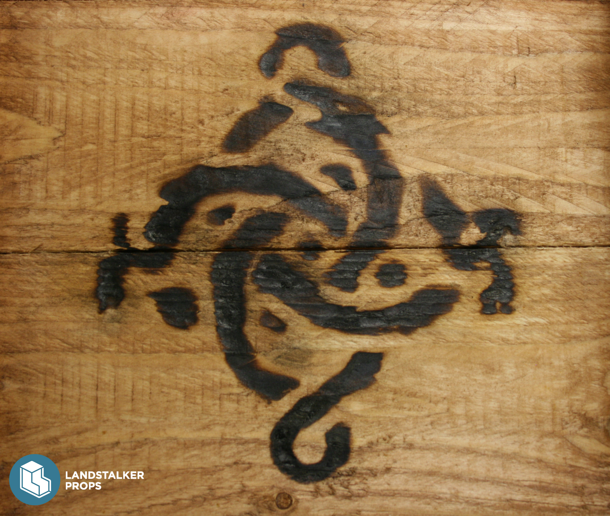

This really should have been branded but making the logo out of metal just for this would have been a little overkill. I opted to cut out the design in a sheet of 6mm MDF. I soaked this in water to stop it from catching fire and used it as a stencil for a blowtorch.

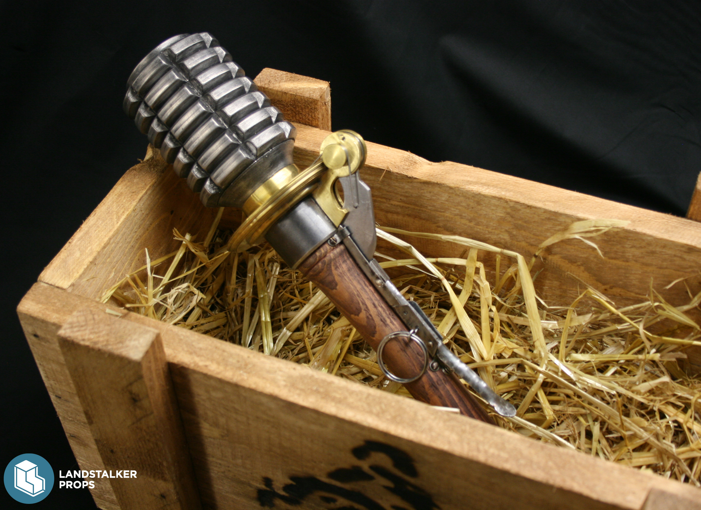

Some straw for packing, just like the game, finished this prop off.
