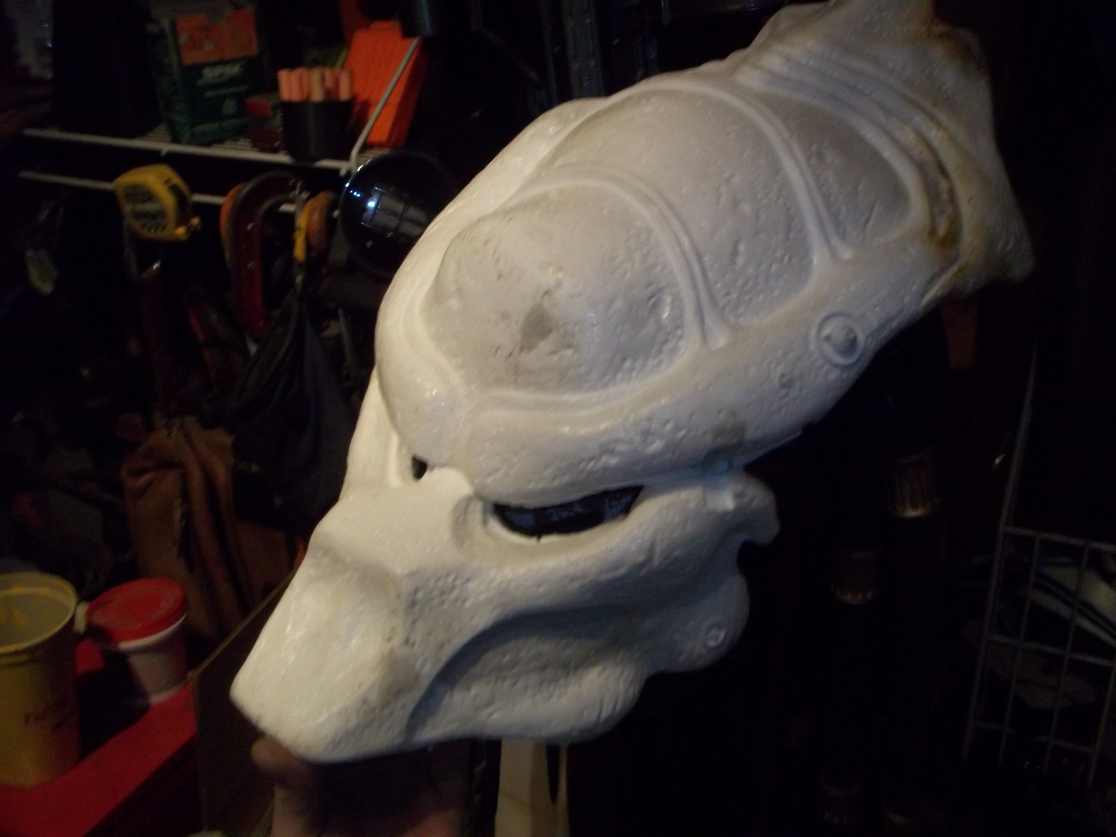

Ok, Here we are with my ongoing project of the perfect Predator! I appreciate everyone who makes the lair! Thanks to many great huntorials and great communication of good sellers it has been an enjoyable time. On behalf of you guys, Thank you! I never thought i could own such great costume pieces. So far, I am creating a Boar like Predator with a southern name twist... "The Hogg". Thanks to Gene I now have a Boar bio. Hell, I figured the weather in deep South Mississippi in the Summer is alot like the Predator planet, Hot,thick, humid air...My apologies also to Gene as that, although a beautiful sculpt the Boar bio is, I always felt it was missing a target helmet laser. I will do your bio justice! I am using Fast Burst lasers with a finger touchpad. Also using a combo of Apoxie sculpt and mechanical parts. Thanks to Casey, I now have a Superfine DBP1 version 2 mask and to Mr. Fett for the P2 Mandibles for variation. It's gonna be a toothy guy! A head somewhat like the Snake pred. I am also using Bambooie Dreads, Master Anubis AVP blades, Monsteroom Thigh armor and gauntlets, and Tokyo Rose quills. I am actually doing a helmeted version and Unmasked version heads due to extra dreads and half mask. Hey, to my knowledge, Kevin Peter Hall never wore both a bio and full undermask. He had a halfmask with the helmet i believe. That is ALOT to see through! I really want the costume to FUNCTION, hence the holes in the side of the mask i cut that line up with my ears. Hearing is good! I also have a built in microphone speaker in the back pack to talk through. And finally, I am still waiting for Prop_Fiction to send me the sound system I paid him for. It will have finger touchpads with all the Predator sound effects! The body suit was made from scratch. I sewed a wetsuit pattern out of spandex, carved muscles from foam, and layered it all up with 5 layers of Latex and acrylic paint with strings and foam balls mixed with monstermakers to make it stick. It is very breathable and stretches with your body like a second skin. Bodysuit Still in 1st layer paints.

Oh hell yes! This is already off to an excellent start! Did you fill in the Bio's cheek area with apoxie?! What a GREAT idea! You've changed the Bio's look - nice job! Looks like you also heated up the fins in the back and bent them down a bit? Cool work man...

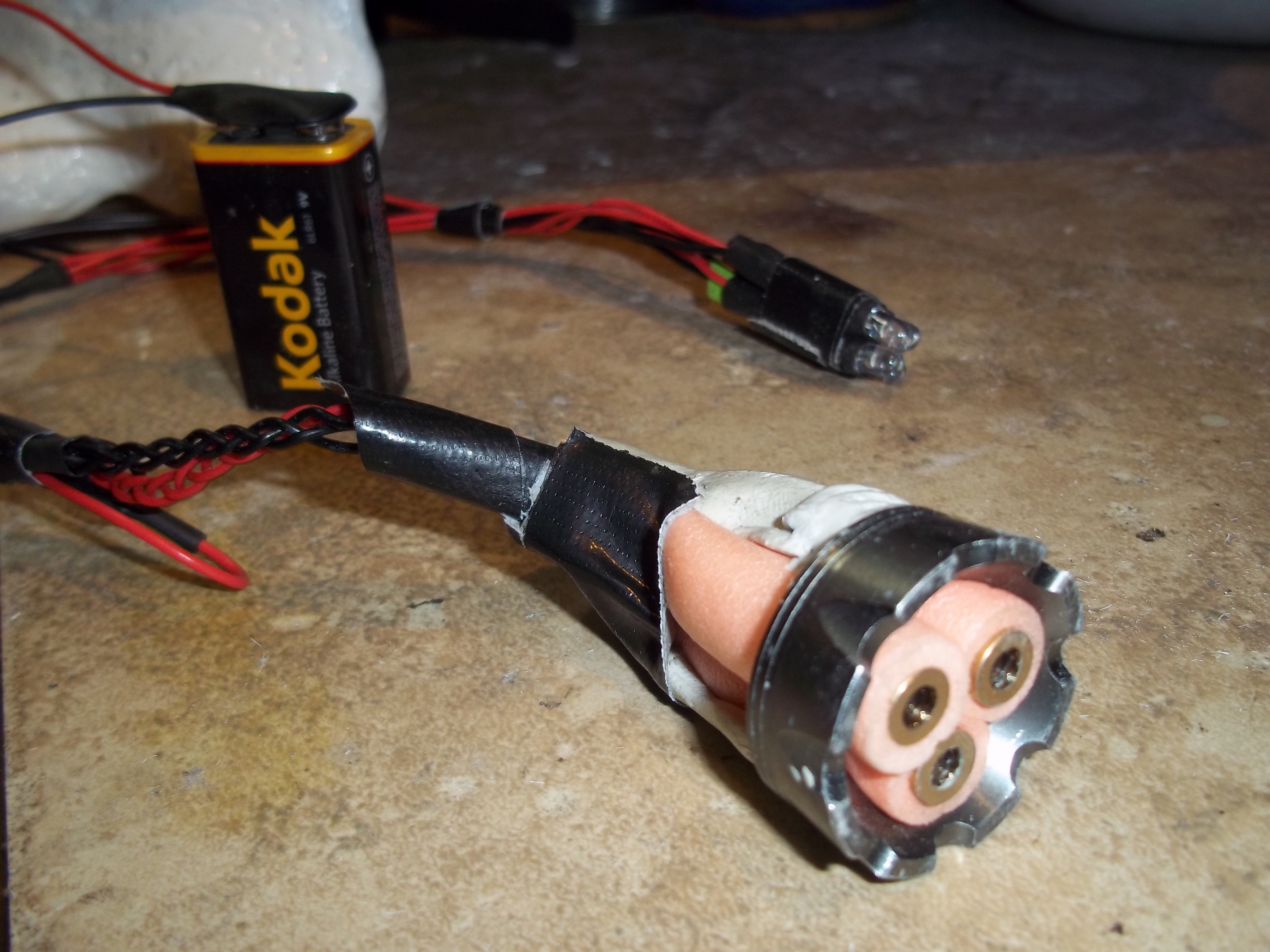

Ok, guys! Well, I haven't done much but here are a few more updates. I dremmeled the mask down in a few choice places for the tri-laser to fit in. I am also putting red El-wire for the Hogg Eyes. You can see the ledges dremmeled to fit them. The laser housing was built using a combination of 2 part Apoxie sculpt, flashlight pieces, and Nerf darts. (Soft,bendable Nerf darts to align the lasers into a perfect triangle pattern) MUCH, MUCH more painting is to be done. Just trying out different colors but really like the aged copper look of Predator 2 AND of course FastBurst lasers with finger pads which are awesome! Any suggestions are welcome. Hope you enjoy a few progress pics!

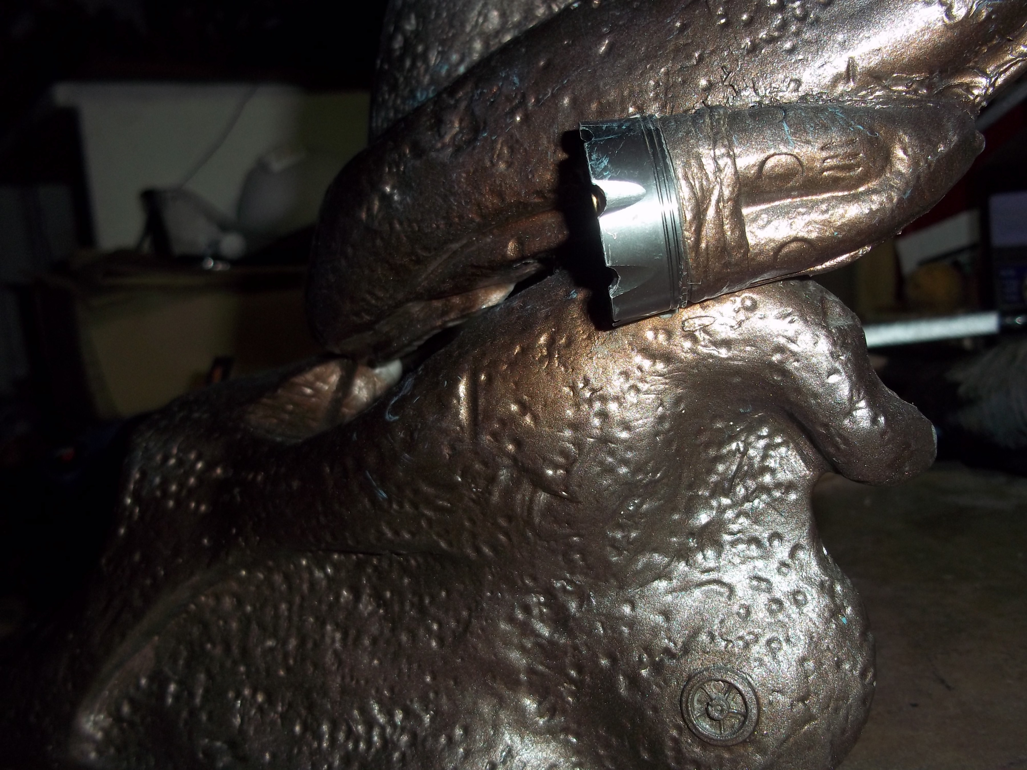

Here is my latest update on The Hogg. I have made extra quills using toothpicks coated in clay for release and then are double coated in an acrylic latex black. I have chosen a P1/ Boar type paint up on the skin. I also now not only have P1 style shoulder but also a P2 style shoulder. I will be using the larger shoulder bells for this guy. I am going for the ever difficult P2 paint job on the armor. I have already used five colors on the helmet and need about five more for that unusual color changing armor of the P2. Still got to put lenses in the helmet but is looking pretty pissed off like most hogs are down here in the dirty south...Hope you enjoy.
Alright! Here we are with the latest updates on the Hogg Predator! I followed huntorials and collected pictures of many paint ups. BUT, i still like the P1 best. It is at least insired from the P1 but in a Boar kinda way. The colors I used were White, Yellow, Orangey Brown, Brown, and Black for spots and blending. This took about 5 hours done by hand. (I have really gotta get an airbrush sometime) Still gotta paint the vieny inside mouth, nasty teeth, quill it, dread it, but I love it! I needed to do this as soon as I finished the body so the head would match up colors that I mixed. Hope you enjoy!
