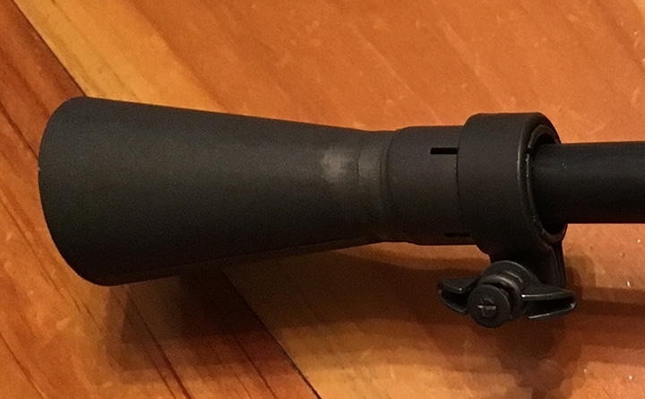

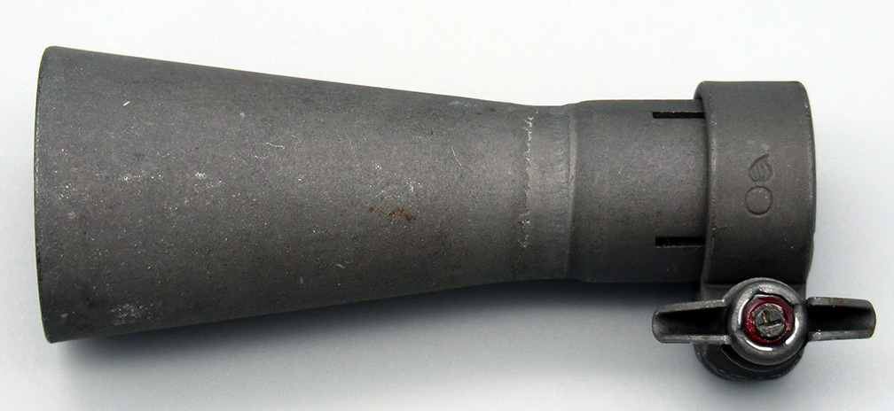

No US Army Ordnance Corps insignia on the M9 though?
If you look reeeaaaallllly closely at the B&W photo of the left side of the Greedo Killer, you can just barely make out part of the mark. Not surprised you missed it, but if you know LFC M9s, you know it should be there.
That's crazy (and amazing).
I appreciate it honesty and I’ve seen that on other real m9 FH’s but truthfully I can’t make it out at all on the actual film prop so I simply left it off. I can imagine it’s one of those things that is on most if not all of these real FH’ers but I couldn’t bring myself to add without actually seeing it.
This is the best pic we have of that side I believe..
The 48th Ronin so u got me to go down another rabbit hole last night trying to find a FH without that detail to see if one exists. There isn’t enough info out there one way or the other that I could see so I added it into file to see what it looks like..
Well, I dug through my archive of pics - mainly saved from other members' builds here on the board - and did a cursory web search, and ALL of the LFC flash hiders that I have seen have the marking. It's absolutely possible that some may have had a poorly stamped marking and/or a partially worn-off marking. Just thought you might want to know, since you were so meticulous about every other little detail. I think what you added looks great. (y)
Out of around 10 flash hiders that passed through my hands only one didn't have the mark ... I kept it because I also cannot make out the mark on the Greedo Killer picture.
