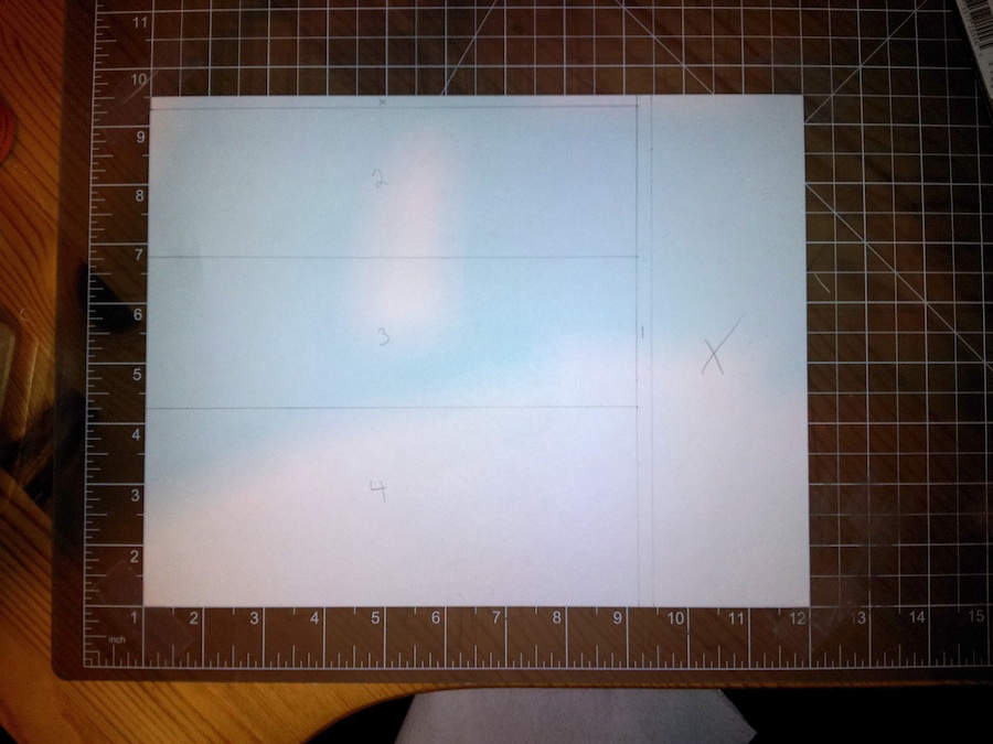

1) I started off with what seems to be the generally accepted size of the stones and reduced it by 1/4". I would use the paper version to then create a styrofoam version.

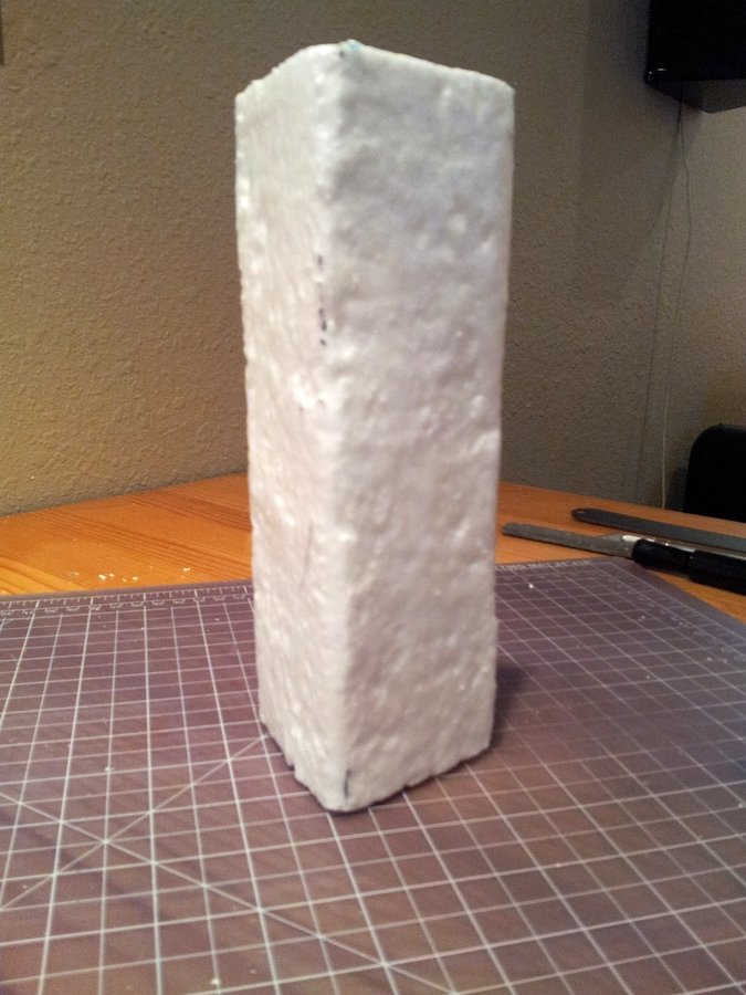

4) This next move was skipped the first time I attempted this. Basically, the styrofoam is to soft and would probably get destroyed by the process of adding clay and if not, pieces of styrofoam would get into the clay when I tried to remove it. So, I wanted to create a shell that could handle this process and since I had some bondo left over from my previous project, I figured I'd go with that. Unfortunately, this would be only the second time using bondo and the heat from the bondo basically destroyed the styrofoam. :cry Learning process I suppose. So, this time around I put a glue coating around the styrofoam to ward off any potential issues. Thanks to a friend for suggesting that! Here are pictures of the glue version of the stone.
5) This time the bondo worked and I have a nice hard shell. After a few thin layers and some sanding here is how it sits now.

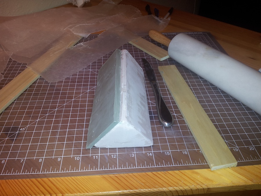

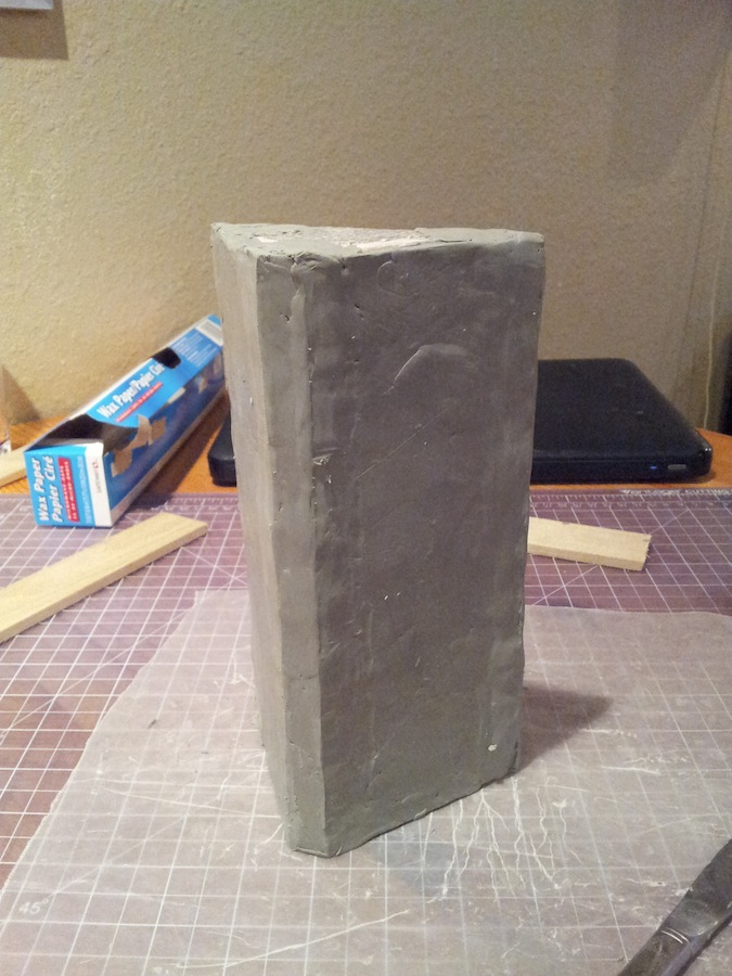

So, over the weekend in my <sarcastic>copious</sarcastic> amounts of spare time, I picked up some clay and got started. I ended up going with Roma Plastilina #3. I need about a 1/4 inch worth of clay around my fake stone so I picked up a 1/4 inch piece of wood at Lowes and took a marble roller and flatend out the sides. Here are a few progress pictures.

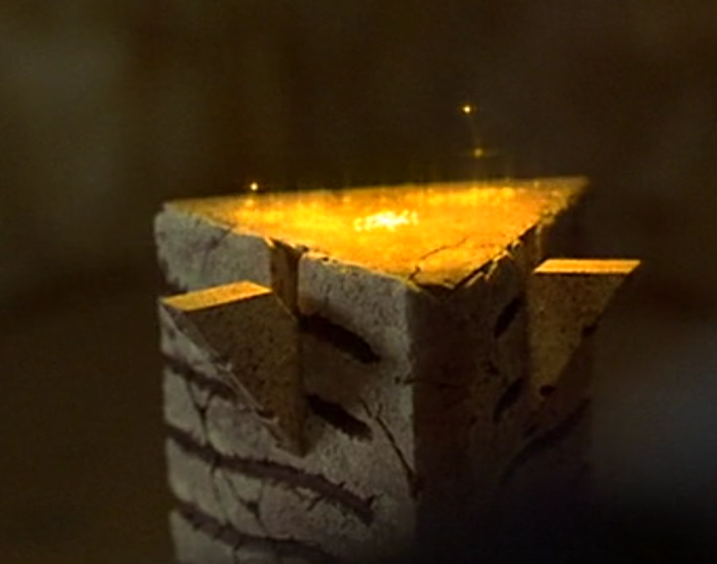

I'm not sure on the best method for attaching the clay to the bondo shell. Any thoughts on this would be appreciated. Also, I played around with getting a rough texture on the skins but really wasn't getting the look I wanted. I think I'm going to head over to Lowes/Home Depot this afternoon and look at their bricks and tile sections and see if something looks close to what I'm after which is depicted in the screen grab. Hopefully I can use something like that as a stamp.
If you notice the rough surface, that is what I am going after. The deep gauges I plan on making after as well as the elemental patterns.

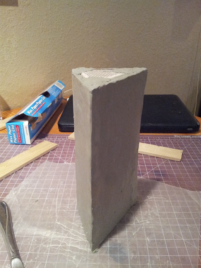

I also ended up taking a wire mesh and wrapping my fake stone with it so the clay would stick better to it.
I've also attached the sides and started working on fixing up the corners. I still have some work to do before applying any sort of texture, but it's progress :)
