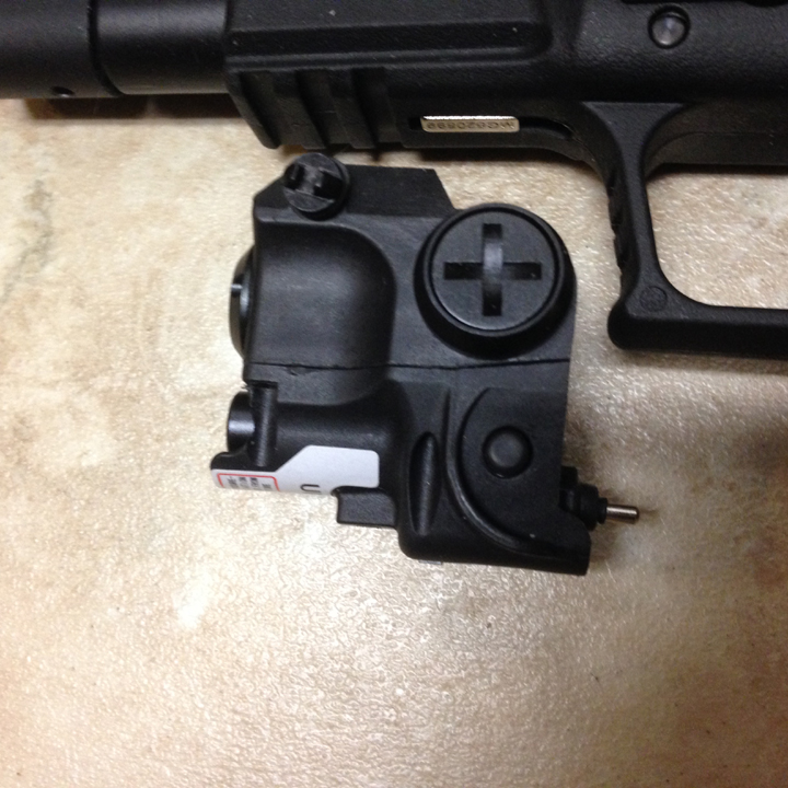

The Martina Pistol Laser/Flashlight attachment arrived today USPS. I am still sanding and refining the Helix pistol parts. But here is a pic of the new attachment:
The part identification was DEAD ON !! Thanks for the input.

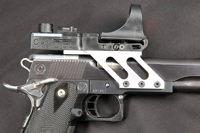

I noticed the pistols don't eject too.
However, having the port covered when the slide is closed is not a big deal if the cover is mounted to the frame, as they eject above the grip, not above the trigger. Many times you'll see competition race guns with the ports covered over the trigger.
Example of what I mean:
BUT . . . those mounts looks to be mounted right on the slide.

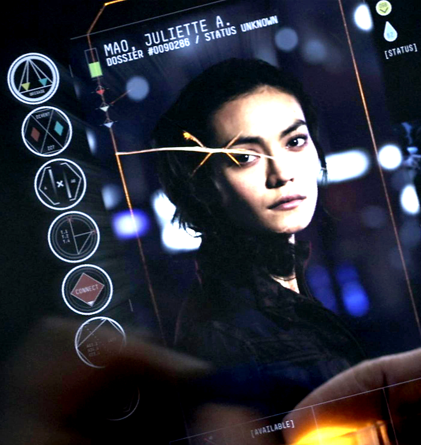

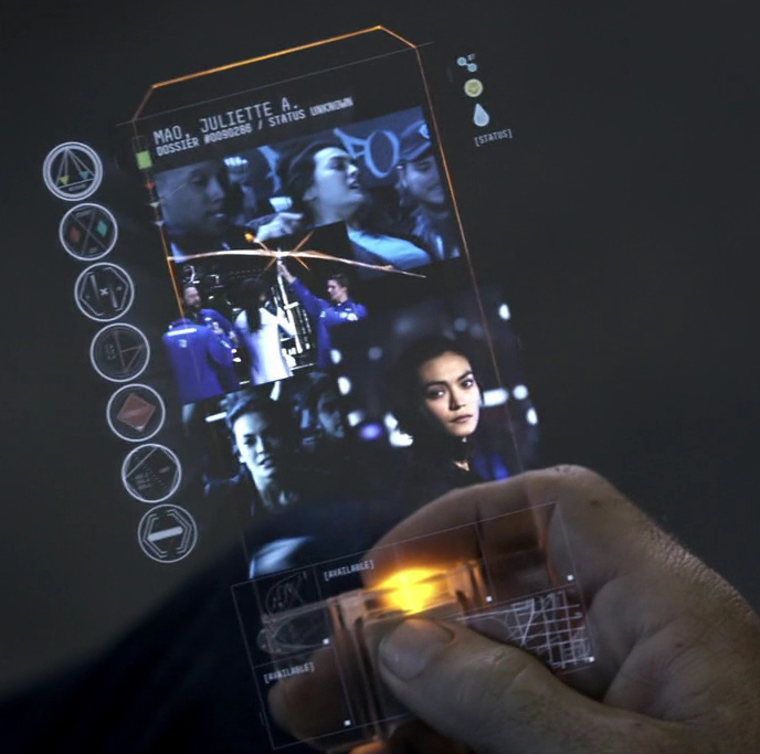

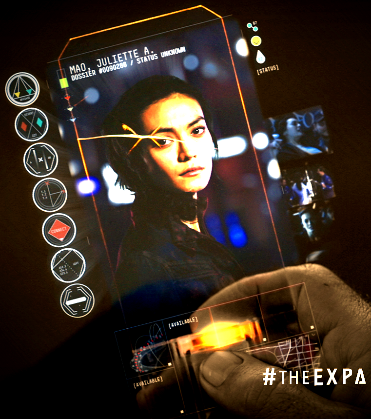

Attached retouched versions of the best pics I could find of Miller's terminal. Other terminals have some different icons.

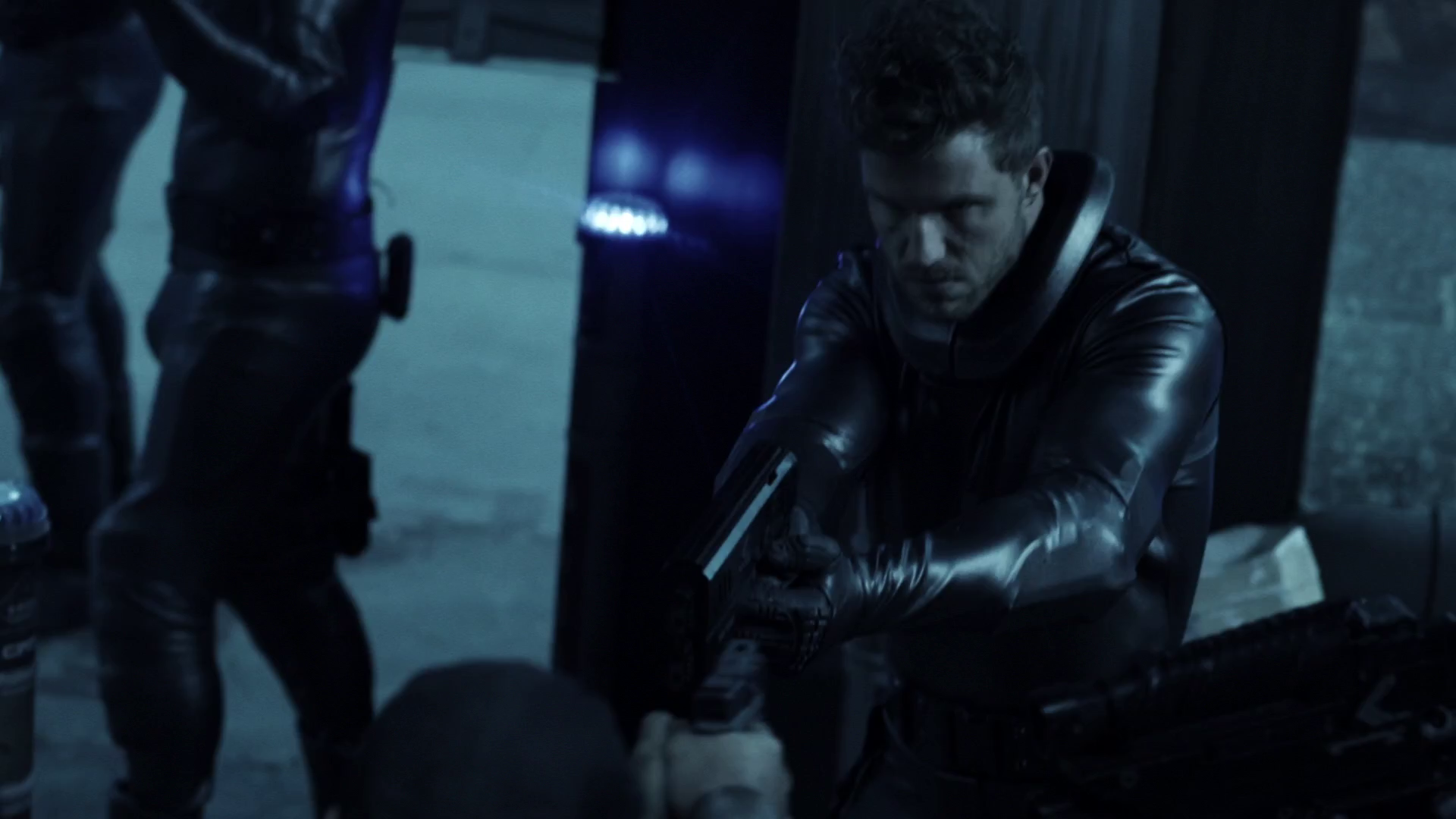

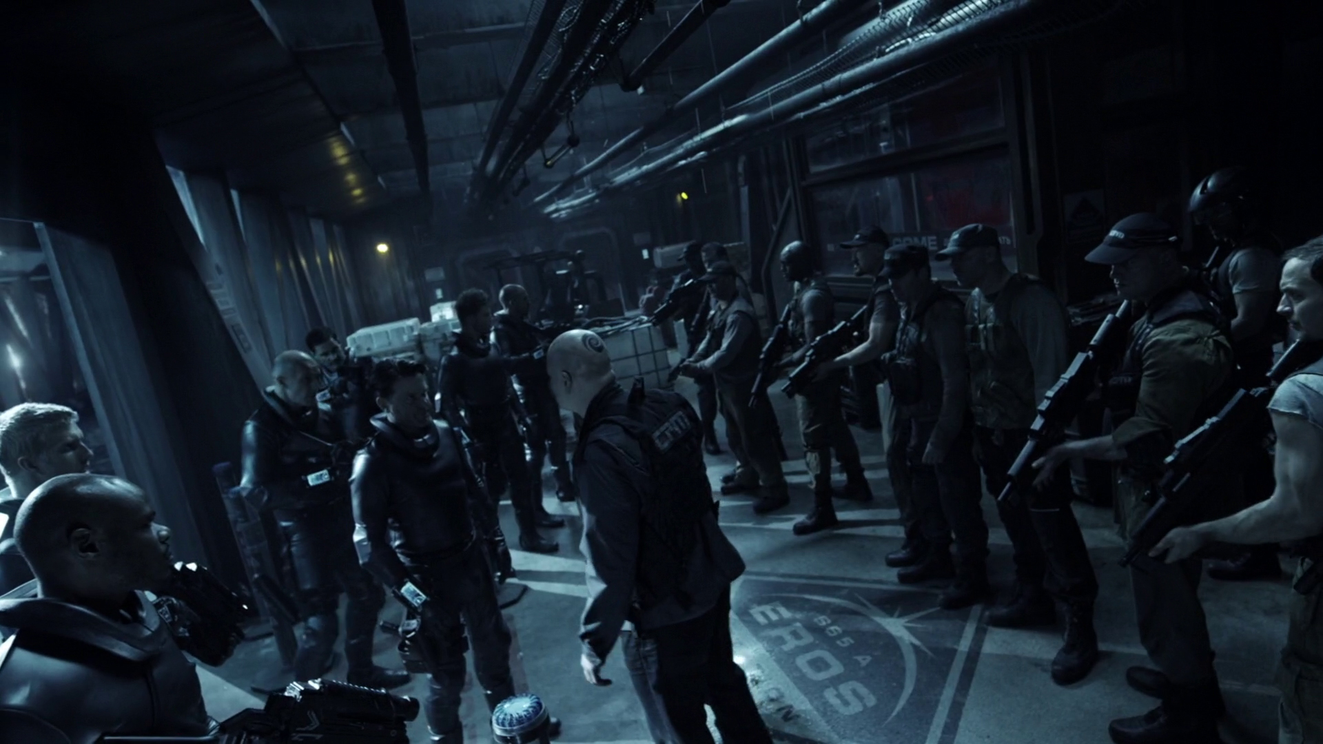

vlcsnap-2016-02-09-21h17m33s709.png ProtoGEN pistol shows up in the last shoot out on the docks. Smaller version of the rifle.

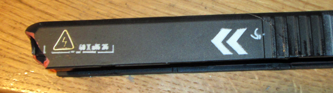

An afternoon of misadventures today :(
I dropped the slide - which I had finished modifying and sprayed flat black - and it actually shattered in several places! Fortunately I bought two guns in case of errors, so I can replace that.
Then comes the graphics, which are downright pesky. Being white on black, you can't actually print them onto waterslide decals, since you can't print white with an inkjet. I tried laser cutting them on white adhesive vinyl, but even the lowest power stains the vinyl yellow :unsure
Next attempt - cut a mask and spray over as a template. This was more successful, but open symbols like the warning sign don't work with a stencil at this size - too fiddly. I glued the broken slide back together as a test, with the warning symbol cut from vinyl - you can actually see the yellow staining in the pic. So looks like I'm going to have to cut it, spray it white, then apply to the gun. These decals are pretty tiny, so it makes it all a regular pita!

Appears to be, yeah. I haven't gone frame-by-frame yet, but I wonder if they just cut the stocks off.
-MJ
You are likely right - removable stocks. Everyone else (ProtoGEN mercs) on the docks are using the Airsoft Grenade launchers for rifles.
