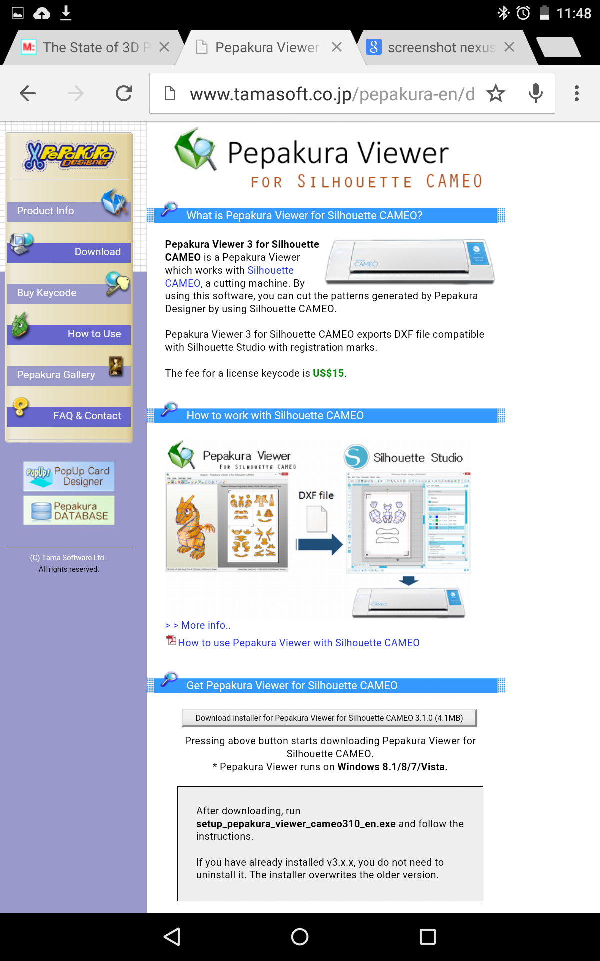

I tried following that guide first, but in my file menu there is no option to Export DXF file for Silhouette Cameo (*.DXF)...
That is when I tried using the other guide and could not find the controller button. I'm on day 2 of trying to get this to work :cry
Then you need to upgrade which version of cameo viewer you are using. Pepakura designer and the basic free pepakura viewer will not output to use the cameo. I attached the page you should download it from. http://www.tamasoft.co.jp/pepakura-en/download/viewer_cut/index.html uploadfromtaptalk1440128943260.png

I figured it out. I used pepakura designer and was able to export it to my cameo and make the cut. I tried the upgraded version but it wouldn't install. Said file was broken. I will try that again tomorrow, my interwebs is not cooperating . The downside of living in the country- no high speed internet.
