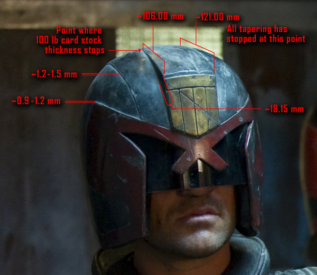

helmet_top_pepakura_measurement01.jpghttp://www.studiocreations.com/howto/dredd/dredd-helmet.html
