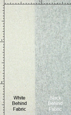

One of my friends in Rebel Legion told me that it could be “suiting burlap” from the look of it. I guess it’s a Ren Faire thing. However, hemp might be appropriate, too. I ordered some swatches of Wool Crepe (what they made the ROTJ Cloak out of), so I’ll post some shots of it when they get here. If none are a match, then I’ll take the “long drive” to a fabric outlet to see if the ladies up there have any suggestions.
