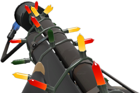

i picked up the tf models again and started on a festive rocket launcher. Witch is just a regular rocket launcher with blinking christmas lights wrapped around it. I would like to find LEDs with the same shape as the festive weapons.

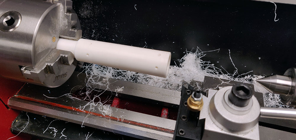

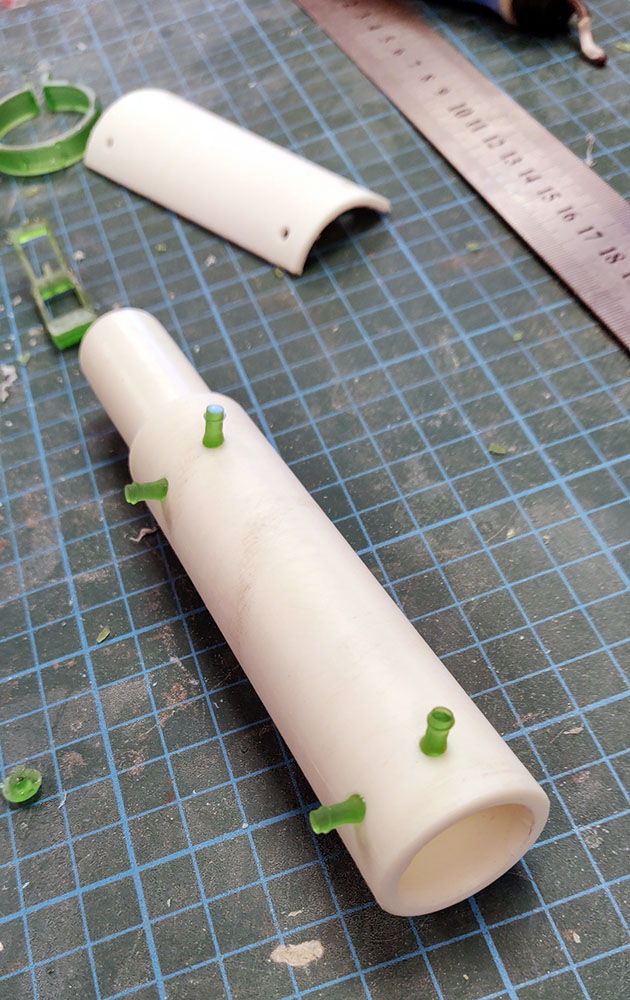

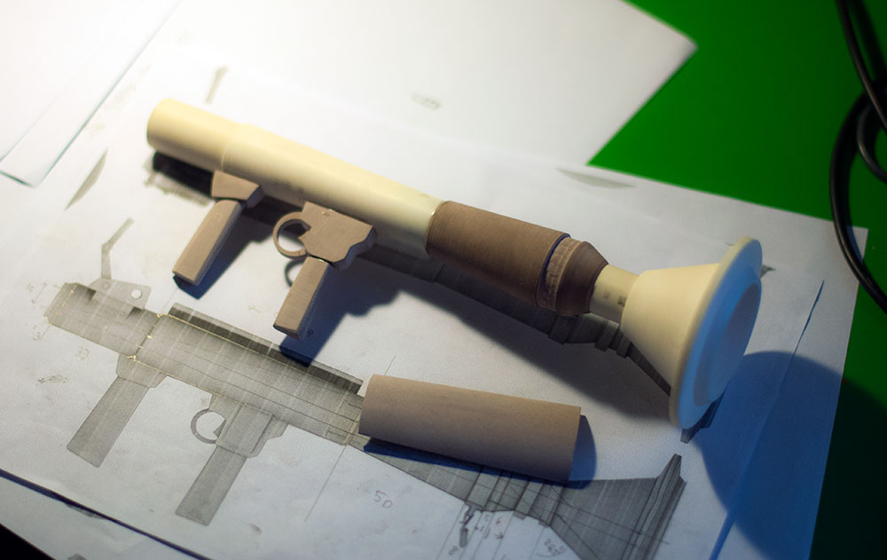

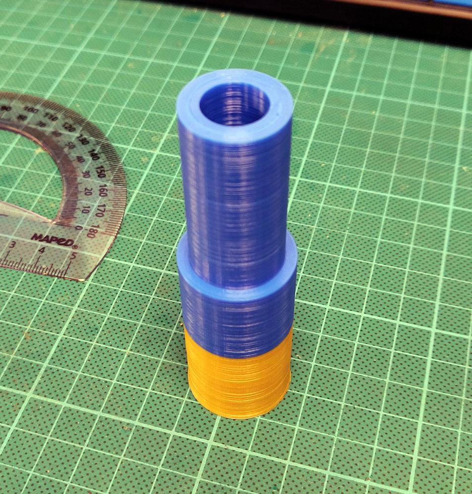

This time I am trying a technique I have been wanting to try. Print solid blank patterns in PLA and turn the parts to get a decent finish.

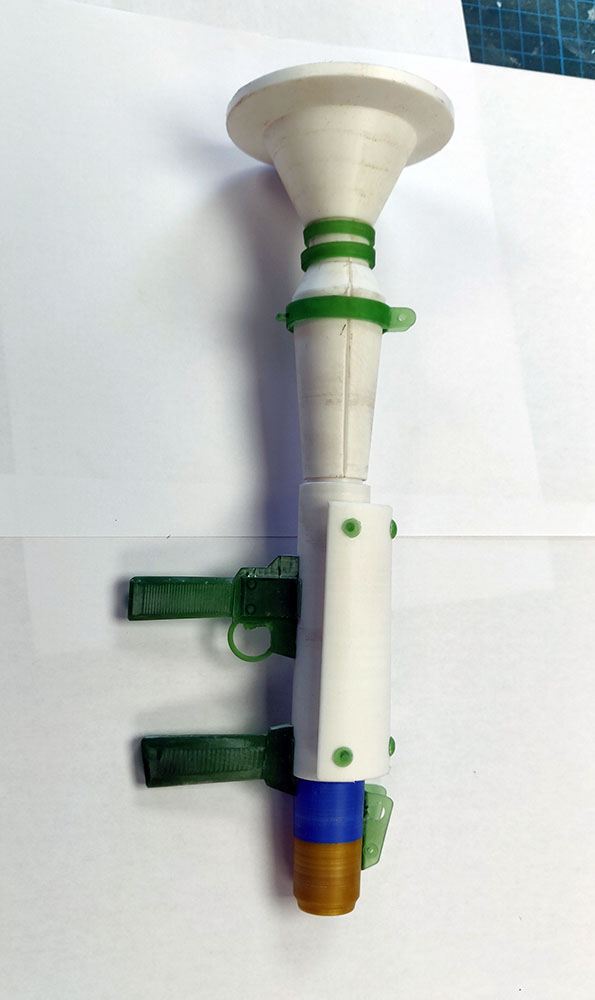

First blank pattern printed with leftover PLA

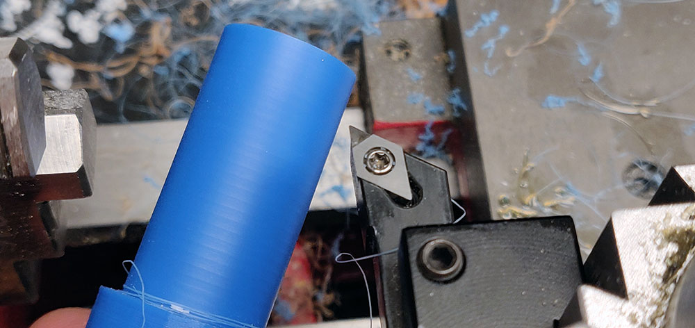

Solid printed PLA machines quite nicely with a sharp tool and light cut to keep the temperature down.
Some of the blank patters have holes modeled in so the parts will fit together like in the 3D model.
smaller details are printed with SLA

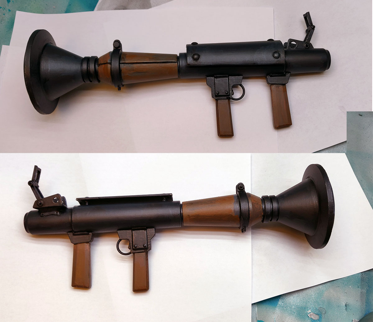

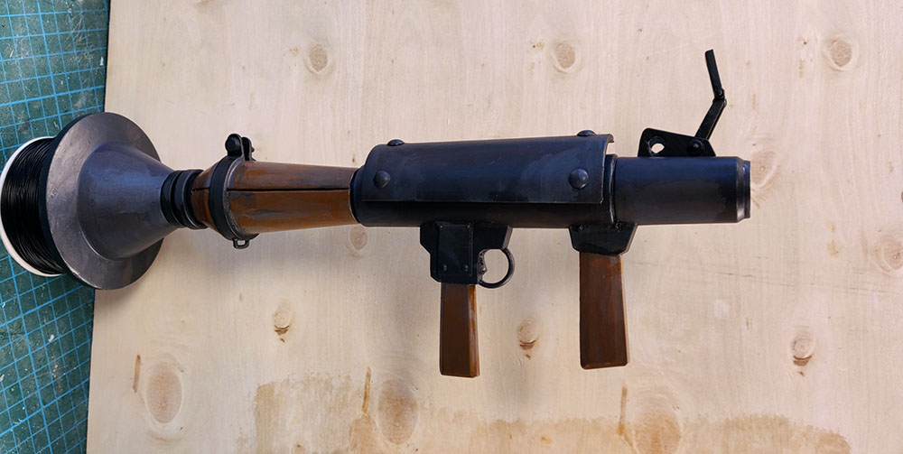

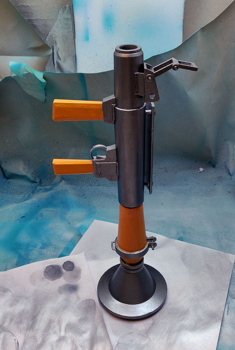

I have currently started ruining the model by painting it.
The rocket launcher is more or less finished, I need to touch up the paint. The Vallejo paint turns darker when dry so it is hard to color match the 3D model from the game.

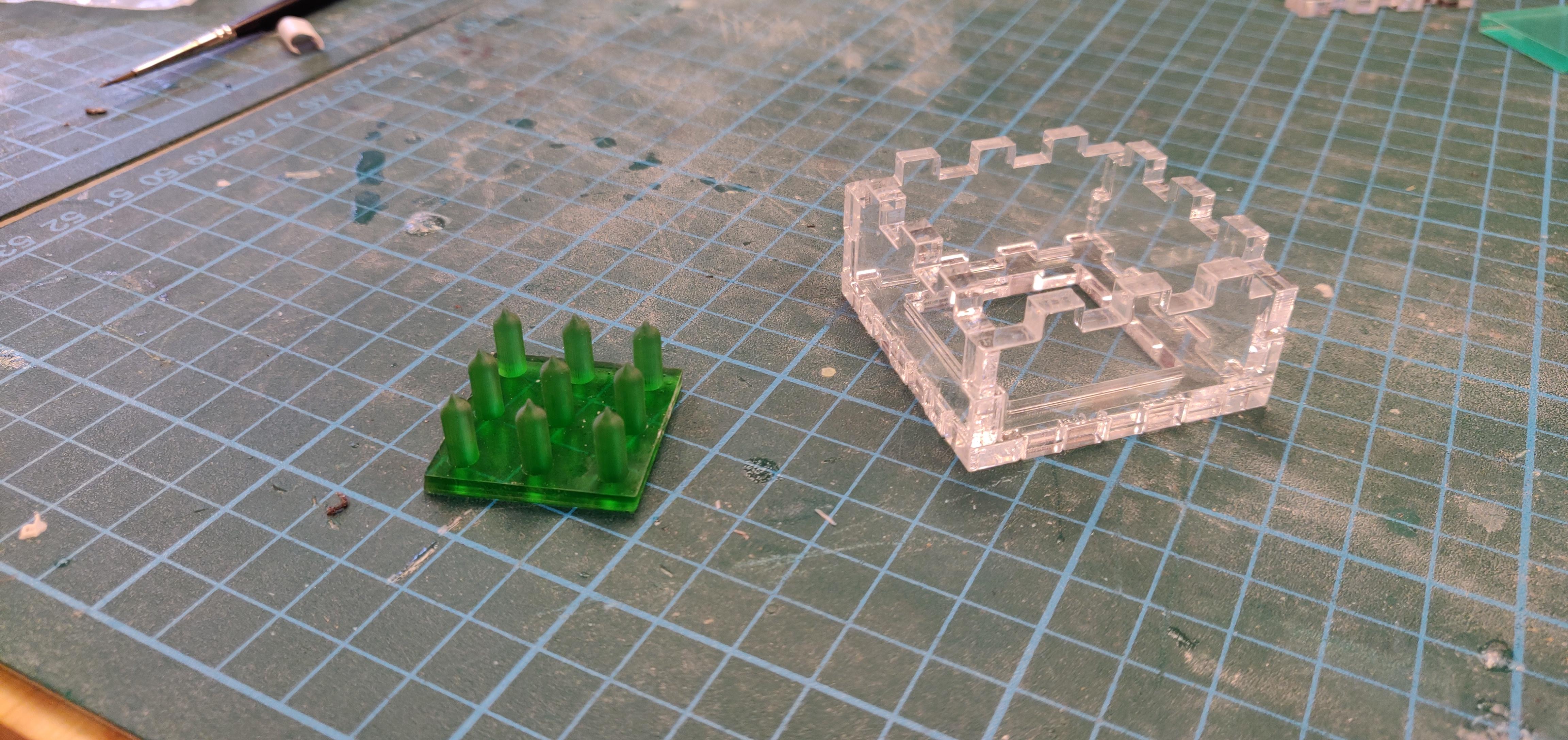

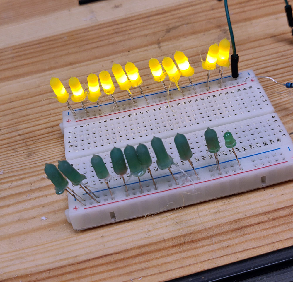

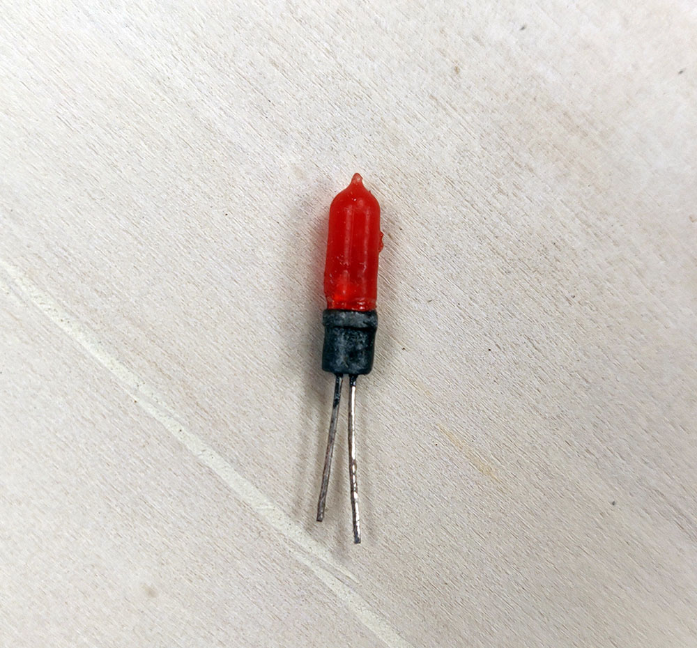

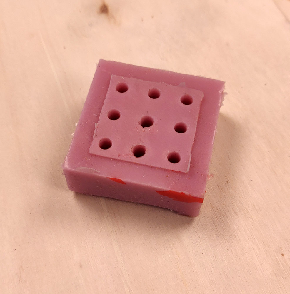

I have started on the Christmas lights, the plan was to print some Christmas light shapes and make a mould so I could pour transparent resin with colour into the mould and put the LED. This did not work, the lights are too small to cast with the resin I have. My workaround is to use coloured hot glue. I just squirted the glue into the mould and jammed an LED into the hot glue and had a Christmas light in seconds.
