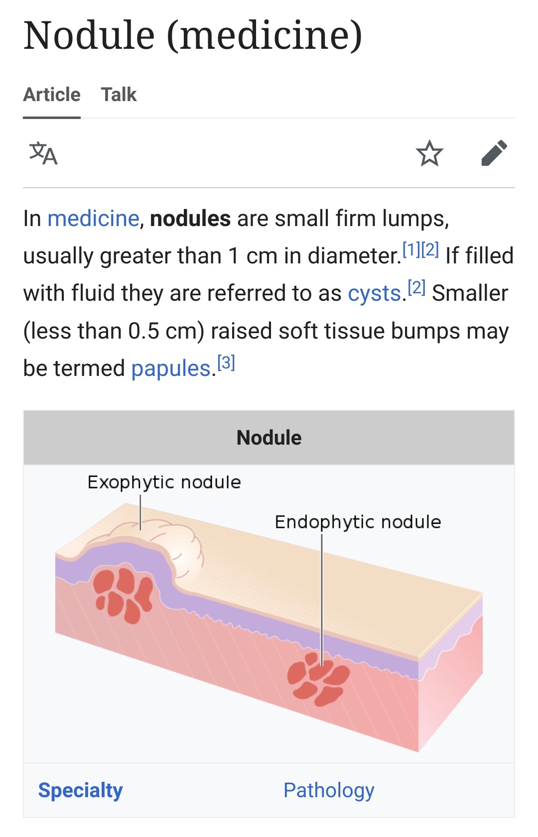

I looked at the sources a bit more, and it seems the specific part of a Taozin that needs to be included in the amulet, is a skin nodule. So off I went, googling skin nodules (not a recommended picture search by the way). Nodules are hard lumps that can form in different depths under the skin.
