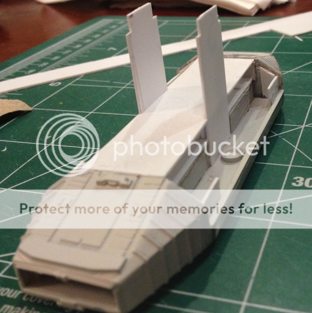

Here are pics of the flight pod that will go on
Defender. This is the original part that I built/painted (very crappily!) for Defender. I cut along the bottom section of the side "trenches", cutting almost all the way thru. However, there was still roughly 1/16" of resin in the center that I couldn't quite reach. I separated the two parts using a wedge, then Dremeled the interiors to remove excess resin.
I then used a polishing bit used for grooming the nails of dogs. It got the interior pretty smooth, which I was most happy with. I had apparently damaged he opening's a bit, so had to go back and add sheet stock and/or putty to even it up some. Still not done, but mostly there. I've started skinning the interior walls and plan to added some sheet stock to the pylon/arm assembly to thicken it up a bit.
Or maybe I'll add some half-round...?
As mentioned previously, I'm using some TOS Galactica hangar bay doors and the bottom section of a Monogram flight pod to build a somewhat large - for the size of the
Defender-design - flight pod. Ephesus is meant to operate as a ASW (Anti-Ship Warfare) / ECM (Electronic Counter Measures) ship as a Fleet Defense measure. As such, the flight pod is much larger to reflect her being able to field ECM Raptor's and shuttles. I've added some sheet stock for interior supports, some liquid storage along the walls and an LSO / Observation deck in the center of the flight deck ceiling.
The pod, as you can see above, is literally large enough to hold at least the dozen shuttles in those last three pics, as well as more auxiliary craft. There's enough room in the flight pod above the deck for one more large deck for storage and maintenance of various ships, as well as one more, smaller deck above that for parts storage and aircrew ready rooms. Munitions, such as they would be, would go on the deck immediately below the flight deck. I figure she can field roughly 18 shuttles, 40 Raptors and a dozen Recon Fighters ("Stealthstar's", a name I hate for a small recon fighter), mostly geared towards scouting and ECM use, tho likely has a few "assault" Raptor's aboard meant to be used predominately for defense.
