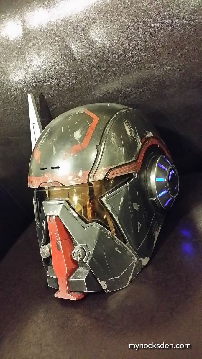

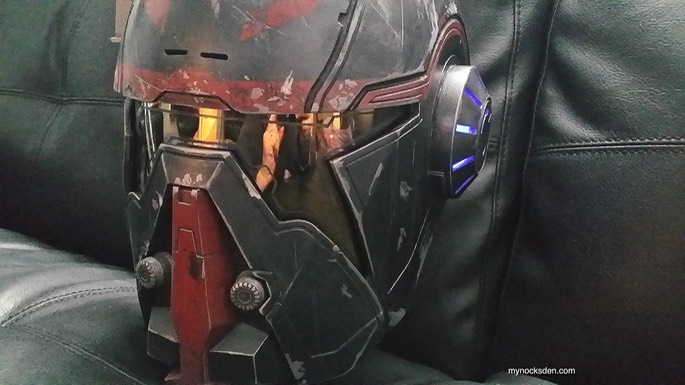

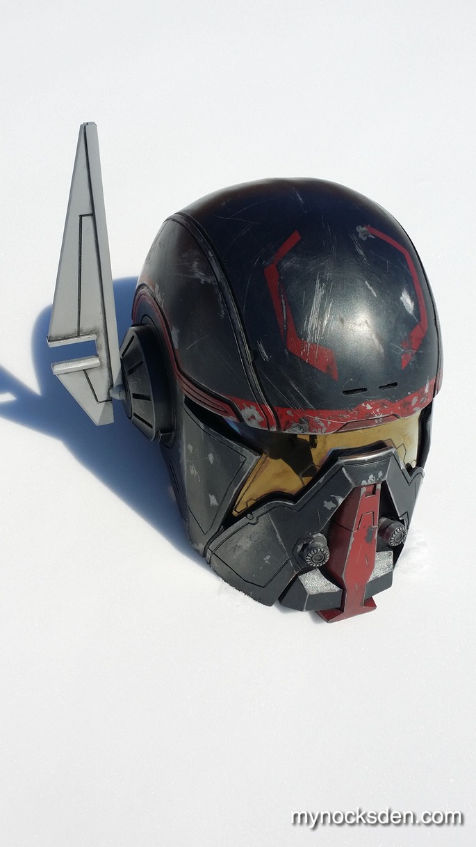

Helmet nearly finished. Just have to install lights into the ears, add some detailing to the visor, and put in my environement amplification system and it's done! The cast run of this helmet will be appearing in the Junk Yard shortly.
Re: SWTOR "Exalted" (Shae Vizla) Mandalorian Helmet WIP

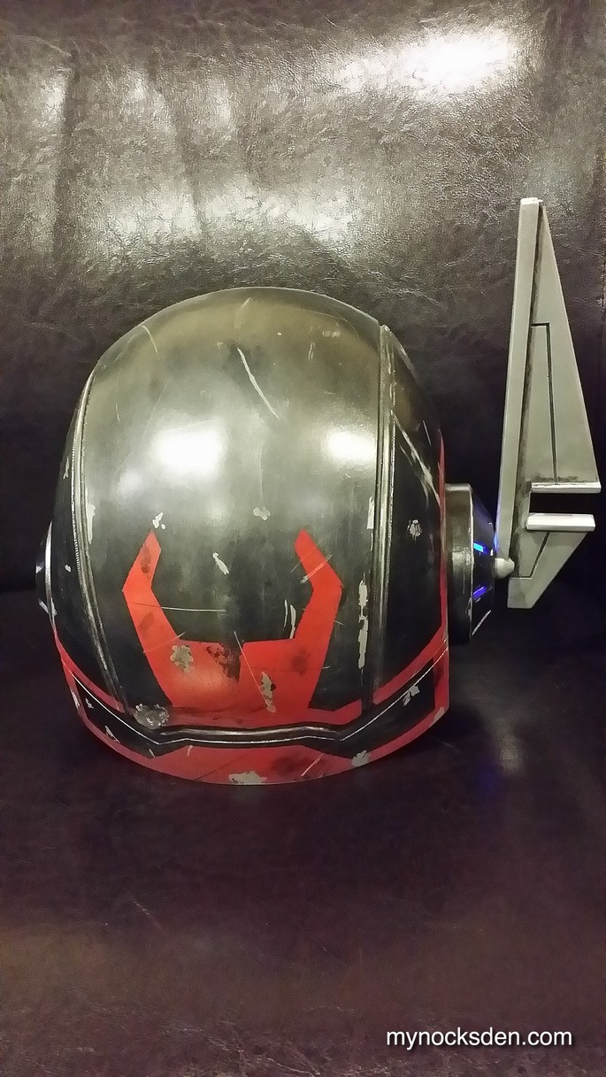

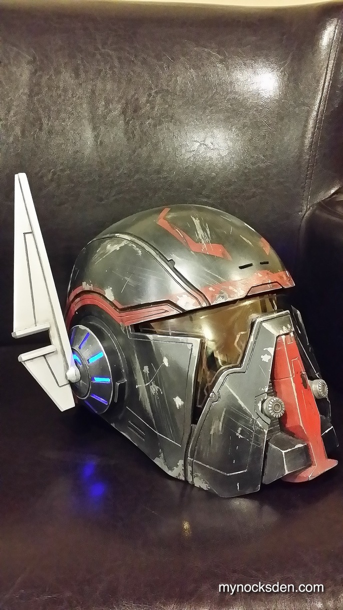

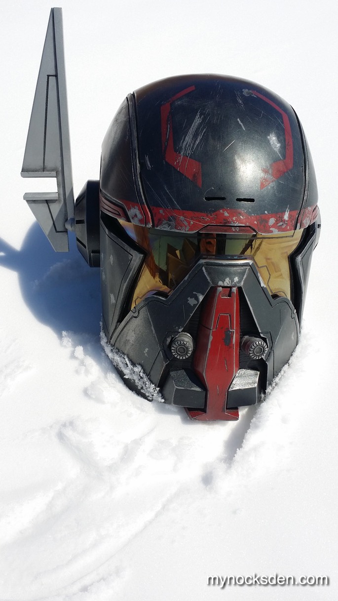

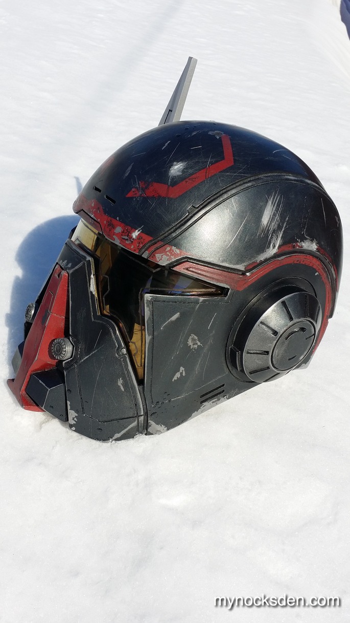

Thanks guys! I'm still experimenting with various painting methods to get the disterssed look, but I'm getting the hang of it. I'm cold casting the helmet in aluminum, sanding it very fine, and then using steel wool to bring out the shine. I then use masking fluid to do some of the large "flake" spots, paint, and peel the masking fluid off to reveal the shiny metal underneath. For some of the minor scratches, I just throw the helmet on my garage floor, and drag it this way and that, then use fine sand paper to take the shine out of the main paint layer, and black paint to "oxidize" the paint in places. I finish up by adding a few extra scratches using a knife. I may touch up the paintjob a bit, as I think some of the paint chip spots are a tad too big. But for now, I'm pretty happy with how it's all turning out.

It's cast in resin, however I mixed aluminum powder with the outer layer - a process commonly referred to as cold casting. All you do then is sand the surface using fine grit paper (400+), and buff with steel wool to bring out the shine. If done right, the cast comes out looking convincingly metal.

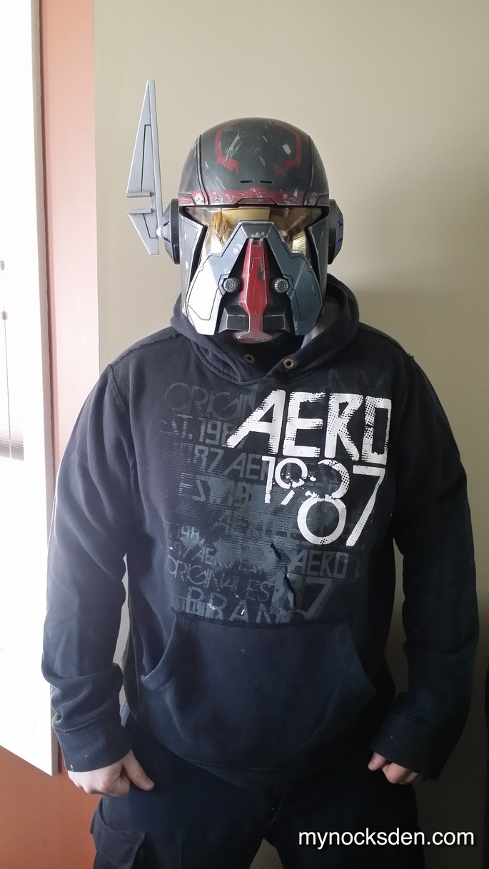

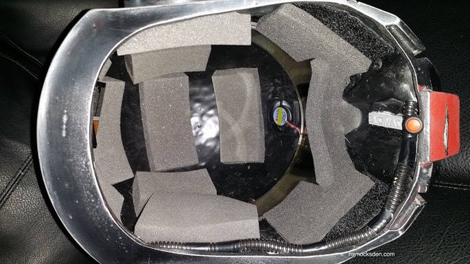

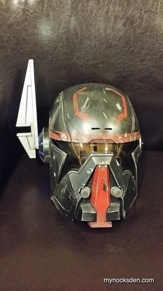

Helmet finally finished, completed with lights, fan, and padding. This is now ready for some serious bounty hunting! Full ompletion notes on my website, mynocksden.com
Next step, full Armor! :)

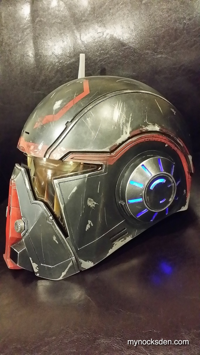

One of the best helmets i've ever seen,
LED's in the ear cups? Genius! It looks even more bad-ass now which i thought was impossible!
