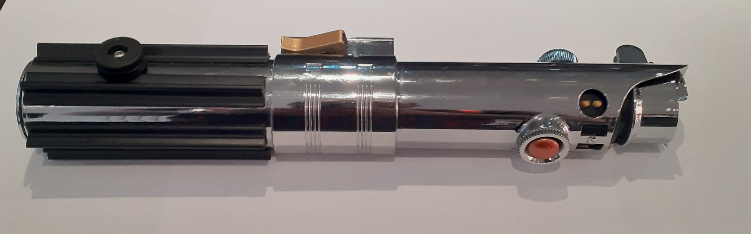

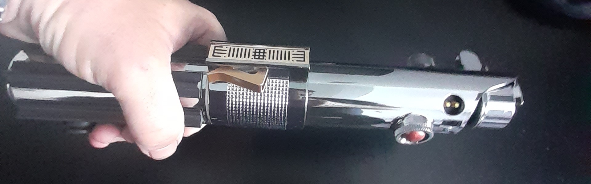

So I'm nearly done with this. Just waiting for some of Roy's tape then it's finished. This has been a really fun conversion and is relatively easy to do.
First you need to strip the saber down. Start with the one screw under the the button behind the bunny ears. Just prise the red button out and underneath will be a screw. Whip it out and pop out the front section.
Next pry out the clamp card and the fitting - you will find more screws under this. There are 2 screws under 2 of the 6 grips. Take off the grips and rivet heads but they are pretty decent for another project so don't demolish them. The grips has a slot underneath that are used as a key for positioning so after taking the grips off you will need to take some snips and carefully cut the plastic - it's easy if you have a good pair of snips. Lastly clean off all residue of sticky foam used to stick original grips on. It should all come apart now. If you wish to remove the bottom cap I drilled hole through it a day with a little force it popped off. I didnt want to the electrics in this but I kept the guts in to add weight.
Get some new grips, a covertec wheel, clamp card and Roy's tape and you are good to go. For the buttons I used simple metal clothing snap buttons painted in the colour you wish. The bottom one is a dome button.I've gone for the copper color although some go gold - in some photos of the originals and other replicas they are either copper or gold. Mask off clamp lever area and spray gold and you have done it!
Enjoy the pics. When the tape arrives I'll put it on then take some better pics. Total cost was £60 all in including the saber itself. Definatly worth converting I'd you get a chance. And it's made me happy that I've added Anakins saber on a budget, and the chromed finish is very similar to the actual prop.
I've actually bought 2 more as I'm going to do an ESB saber half buried in snow. Its one scene that takes me back to the old days!
Completed :) not 100% accurate but for £60 all in you can't complain.
I'd change the button colors to gold or back to copper for anakin but other wise its a very nice piece and much nicer than those 3d prints, now for the ESB or other graflex styles I'd recomend using a scotch/brillo pad for that brushed steel effect it works well on chrome.

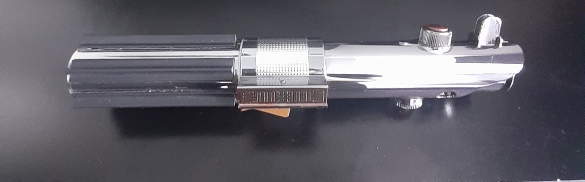

oh also wanted to add something here about how i'm using my jedichallenges lenovo lightsaber as a "sleeve" to insert my rgb base-lit jvmusaber into. didn't want to deal with wiring any electronics. just want to insert in/out to turn on/off & to recharge (really only have to pull out halfway). i figure even if no working button on the outside, this was a good compromise to turn it on/off and recharge. also since the more expensive $200-$500 graflex lightsabers require you to take apart the graflex to recharge, my sliding the jvmusaber in/out of my lenovo lightsaber is good enough for me. the key to keeping this altogether was using a strip of 2"x8.25" corrugated cardboard (cut from a shipping box) to securely hold the jvmusaber inside the lenovo lightsaber. and it holds even if i do spins (well not too fast to be on the safe side). experimented with different smaller sizes of corrugated cardboard, as well as plain regular cardboard, form, styroform, but the 2"x8.25" corrugated cardboard works well and securely for me.
UPDATE *** ::: finally got my control activation box button to be used to turn on the jvmusaber. there are three holes where the activation card/button goes into that box. there is that middle pin already built underneath into the activation card/button that goes in the middle hole. but for mine with the jvmusaber, i had to make a new spring/pin from a paper clip to go into the front hole to press the button on the jvmusaber because that's where it lines up. anyways it now works to turn my saber on/off & to switch light colors & to turn sound on/off. (if you want to see more of my mods, go to my instagram @iwantgizm0s and click the link in my instagram bio to get to a list of my insta lightsaber posts)
