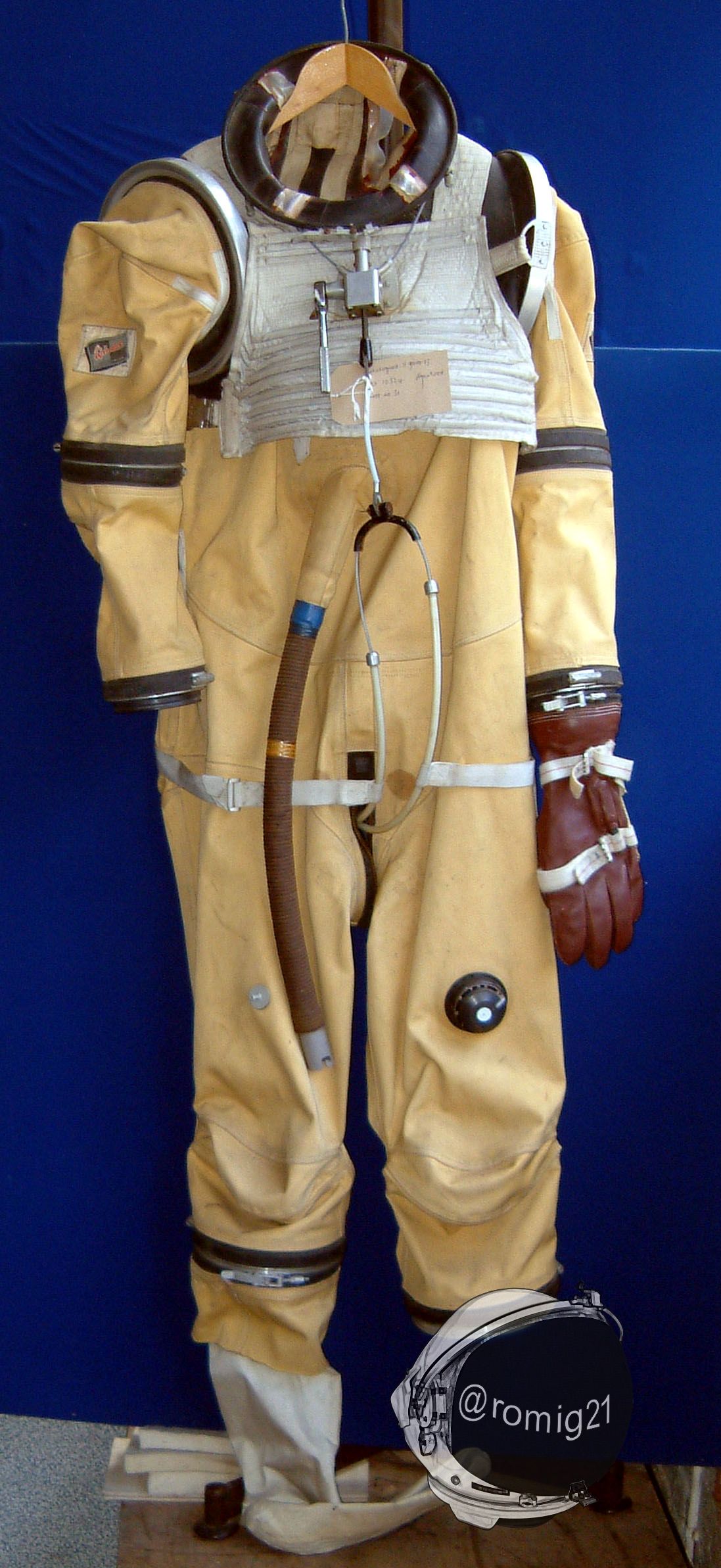

I think I can be of assistance

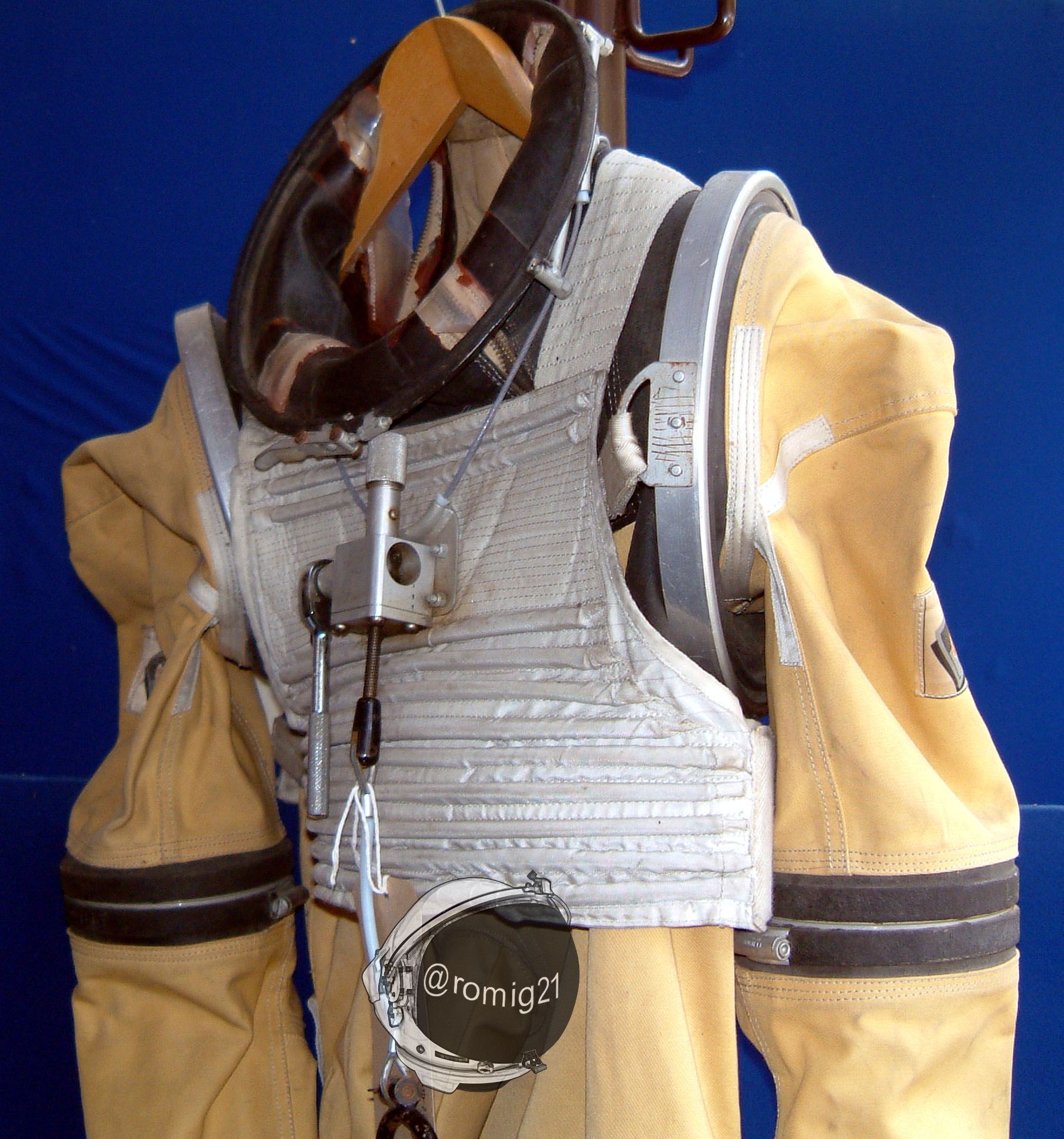

Great image and many thanks! This is the first "contemporary" photo I have seen of an actual surviving "yellow version" of the Windak pressure suit, as opposed to either period photos of RAF personnel wearing it, or film stills. However this one is of the front as well, like nearly all images we already have, and as Imgill previously mentioned. This appears to be taken in a museum or private collector's storage facility though, so if you still have access to this suit, I am sure many people here would like to see images of the back of it, and particularly of the very baggy "seat" area of the suit, which has remained so elusive in the past, and someting I do not think any of the costumes has properly captured thus far.. One new thing we can learn from this original suit from this image though, is that the "flag type patch" one the suits rented from a prophouse for Star Wars, First Men in the Moon and Doctor Who, were put on the suits to conceal the Windak Comoany logo patch positioned in the exact same spot!
I will be able to take some more pics when back in the UK, assuming travel bans will be lifted soon.
In the meantime, enjoy this:
and this:
