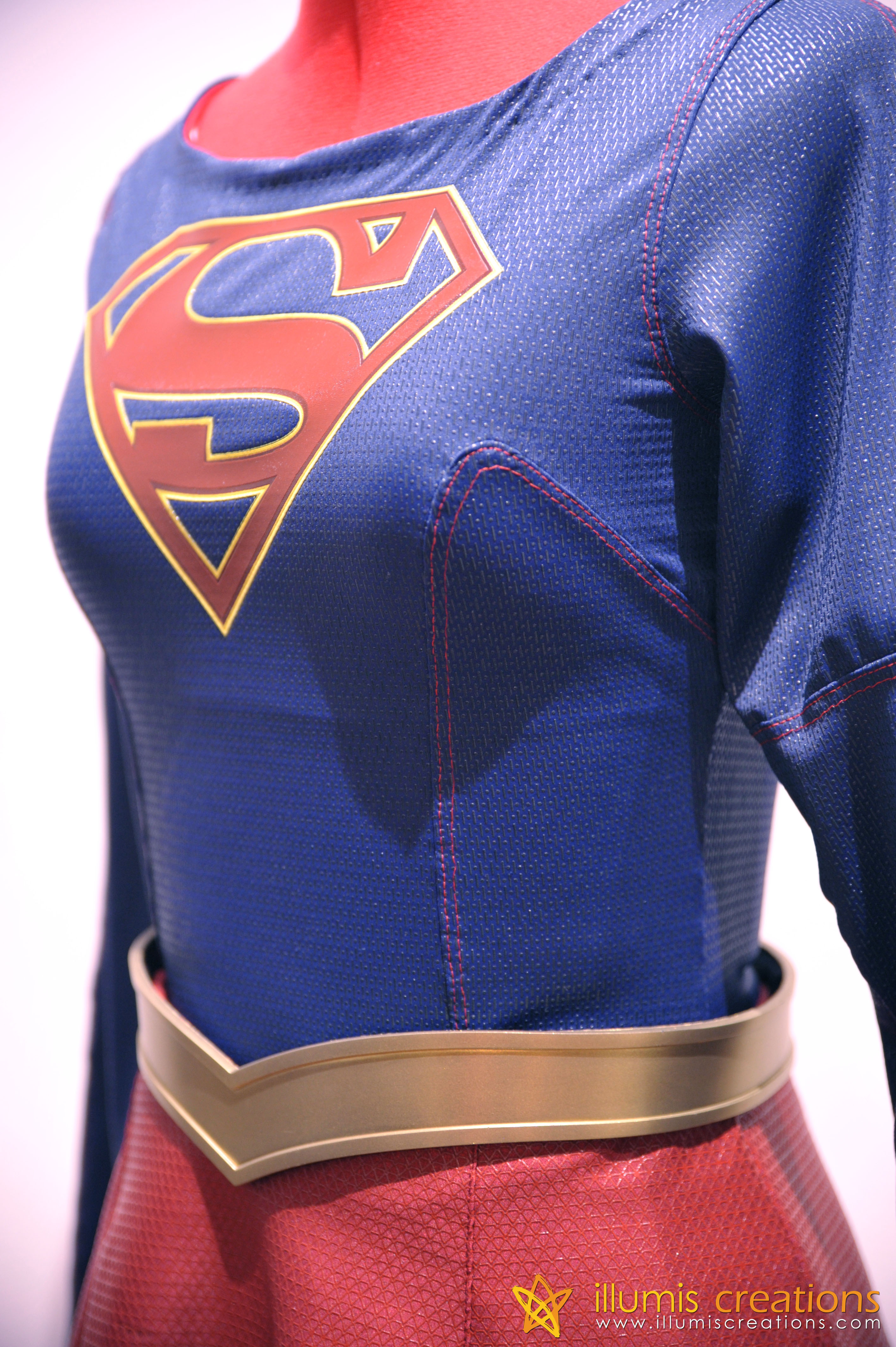

Leotard:
I started off with a basic dance leotard pattern with a skirt from Kwik Sew. I made a toile out of lycra and drew in the panels on the front side, as well as the sleeve seams and altered the neckline. The pattern doesn't have a zip or any sort of closure, so I split the back piece in half and added an invisible zip. I left out the skirt on the pattern, and modified the crotch to make it a flap (for easy bathroom visits!). Early on, we weren't sure whether to sew the skirt into the leotard, or keep it separate. We ended up keeping it separate. I used an overlocker, but you can also use a zig-zag stitch or stretch stitch if you don't have an overlocker/serger.
The neckline has a red facing which peeks over the edge.

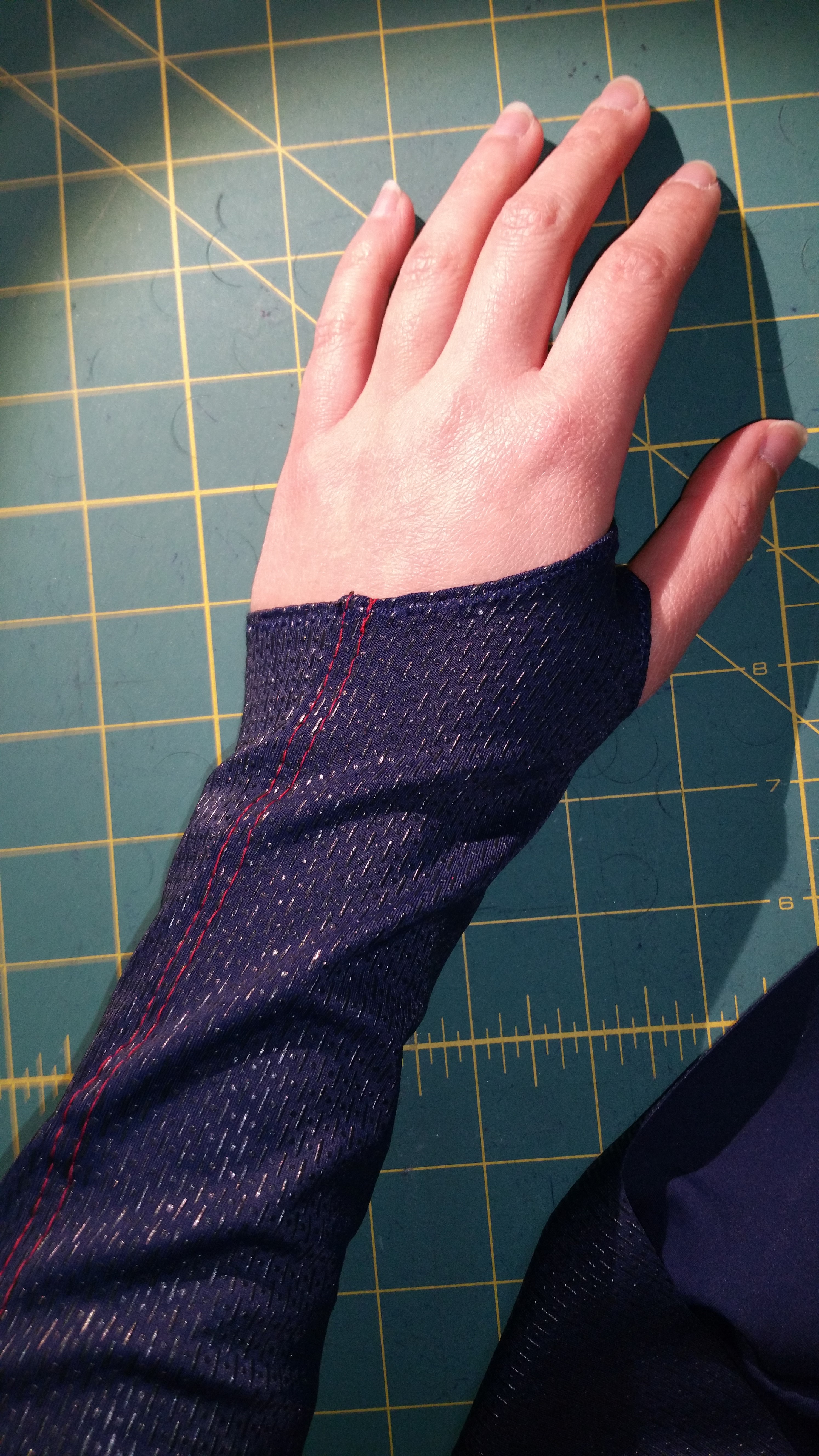

Sleeves:

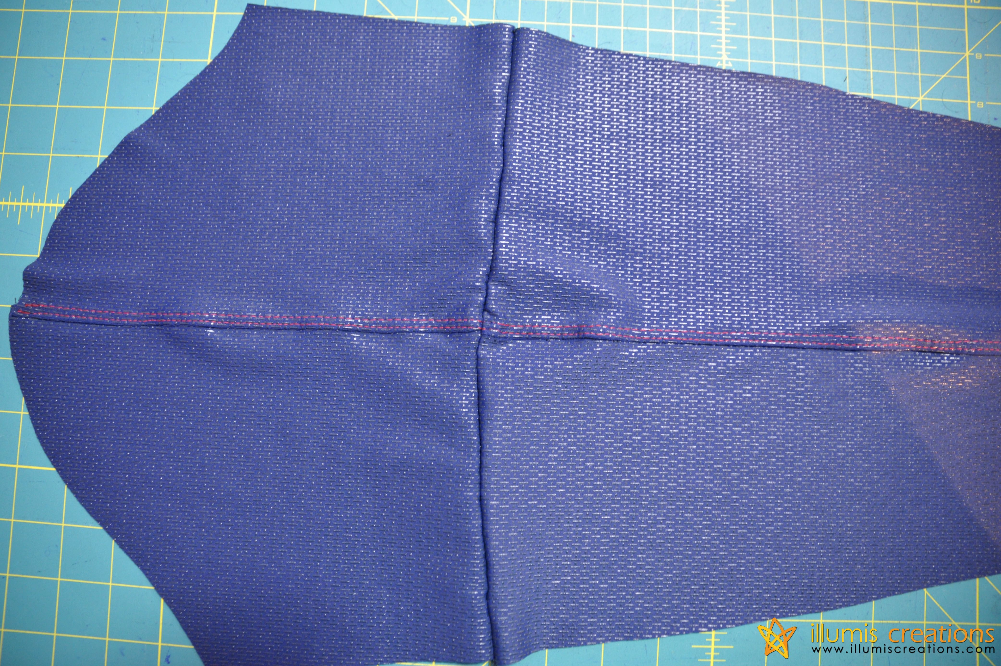

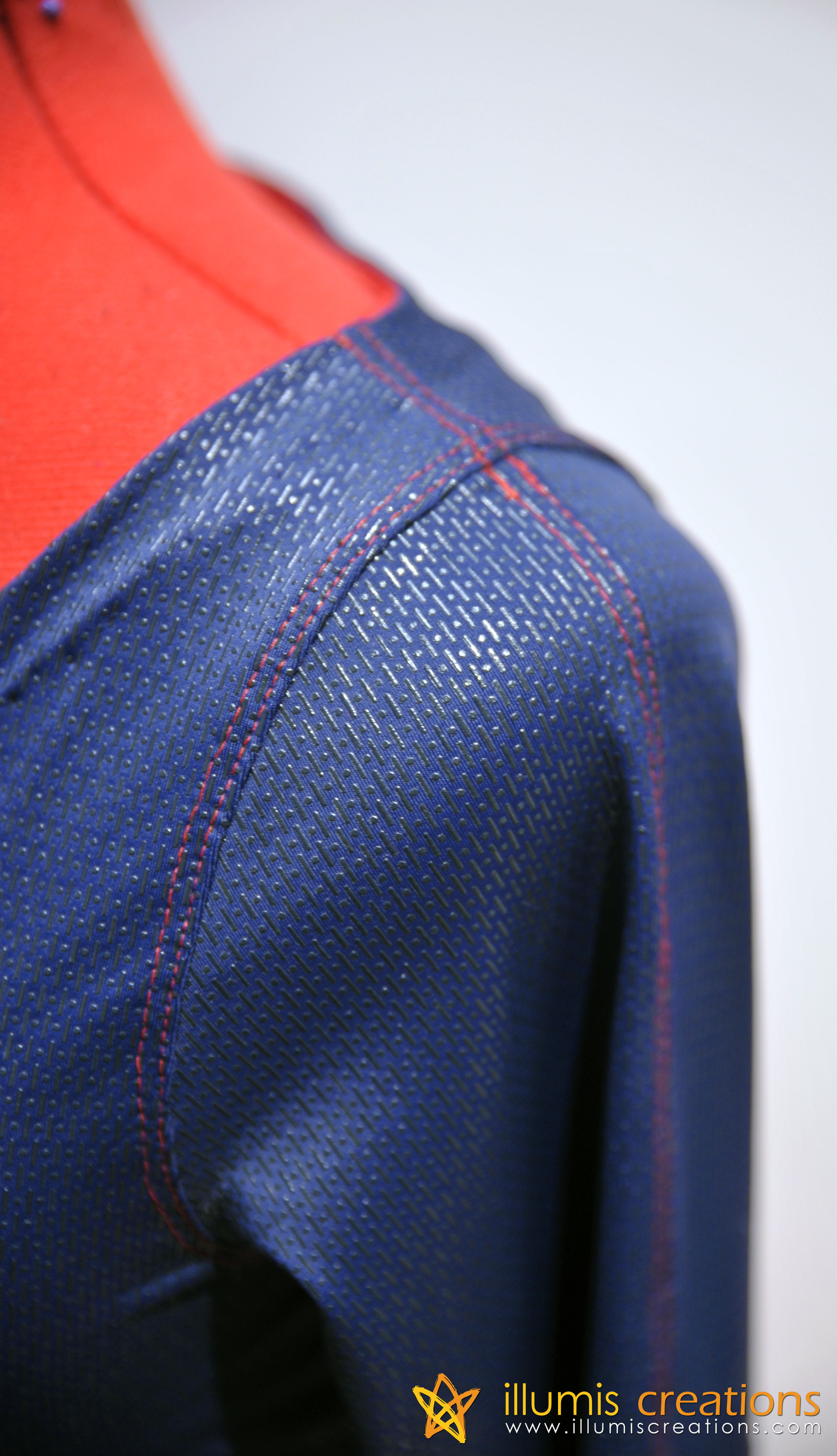

I struggled for a long time with how to do the sleeves with the top stitch detailing. It then occurred to me that the sleeve would have to have 2 vertical seams - one running down the top/outside of the arm, and another running down the underside. I had been trying to do it with 1 vertical seam. Essentially, the sleeve is made up of 4 pattern pieces.
The top stitching was another challenge. I rarely use use stretch fabrics. I prefer my wovens. I've always been told never to use straight stitch on stretch fabric because it doesn't stretch and I didn't want stitches to snap, but I asked a friend of mine who makes a lot of dance wear and she mentioned lowering the thread tension.
I increased the stitch length and lowered tension. Normal tension on my machine is 5.5. I lowered it to about 4, which was also buttonhole tension. It may differ for your own machine, so best to test it!
20170623_200436.jpg 20170623_200429.jpg<< test

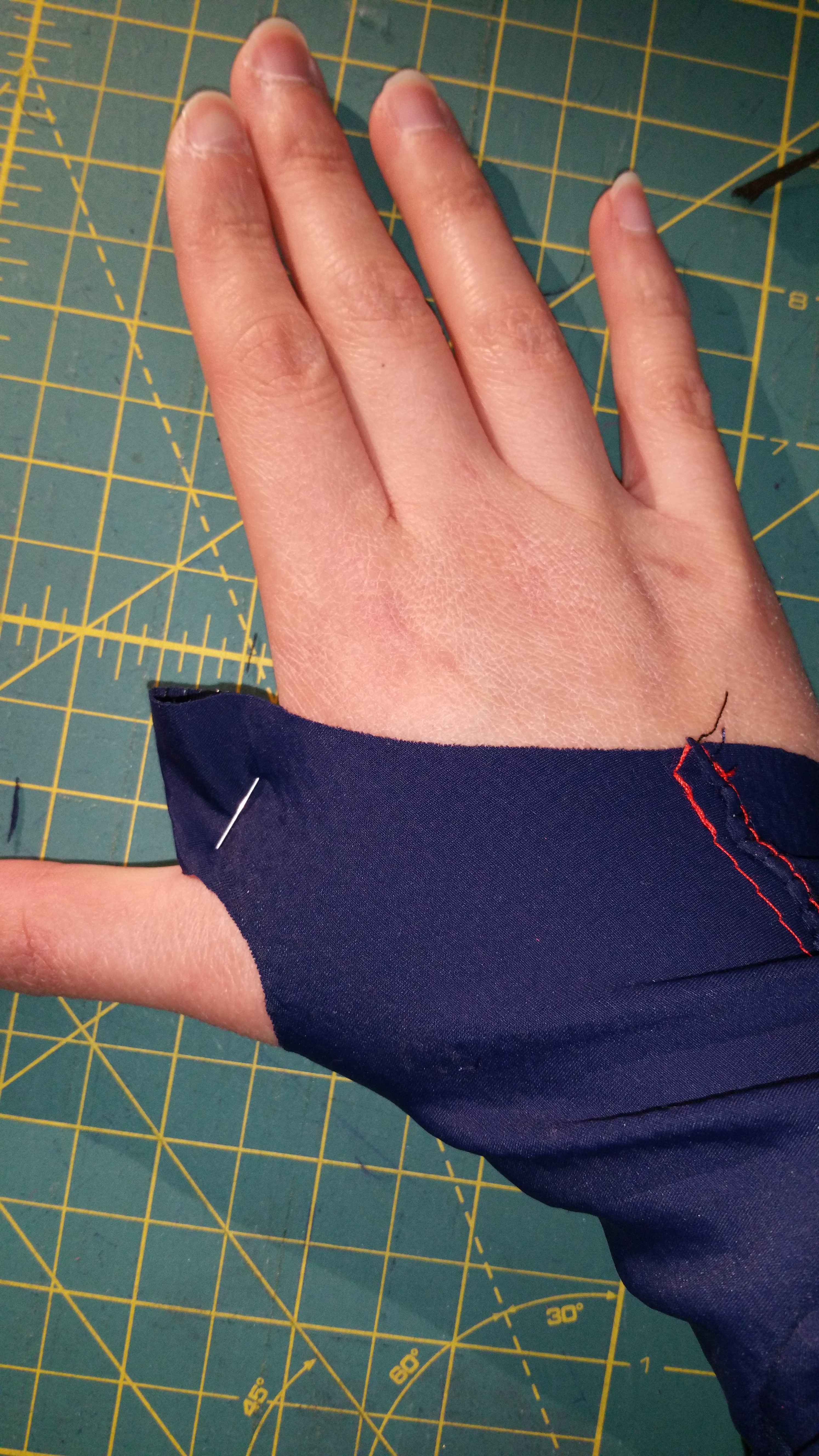

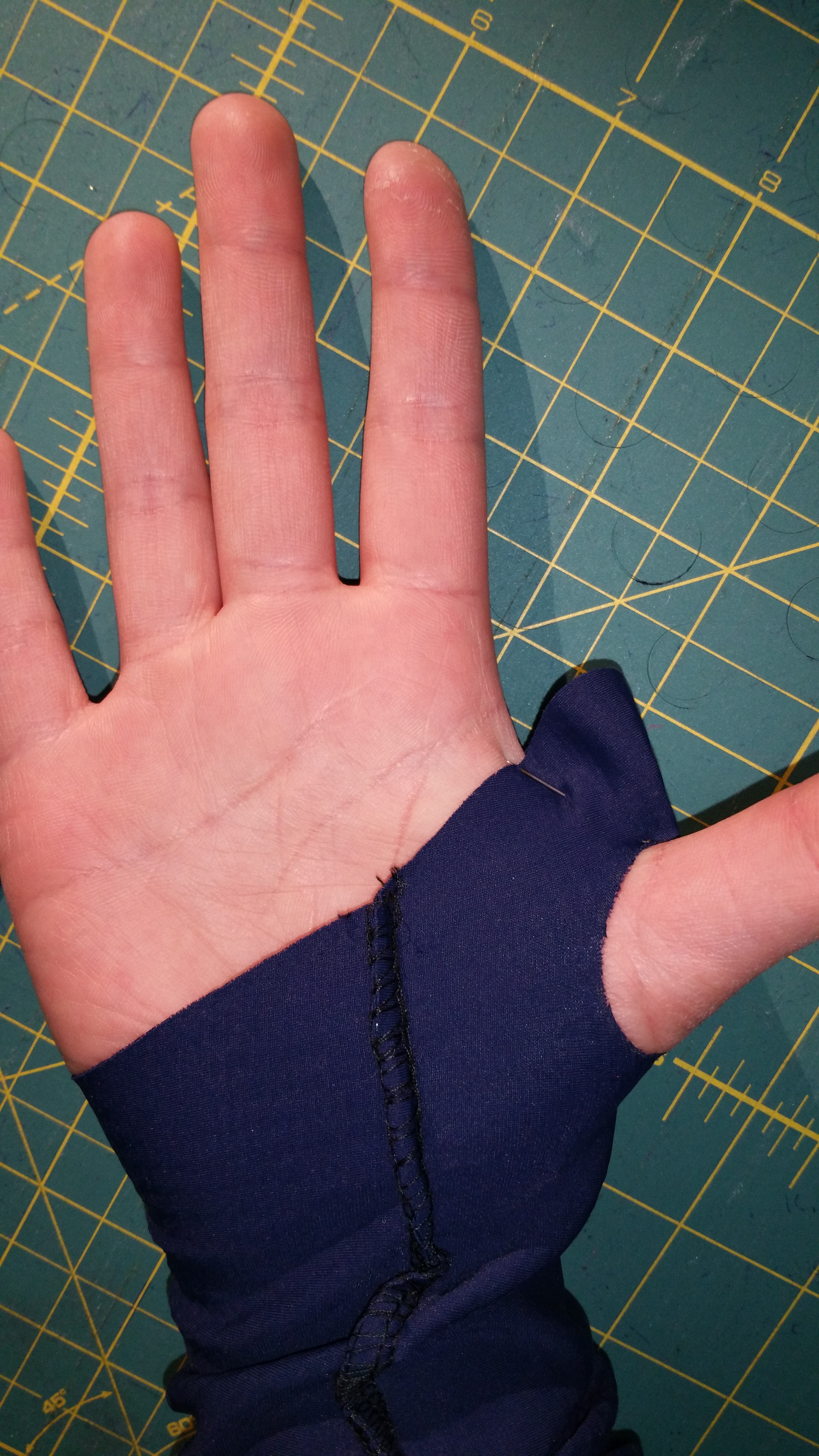

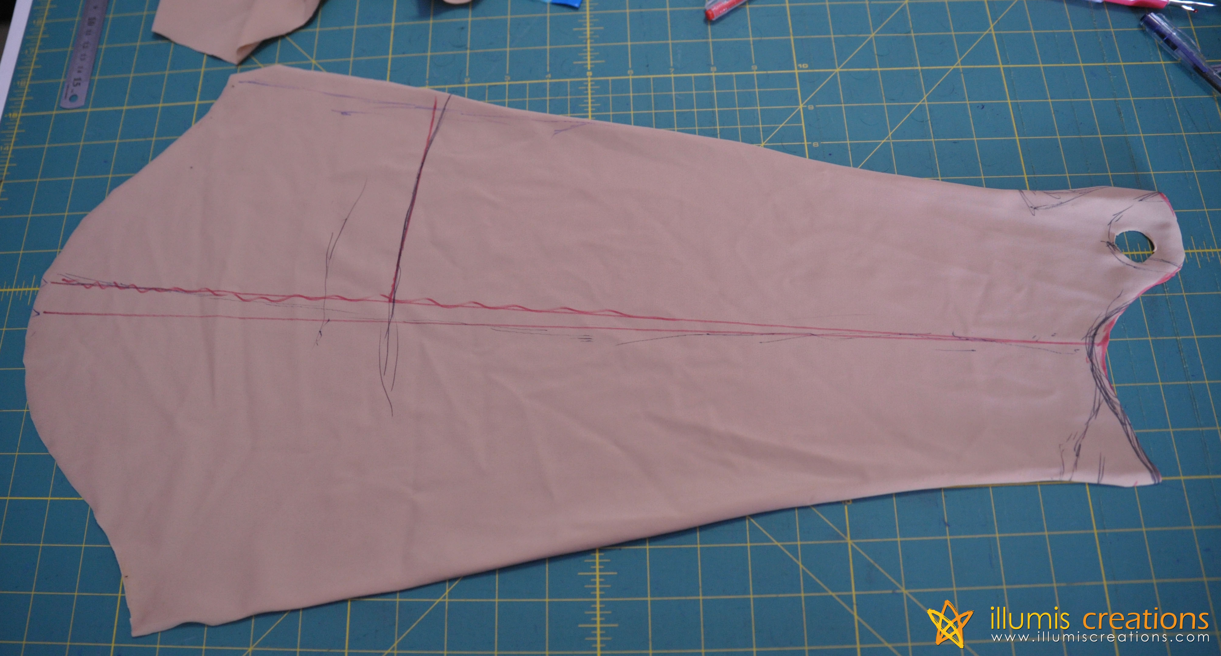

For the thumbhole, I lengthened the sleeve cuff, shaped it and cut a small circle approximately where my thumb was. The way I originally made it, I found it gaped in the area between thumb and fingers so I cut the excess and added another seam which worked perfectly. The edges were folded over by a couple of mm and zig-zag stitched.

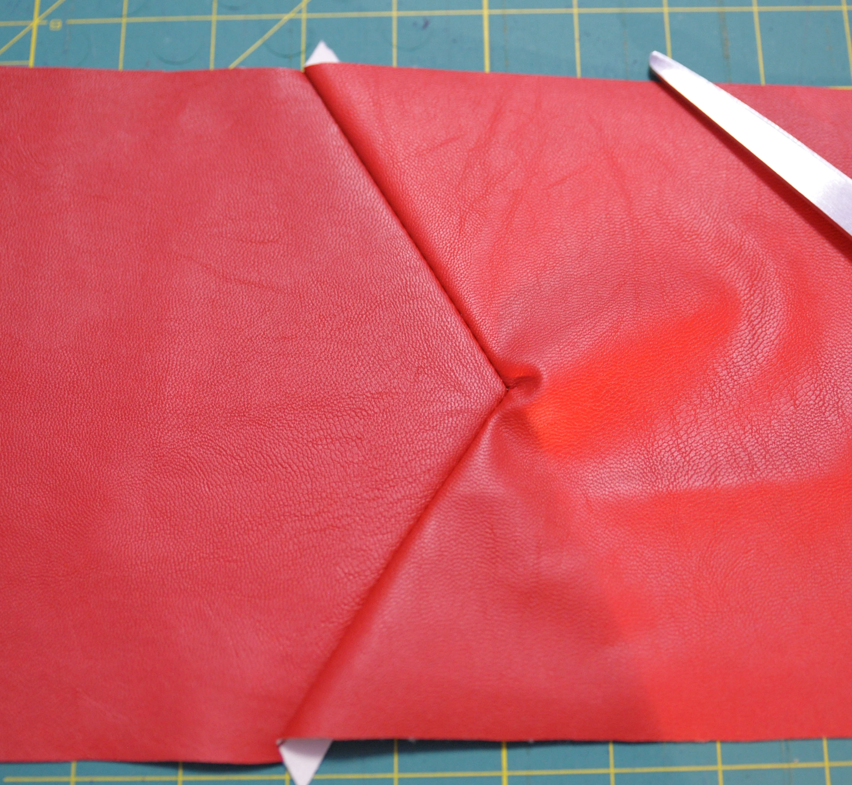

Cape:
scnet_supergirl2x01_1687-edit.jpg scnet_supergirl2x01_0115-edit.jpg spg106_2680-edit.jpg scnet_supergirl2x01_1739.jpg
Her cape has been pieced together from panels, but there weren't many promo images of the back. I managed to find screencaps of all the episodes on Screencapped.net and trawled through all of them. This was the best reference I could find which shows the cape is made up of 6 panels + the zig-zag pattern on the bottom. The hem of the lining also looks like it's not sewn to the hem of the cape.
I used another basic superhero cape pattern as a base and widened the centre and the shoulder straps to be able to create the pleats.

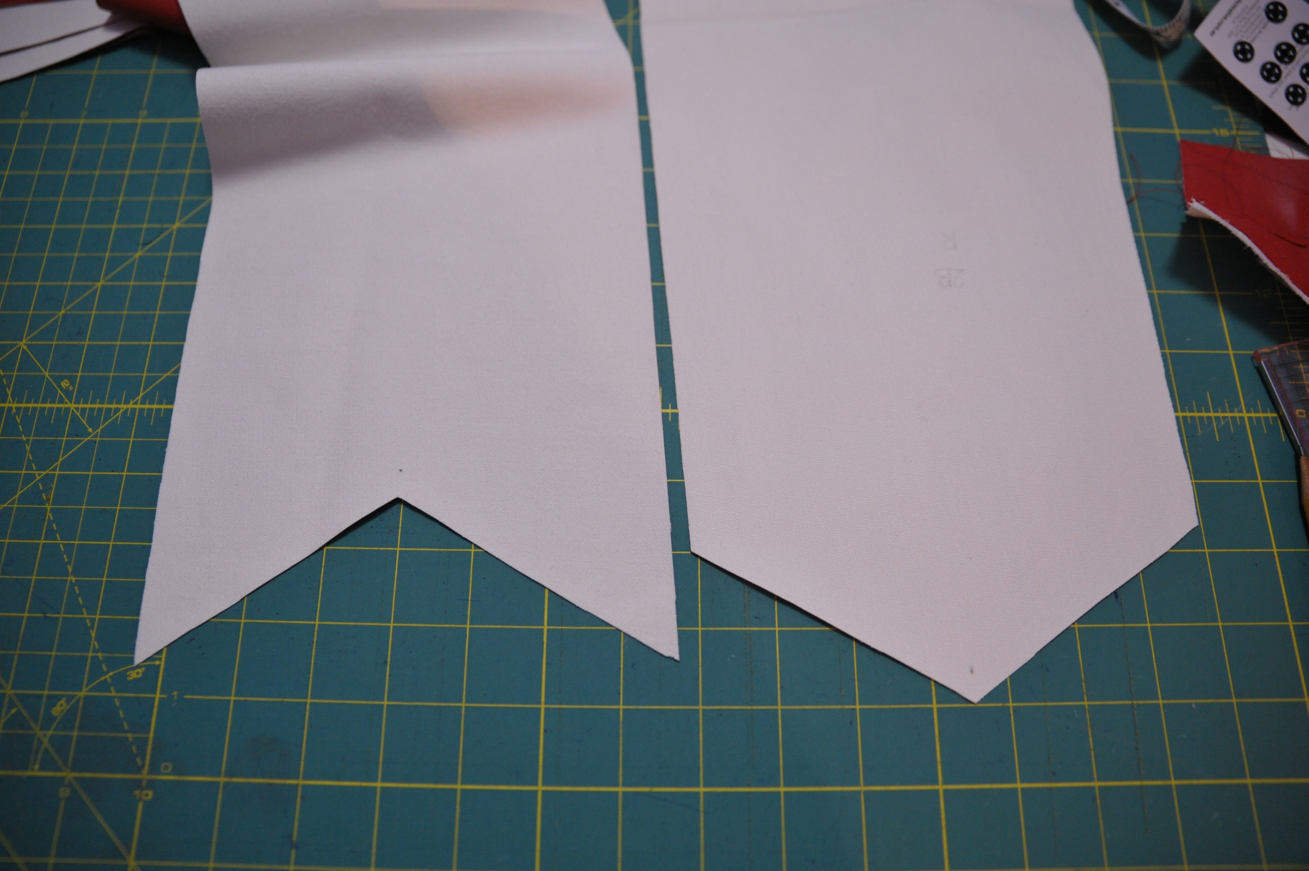

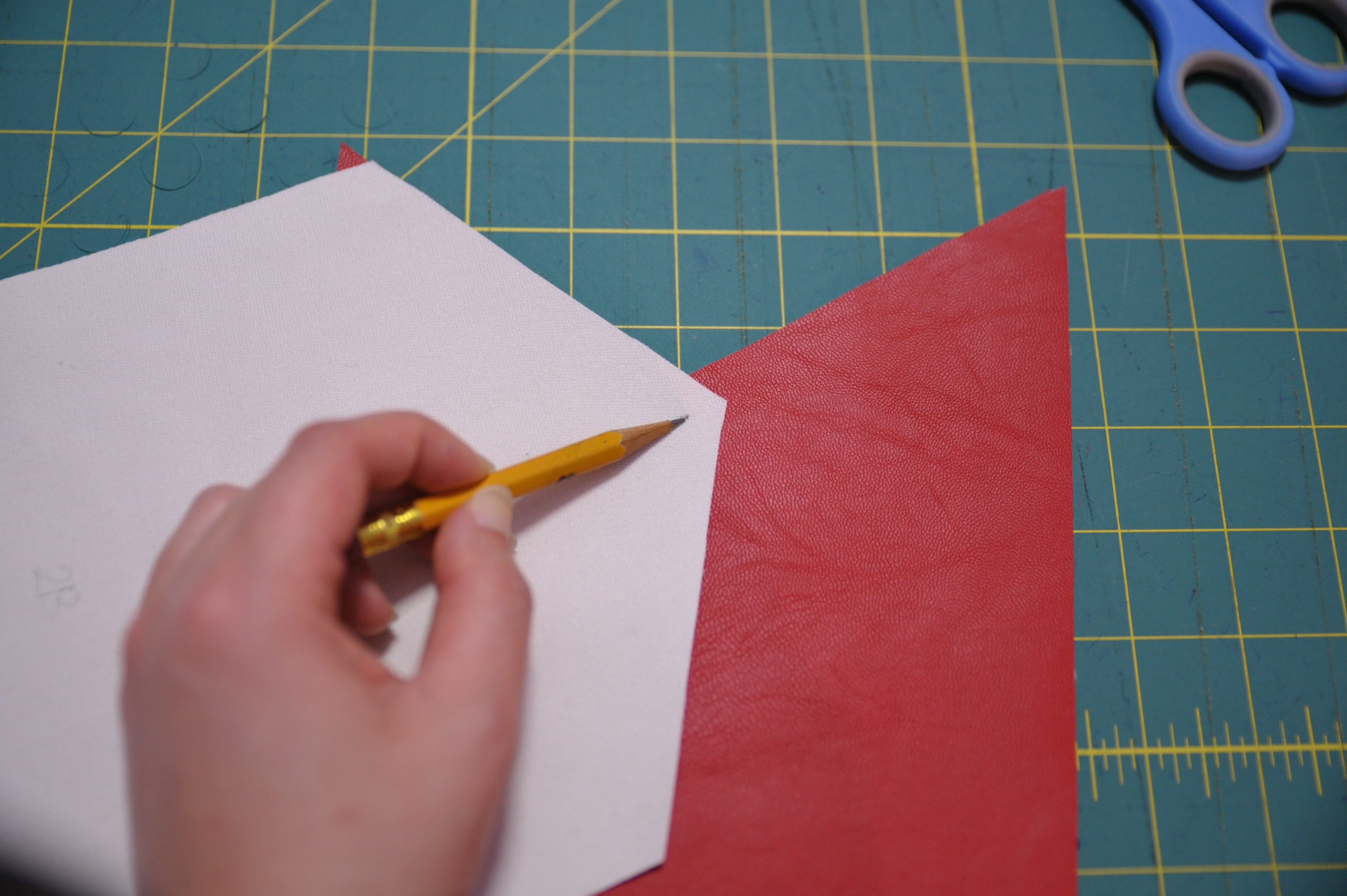

An easy way of joining these pieces together is to measure and mark the seam allowance at the centre points (in this case, 1 cm up from the point). Overlay the pieces and use your pencil as a pivot point to get the correct placement when you sew it together. Use bulldog clips or quilting clips to hold the pieces together when sewing instead of pins. Once sewn, clip the point on the piece with the triangle cut into it (hard to describe. Inverted triangle? The one that's facing up in the 2nd and 3rd pic). Top stitch. Repeat for each panel, and then sew the cape together. Top stitch the vertical seams.
It should look like this:
The lining was about 2cm narrower on both sides than the cape so the inside should look like this:
DSC_0167_FB.jpgWhen sewing in the lining, only sew the side seams and the neckline, not the hem or ends of the shoulder straps. You'll see why below.
To get the crisp edges, I used fusible hemming tape and ironed the edges using a press cloth (otherwise you will melt the pleather). I hand stitched the hem of the lining to the cape. I couldn't leave it floating because the back of the pleather is bright white, and that won't look good.
