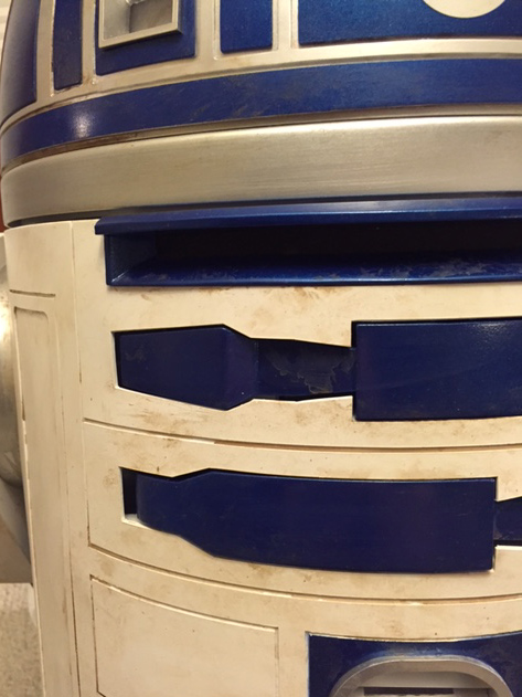

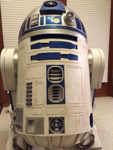

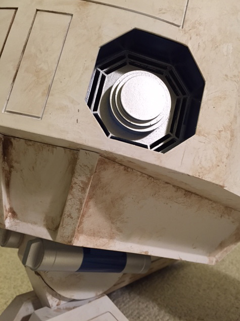

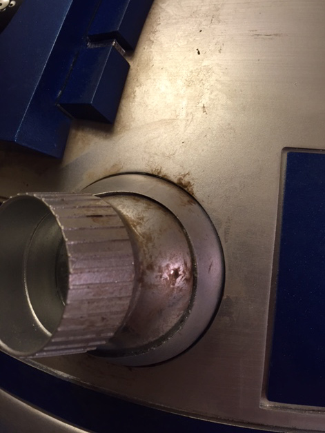

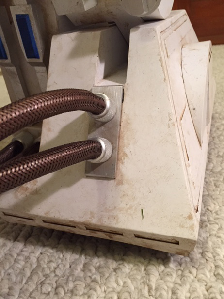

So I finally had the guts to properly weather Artoo. I went for a subtle Tatooine look. A few layers of various acrylic washes did the job. What can I say? He instantly went from "plastic thing I made" to "rough-an-tumble astromech". The weathering REALLY makes him come alive. So glad I did it.
