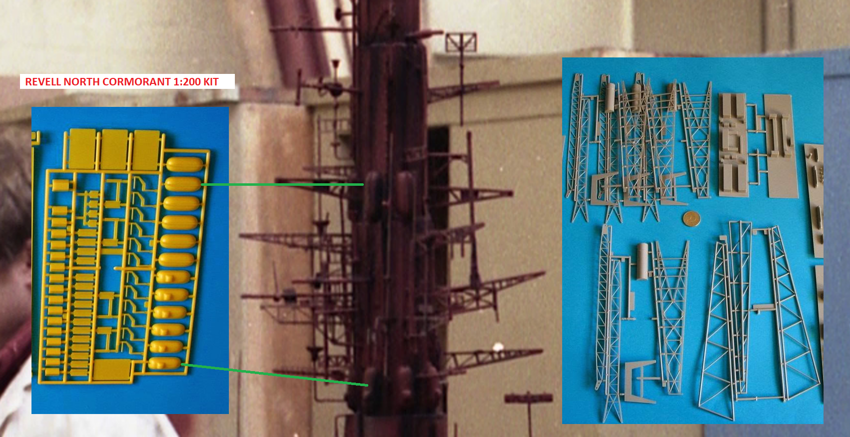

Well, it looks like I've identified a fair bit from the central spire structure and once I noticed this, bits of the same kit are all over the rest of the studio model too. I guess that I can tick this off the list of things to ID. What do you think? Obviously there's more to it than this, but it's a start.

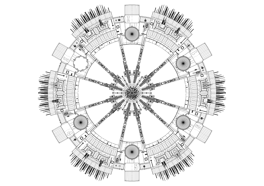

There's been a little bit of progress on this slow creeper of a project.

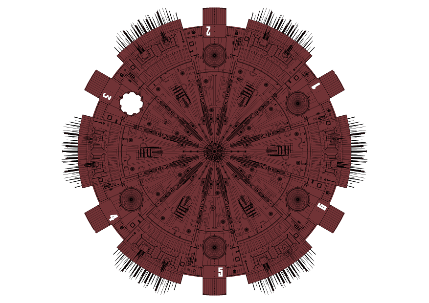

To help with it all, a drawing was made to give a general overview of just what we're supposed to be looking at. This makes the whole process of navigating around the model and identifying the various landmarks much, much easier.
This version (above) of the drawing is slightly simplified and I'll add some doodles over it to note where the various kit part elements go in context to the ship as a whole.

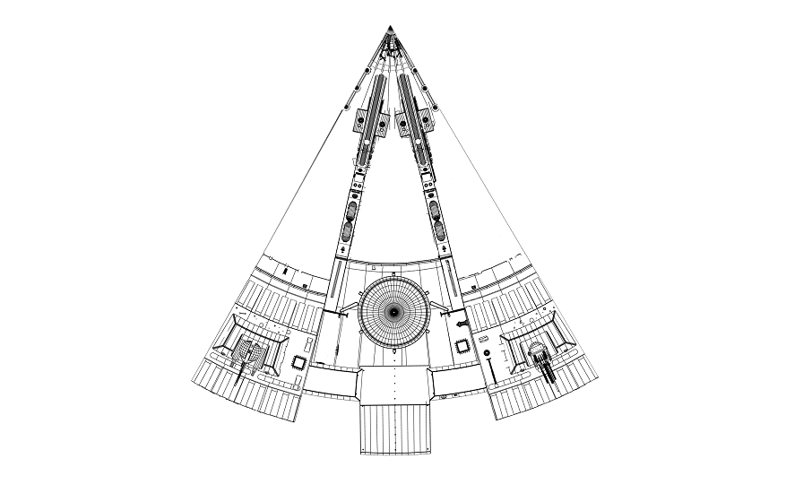

And this is an enlarged section representing each individual cast fibre glass panel that makes up the main hull of the studio model.
Further detailed notes will go onto these sketches to really nail what goes where.

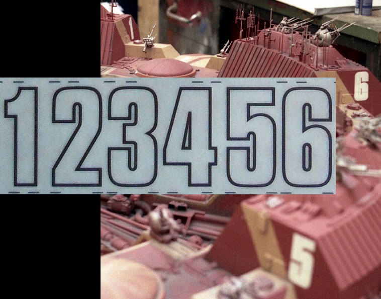

While not a huge revelation, identifying the Docking Bay numbers font has been a bit of a relief. Clearly the BBC folks made their own take on this font, so in due course, I'll have to remake their version of it too - but that's a long way off yet.

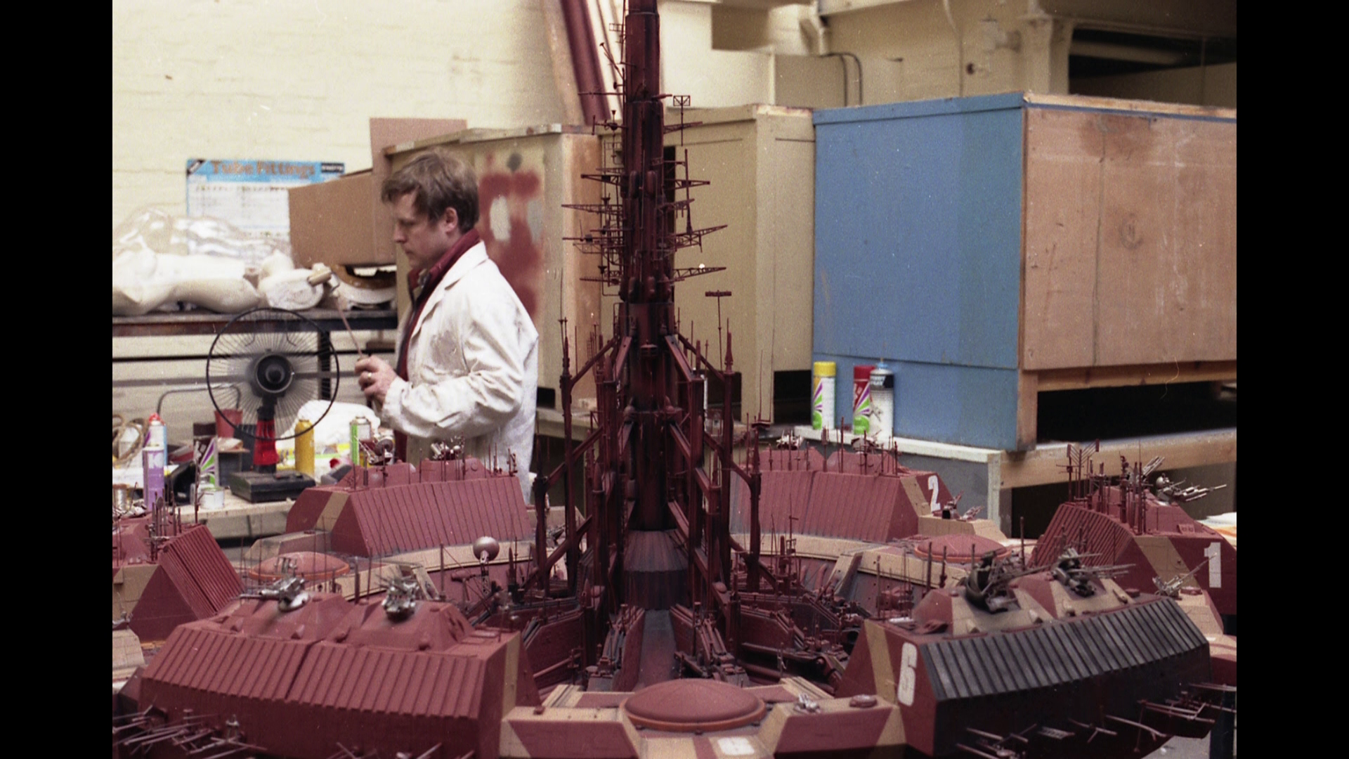

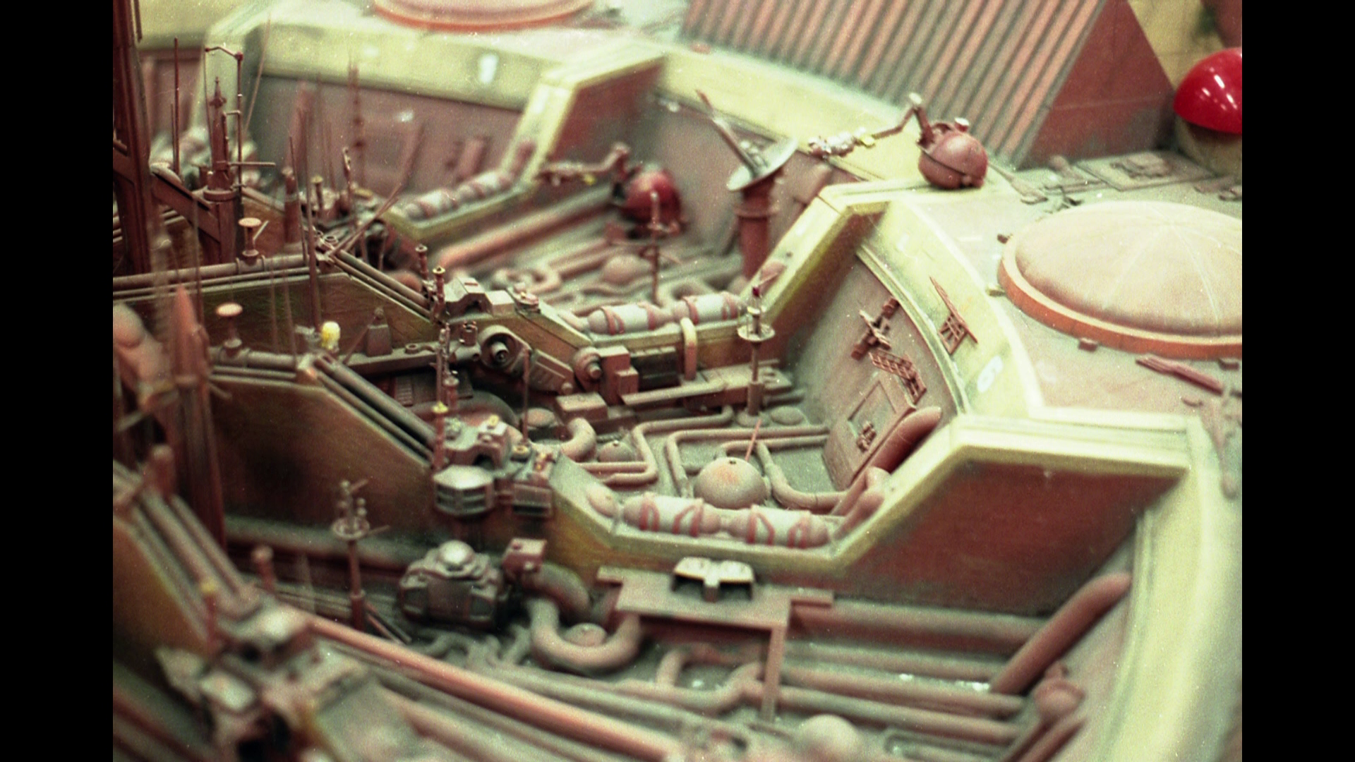

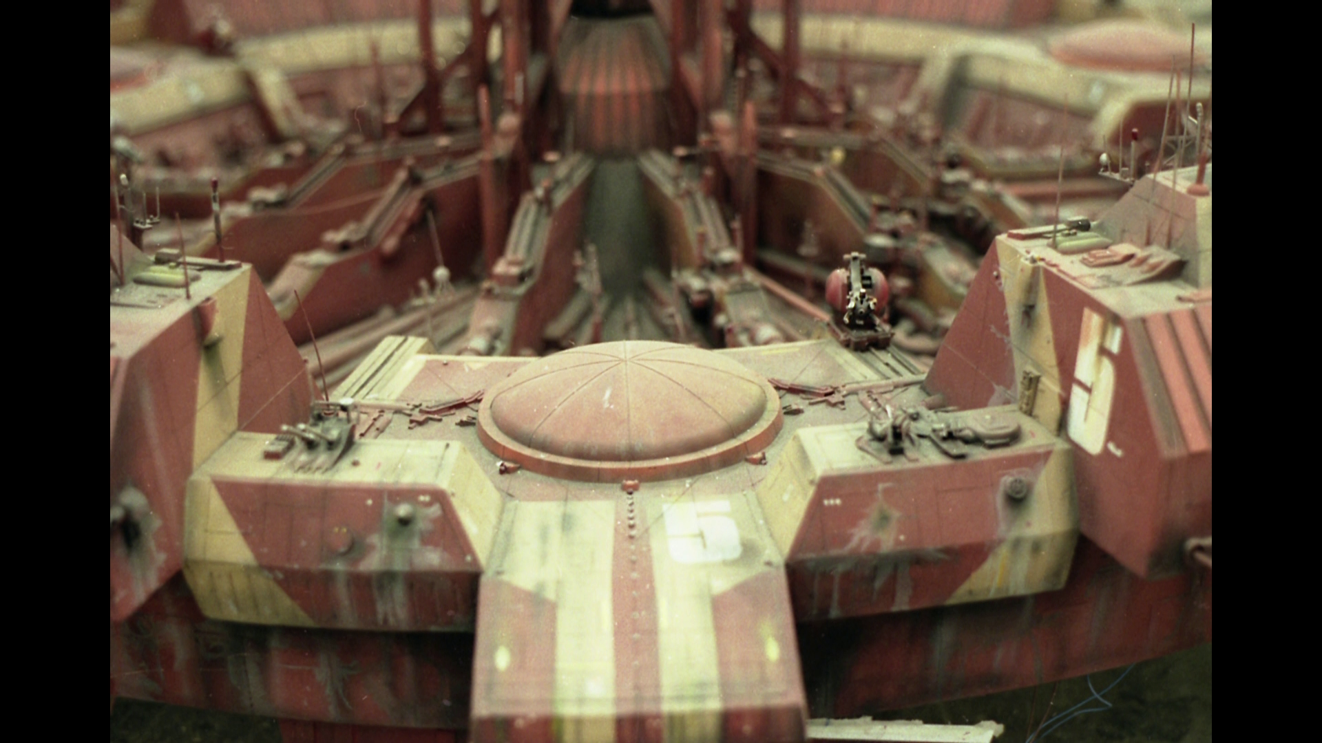

Fellow model makers, I could really do with the help of your collective hive mind on a project that I've been researching for a while, if you'd be so kind.
The model in question is this, a space station built in 1986 for Doctor Who. I think it's a lovely model, but unfortunately the original was badly damaged in a fire and I'd like to try and recreate it, but I'm stuck on the vast amount of kit parts that adorn this piece.
It's very early days on this project, but obviously you have to start somewhere - and part ID seemed to be the obvious place.
I can see there are elements of the MPC At-At kit dotted around it, various Plastruct elements and I'm aware that there are also Gundam pieces (which I know nothing about) but that's pretty much as far as I got for this side of the potential project.
I'll attach some images and with luck, some of you may recognise parts.
I know this is going to take a long time and will probably be no doubt very expensive, so some certain amount artistic license may have to be taken, but it can't hurt to do as much research as possible now, just so that I can start to plan what course of action should be taken with this.
Anyway, if you can spot anything here, please feel free to educate me.

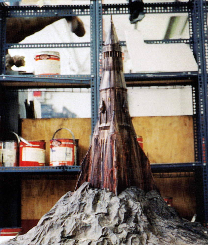

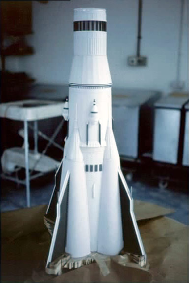

I am pretty sure the large centralspire is the ship from state of decay, just reused as ppart of a larger model. Or the same parts used to make that older Tom Baker story model.
PB Props
Oddly, a couple of people have said that to me recently, but alas it just isn't so. Good idea though.
The "Ship of State" was, if memory serves, built from a Saturn V and a number of other kits and still survives to this day. The central spire on the model that I'm hoping to start work on is just a bunch of plumbing and structural tubes stuck together with loads of greeblies added to it.

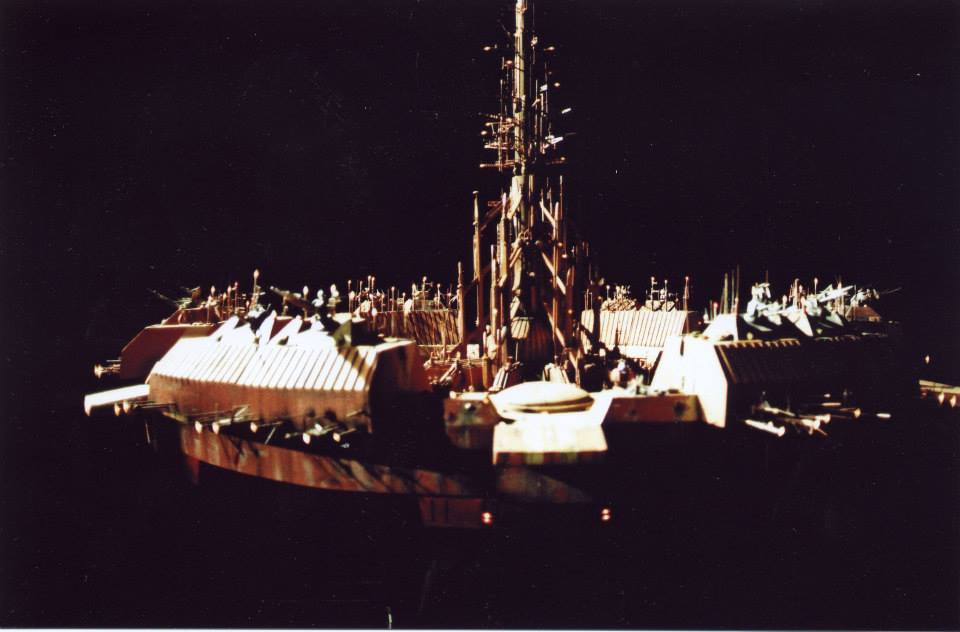

I remember this from Dr Who mag’. One of the longest motion control shots ever done.
Yes, and a camera move that was incredibly complex for its time.

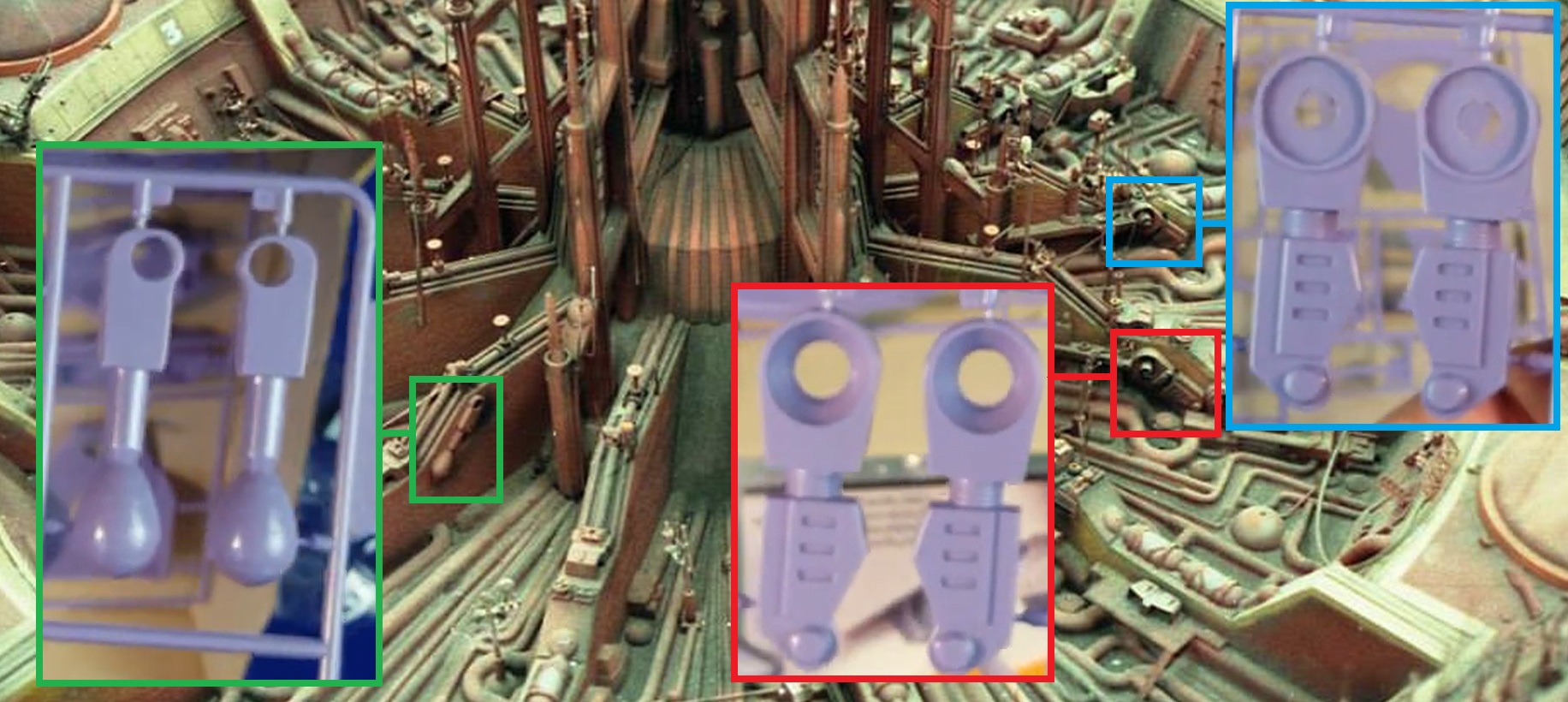

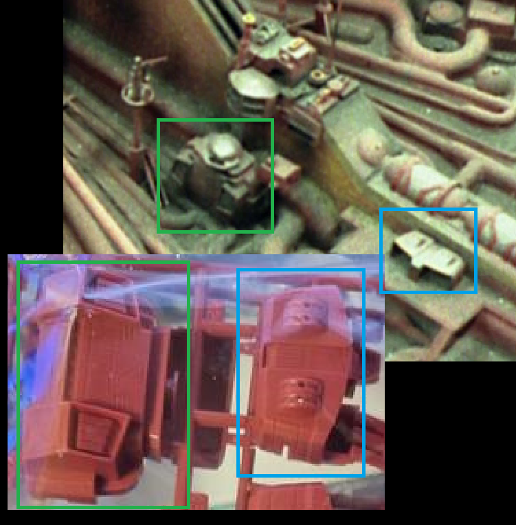

You know when you say something, but aren't entirely convinced by it? Well earlier in the thread I mentioned that I'd identified some MPC AT-AT upper legs on this model. Now this was actually "spotted" a few years ago, but having come back to it all recently, then posted the image here where I ID'd them as such... I sat back and looked at them again and was even less convinced than I was before.
So, I spent a couple of days doing some more research. You know the drill, looking at 1000's of pictures when really I should have been doing some stuff around the house. Anyway, turns out that I was right, they are upper legs, just not from an AT-AT. They're from a Gundam Walker robot...
With the kit in hand, I also found a few other bits too... Those in the green box. Small mercies and all that.
Best news of all - I've identified the "Robot Underpants" element that had eluded me up to now as well as the piece that I'd assumed was a chest section from something similar. Again, it's all Gundam stuff. Turns out that the UK was flooded with these cheap kits back in the 1980's, despite no-one having a clue about Gundam or the culture (comics, books, cartoons etc) that goes along with it... to us Brits, they were just robot kits.
