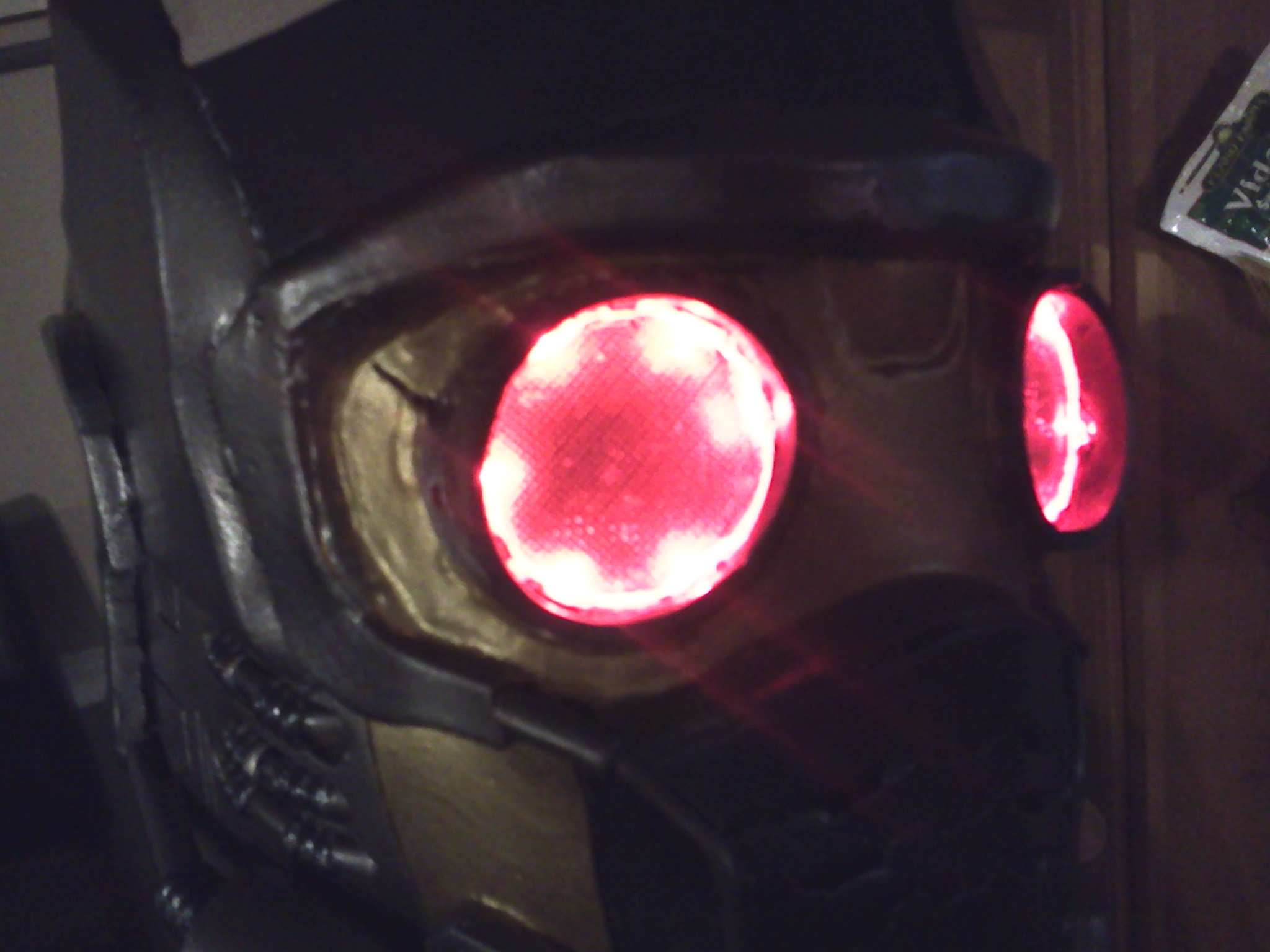

I used 6 LEDs per eye, but it looks like they used about 12. I wish I had ordered more but funds are kinda low at the moment and I think 6 LEDs is ok with me. It does not light up "as much" as the production pics, but the "glow" effect is the same.
So basically, in real life, they dont glow intensely, however in the pics, they look like copy of the prop pics...Well, if I had the guns finished, and the same lighting conditions. So, I'm happy.

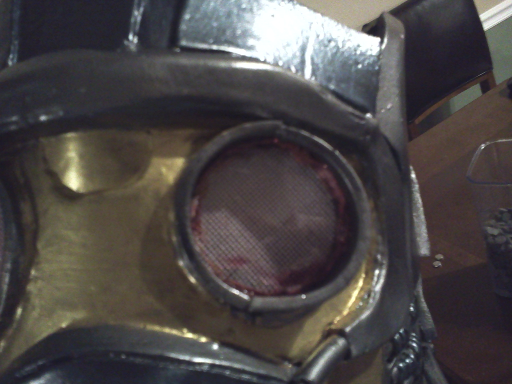

I was pretty pleased with the eyes, but I wanted it to be more accurate. In the 2nd pic I posted, the eyes maintain their "red" color. I believe this was achieved with either Red Acrylic, or Red Stained Acrylic.

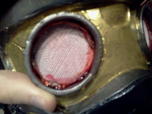

I tried staining my plastic. It worked pretty well but it looked as if I had cataracts! I could barely see. Very, and might I add another, VERY, disappointing.
Maybe I didnt wait long enough for the layers to dry? Meh, you can try it if you want to explore. I decided to order some red acrylic sheeting that is 12"x12"x1/8th" I should have ordered some other stuff too because the "start" shipping was $8~ Oh well...

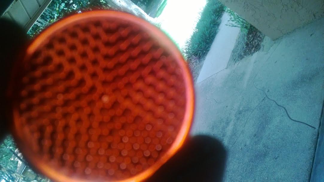

Just looking at those pictures, the eyes look like red reflectors for bicycles. They have a geometric pattern embedded to catch and reflect light.
I don't know how easy it would be to see through them, but perhaps a pair of red reflectors cut to size with an led strip around the edge might produce the desired look.
Do a quick google image search and see what i'm talking about.
Agreed! I bought some 1 1/4" bike reflectors, definitely cannot see through them. Wondering if small holes would work reflector.jpg

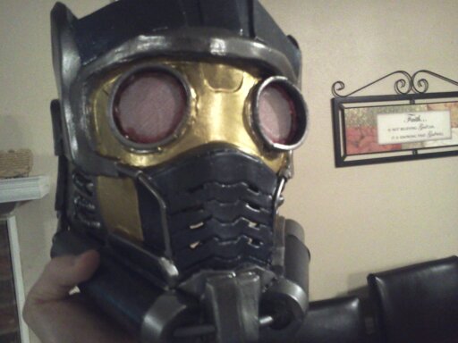

So, these pics are taken with my dad's phone... Because I still cant find the darn wire. Anyway, it will give you a small idea of what I did, and the visibility of the build. I will say though, that these pics do not show the mesh all that well. I guess it cant focus in on it that well?
Guardian 343.jpgGuardian 363.jpgGuardian 360.jpgGuardian 358.jpgGuardian 356.jpgGuardian 354.jpgGuardian 353.jpgGuardian 345.jpgGuardian 338.jpgGuardian 364.jpg
I dont know why there is an extra thumbnail thing.
Anyway, the red splotchy stuff is the glass stain I tried to remove.
