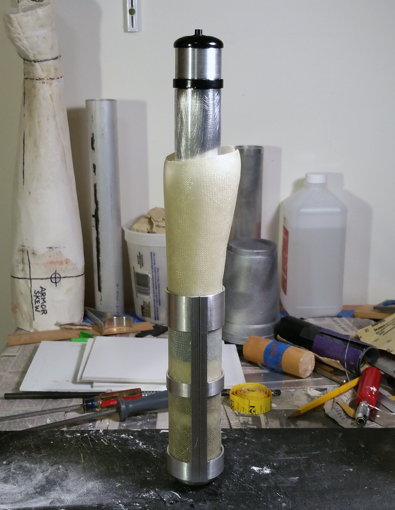

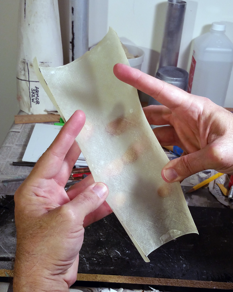

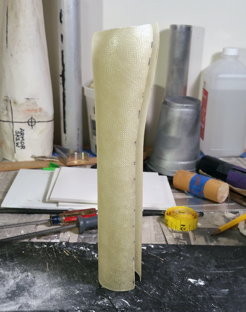

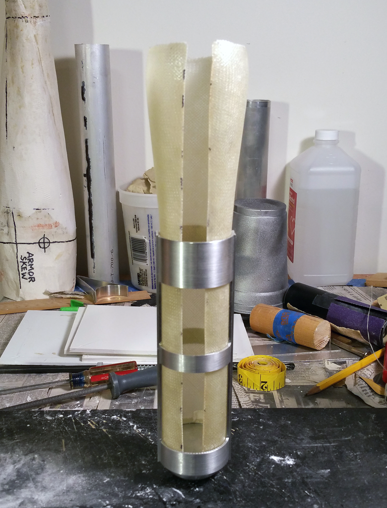

Here is the de-molded saber holster liner. The opening is still rough cut and needs the wavy edge and the lacing. If any of you build fiberglass production pieces, I can highly recommend a bit of the flexible resin in the mix (see previous post for source link). As you can see in the first photo, it REALLY flexes, and that's only about 25% flex-resin to 75% normal laminating resin. It snaps right back into original shape as soon as pressure is let off. There were three layers of glass cloth in this casting, and I could have gone four with no problem. I plan on using a little flex resin in the mix for the ab-plate. For the lacing I plan to use plain un-waxed dental floss, and make it rigid with superglue (Many thanks to Thomas Spanos The Clone Emperor for the idea).

More work on the lightsaber holster: I laced up the gap in the "leather" lining (it's actually flexible fiberglass) using embroidery thread, then soaked the thread with superglue over a polypropylene tube insert. Glue didn't stick to the plastic but made the thread semi-rigid. Jedi Leda will be adding the weathering.
