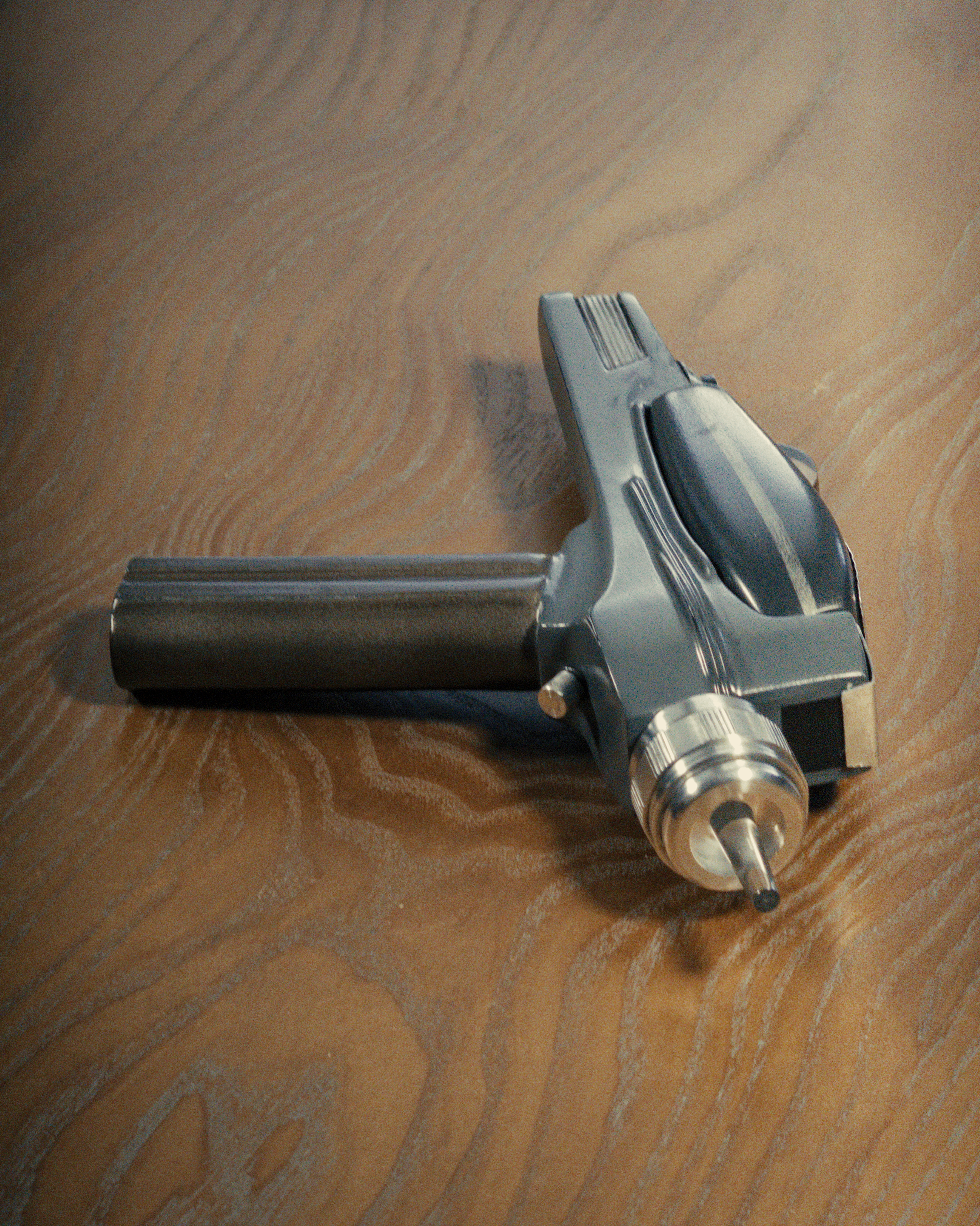

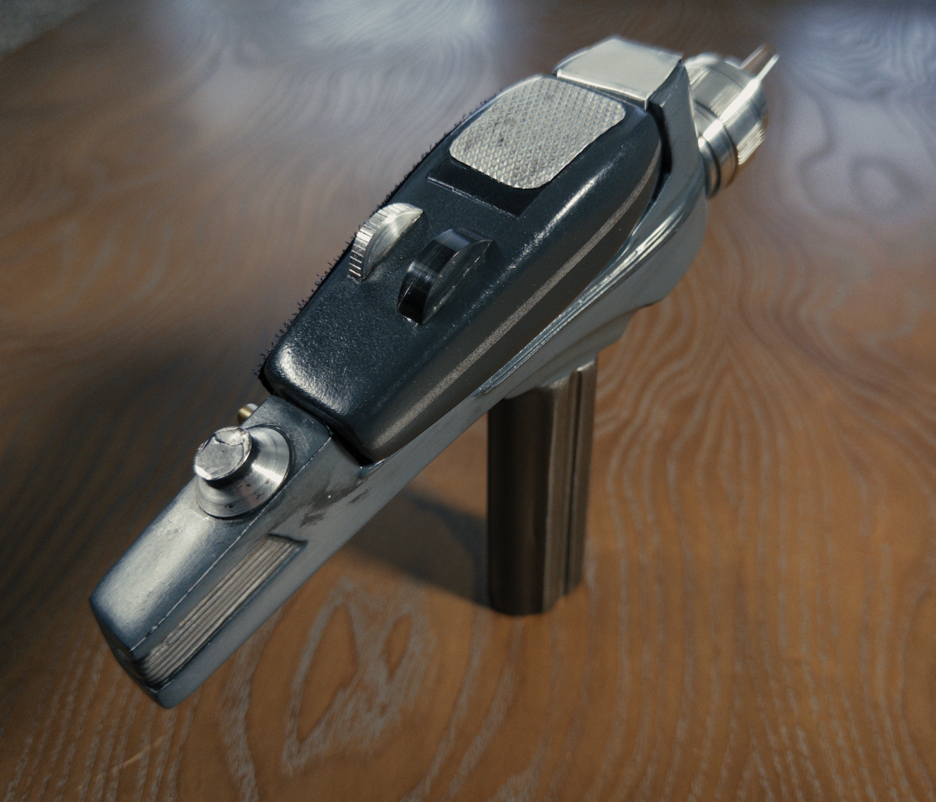

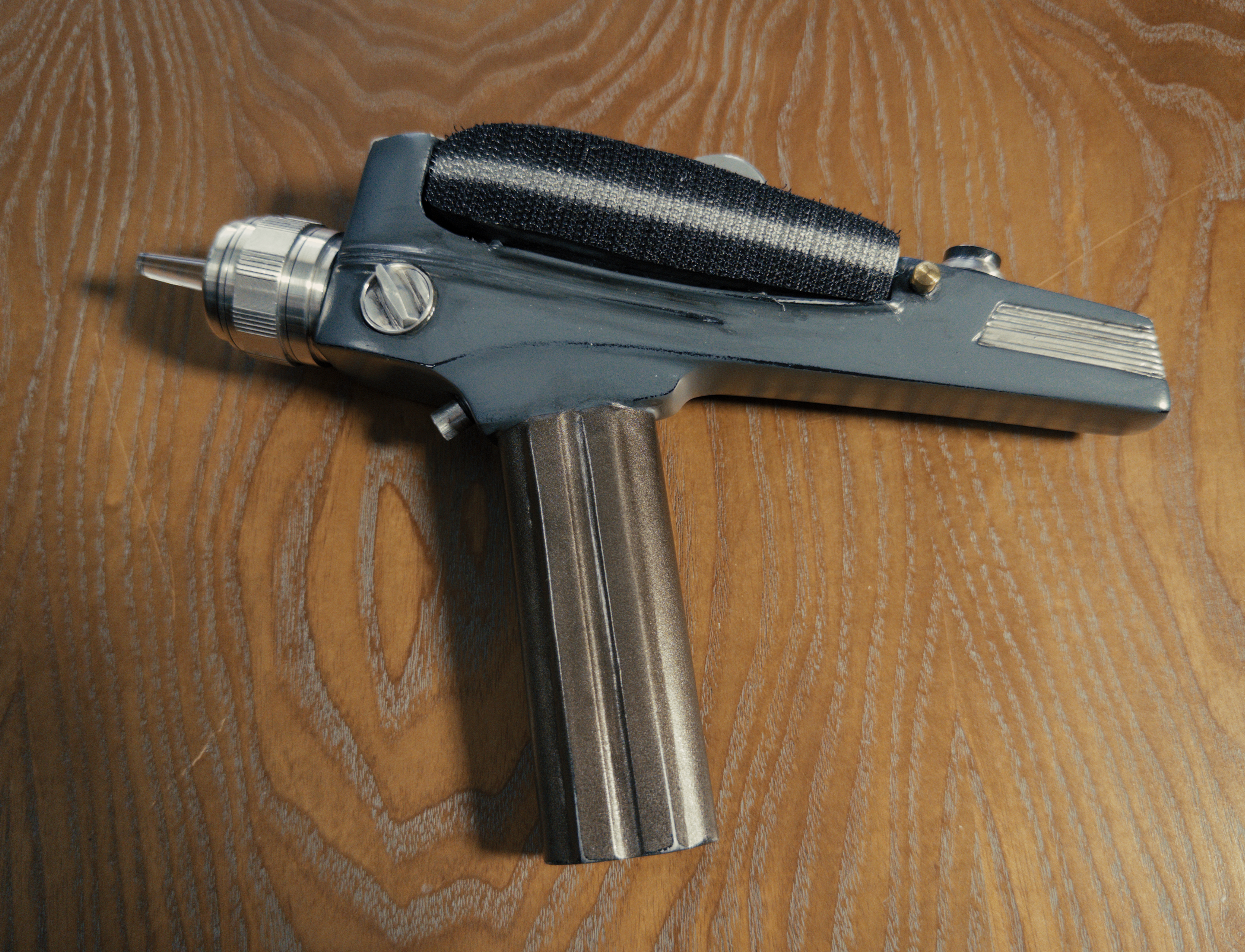

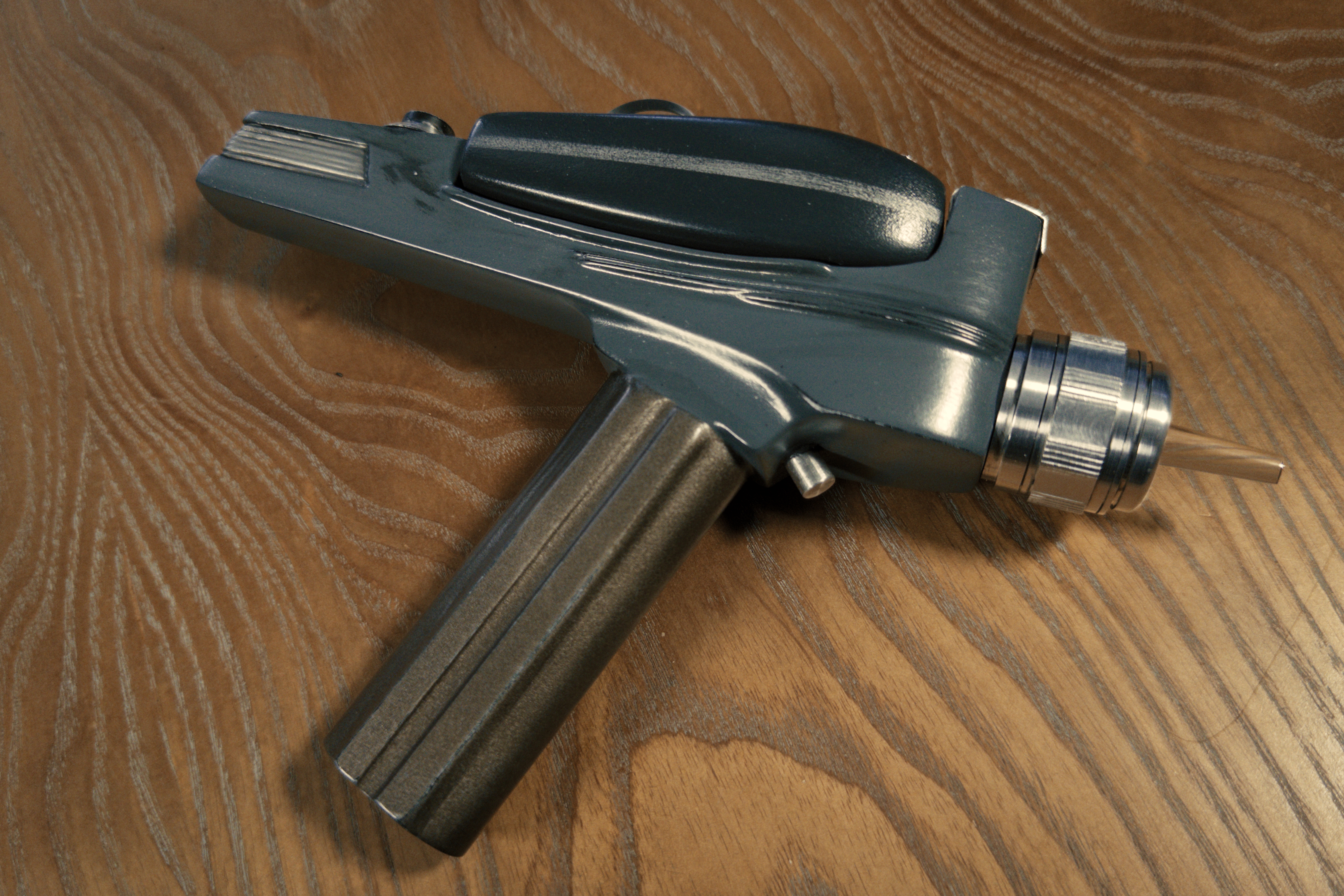

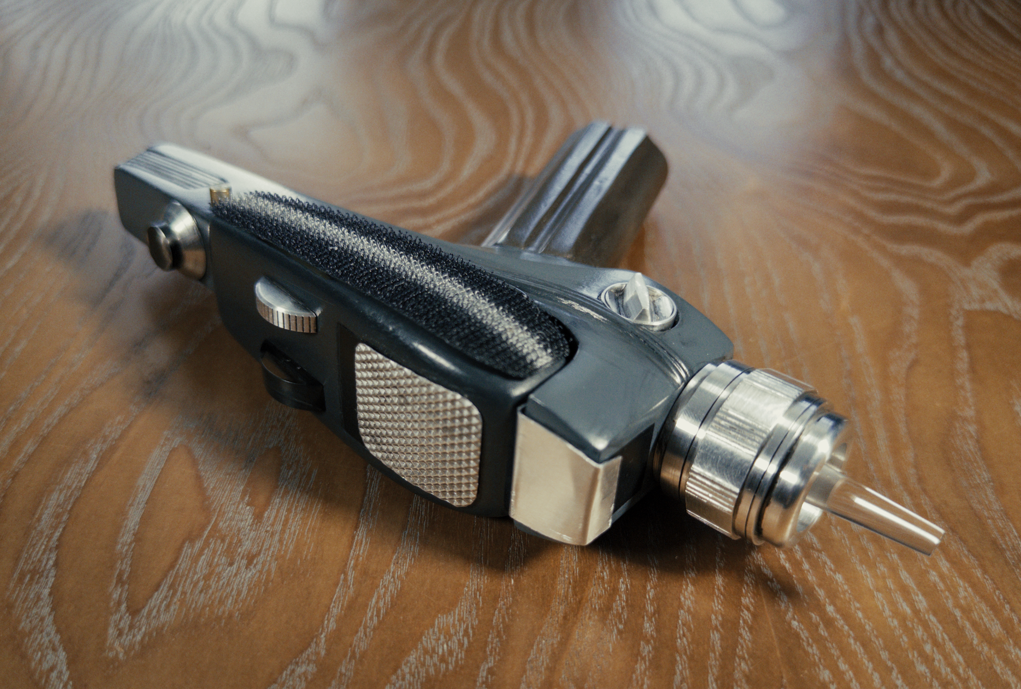

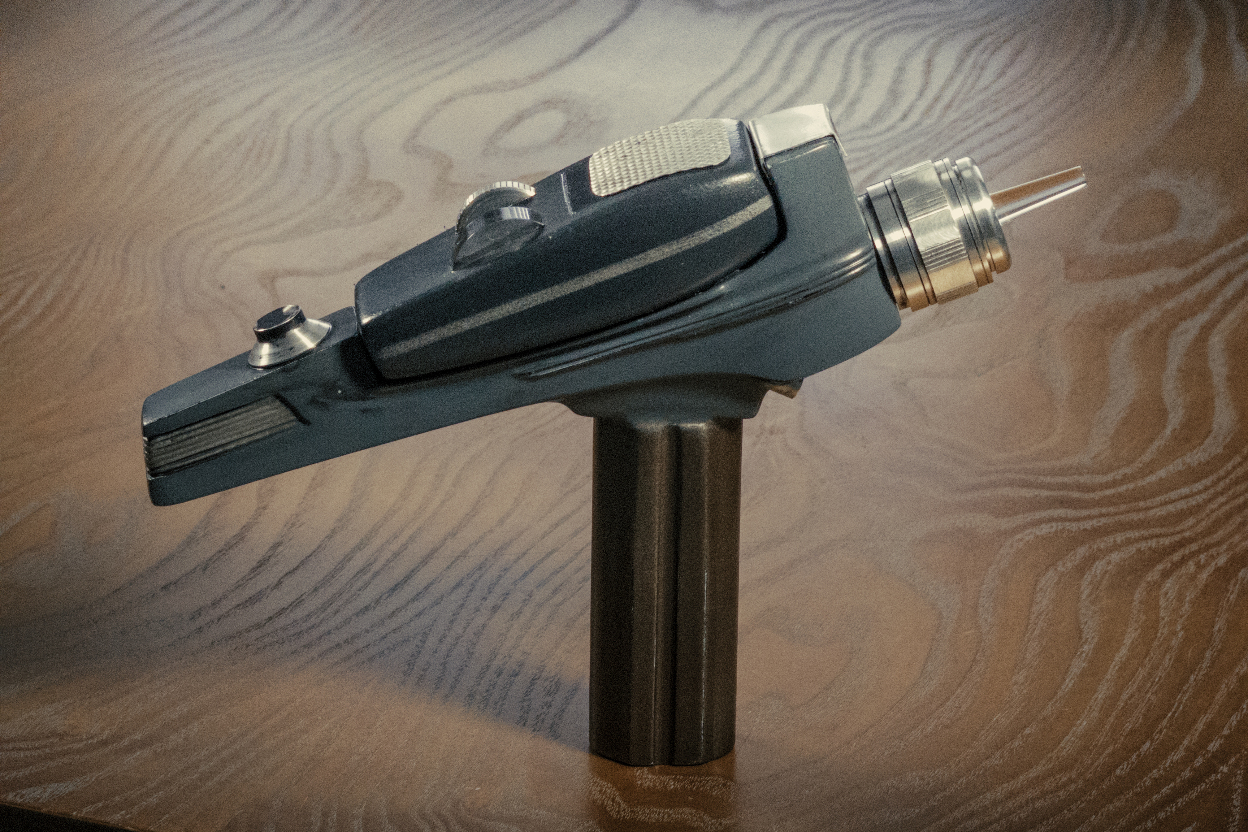

I’ve had some very early shanko shells sitting in a box for nearly 16 years and thought it was finally time to do something with them. Many thanks Nicksdad for the excellent metal parts and the grip. Shanko’s early shells had a lot of inaccuracies to them so I reshaped as much as I could. Flattened out the top of the forehead, thinned out the bulge around the sides below and beneath the side rails, flattened the slope above the trigger, and slimmed down the whole thing to match the west coast mid grade photos. The P1 had to be reshaped as well. The area beneath and aft of the thumbwheel/power meter got flattened out to match the slope the screen used mids had. The whole thing got a semi-flat black undercoat, then the P1 is Zynolyte Dark Grey, the P2 is Krylon Shadow Grey, and the grip is Rustoleum Dark Bronze misted over dull aluminum. All 3 of my old cans of shadow grey nearly exploded on me for some reason. Luckily enough, buying a new can off amazon worked out, looks like the color hasn’t changed. Dull aluminum for the silver bits with a black wash over the whole phaser including the metal. I went for the authentic screen used look but tried to keep it tame for the most part. Steel wool was used to cut down the top coat along the edges. I wasn’t precious about protecting the previous coats or when using glue. It got messy while I was building it and it just seemed to add more character. A lot of the weathering you see was from the black wash mixing in with the slight tackiness from the clear expoxy that found its way into places it shouldn’t be, but it felt right. Sealed it all in with a light semi-gloss clear coat. I bought some mil-spec fabric velcro for the P1 that seemed to have a tighter grouping to it and felt more like the authentic vintage velcro. Over all a really fun build! I’ve got all the parts now for a hero so I’ll get around to that hopefully this year. Here are a handful of shots from my phone-

Thanks! All of the known real midgrades in private hands are painted to match the heroes. In all my years of building I’ve never seen one with a black handle. In my original post I stated it’s actually dull aluminum with dark bronze misted over it to create a lighter shade. I agree, dark bronze metallic on its own comes out a bit dark. My build has a grip that is lighter than what’s on the Wand Co phaser for comparison.

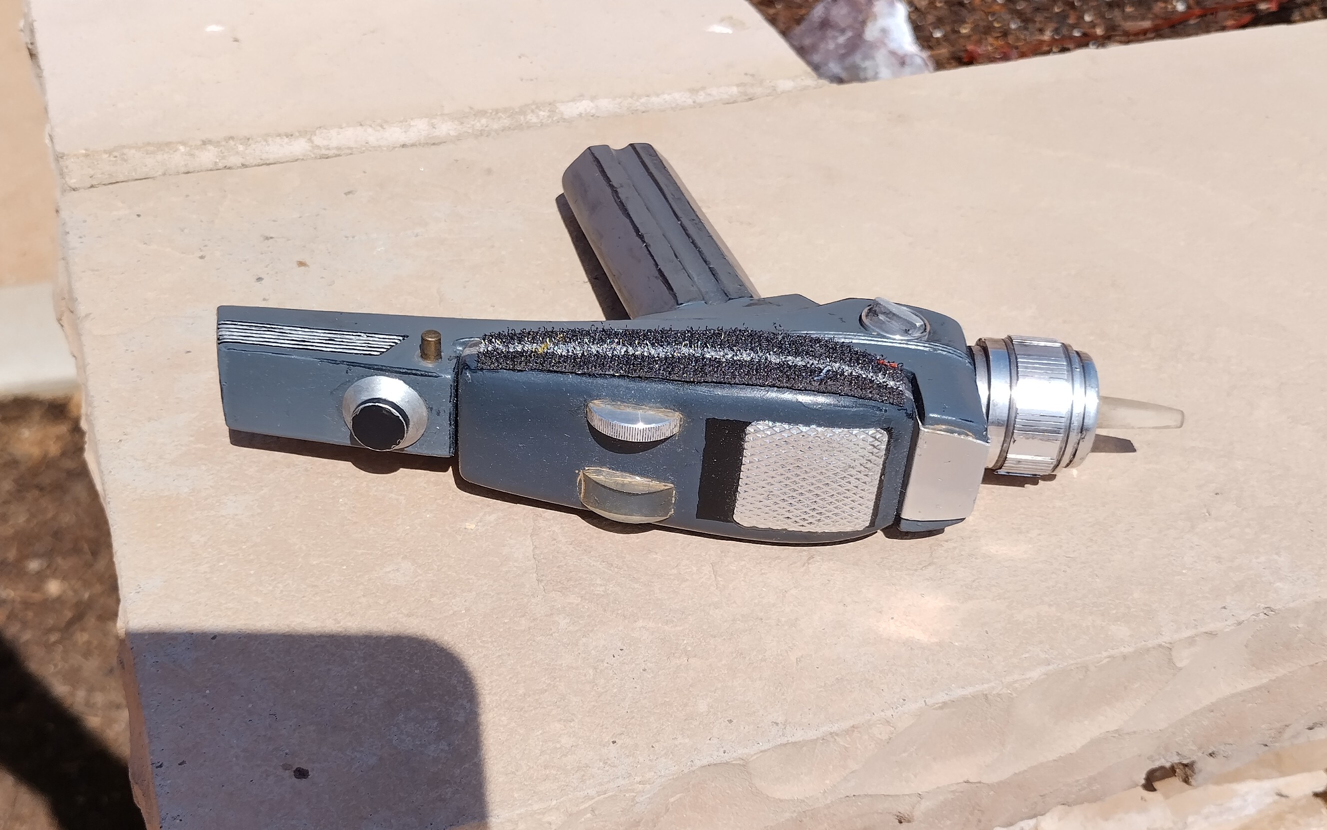

Here is my midgrade built based off of one of the screen used props I photographed & mixed the colors for
Handle color looks great on that one, what was used?
I mixed the colors by hand as I am rather old school
I checked my RAL guide (nothing came close). I will dig up my Pantone color guides to see what comes closest and give you the number
