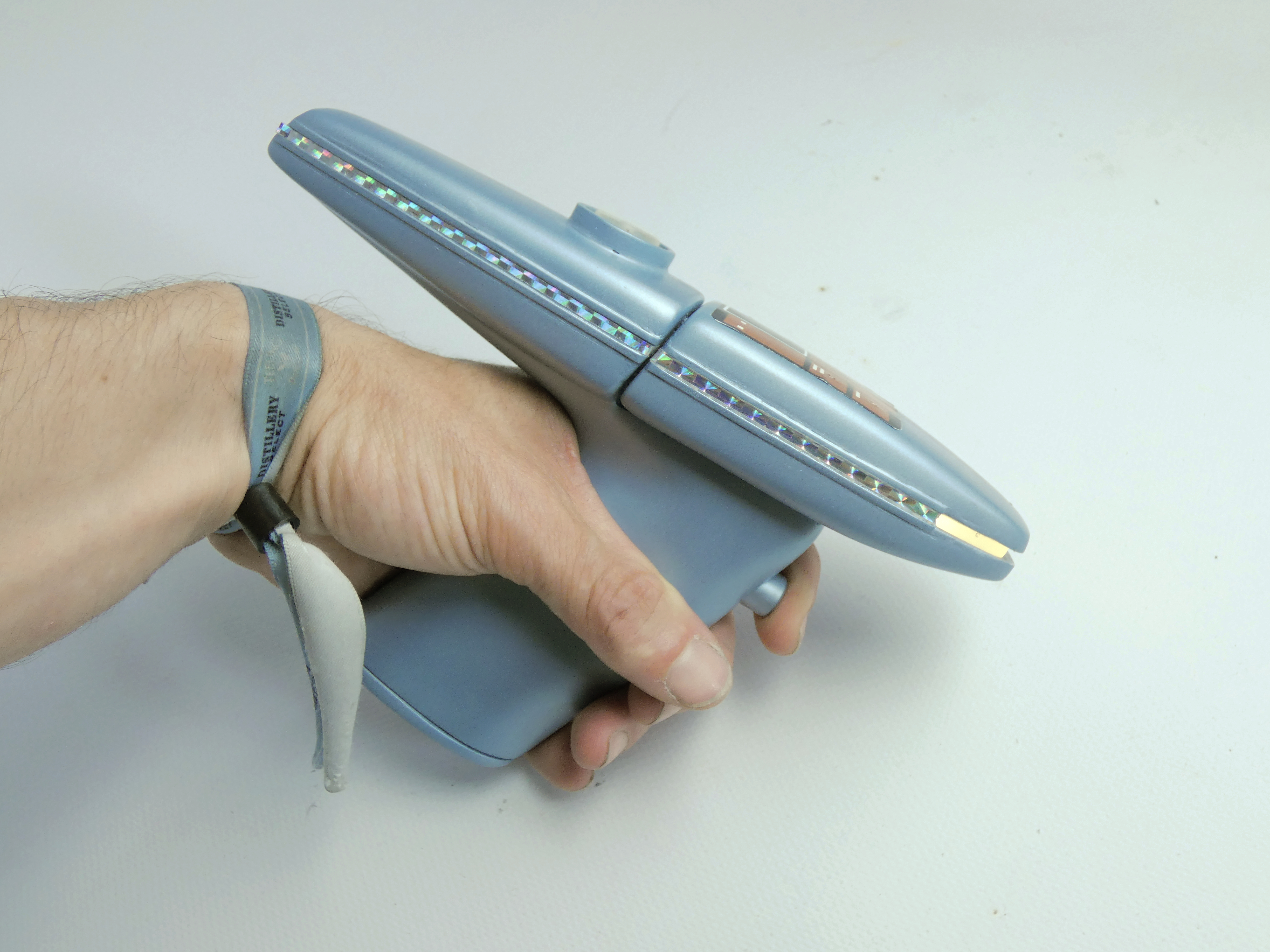

Ok, I'm almost done with that first try.
I went for the classical representation of the WOK phaser and took inspiration on the Saavik/Jein hero prop, wich the most documented iteration so far.
Not my favorite version to be honest, I hate that silly prismatic tape on the sides. I think it looks terrible in person.
I used Tamiya PS-49 to paint it up. Definitely not the ideal but that's the closest match I could get.
It's not made for such use, it's very thin, way too blue and easily scratch off but things got better with a satin clear coat. The whole color turned lighter and way more durable.
The emitter is made out of clear epoxy resin.
It lits up by pressing the trigger stud and I'm crazy about that as I can't stop playing with it.
I'll install chaser lights on the control pad later as I have to learn how to make such thing.
Unsurprinsingly the gun is pretty fragile and lightweight. The seam line is still visible on some areas and the overall shape is a bit wonky but I must say I'm pretty happy with it.
Let's say it's a step forward, for me, into the fascinating world of phaserology.

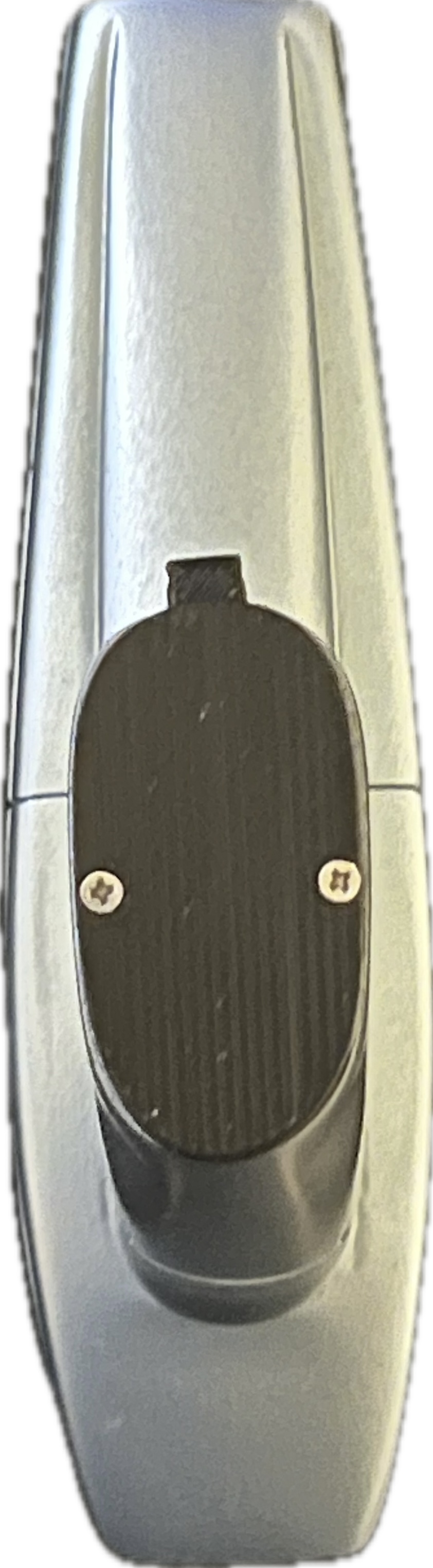

Weird question here:
Most of the screen used TMP/WOK phasers have a rather rounded tapered rear.
Is it en optical illusion or does the the HMS rear body has a kind of curved shape on its left side ?
Here is a shot from the bottom, up.
It’s a bit “asymmetrical” with the left side having a slightly more rounded curvature than the right.
I never noticed that before.
