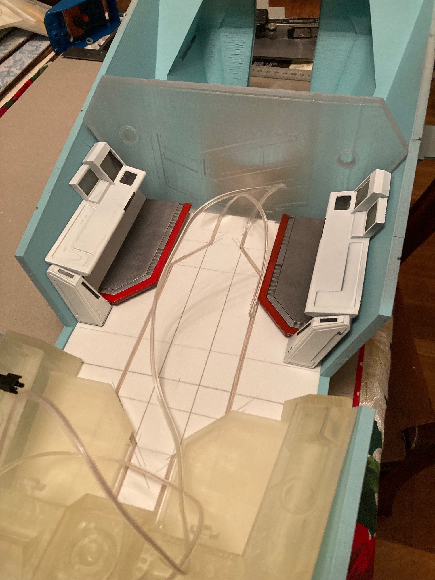

Cockpit printed in resin.
I have printed it in sections to see how in looks. The final print will be in clear so I can back light it all.
I an not sure what I will do wit the roof paneling yet but that has to have lighting as well.
The white on the print is residue from the cleaning solution I have not cleaned off yet.
I had to add this strip and pads in the door way to support the floor.
I had to trim the floor so I can add the underfloor lighting.
The white filler on the floor is to putty some of the groves from my marking out pencil.
Adding the under floor lighting.
Trying it with the consoles fitted.
Side view through the door.
Front view through the front window.
Now through the back door.
all the lighting will be 12V DC except the EL wire which requires 3V AC.
