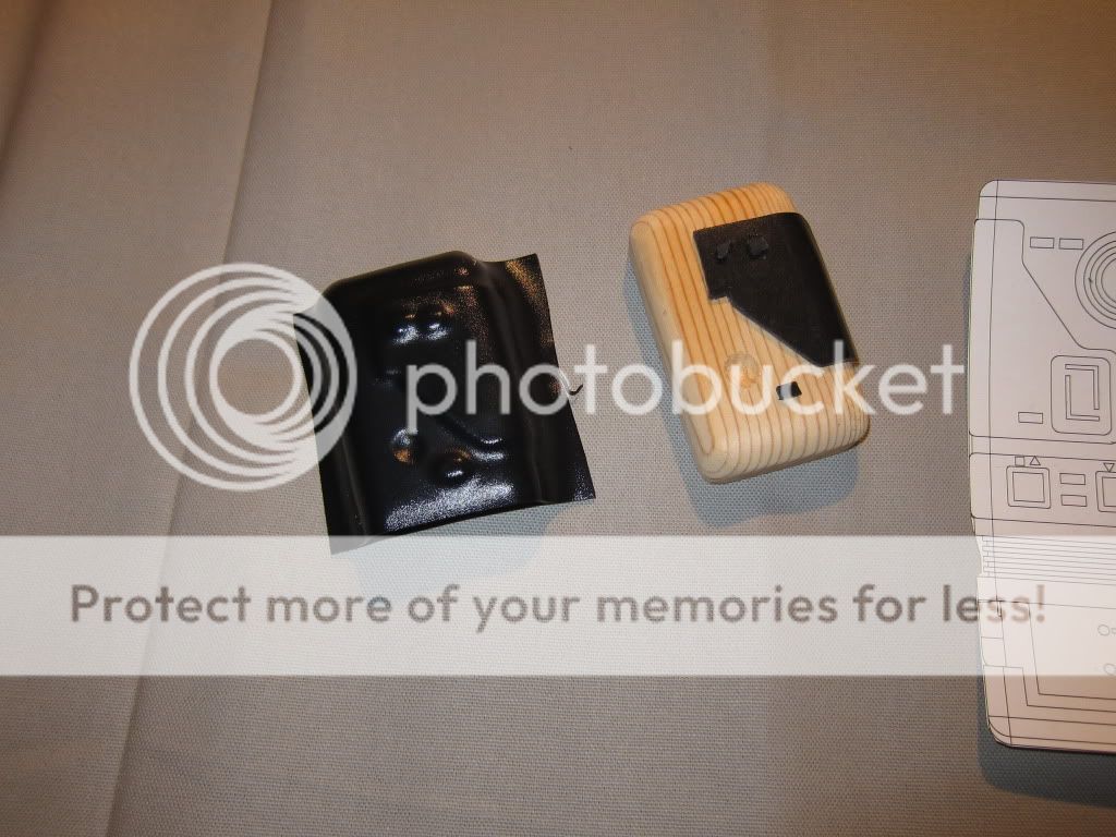

Sure- kydex is a type of thermoplastic. It's very rugged and pretty easy to work with, and is a popular material for making sheaths and holsters out of. (Sci-fi ones, too. I believe it was used to make phaser and tricorder holsters in Star Trek, from TNG on, and laser holsters in BSG TOS, and the first season clamshell holster in the new BSG.)
You can heat it up in a toaster oven (or regular for larger pieces) until it softens, then form it- and rework it later with a heat gun. In this case, I'm using a foam rubber padded press to force it down over my buck. (The idea is similar to vacuforming, only instead of pulling the air out and pushing the plastic with atmospheric pressure, I'm pushing with the heat-resistant foam.)
I actually did the first test tonight. It looks as though I will be able to do the big features this way, but all those tiny rectangles and triangles are going to have to be glued on after the fact. Here's what my test part looks like:

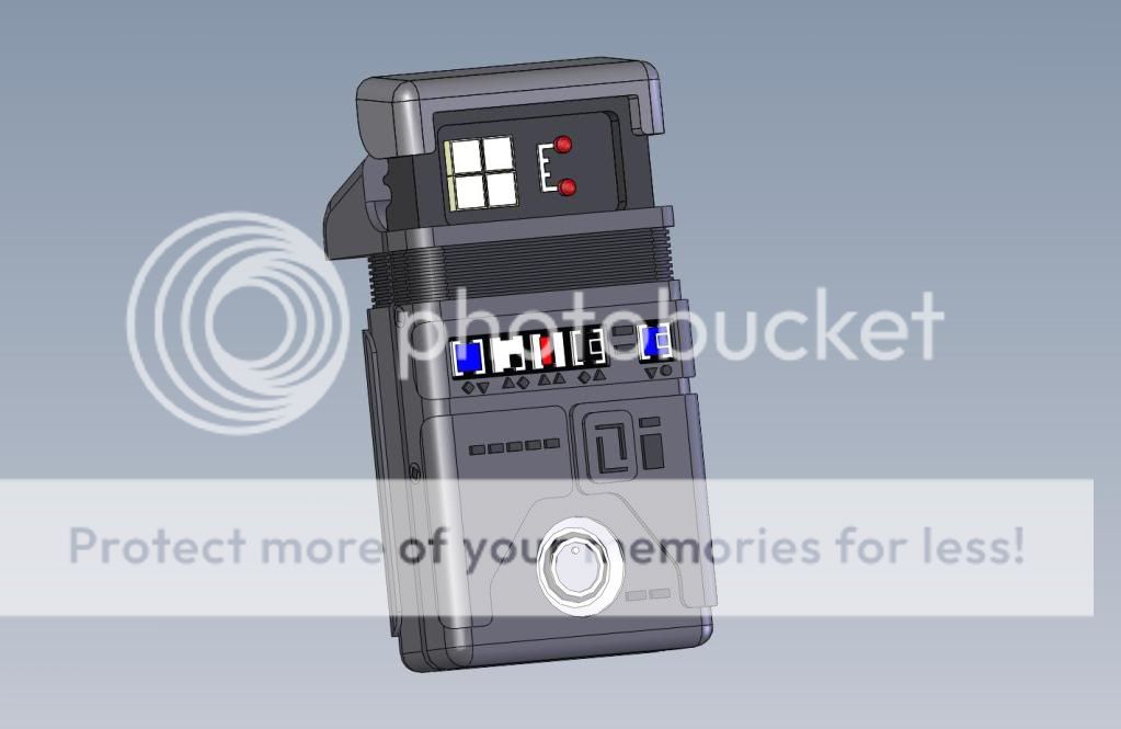

Just wondering...if you have the tricorder modeled in 3D on the computer, couldn't you have it printed by a company, using a 3D printer? I know this goes into a totally different area, but it's looking like this will get more and more affordable in the near future.
Re: Star Trek III Tricorder Project - Scale set
That's a good point. I could- I hollowed out my model (mostly kept a wall thickness about 2mm) and had it quoted by Shapeways. For a two part hollow version (separate sensor head) made out of the 'frosted detail' material it would be about $400. (The 'white strong' material would be only about half that, but it doesn't capture the detail that well, and it doesn't take paint well, either.) If I really thinned out the walls I might be able to bring that down to close to $300.
I want two of them, and I think going with my current plan it will be closer to $40 of material (and a lot of my time) each to make them- that's an order of magnitude less. Since these are intended primarily as costume accessories, I think I'll try to find the time to build them. (I also have to find time to finish the costumes, but that will be a separate thread.)
However, if you know of newer, less expensive ways to get things 3D printed, I'd be interested...

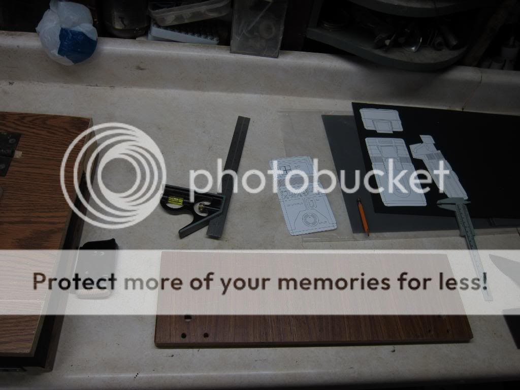

Bench with paper templates, scrap wood & kydex-

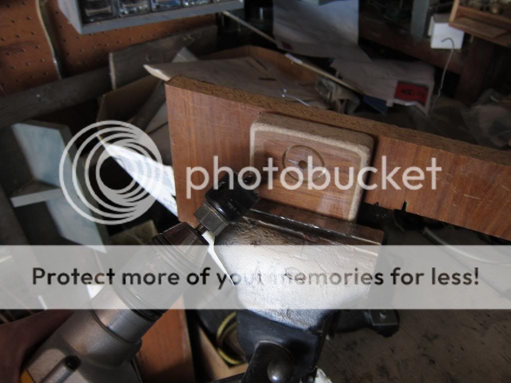

Power sanding to get the rounded edges-

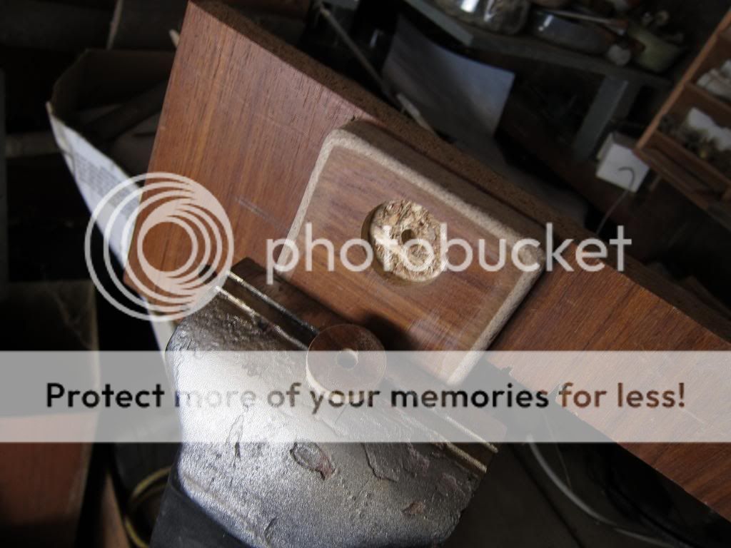

Working on the front circle detail-

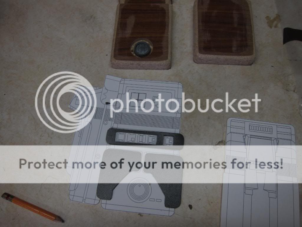

Detail panels out of scrap kydex-

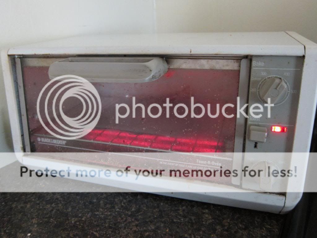

Heated the thermoplastic with my super-high-tech toaster oven-
